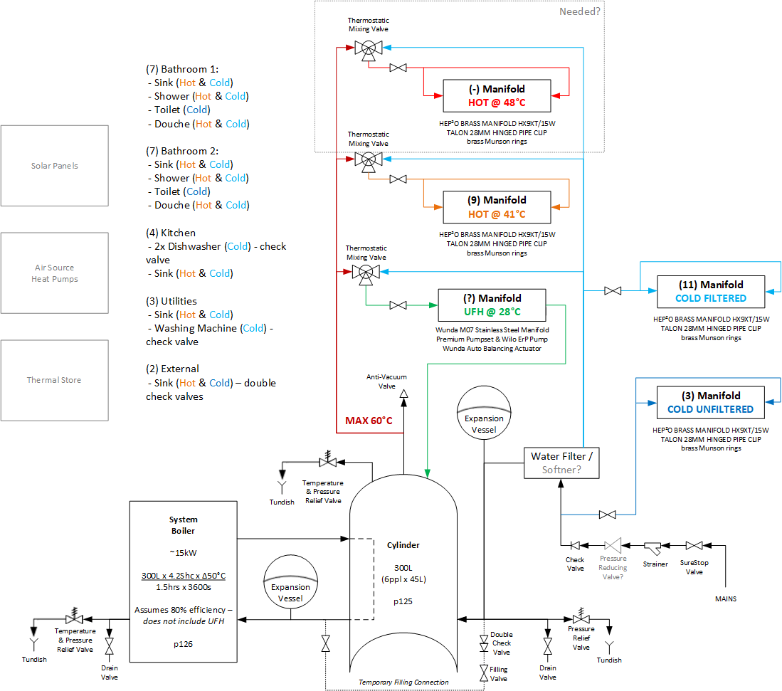

Posted (edited)
Due to some of the astounding quotes for UFH and DHW systems, I have decided to have a stab at designing and specing our own system! This is the first draft, possible due to this forum and the Building Services Handbook recommended by @curlewhouse - an awesome book, I've left in the page #'s from where I've done capacity calcs. Even so, a sanity check is very welcome!
It's currently a bog-standard unvented system + system boiler that is scaled for the DHW only. You'll notice I'm one of the converted to @Nickfromwales's Hep 20 Manifold setup, though I'm not necessarily sure that the 2nd hot water at 48'C manifold is necessary for us. Principle question here is whether it's safe to pass the output of the UFH back to the main cylinder, or will that have to be discharged?
We're unsure as to how we're going to supply heating however, whether we scale up the boiler / cylinder capacity, or whether we go via the ASHP or Solar Panels/Thermal Store. We're looking at ~2100 Watts for the UFH based on our heat losses during the winter here in Oxford. There'll be no other heating in the house save for some electrical UFH matts in the upstairs bathroom.
  • ASHP with a good CoE running overnight to take advantage of the E7 scheme sounds grand, though we're concerned with the noise and another hole in our external wall for this. Could this be plummed directly into the UFH, or would a separate cylinder be needed to store the output?
  • Solar Panels sound grand, but we're concerned the timing of the heating will be at odds with when we'll need to heat the floor. Also, the initial outlay appears quite steep so we'd likely need to install it retrospectively when we've the money.
  • Scale up the Boiler to ~18kW to supply the UFH along with everything else
FYI: I used MS Visio 2016 which has several Pipes & Valves stencil sets out of the box. Very useful!

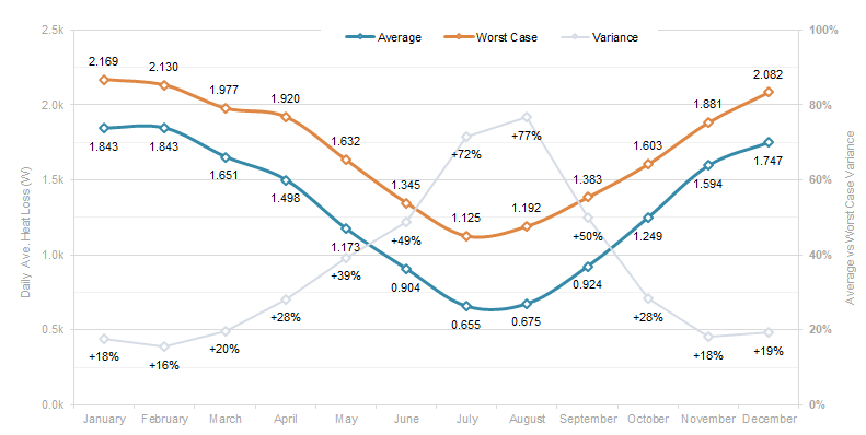

Heat Losses calculated thanks to @JSHarris's calculator.

Posted
@Visti UFH doesn’t work like that - it needs a 3 way valve and would be connected to the boiler if that is an unvented cylinder.
You also don’t need an anti vacuum valve on an unvented cylinder - only used on gravity cylinders with high pressure pumps.

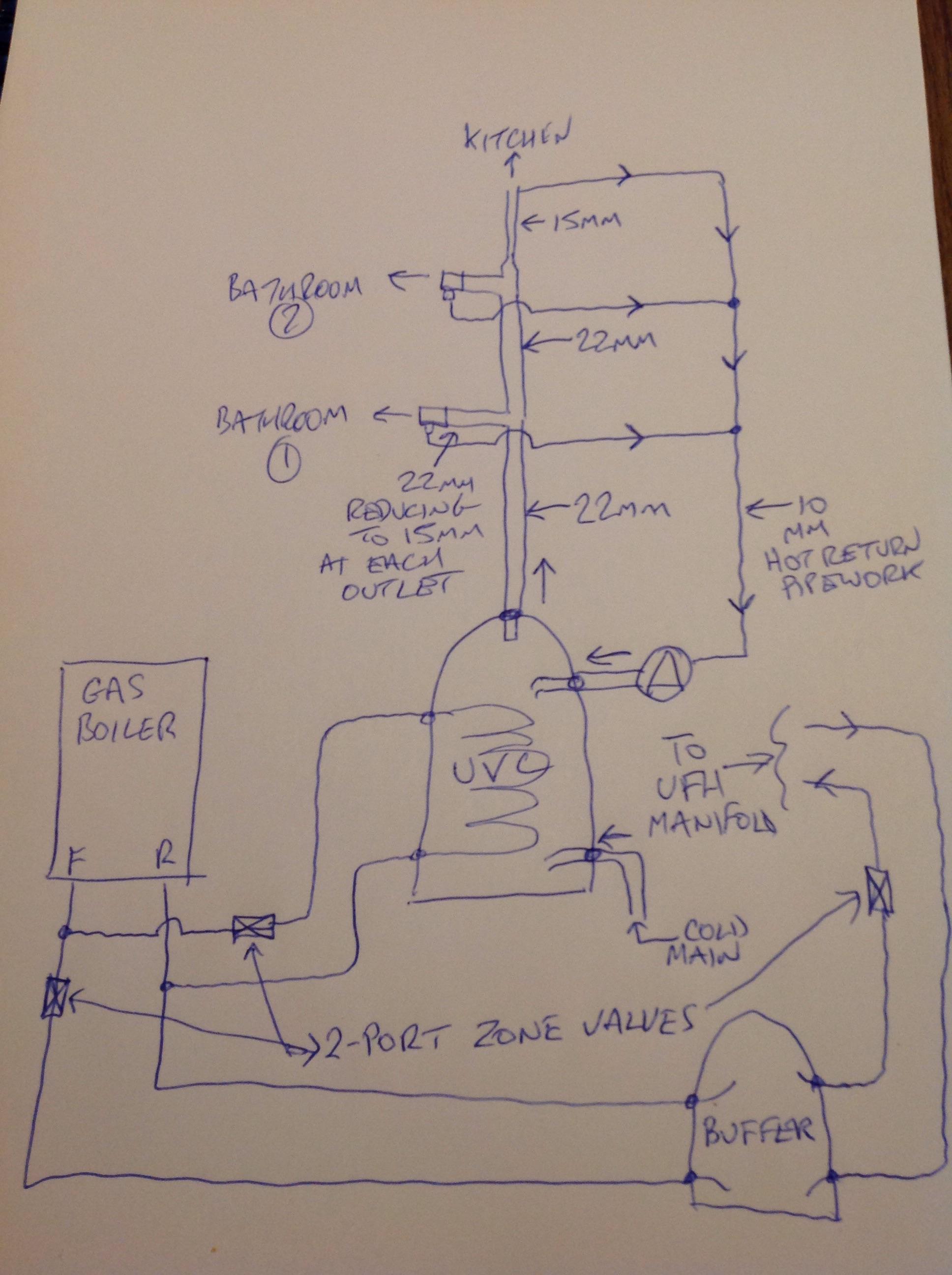

Posted
@Visti
Rough as toast sketch.
You can omit the buffer but its its better to have it in to help regulate the delivery from the HP and mitigate against short cycling when the house is up to temp.

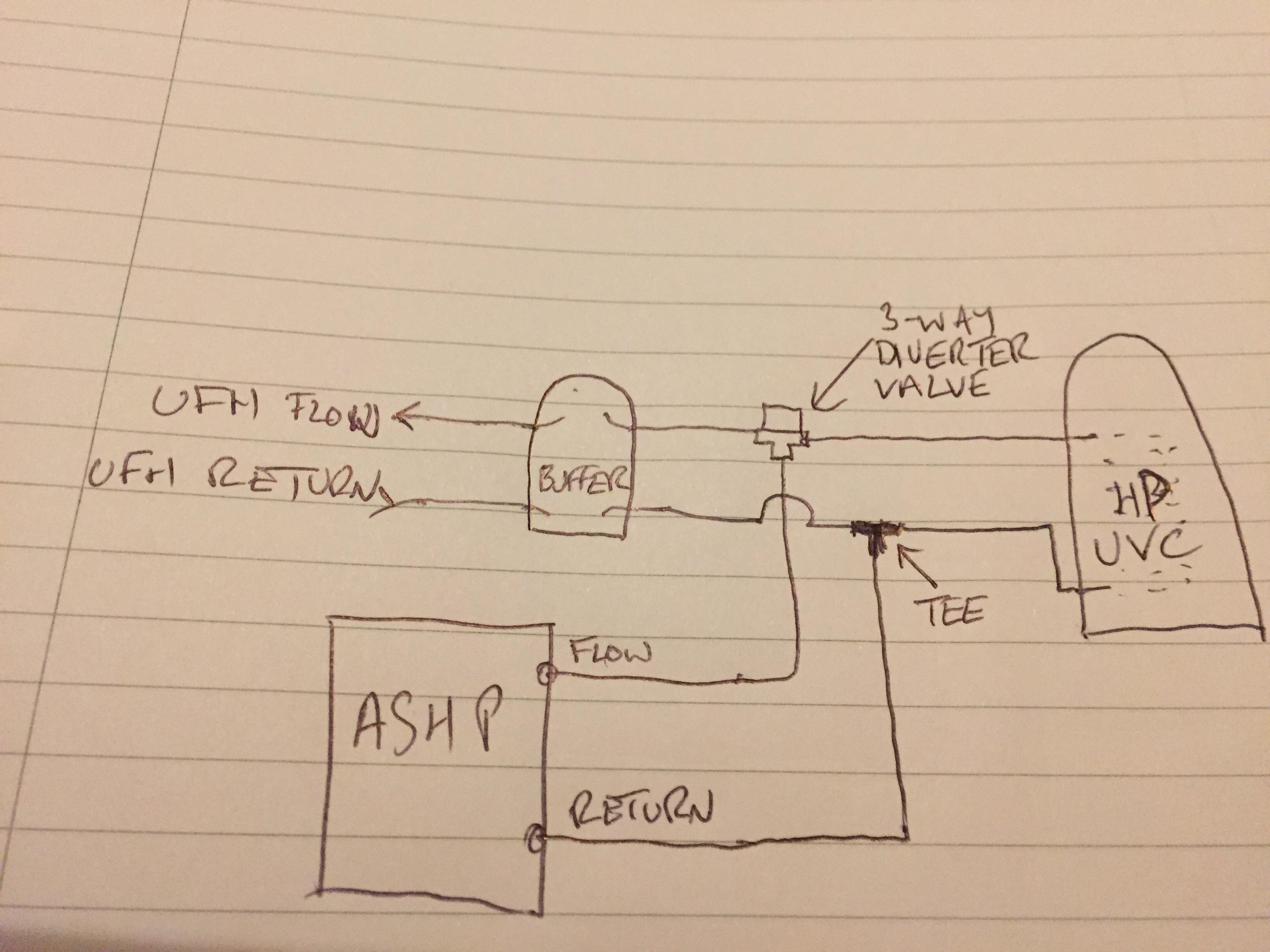

Posted
Yes there is something a bit odd about your design @Visti as @PeterW says because your UFH return is going into your hot water tank so there is a chance that it could, depending upon demand / slab temperature, I suspect overwhelm the tank in temperature terms. @Nickfromwales seems to have shown the way using the ASHP to run the UFH and the UVC.
Posted
2 hours ago, Visti said:
2100 Watts a day
Not sure what that really is.
watts (W) is power
day (24 hour) is time
So do you mean 2100 [W] x 24 [h] = 50.4 kWh/day
Posted
You have mixed potable (drinking) with non-potable (not drinking) water!
The way you have it the boiler heats the UVC via a coil (Primary water non-potable), what is in the UVC is potable and supplies you domestic outlets.  The UFH system is non-potable so cannot be run directly off the UVC you need a buffer tank as @Nickfromwales diagram shows.
Alternatively if you want to run one tank then it would need to be a Thermal STore (TS) type where you heat the TS directly from the water (TS contains primary water), you take a tapping for the UFH from the TS (usually middle) and use Coils/Heat Exchanger for Domestic Hot Water (DHW).  These have their drawbacks (heat loss).
As you have a boiler the simplest is to add a buffer and plumb the UFH (upsize boiler if required).
If you want an ASHP, then again it needs a separate buffer (though you can potentially not have one) and you should consider DHW pre-heat to take advantage of the high COP of ASHP at 40oC, however you system will be infinitely more complex (for a normal plumber).
If you want to run the ASHP overnight for E7 then you will definitely need a descent buffer, to store adequate heat for the day (and DHW pre-heat if you go that route).

Posted
Insulated pipe work for a Monobloc ashp can leave the thermal envelope through the floor slab. If the alternative is a flue from a gas boiler then I reckon in terms of heat loss the ashp would be preferred.
With regard to noise, have you looked at a split type ASHP? Where the external condenser and internal compressor are separated. This gives you the option of placing the condenser around 30m away.

I would say you need to revisit some fundamentals as per the comments above.
Q1: if you have mains gas boiler why add an ASHP. Waste of money you cannot recover the extra capital. I posted some examples on this forum. I would stick with gas. However, if you add a PV system then it swings in favour of ASHP over gas.
Q2: Why 15 or 18kW from your system boiler? We have 6 people and manage with a 7kW ASHP and 300l DHW. Our space heating load is higher than yours at about 3 to 3.5kW.
Q3: Why have a water softener in-line with the UFH / heating circuit? The heating circuit is normally closed-loop so never needs fresh water after the intial fill. Just add inhibitor. Water softener is then reserved for all other uses apart from drinking.
Posted
@Visti
Just as a reality check, that having a flue penetration in the wall of the house is of very little consequence. You can still make it airtight and you can fill the sleeve ( duct ) with intumescent expanding foam for a bit of insulation. Yes it'll be a slight cold bridge, but the latent loss off the boiler will offset that by a huge factor.
ASHP or gas boiler ?  GAS BOILER!
Smaller tanks, less installation complexity, no antifreeze, common and simpler controls ( so setting up and operating it is childs play ) and still a reasonable unit running cost per kWh. What boiler do you have now? Do you need to replace / upsize ?
The 'beauty' of the manifold setup only comes into play if it's centrally mounted and sees short-ish runs from the manifold to the hot outlets. ( the cold is not an issue ). If the plant room is off side and leaves you long runs to two or more outlets then it may be a candidate for a standard series plumbed configuration, and the introduction of a hot return circuit and pump.
I agree, if you have mixer taps then the secondary TMV is a luxury item that can be dropped from the design, but as they're so bloody cheap I choose to install where possible as a comfort measure as much as for safety. If there are a house full of little ones who will grow up there, it's a no brainer. Fwiw, the image where you see two TMVs is one where a TS has been fitted, so comes factory supplied with a TMV to cap the output temp ( usually 50-55oC ) as a measure for anti scald and to mitigate any excess energy wastage. A TS will typically store water ( primary heating grade water ) at a much higher temperature conmpared to an UVC so these are two different beasts with two entirely different uses and installation requirements. ;)  An UVC is full of drinking quality potable water, stored ready to be drawn off at the tap, and a TS is full of non potable ( primary heating grade ) water which has an instantaneous DHW coil sat in the water which instantly converts incoming cold water to hot DHW, so basically a giant combi that uses heated water instead of gas as the energy medium. An UVC does not require the primary TMV, in fact it requires no TMV at all. If you decide on the hot return and series plumbing you definitely want the UVC, sized between 250L - 300L ( 300L better if you ever decide on solar pv ( NOT solar thermal )) and to order the UVC with a hot return tapping to accept the pumped DHW return.
As I know you'll be wondering what the hot return is all about :) :
Lol. Another way of doing things :D
Thanks for pointing that out, I've fixed the original post
It's just Watts, so that'd 50.4 kWh/day, or ~1512 kWh/month.
That's worst case however. On average it'd be about a 3rd lower, at about 32 kWh/day, or 950 kWh/month.

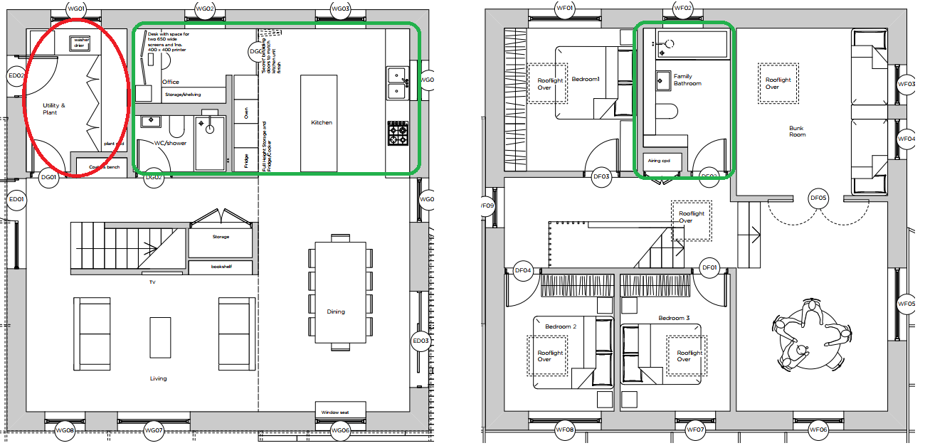

None as of yet. We've got nothing but the land so far, foundation is going in march, so it's a blank slate thankfully. No limitations at present!
8 hours ago, Nickfromwales said:
The 'beauty' of the manifold setup only comes into play if it's centrally mounted and sees short-ish runs from the manifold to the hot outlets. ( the cold is not an issue ). If the plant room is off side and leaves you a long runs to two or more outlets then it may be a candidate for a standard series plumbed configuration and the introduction of a hot return circuit and pump.
Good point. The system wont be centrally mounted (utility room in red), however the majority of the runs will be under 4m in the areas I've highlighted green. Only exception will be the Kitchen sink which will be about a 10m run. LHS Ground, RHS First Floor:

Posted
Any reason you cannot swap the utility room with the office? Makes all runs (water, gas, electricity, ventilation ducts) that bit shorter.
