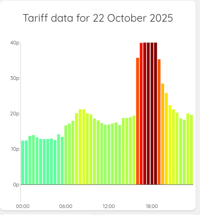

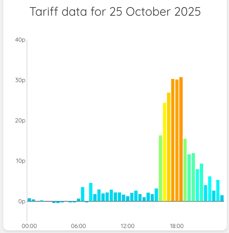

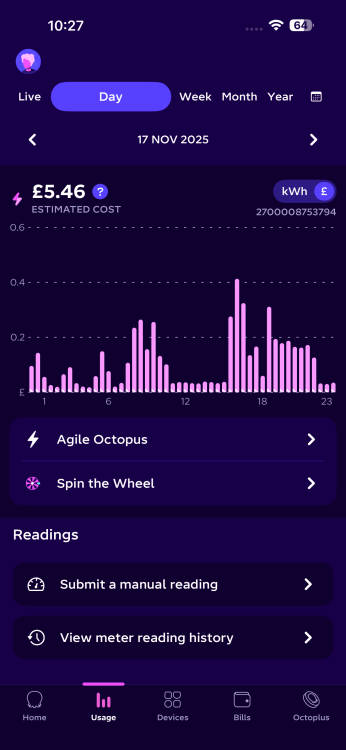

SteamyTea Posted November 21, 2025 Posted November 21, 2025 @damspt Does that price on your charts include the daily charge and VAT? 4 quid a day seems quite low to me, mind you, yesterday I used 6 kWh, and I had a light frost on the car this morning (only one at work that did, but then I start earlier than the idle buggers). Your chart shows a higher usage during the evening, are you doing a lot of cooking and clothes washing/drying. A faulty fridge can burn though quite a bit of juice, check it to see if it constantly running (touch it and feel the vibes). Much warmer when I left work half an hour ago. South West wind now. So cold snap is over. This is what it was like earlier. Not much difference in temperature, but windier, and from the North, which is rare down here (we had snow in Bodmin).

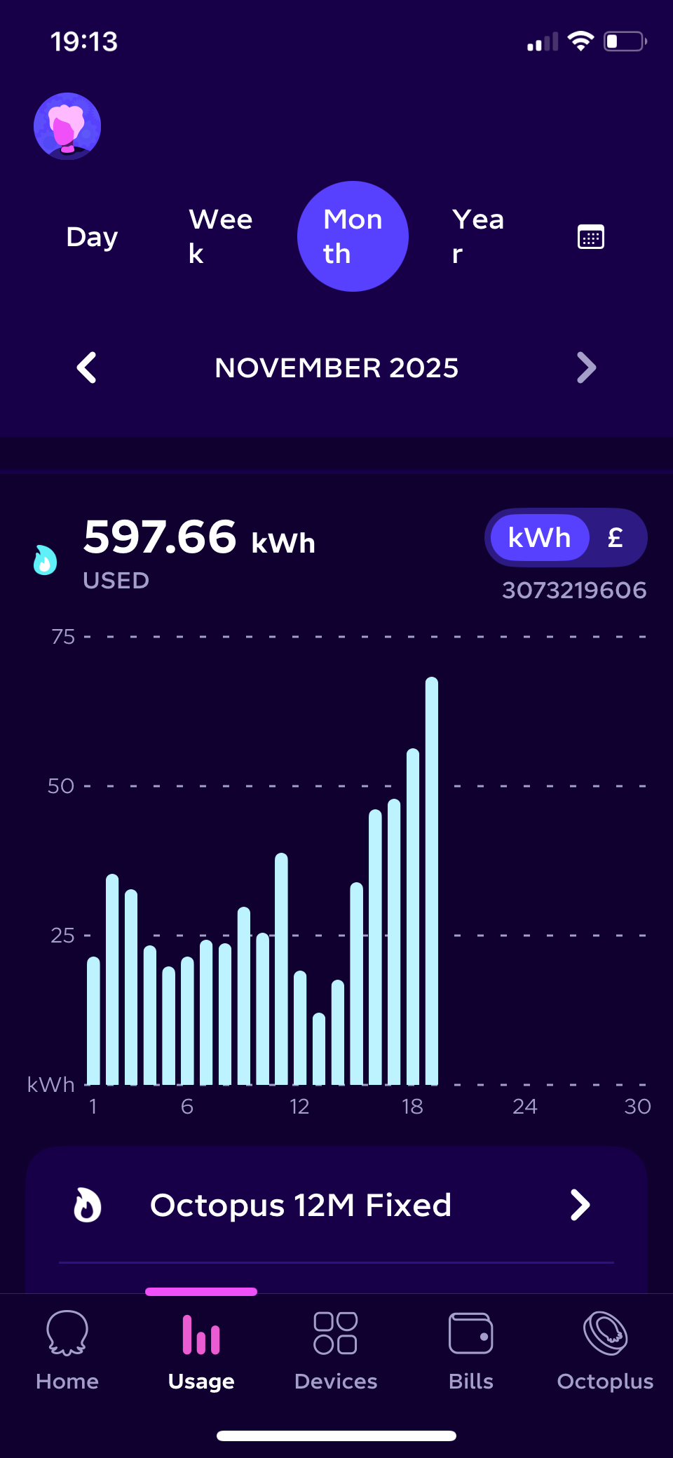

marshian Posted November 21, 2025 Posted November 21, 2025 1 hour ago, JohnMo said: Not sure why you think the electric consumption is high. Assume you are all electric etc. Our house seems to use about 20kWh without the heat pump. 59 minutes ago, Kelvin said: Ours is about the same. Blimey - we've never hit that sort of base line on Electric - 3 loads of washing, some with tumble drier (some with dehumidifier) and a load thro the dishwasher and we peak at 16 kWh in a day Average daily for the year is 9.5 kWh but typical base number is around 7 to 8 kWh and I regard that as above average

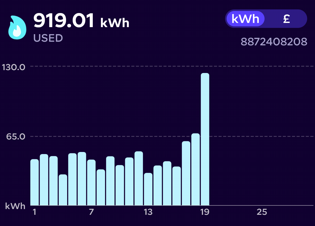

marshian Posted November 21, 2025 Posted November 21, 2025 1 hour ago, Beelbeebub said: Just for perspective our gas heating has shot up during this cold snap (shock!) We were sub 50kwh a day then the cold snap hit and we are more like 100kwh plus - and that's with a log burner going to take the edge off things. same here from average of 25 kWh per day to over 70

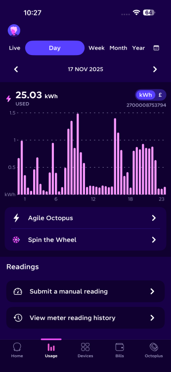

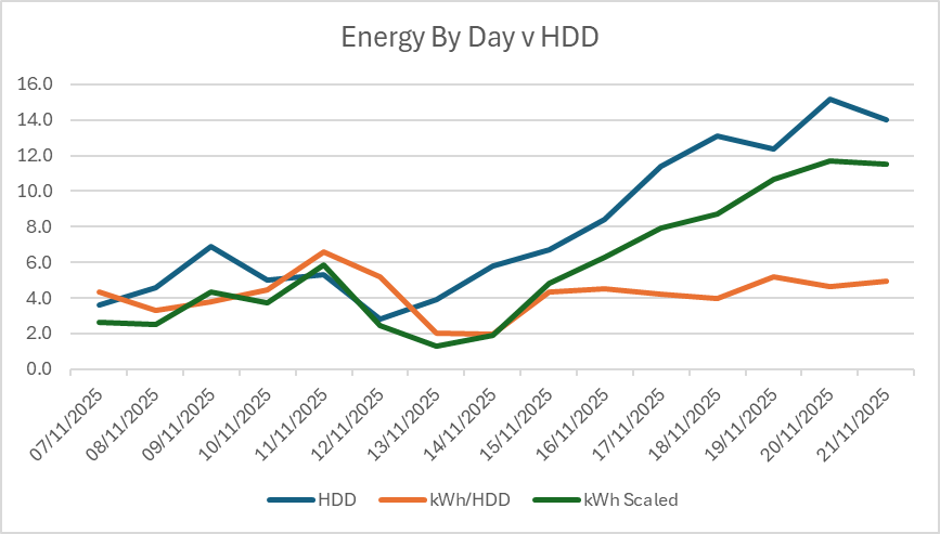

marshian Posted November 21, 2025 Posted November 21, 2025 2 hours ago, damspt said: I’ve noticed that it’s been since Monday (17/11) that we have been using a lot of electricity, I’m not sure if it’s a coincidence but our new fridge came on that day ( same as the previous one but had to be changed due to a fault ) HDD data for my house by day Raw Data below - I scaled the total kWh per day by dividing by 6 (so 25% or the other two (HDD and kWh per HDD get lost at the bottom Either way weather gets colder energy usage goes up or house gets colder - choice we have to make in winter (or a choice we don't get to make) Date HDD kWh/HDD kWh Scaled Total kWh 07/11/2025 3.6 4.34 2.60 15.6 08/11/2025 4.6 3.30 2.53 15.2 09/11/2025 6.9 3.77 4.34 26.0 10/11/2025 5.0 4.43 3.69 22.2 11/11/2025 5.3 6.60 5.83 35.0 12/11/2025 2.8 5.21 2.43 14.6 13/11/2025 3.9 2.02 1.31 7.9 14/11/2025 5.8 1.94 1.87 11.2 15/11/2025 6.7 4.33 4.84 29.0 16/11/2025 8.4 4.50 6.30 37.8 17/11/2025 11.4 4.19 7.95 47.7 18/11/2025 13.1 3.99 8.72 52.3 19/11/2025 12.4 5.17 10.68 64.1 20/11/2025 15.2 4.61 11.68 70.1 21/11/2025 14.0 4.94 11.53 69.2

marshian Posted November 21, 2025 Posted November 21, 2025 3 minutes ago, JamesPa said: Its nothing to do with 'your' fridge, its to do with the fridge outside which was delivered by the almighty (other explanations for the natural world are available) around the same time. Its warming up at the weekend and consumption will drop back down again. Exactly - My house heat loss is calculated to be 4.0 kWh at -2.4 Deg C OAT So if we have 24 hrs of -2.4 Deg C (or that as a average over the whole day) I can realistically expect to use 96 kWh for space heating plus another 5 kWh for HW requirements if I run the heating 24/7 Reality is those days are maybe just a handful of days a year rest of the winter time it's somewhere between 2 and 7 deg C

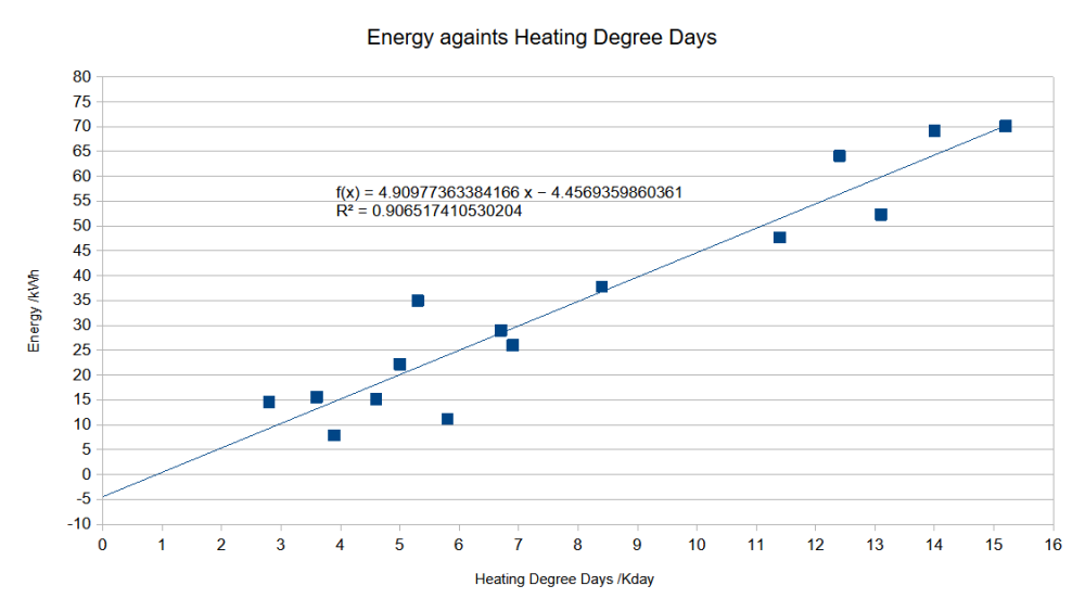

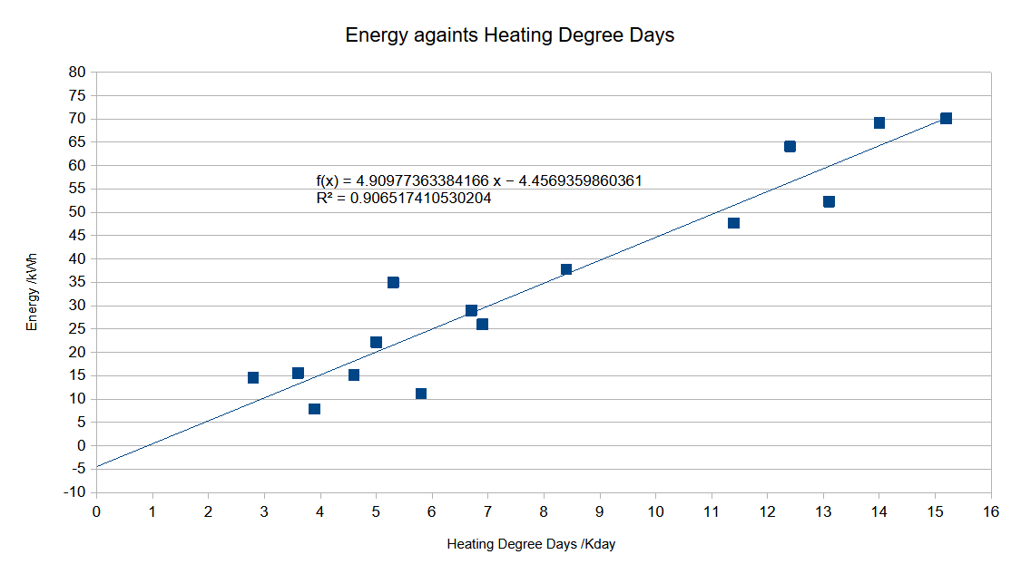

SteamyTea Posted November 21, 2025 Posted November 21, 2025 1 hour ago, marshian said: Raw Data below I re-charted your data in a more suitable way, but as I do not know what Heating Degree Days (HDD) base temperature you used, was it 15.5°C as that is the usual UK default, I suspect it is not giving a true picture, as at 1 HDD, your house has no base load. 15.5°C is really a reflection of our shoddy housing stock and crap heating systems. At 3 HDDs, and 3°C is a typical house temperature above OAT when there is no heating on, your daily, non heating, load seems to be about 10 kWh. Adjusting the base HDD temperature, and with a full years (or more is better) worth of data, should show you the DHW usage and any parasitic loads. I have found that HDDs are not very good for homes like mine that have E7 heating as during the shoulder months it is too easy to have an overheated house. I also have a secondary issue in that half the time my house does not draw anything from the grid, this skews the numbers if I try an calculate it at the hourly level to reduce the effects of the overheating issue. Where HDDs work well is in offices that are fully climate controlled i.e. very stable internal temperature.
marshian Posted November 21, 2025 Posted November 21, 2025 6 minutes ago, SteamyTea said: I re-charted your data in a more suitable way, but as I do not know what HDD base temperature you used, was it 15.5°C as that is the usual UK default, I suspect it is not giving a true picture, as at 1 HDD, your house has no base load. 15.5°C is really a reflection of our shoddy housing stock and crap heating systems. At 3 HDDs, and 3°C is a typical house temperature above OAT when there is no heating on, your daily, non heating, load seems to be about 10 kWh. Adjusting the base HDD temperature, and with a full years (or more is better) worth of data, should show you the DHW usage and any parasitic loads. I have found that HDDs are not very good for homes like mine that have E7 heating as during the shoulder months it is too easy to have an overheated house. I also have a secondary issue in that half the time my house does not draw anything from the grid, this skews the numbers if I try an calculate it at the hourly level to reduce the effects of the overheating issue. Where HDDs work well is in offices that are fully climate controlled i.e. very stable internal temperature. Base is 16.5 (once daily average temp falls below this heating is required - have a few years data that backs it up) Base temp was worked out using on-line regression tool with 2 years of daily heating data (with HW/cooking energy usage removed) it’s an 1980’s build that I’ve tried to bring kicking and screaming into a more insulated state - biggest issue is it’s shape - fundamentally it’s a T shape so a number of rooms have 3 external walls (north facing frontage being the worst areas for heat loss) I was planning on re-running the regression tool after this winter to see if the most recent improvements have made any difference (loft insulation increased to 300 mm from a depth of 75mm to 150 mm)
marshian Posted November 21, 2025 Posted November 21, 2025 21 minutes ago, SteamyTea said:At 3 HDDs, and 3°C is a typical house temperature above OAT when there is no heating on, your daily, non heating, load seems to be about 10 kWh. JFYI No DHW energy usage is included in “total kWh” per day in data above it’s not contributing to space heating so I remove it for HDD calcs - my target is 4.0 kWh per HDD - most of the time heating 24/7 I’m in the ball park (it does trip above when there are significant changes in OAT over a short period of time)

damspt Posted November 22, 2025 Author Posted November 22, 2025 On 21/11/2025 at 08:47, JohnMo said: Are you on the correct tariff would be my first question. If you have a battery maybe, without suspect not. Do you have a timer for DHW or is that for CH as well? @JohnMo Yes, Agile tariff which seems to be the best by comparing with others. Please let me know what are the terms for DHW and CH as I'm new to this and have no idea what those initials are for.
damspt Posted November 22, 2025 Author Posted November 22, 2025 On 21/11/2025 at 09:04, Bonner said: All depends on your insulation and air tightnesses levels but £6/day during this cold snap does not seem unreasonable, especially with 22/24 degree set points. My set points are 18/20 degrees but I do have a wood burner for the evenings. Do you have UFH, charging it when rates are low (overnight)? @Bonner Hi, I had a professional snagger checking on my property and apparently the insulation is not bad at all, he did say the loft needed more insulation which then the builders added more. Not sure what UFH is, i'm sorry
