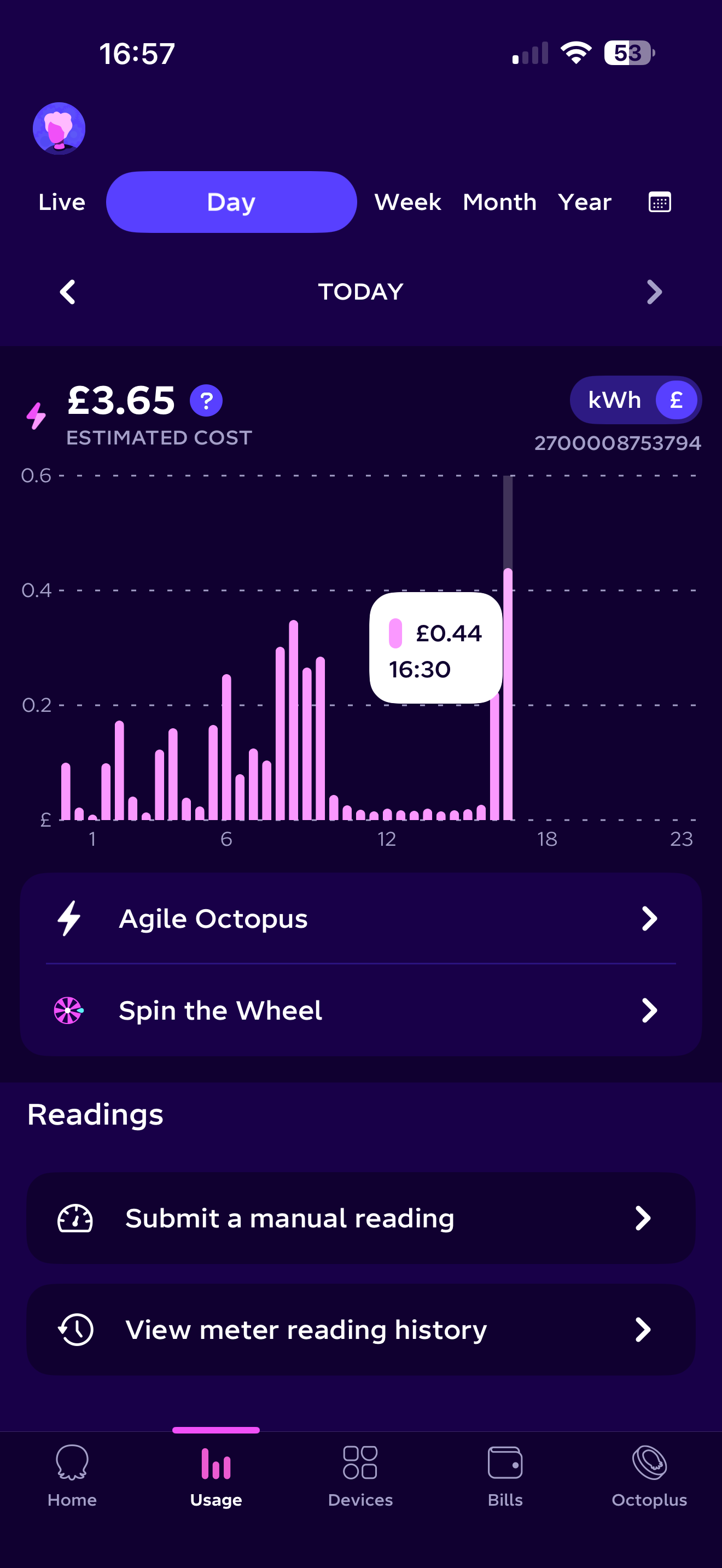

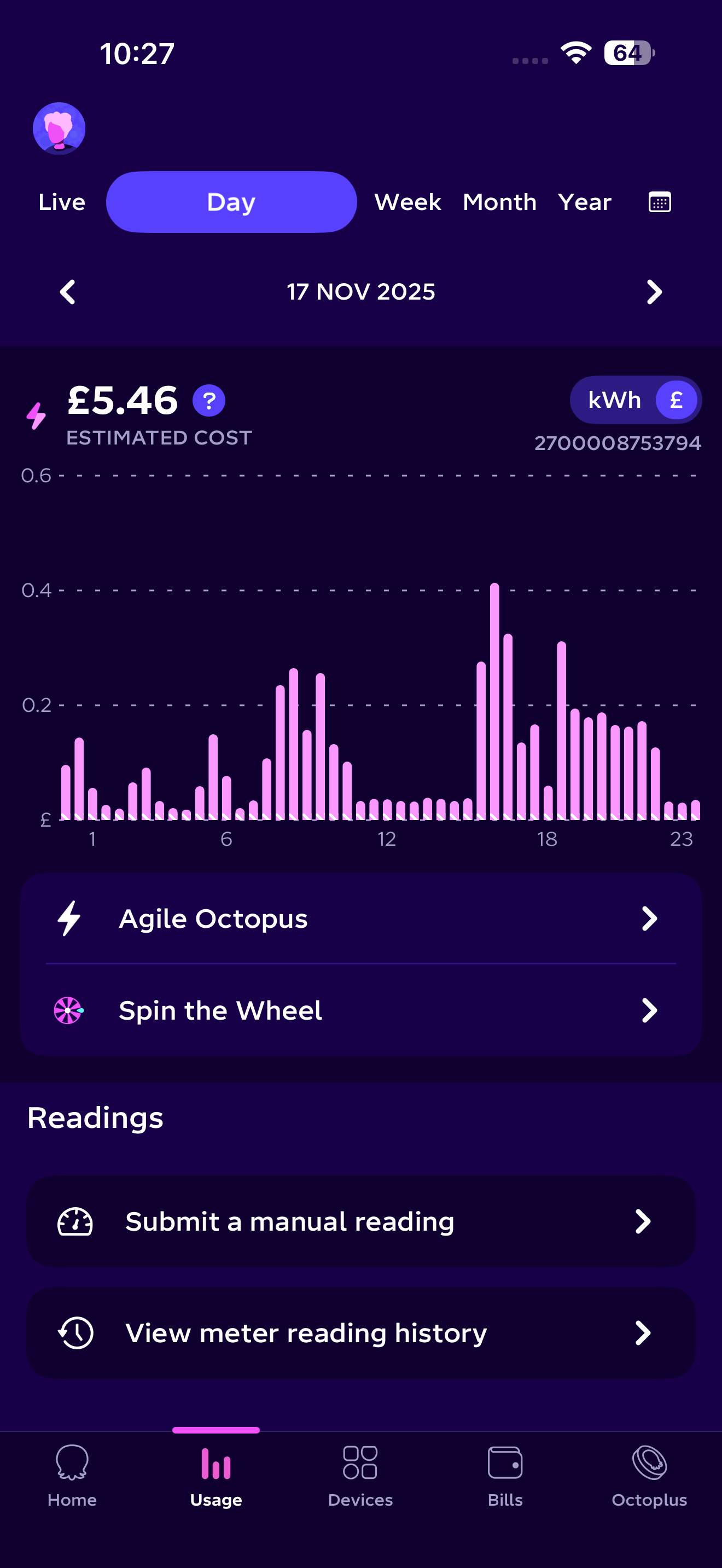

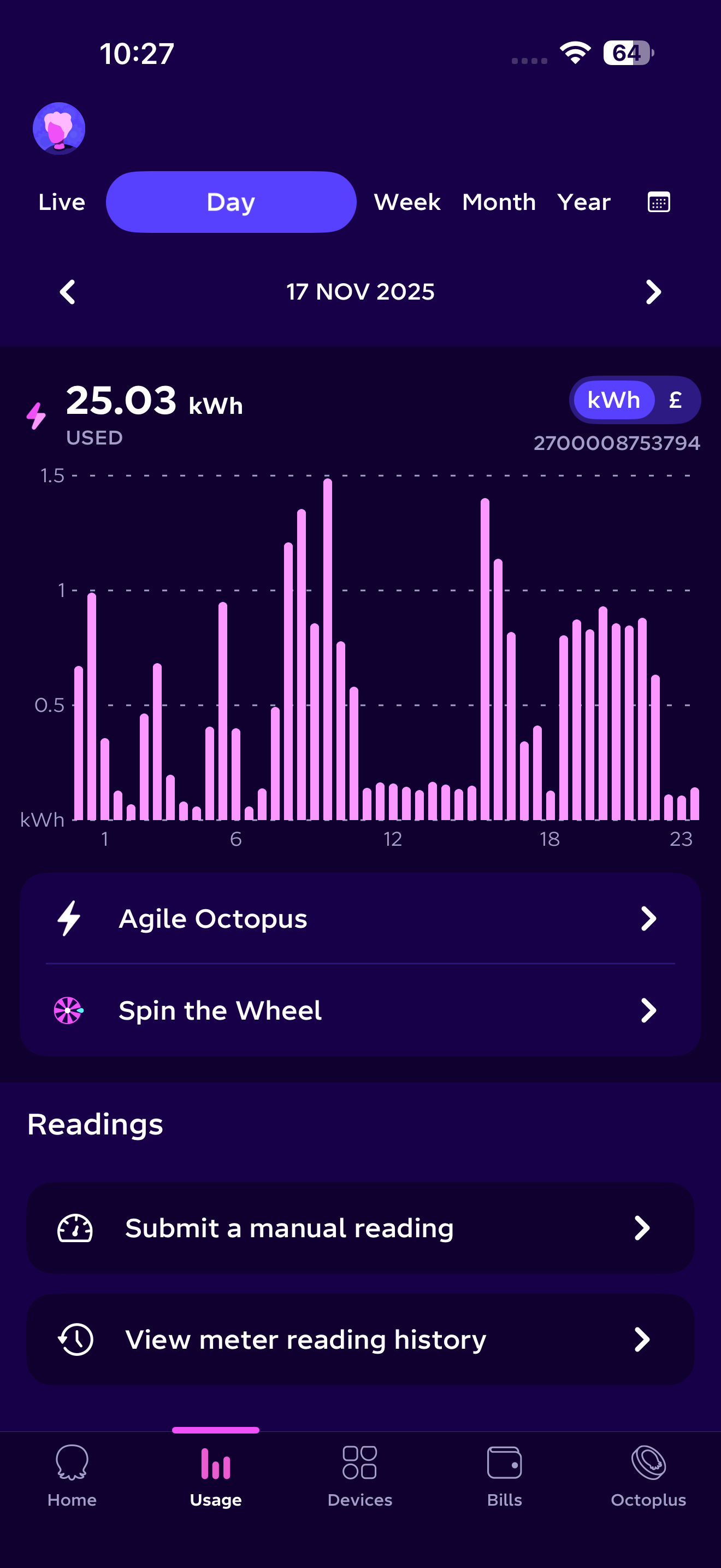

November 22, 2025Nov 22 35 minutes ago, damspt said: @Beelbeebub Hi, some graphs for the 17th. I guess i'm worrying too much? as some of you are spending more than me but it's very scary what we will end up paying. I have compared cosy tariff using the octopus compare app and agile it's still better than cosy tariff. yes we do use a fair bit at peak hours because that's when me & partner come from work and cook and shower the baby. It's annoying how they make sure we use the peak times because there is no other option do you use agile? would like to see a weekly timer setup from you If I'm honest, there doesn't seem to be much wrong with your setup. The 17th was pretty cold where I was and I assume where you were, so £5.46 all in isn't too bad. Remember this is for one of the coldest days you are likely to see. In August your per day costs were much lower but it stands to reason your heating costs will be higher in the winter! One thing that does stand out is you're using the agile tariff whilst also using lots of 4-7pm elec. Because the unit cost changes hour to hour and day to day the cost on any given day can vary wildly. For example here is the cost for the 25th Oct As you can see it was near zero in the early morning and only a few p/kwh for most of thr day with a peak of 30p 4-7 Now compare that with a few days before. At no point was the unit price below 10p but the peak was huge (off the gaph, at 60p). You could could charge an electric car up (say 75kwh) on the morning of the 25th for less than running your dishwasher after tea on the 22nd. Over a year you migbt save vs a Cosy tariff but the day to day costs will occasionally be a real shocker. For your sanity, look at the monthly or weekly costs rather than daily and try to minimise any use in thr peak eg dishwasher, washing machine. You should def make sure your heat pump is not heating hot water in that time slot unless it absolutely has to. There will be settings you can change for that. If your house doesn't lose heat too quickly you could try setting the target temp back a bit in that slot to use a bit less. Otherwise your usage seems about waht would be expected - unfortunately energy is expensive these days. Good. Luck!
November 22, 2025Nov 22 43 minutes ago, damspt said: do you use agile? would like to see a weekly timer setup from you I have solar and a battery and gas heating so I currently use old fashioned economy 7. I charge my battery overnight at 13.5p and then any elec the panels generate that isn't used in the house is exported at 15p. When the sun goes down we run off the battery until the next charge period. If it's been a bad day solar wise and we've used a lot of elec (washing etc) then we migbt use a bit of peak rate elec (30p) for a few hours in the night. My average cost per unit is about 15p and if I include my PV it"s about 2p at the moment.
November 22, 2025Nov 22 18 hours ago, damspt said: Why is your usage low between 10:00 and 3:30 are you running a set back temp during the day?

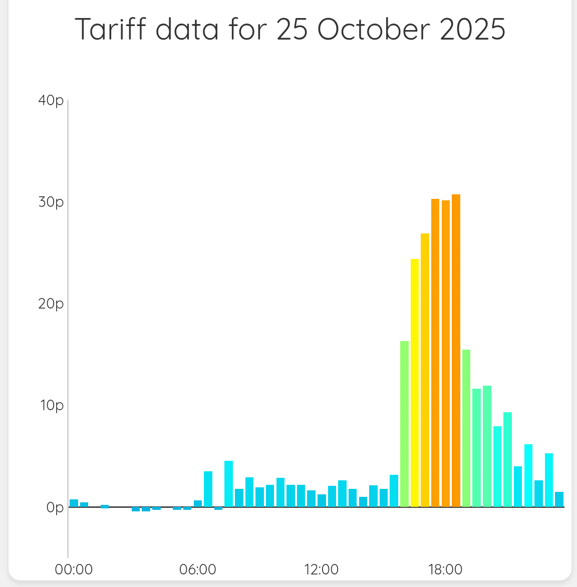

November 22, 2025Nov 22 A valid point to make here even stronger, is a Time Of Use tariff should only be used by someone who understands the different charges at different times of day (and with some tariffs they vary day to day) and then actively manages their energy use to consume as much as possible in the cheap times and as little as possible in the expensive times. If you don't do that and just "use it when convenient" I really don't think a time of use tariff is for you.

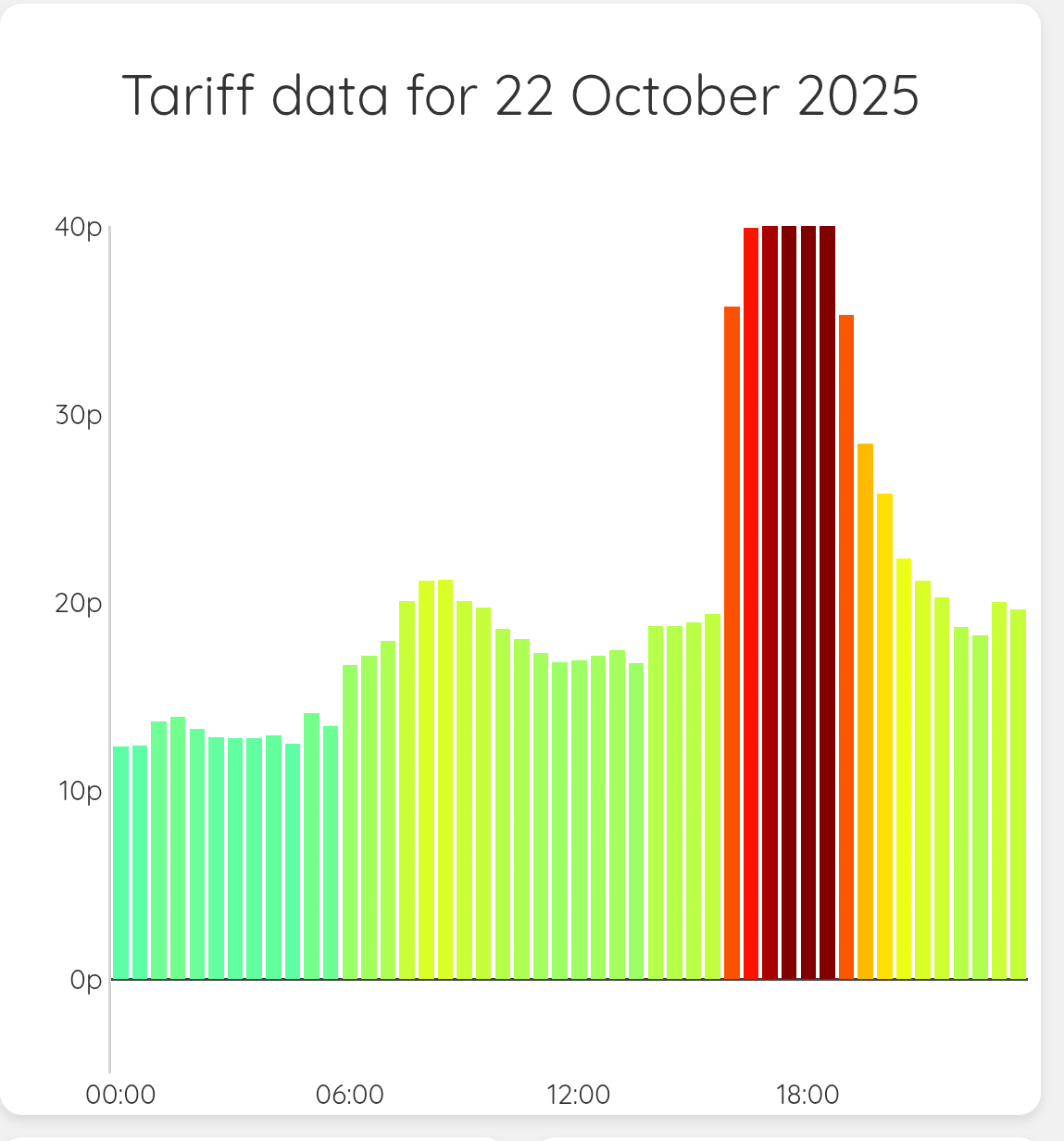

November 24, 2025Nov 24 Author On 22/11/2025 at 11:13, Beelbeebub said: If I'm honest, there doesn't seem to be much wrong with your setup. The 17th was pretty cold where I was and I assume where you were, so £5.46 all in isn't too bad. Remember this is for one of the coldest days you are likely to see. In August your per day costs were much lower but it stands to reason your heating costs will be higher in the winter! One thing that does stand out is you're using the agile tariff whilst also using lots of 4-7pm elec. Because the unit cost changes hour to hour and day to day the cost on any given day can vary wildly. For example here is the cost for the 25th Oct As you can see it was near zero in the early morning and only a few p/kwh for most of thr day with a peak of 30p 4-7 Now compare that with a few days before. At no point was the unit price below 10p but the peak was huge (off the gaph, at 60p). You could could charge an electric car up (say 75kwh) on the morning of the 25th for less than running your dishwasher after tea on the 22nd. Over a year you migbt save vs a Cosy tariff but the day to day costs will occasionally be a real shocker. For your sanity, look at the monthly or weekly costs rather than daily and try to minimise any use in thr peak eg dishwasher, washing machine. You should def make sure your heat pump is not heating hot water in that time slot unless it absolutely has to. There will be settings you can change for that. If your house doesn't lose heat too quickly you could try setting the target temp back a bit in that slot to use a bit less. Otherwise your usage seems about waht would be expected - unfortunately energy is expensive these days. Good. Luck! @Beelbeebub hi thanks for the input! i'm sure the hot water is at 2AM but still having showers at 6/7pm costs immensely! on the weekly timer do i turn off hot water between 4-7? i think i've done that before but when we were having a shower, hot water was gone after a while
November 24, 2025Nov 24 Author On 22/11/2025 at 10:48, ProDave said: I don't know your particular heat pump, but there should be a way of setting a timer so it only heats hot water at certain times, and you want to set it so that it does NOT heat the hot water between 4PM and 7PM. Then you will just be using the hot water from the tank and it won't re heat it after use until the expensive period has ended. Same could apply to heating the house, set it so it does not do that between 4PM and 7PM. See if the house keeps warm with the heating off for those 3 hours, hopefully it will. @ProDave by using the weekly timer, i've stopped the hot water running between 4-7 before but eventually when having a shower the hot water would stop on the second/third shower
November 24, 2025Nov 24 34 minutes ago, damspt said: @ProDave by using the weekly timer, i've stopped the hot water running between 4-7 before but eventually when having a shower the hot water would stop on the second/third shower Yes, of course the tank will run out of hot water if not being re heated. If you must have 3 showers all in one go and can't change the time you shower, then I really think your simplest solution is change to a different tariff that does not have that hugely expensive period when you most need it.
November 24, 2025Nov 24 17 minutes ago, ProDave said: Yes, of course the tank will run out of hot water if not being re heated. If you must have 3 showers all in one go and can't change the time you shower, then I really think your simplest solution is change to a different tariff that does not have that hugely expensive period when you most need it. Or 1. heat the water to a higher temperature in the cheapest period 2. Change the tank for one with a larger capacity

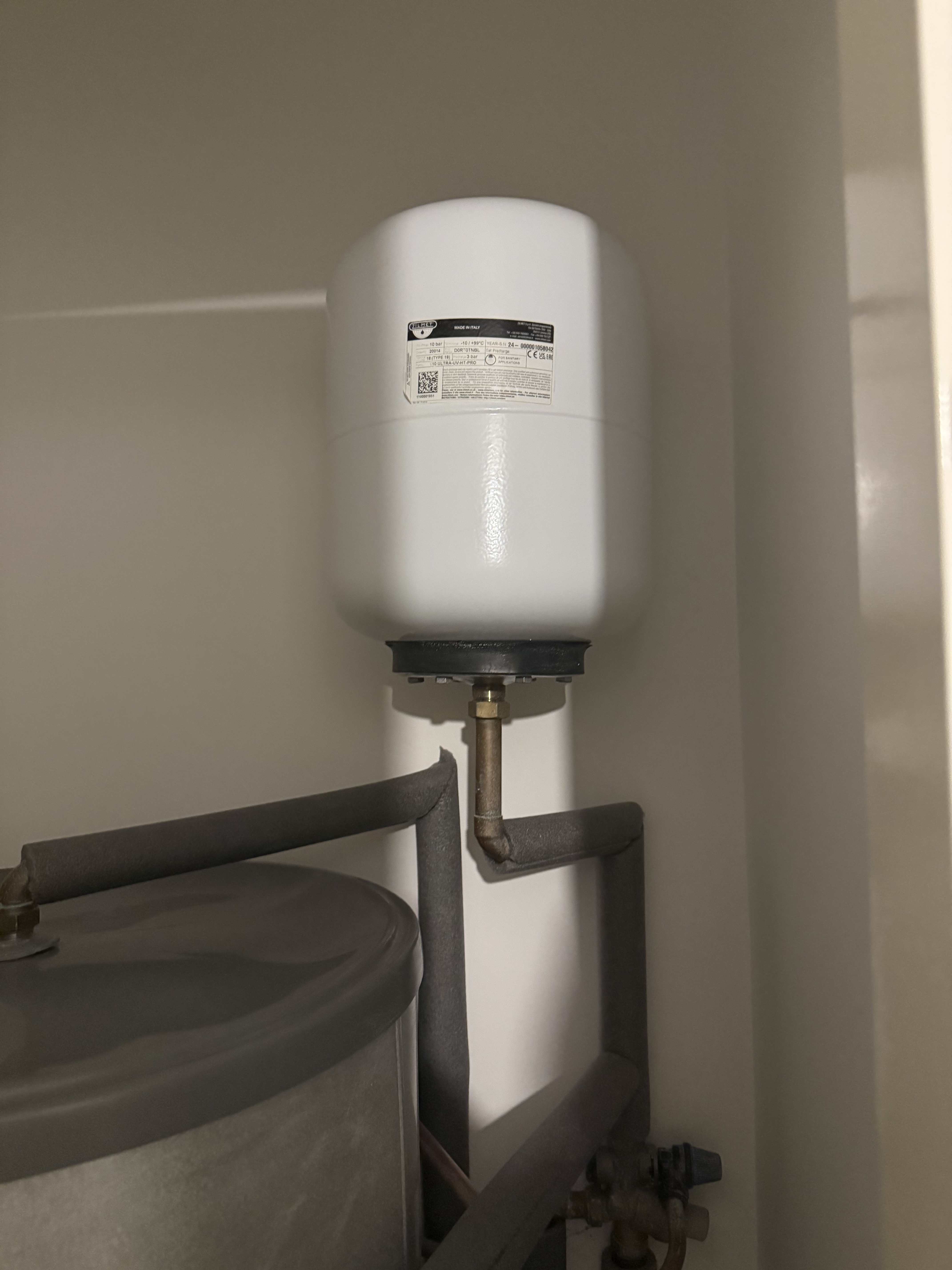

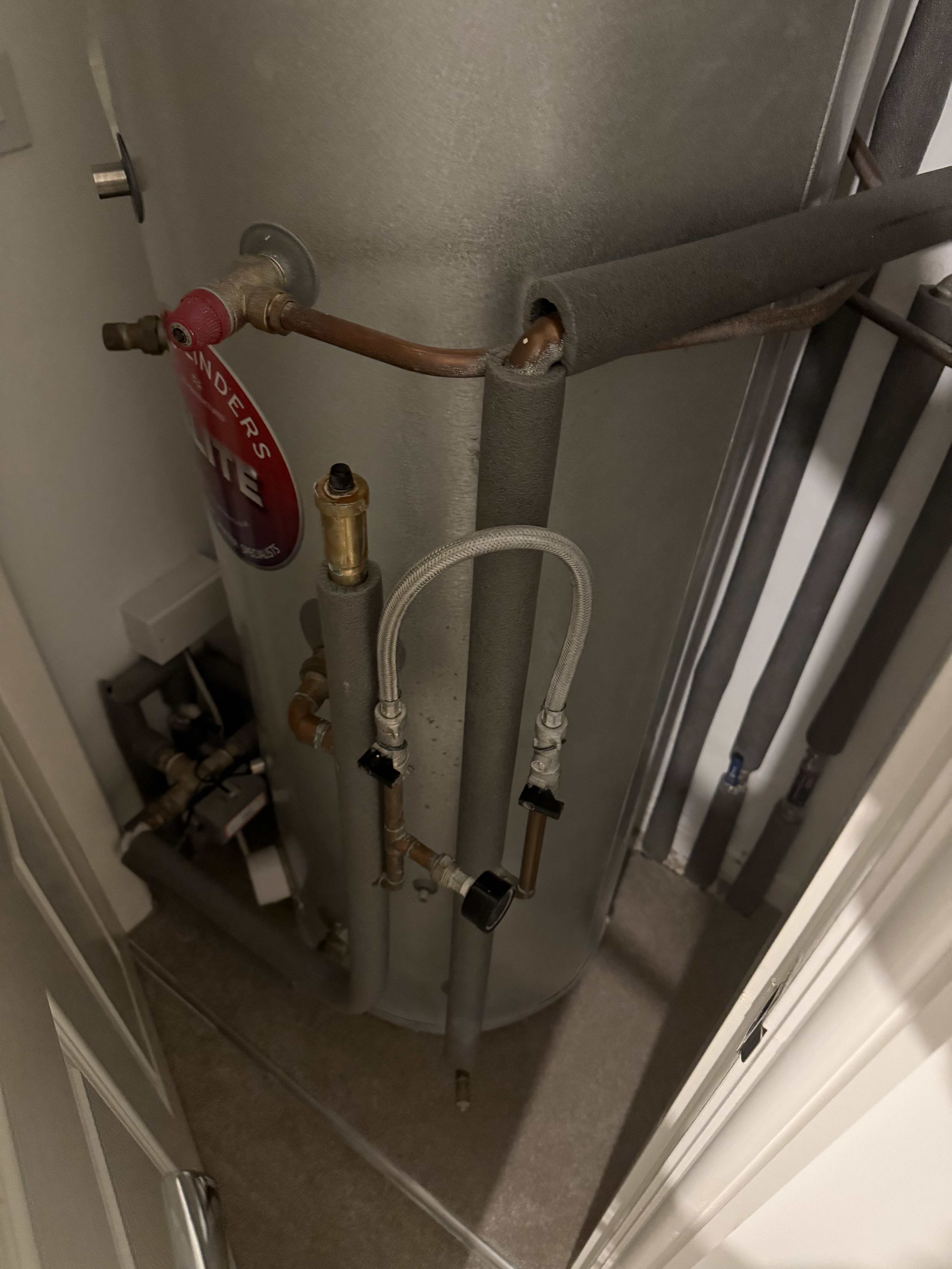

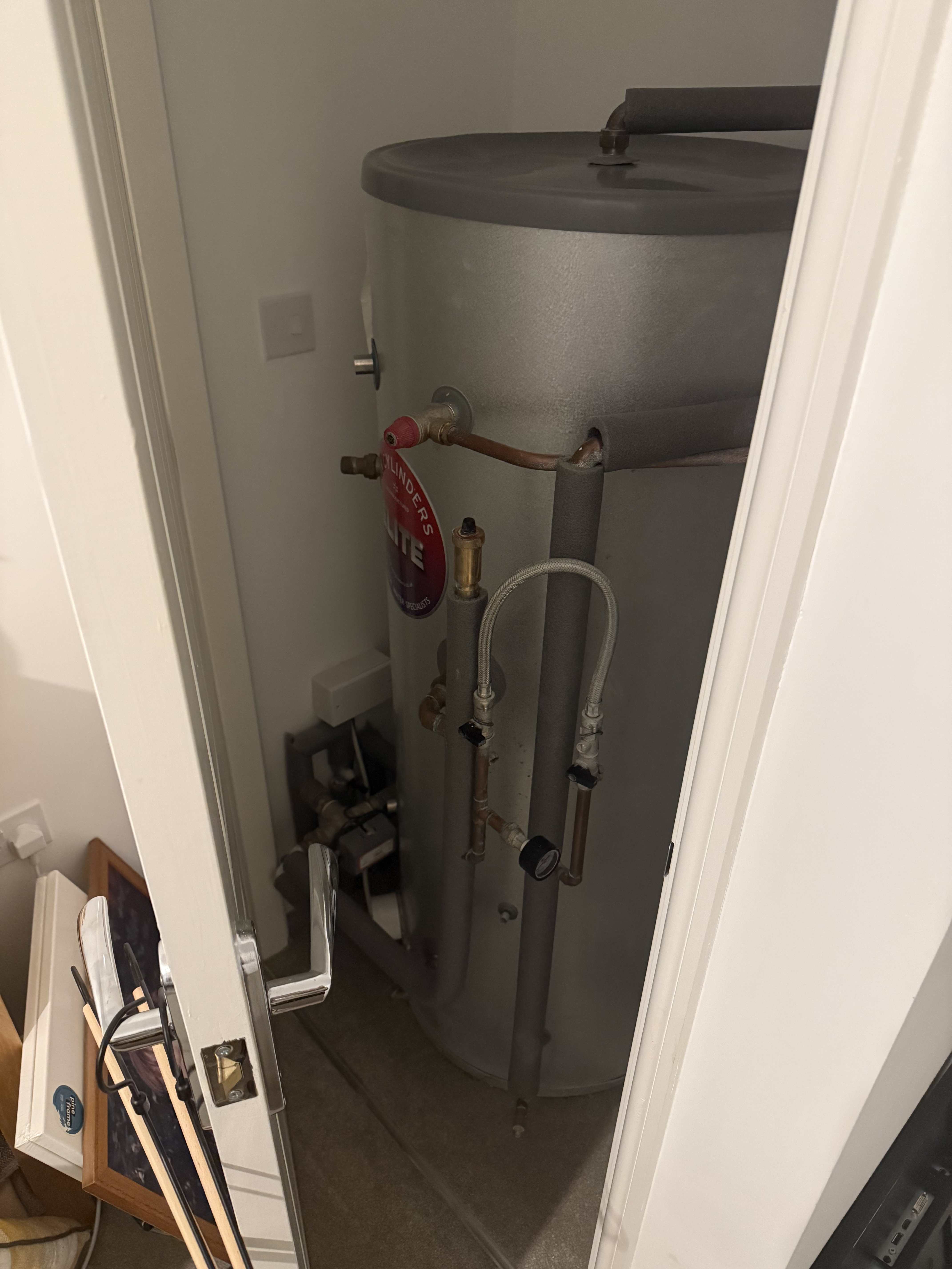

November 24, 2025Nov 24 1 hour ago, damspt said: this is my setup So no buffer which is good. But insulation around the cylinder is rubbish, can you take a photo of behind the heat pump where the pipes are and show how it's been insulated? On 22/11/2025 at 13:05, JohnMo said: You say you have a thermostat in the living room is this actually doing anything? But you didn't answer this question?

November 24, 2025Nov 24 @damspt That looks like a decent sized tank - has it got a declared capacity on the side label? I'm struggling to understand how 3 showers exhaust the HW - we can have up to 4 showers per day from a tank that is 115L and only heated once a day to ~50 deg C Have you got a HW circulation loop running? A loop that ensures HW is avaliable instantly at the taps without running lots of water first - they can be horribly parasitic in terms of depleting available HW if they aren't minimised to "TOU" (Time of use)
