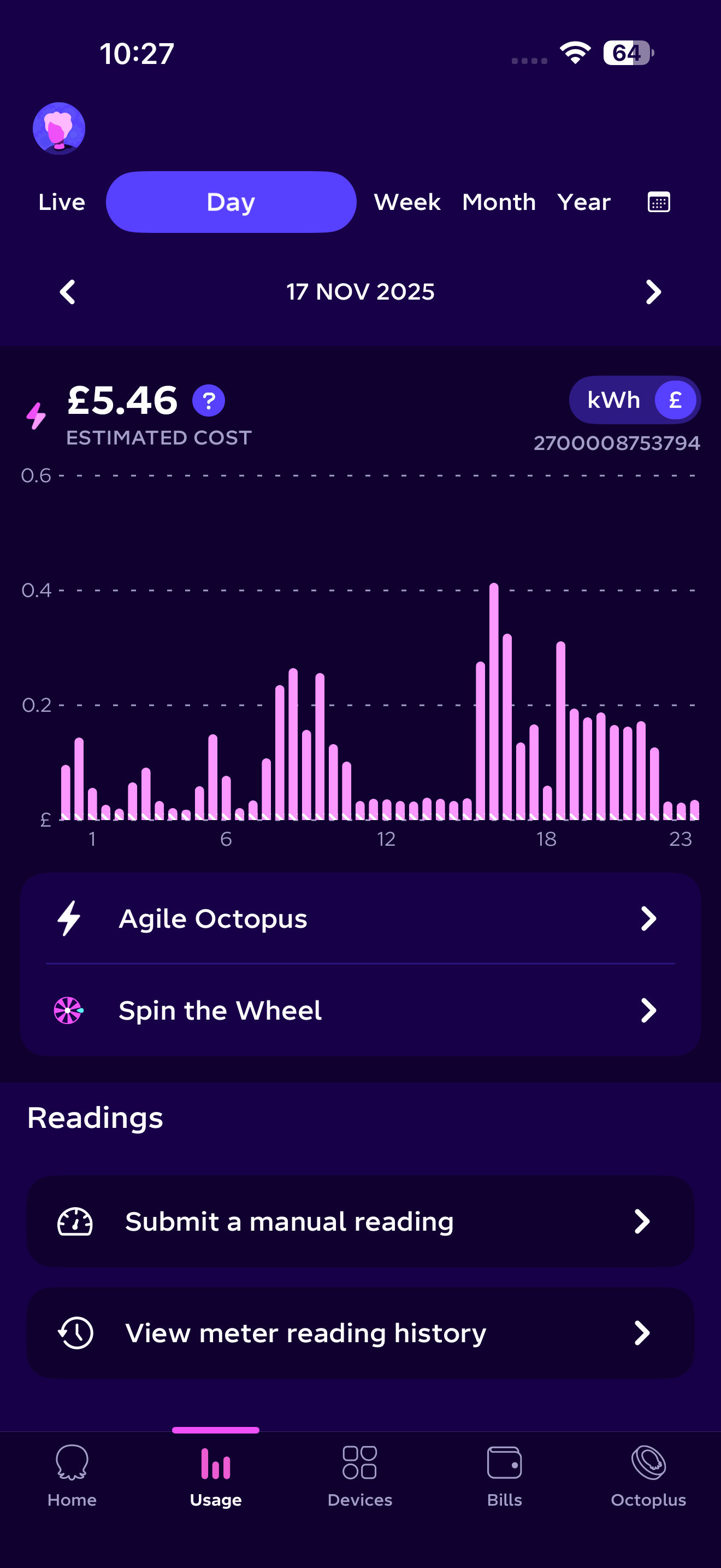

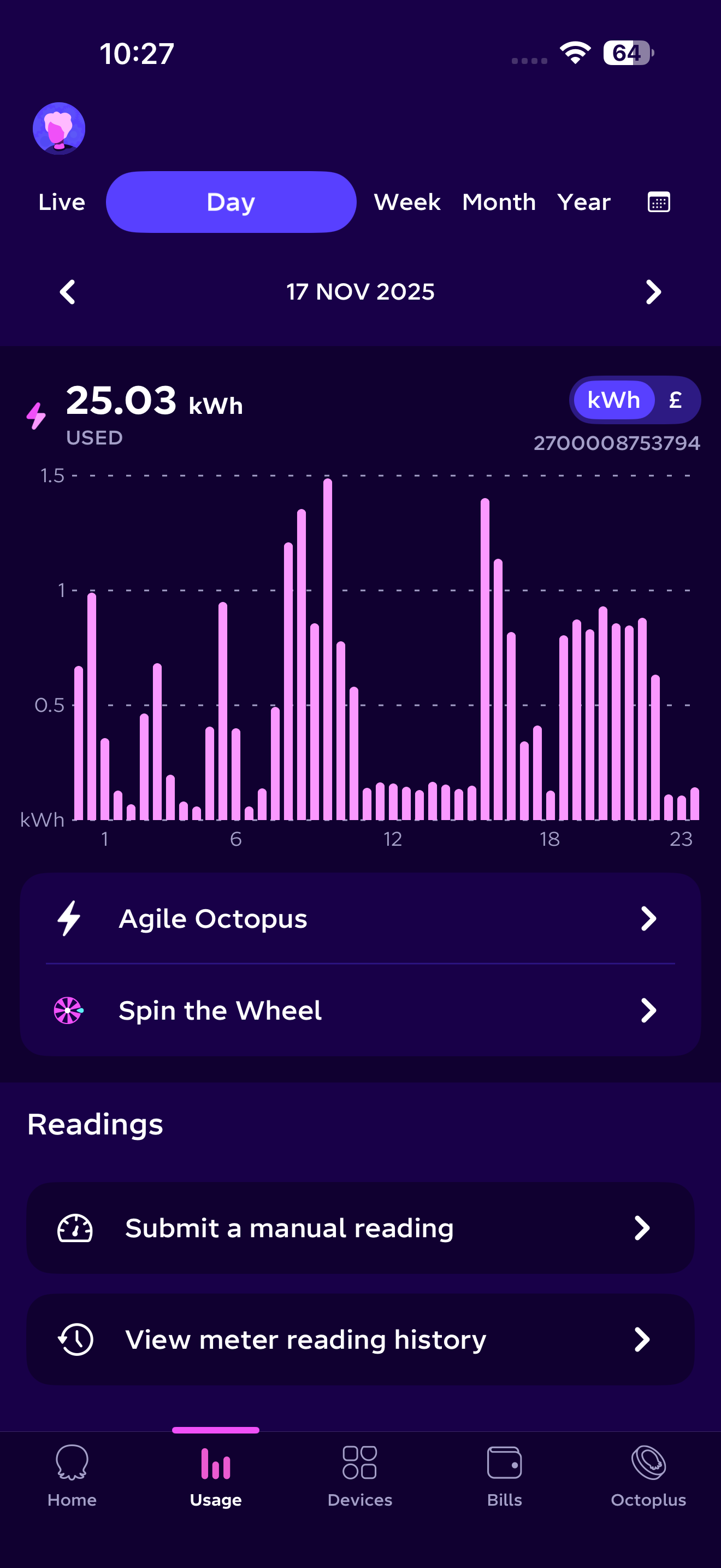

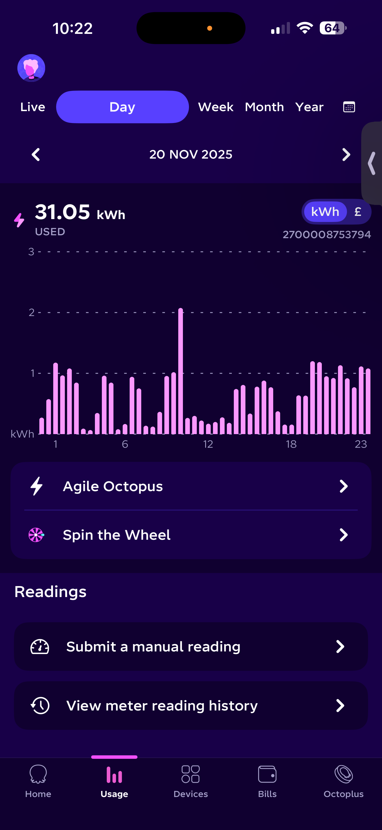

If you used 31kwh yesterday (20th) that's pretty good.
The 20th was pretty cold (dunno where you are but it was sub zero across the Midlands).
If we assume your house uses something like 6kwh a day for non heating stuff like fridges and lights, then you used 24kwh in a day, basically 1kw continuous heating load.
If we assume a cop of about 2.5, that's a heat demand of around 2.5kwh. Not unreasonable for a house kept at 22-24C during a subs zero cold snap.
If I read your graphs correctly on the 20th you used 31kwh and paid £6.52. That's 21p per kwh.
Coukd you post some pairs of graphs for the kwh in a given day, then the £for the same day.  I suspect you are losing out by using some energy during the agile peak period.  You could save a fair bit by making sure your hot water heating doesn't occur then and also maybe turning your heating off for those hours.
Agile is best used with some sort of automatic system that adapts your use to the variable daily price curves.
You migbt get a better price using Cosy.
@Beelbeebub Hi, some graphs for the 17th. I guess i'm worrying too much? as some of you are spending more than me but it's very scary what we will end up paying. I have compared cosy tariff using the octopus compare app and agile it's still better than cosy tariff.
yes we do use a fair bit at peak hours because that's when me & partner come from work and cook and shower the baby. It's annoying how they make sure we use the peak times because there is no other option
do you use agile? would like to see a weekly timer setup from you
