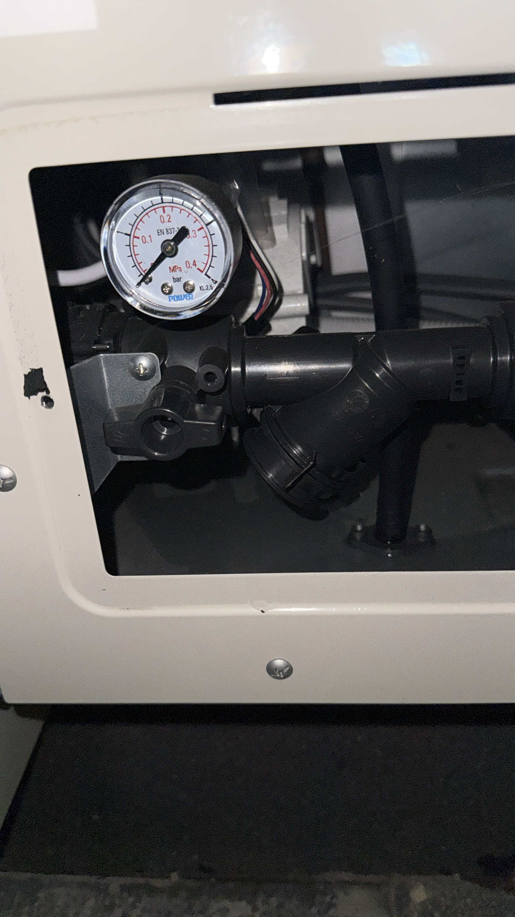

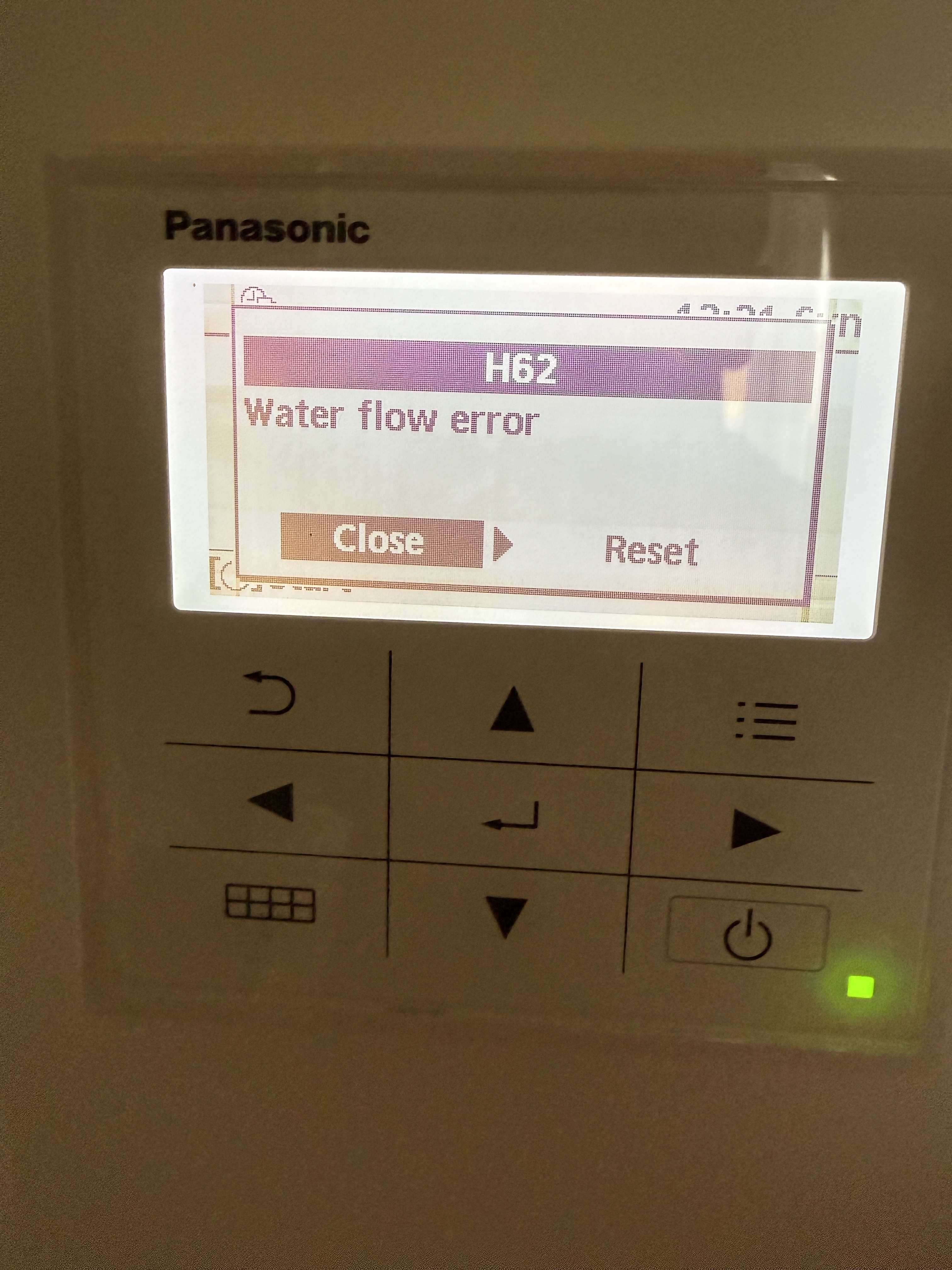

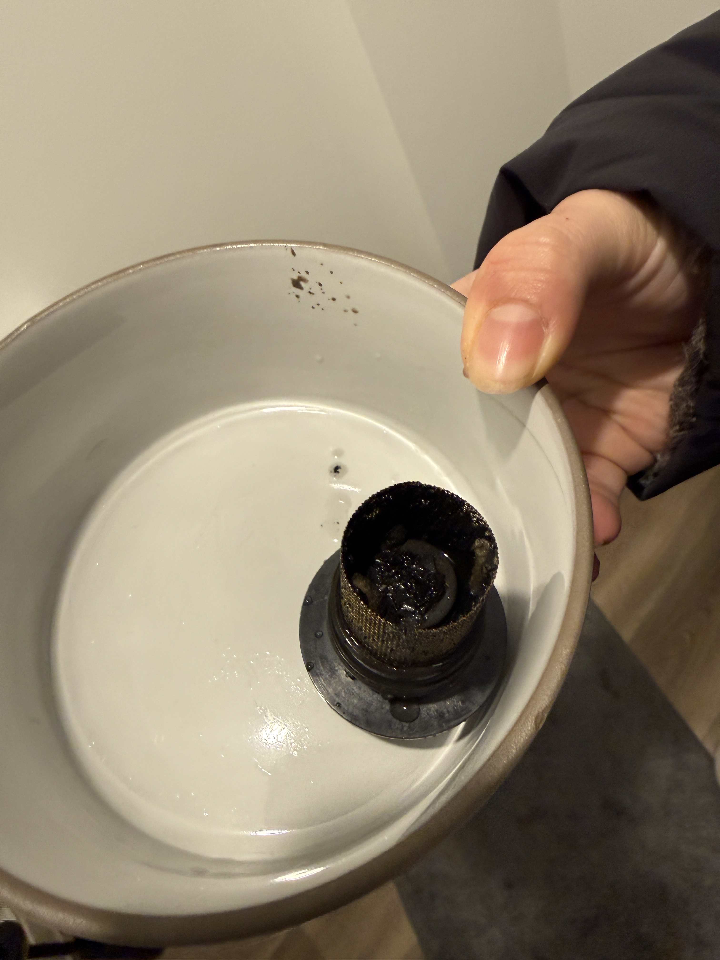

January 26Jan 26 Author @JohnMo Hi everyone, I completely forgot about this topic as eventually I saw that many people were spending much more money than me, I'm only spending between £100 and £150 in this weather while I see people spending over £200/£300 which is crazy. I have a new issue, this H20 and H62 error came up yesterday and house has been cold and no hot water, I need to shower my son asap. I've cleaned the filter as seen in the picture but still not working. Radiators have been bleeded, some of them no hissing and no water coming off. What else should I do? Please help
January 26Jan 26 Your system has lost it's water pressure. One of the plumbers will be along to tell you how to top it up. In the mean time post as much as you can of the plumbing around the system particularly anything with something resembling a valve etc.
January 26Jan 26 1 minute ago, damspt said: house has been cold and no hot water, I need to shower my son asap. Flick on the immersion for hot water. Looking at the state of the filter/strainer, your system is full of crap. If you have zero pressure in system it will not bleed. But top-up water to get around 1 bar on the gauge you show. Then switch off power to heat pump, this maybe needed to reset the error code. Switch on and see if cleared. If so it should start up. If pressure has dropped again tomorrow you may either have a leak or you heat system expansion vessel has failed.

January 26Jan 26 On 24/11/2025 at 09:35, damspt said: This looks like your fill loop. If that is a pressure gauge there, open the two black valves at the end of the silver hose looking thing until the gauge reads about 1.5 bar then close them. Then try resetting the fault on the HP control panel
January 26Jan 26 Author 1 minute ago, JohnMo said: Flick on the immersion for hot water. Looking at the state of the filter/strainer, your system is full of crap. If you have zero pressure in system it will not bleed. But top-up water to get around 1 bar on the gauge you show. Then switch off power to heat pump, this maybe needed to reset the error code. Switch on and see if cleared. If so it should start up. If pressure has dropped again tomorrow you may either have a leak or you heat system expansion vessel has failed. Thank you for the quick reply, currently working a night shift. Will try tomorrow. Before I left home, i've turned the switch which i think it's the immersion for hot water but radiators were still very cold althought the live usage on octopus app was showing more than 4000w, so I told wife to turn it off since it's not warming up the house. When she turn the switch off, she said something sparked around the switch, so not sure. I am not sure which one I need to turn to top-up water, tomorrow will take a couple pictures. When saying "switch off power to heat pump" do I actually turn it off in the meter box or just turn it off in the thermostat?
January 26Jan 26 Author 3 minutes ago, ProDave said: This looks like your fill loop. If that is a pressure gauge there, open the two black valves at the end of the silver hose looking thing until the gauge reads about 1.5 bar then close them. Then try resetting the fault on the HP control panel Both valves? okey dokey, will try tomorrow! Damn, I love this forum. People are so kind and helpful, unfortunately I'm not skilled enough in any of these topics as I would love to help people like this
January 26Jan 26 9 hours ago, damspt said: When saying "switch off power to heat pump" do I actually turn it off in the meter box or just turn it off in the thermostat Turn off the isolation switch outside by heat pump. Leave it off for a couple of seconds and switch back on. Or if the controller is on its own power supply, switch that off and on again. Doing both will not hurt anything. 9 hours ago, damspt said: octopus app was showing more than 4000w Makes sense, immersion are generally 3kW so that plus any other loads in the house.

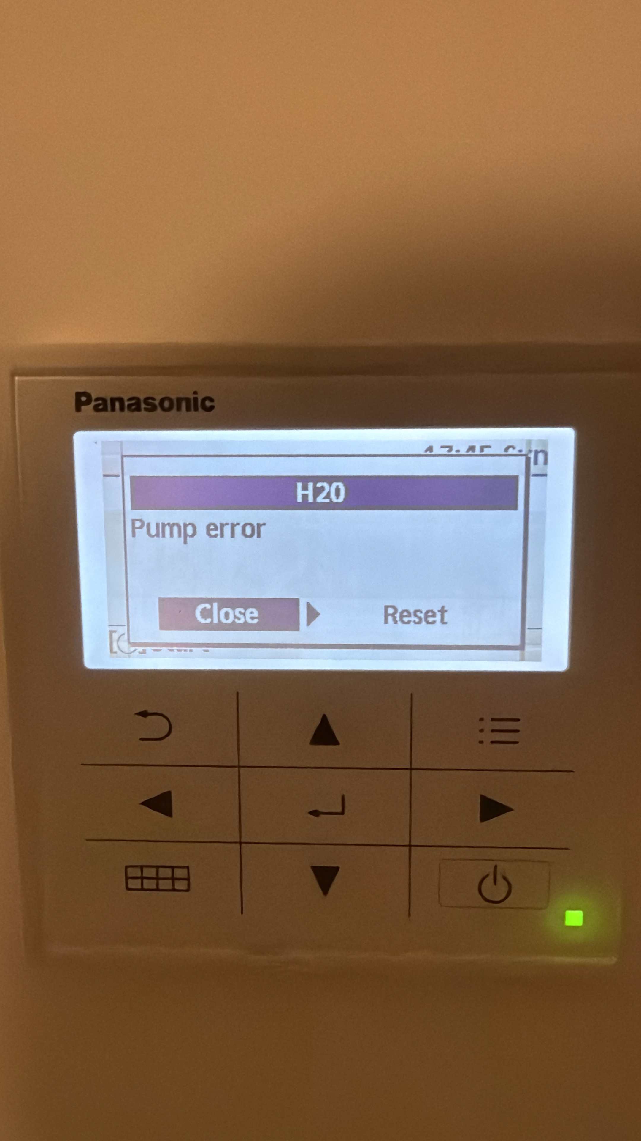

January 27Jan 27 Author @JohnMo turn both valves and let pressure went up to 1.5 as you can see in pic and reset the system. still showing same error h20.
January 27Jan 27 18 hours ago, damspt said: Radiators have been bleeded, some of them no hissing and no water coming off Did you finish this after topping up system pressure?
January 27Jan 27 Author 35 minutes ago, JohnMo said: Did you finish this after topping up system pressure? yes, wife did yesterday but I just did it again after you mentioned and upstairs they all hissed and came out water which is good i guess. Downstairs they didn't hiss but water came off. I've done a reset once again but still same error code.
January 27Jan 27 To keep hot water available switch the immersion on and leave it on. It may not heat the whole cylinder but should give you enough for a single shower. Wait half an hour between showers and you'll all get one. Borrow a couple if electric fan heaters and use those to heat the house while the heat pump is off. For the heat pump fault if youve already cleaned and replaced the blocked strainer and repressurised the system, switch the power off using the switch by the pump and leave it off for a couple of minutes. Switch the power back on and see how things are.
January 28Jan 28 Does the other pressure gauge also show pressure? Pump error sounds more like it could either have broken or have something lodged in it? Wherever your pump lives, it will have a screw (big) on the front of it which can be undone to remove any debris. Also make sure it has power and its at least trying to work. Example pump showing the screw
January 28Jan 28 Author update: plumber came this morning and the little pump inside the outside unit has been replaced and it's now working. unfortunately it was wife that was home to attend and i didn't had the chance to see how to replace and where to buy a new pump in case this happens again
January 28Jan 28 15 minutes ago, damspt said: update: plumber came this morning and the little pump inside the outside unit has been replaced and it's now working. unfortunately it was wife that was home to attend and i didn't had the chance to see how to replace and where to buy a new pump in case this happens again Pumps usually last a minimum of 10 years in a typical household, often much longer. Good to hear it’s sorted, but how old was the pump they replaced? Did they leave the old one there, and did they offer an explanation as to why they thought the old one had failed?
