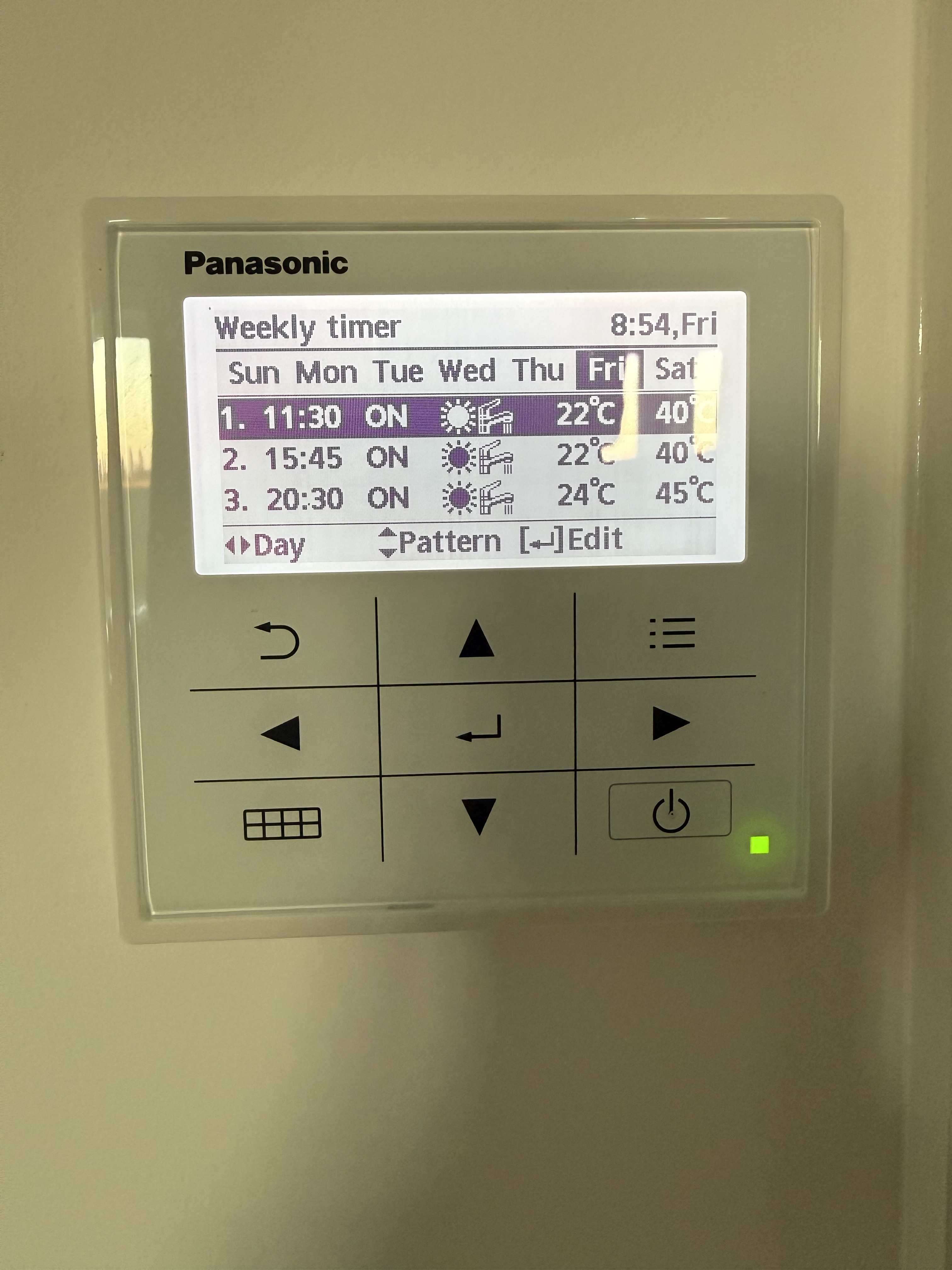

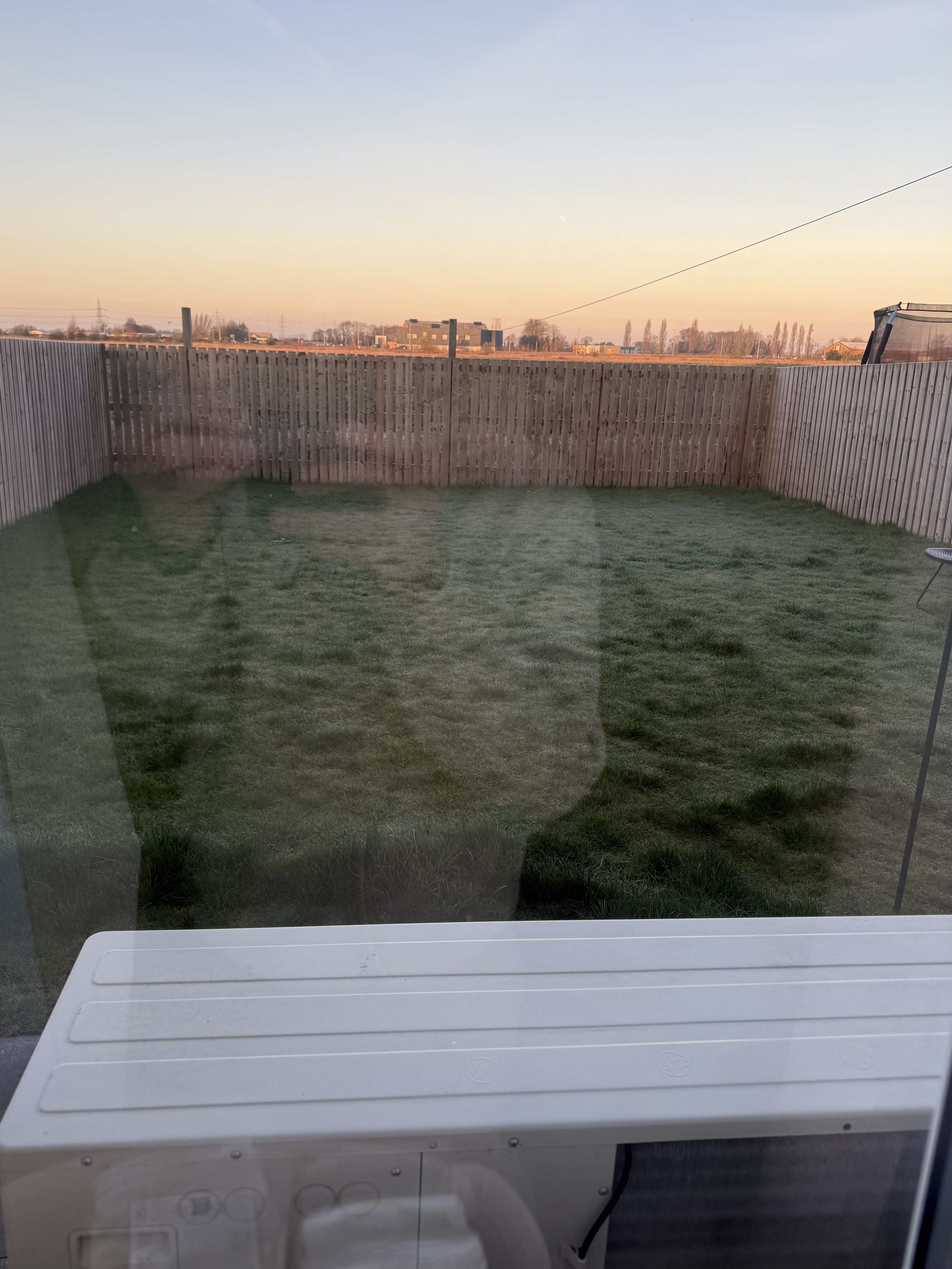

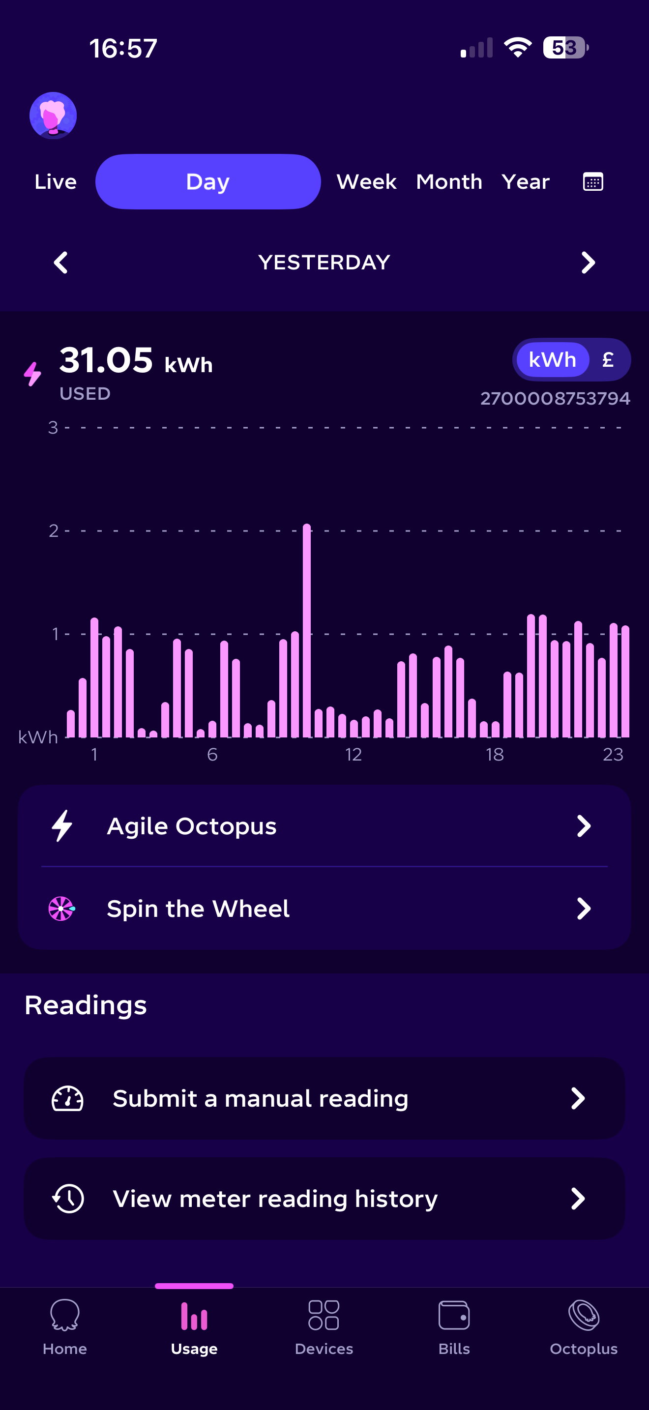

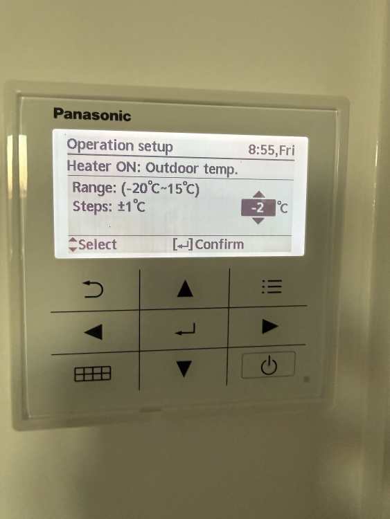

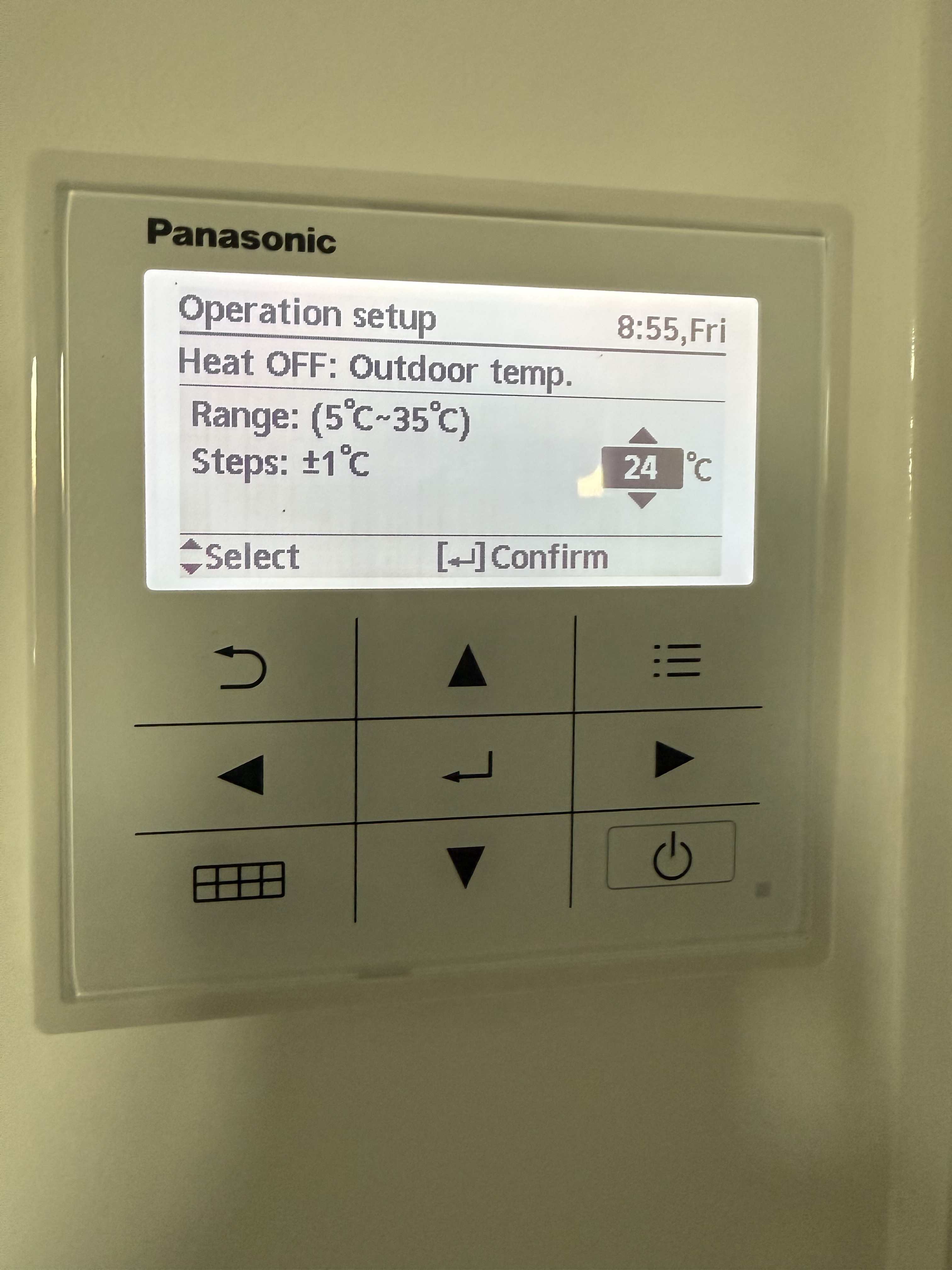

damspt Posted November 21, 2025 Posted November 21, 2025 Model: Panasonic WH-MDC05J3E5 Octopus Agile Tariff Hi everyone, urgently need help as I can’t keep up with the costs at the moment🤦🏻♂️ I have attached some screenshots and pictures what might be important to know My heat pump is in the back garden which is an open field after my fences

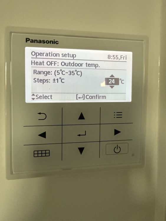

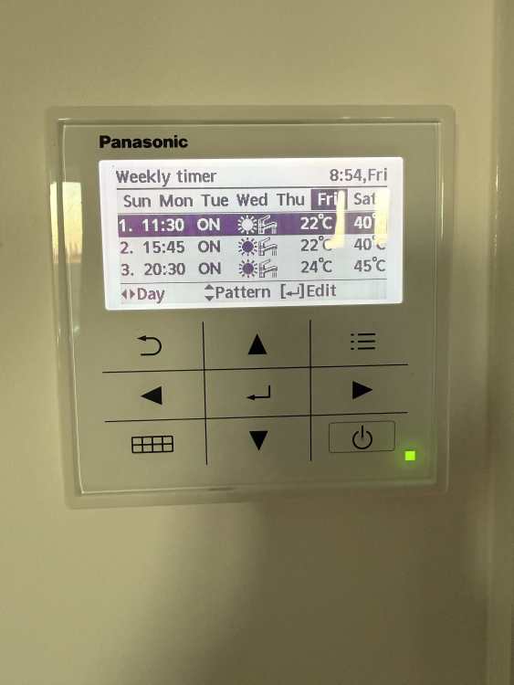

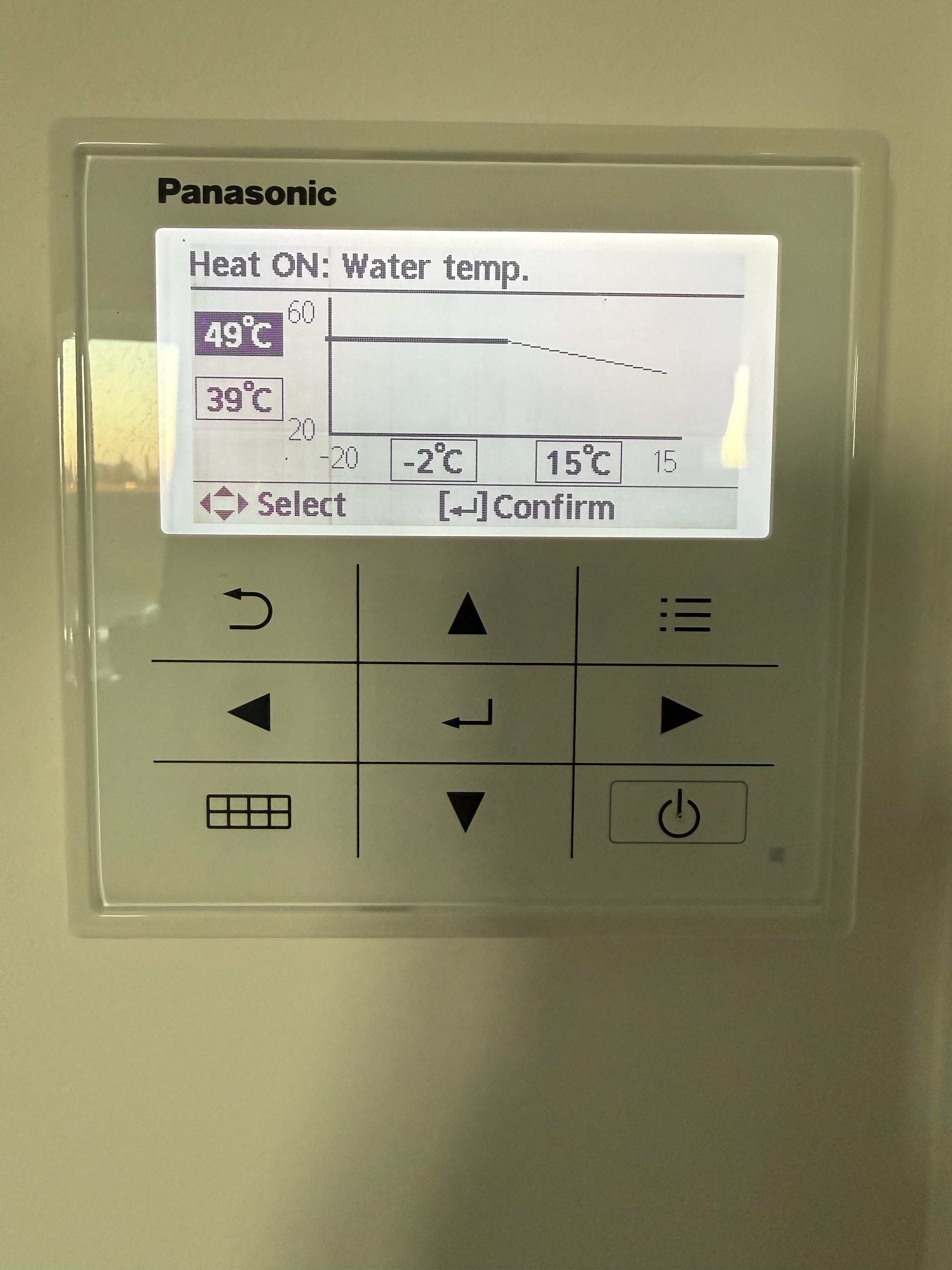

damspt Posted November 21, 2025 Author Posted November 21, 2025 I’ve attached weather compensation curve and weekly timer!
JohnMo Posted November 21, 2025 Posted November 21, 2025 Are you on the correct tariff would be my first question. If you have a battery maybe, without suspect not. Do you have a timer for DHW or is that for CH as well?
Bonner Posted November 21, 2025 Posted November 21, 2025 All depends on your insulation and air tightnesses levels but £6/day during this cold snap does not seem unreasonable, especially with 22/24 degree set points. My set points are 18/20 degrees but I do have a wood burner for the evenings. Do you have UFH, charging it when rates are low (overnight)?

Nickfromwales Posted November 21, 2025 Posted November 21, 2025 Are you using the heat pump to do hot water in this bitter cold snap? If so, your unit will hate you for it as it’ll be frosting and defrosting a bunch on low grade heat but will be much more of an efficiency killer when heating hot water. Try 48 hrs topping up with the immersion ( in off peak windows ) and see if that improves things. Also how long is the heat pump taking to recharge hot water? If it’s a long period then the house will start to cool down making the job of maintaining comfort temps even harder.

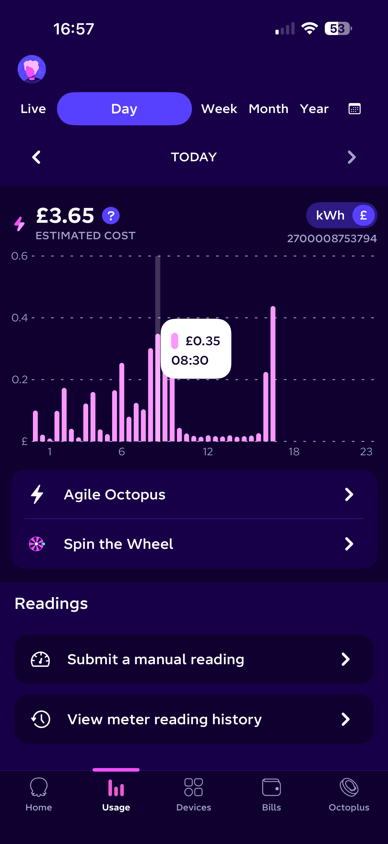

Beelbeebub Posted November 21, 2025 Posted November 21, 2025 Could the Op post the kwh usage graph from. Octopus. Thry say they are on agile which has a massive spike between 4-7pm (eg today 21st Nov it's neatly 50p/kwh) Agile is for people with a battery (mostly) For a HP you need a Cosy tariff.

JamesPa Posted November 21, 2025 Posted November 21, 2025 (edited) 24 minutes ago, canalsiderenovation said: We are on Cosy so heat hot water and UFH during those times. I have never understood how Cosy is a good fit to a heat pump unless you also have a battery. Sure you get cheap leccy for a few hours per day, but at relatively poor COP because you are trying to get the same amount of energy into the UFH in one third of the time, so have to jack up the flow temperature (49C for UFH apparently, I'm running at only 43 on radiators). Obviously you also need a heat pump which is a factor of 3 oversized. However, that notwithstanding (almost) everything above, is also true. Its very cold at present so consumptio9n is at its max, (as it would be with any heating but who monitors gas or oil daily?) If you have only just switched it on you have got a lot of making up to do. It might be best to just monitor it for a few weeks and see how its averaging. Also consider whether cosy plus jacked up flow temp is more cost effective than a different tariff plus running the UFH at a more typical 30-35C flow temp. What COP is your heat pump reporting? Edited November 21, 2025 by JamesPa

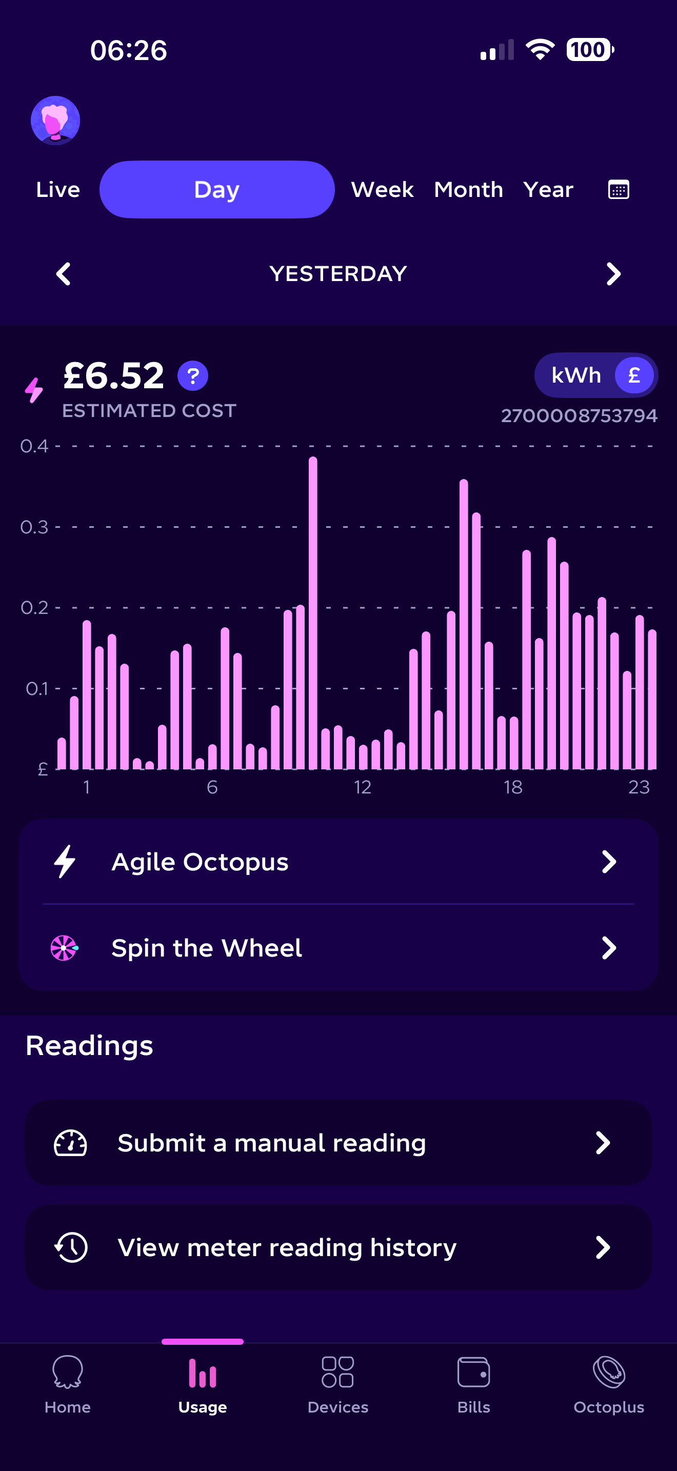

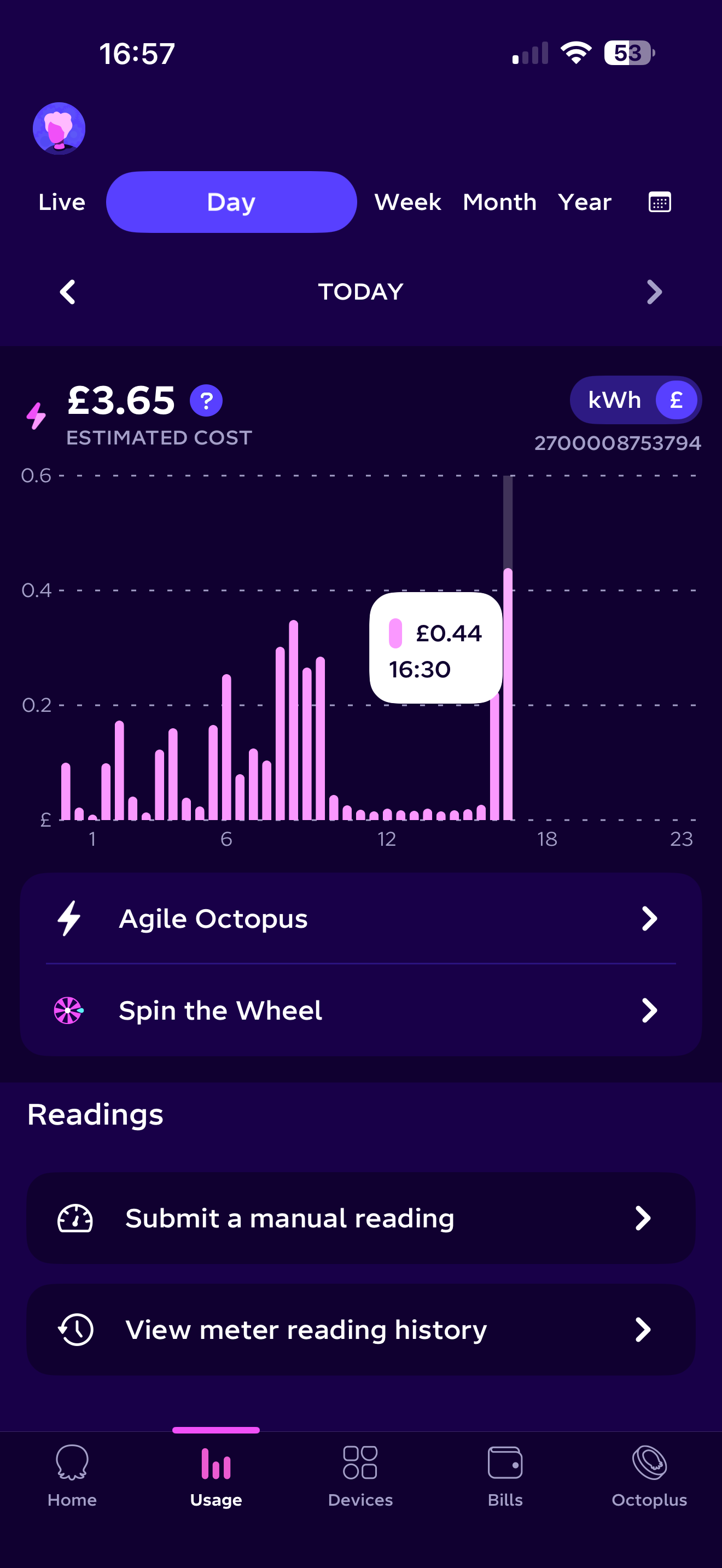

damspt Posted November 21, 2025 Author Posted November 21, 2025 Hi everyone, I’m trying to reply individually. I have contacted customer service and they are trying to help me out as for some reason I can’t reply to anyone. Below, i added a screenshot from yesterday’s kWh usage. And screenshots from today’s 8:30am when i wasn’t even home and a screenshot from 16:30 for a quick shower for my two year old son. I’ve noticed that it’s been since Monday (17/11) that we have been using a lot of electricity, I’m not sure if it’s a coincidence but our new fridge came on that day ( same as the previous one but had to be changed due to a fault ) My house is a new build that was build in 2024 and i moved in this year in February. It’s a 3 bedroom house

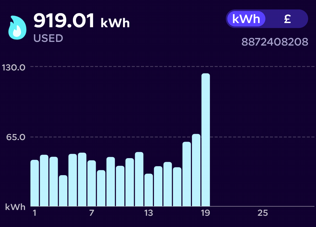

Beelbeebub Posted November 21, 2025 Posted November 21, 2025 Just for perspective our gas heating has shot up during this cold snap (shock!) We were sub 50kwh a day then the cold snap hit and we are more like 100kwh plus - and that's with a log burner going to take the edge off things.
Beelbeebub Posted November 21, 2025 Posted November 21, 2025 If you used 31kwh yesterday (20th) that's pretty good. The 20th was pretty cold (dunno where you are but it was sub zero across the Midlands). If we assume your house uses something like 6kwh a day for non heating stuff like fridges and lights, then you used 24kwh in a day, basically 1kw continuous heating load. If we assume a cop of about 2.5, that's a heat demand of around 2.5kwh. Not unreasonable for a house kept at 22-24C during a subs zero cold snap. If I read your graphs correctly on the 20th you used 31kwh and paid £6.52. That's 21p per kwh. Coukd you post some pairs of graphs for the kwh in a given day, then the £for the same day. I suspect you are losing out by using some energy during the agile peak period. You could save a fair bit by making sure your hot water heating doesn't occur then and also maybe turning your heating off for those hours. Agile is best used with some sort of automatic system that adapts your use to the variable daily price curves. You migbt get a better price using Cosy.
JohnMo Posted November 21, 2025 Posted November 21, 2025 (edited) Not sure why you think the electric consumption is high. Assume you are all electric etc. Our house seems to use about 20kWh without the heat pump. Edited November 21, 2025 by JohnMo
