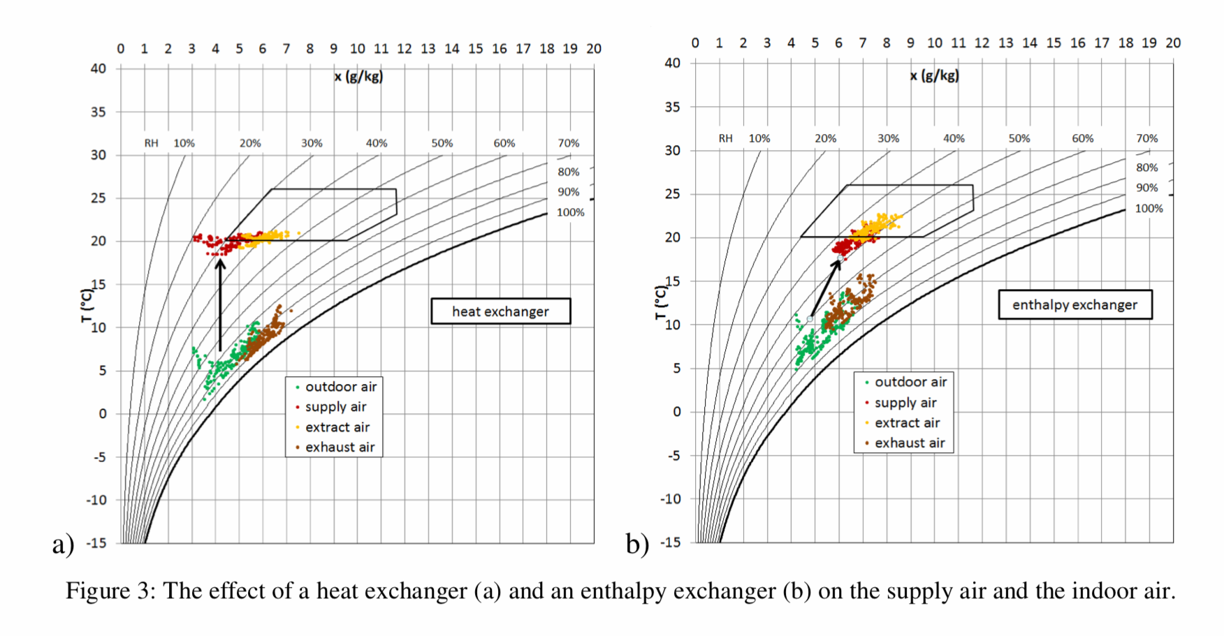

Nick Laslett Posted 21 hours ago Posted 21 hours ago (edited) Here is some more material for anyone that is interested. A short paper by Zehnder comparing an ERV & HRV in the same house in Rotterdam over two consecutive 8 day periods during winter. Doesn’t seem particularly rigorous or compelling, but does confirm the humidity is 10% higher with ERV with colder weather. https://www.zehnder-systems.ch/fileadmin/user_upload/CH/HUB/Mythen_und_Legenden/the_effect_of_enthalpy_recovery_ventilation_on_the_residential_indoor_climate_-_aivc2014.pdf.pdf Edited 21 hours ago by Nick Laslett

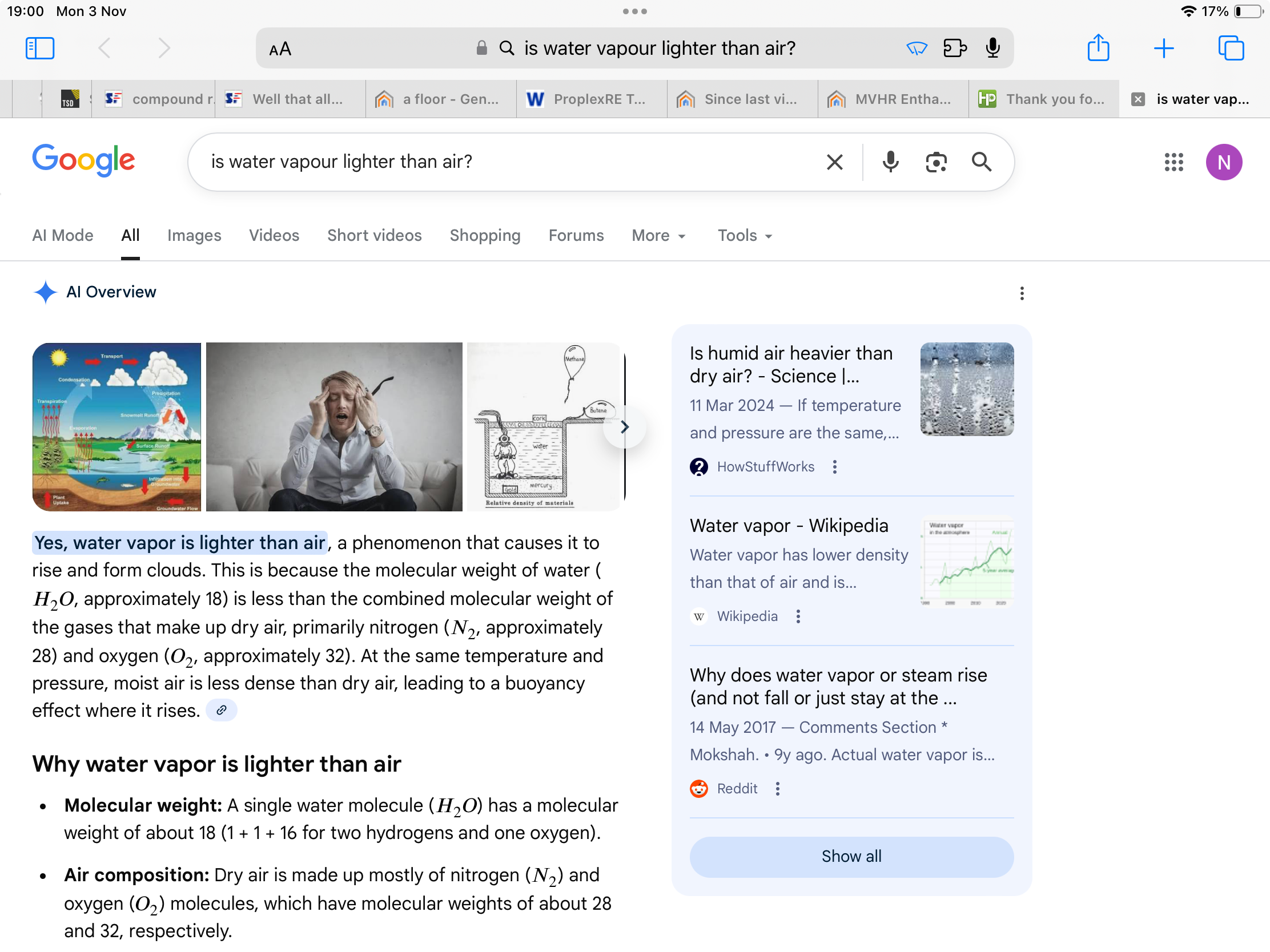

Nick Laslett Posted 20 hours ago Posted 20 hours ago (edited) 9 hours ago, LnP said: I stopped reading at the point where Patrick, describing how the membrane works, said that water vapour is lighter than air and this is why clouds float in the sky 🤣. Maybe I’m wrong, but isn’t water vapour lighter than air? ChatGPT, Gemini, and Grok all seem to think so? Science is not my strong point, so easily confused by these topics. I appreciate our A.I. Overlords can’t be trusted, but I do live in hope. Edited 20 hours ago by Nick Laslett
