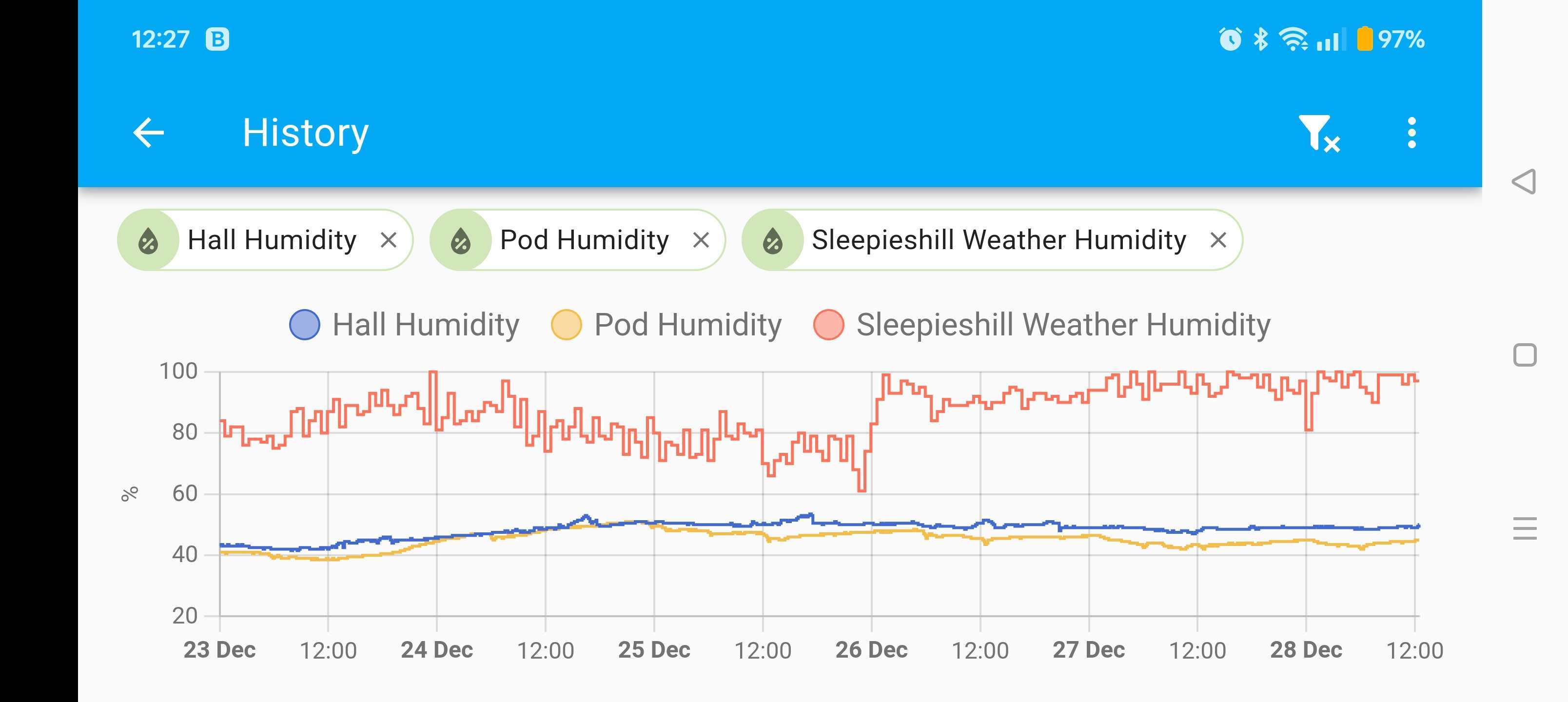

We seem to drop down to about 39% worst case
A screenshot I did last year, compared outside humidity levels to yinside the house (normal MVHR), the pod is a summer house that is heated and has dMEV. The summer house almost tracks the humidity levels of the MVHR.
Screenshot_2024-12-28-12-27-57-93_c3a231c25ed346e59462e84656a70e50.thumb.jpg.60ccc1bc754d5c332d16fa2f422e06e0.jpg
I’ve also noticed that the accuracy of the various sensors is quite variable, especially the Loxone ones. I bought a Ruuvi one that you can calibrate and use that to apply an offset to all the others.
