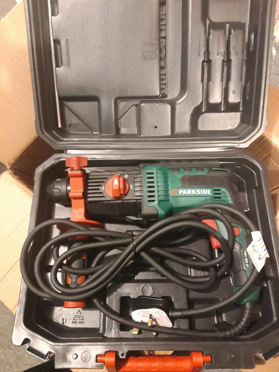

Onoff Posted January 9, 2018 Share Posted January 9, 2018 (edited) Maybe I've got the January blues (I have) and in need of a tool purchase pick-me-up as on a whim I've just bought one of the £34.99 Lidl drills: Their corded multi tool I have is excellent. Their, again 230V drywall gun is actually OK too. I'd have stopped there but my own Bosch 230V hammer drill has just died after 18 years, the one before that lasted 16 years. Tbh I've been getting a bit sick of hauling in my big Makita SDS and the trannie that goes with it of late. This having rotary stop for a bit of chasing and being so light convinced me. So...it's slow start & makes a nice enough noise drilling. The selector switch could be better maybe. BUT the reason it's going back is due to the fwd/rev switch on the pistol grip. It's not what you'd call positive in its positioning and when in what must be reverse it's all I can do to pull the trigger it's that hard work! Duff one maybe. Will find out tomorrow! Edited January 9, 2018 by Onoff Link to comment Share on other sites More sharing options...

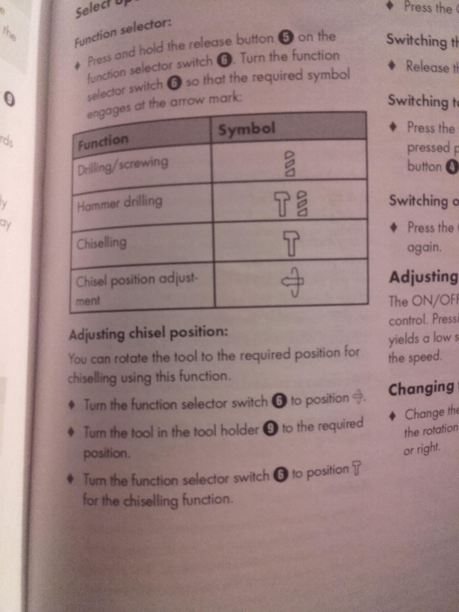

Dudda Posted January 9, 2018 Share Posted January 9, 2018 I one I got either a year or two ago (not sure) but it doesn't have a forward / reverse. The knob also has three options; chisel, hammer drill and drill. That newer version looks to have four? It's brilliant for the price I paid for it. I've really pushed it over a variety of tasks and it's held up very well. Will get it for my Dad as he keeps borrowing mine. Link to comment Share on other sites More sharing options...
Onoff Posted January 9, 2018 Author Share Posted January 9, 2018 5 hours ago, Dudda said: I one I got either a year or two ago (not sure) but it doesn't have a forward / reverse. The knob also has three options; chisel, hammer drill and drill. That newer version looks to have four? It's brilliant for the price I paid for it. I've really pushed it over a variety of tasks and it's held up very well. Will get it for my Dad as he keeps borrowing mine. The "fourth" option is for chisel position: I just hope they have a good one left tomorrow. This was one of the few where the box was intact and unopened. Link to comment Share on other sites More sharing options...

Onoff Posted January 10, 2018 Author Share Posted January 10, 2018 Exchanged the drill tonight for another, again all sealed up in its packaging. Forward function feels/sounds acceptable but reverse doesn't! Need to find A N Other with the same drill and compare notes. Link to comment Share on other sites More sharing options...
dpmiller Posted January 10, 2018 Share Posted January 10, 2018 run it for a while, the brushes might need to bed in. Link to comment Share on other sites More sharing options...

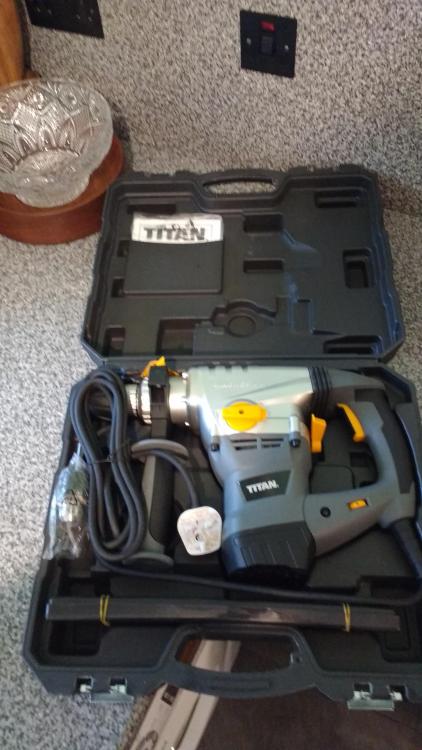

ProDave Posted February 10, 2018 Share Posted February 10, 2018 That Aldi one is what I would describe as a "generic" SDS drill. They are sold under many different names. I bought mine from Screweys about 14 years ago and is badged Titan. 14 years of use and abuse and it's still going strong. In that time I have replaced the brushes once, and fitted a new, much longer mains flex to it. It doesn't do reverse, just forward with or without hammer, and hammer only for chisseling. Link to comment Share on other sites More sharing options...

Onoff Posted September 29, 2018 Author Share Posted September 29, 2018 Reckon I'll be returning this Lidl drill for a refund. Having to pull the trigger "just right" to get it to go. This is the replacement for the first that didn't sound right. As said above fwd sounded ok but not reverse. Just sounds like it's farting when it runs now and loads of sparks visible through the casing. Link to comment Share on other sites More sharing options...
Davew Posted February 27, 2019 Share Posted February 27, 2019 On 10/01/2018 at 19:33, Onoff said: Exchanged the drill tonight for another, again all sealed up in its packaging. Forward function feels/sounds acceptable but reverse doesn't! Need to find A N Other with the same drill and compare notes. I have the same product. I thought there was a problem with reverse, can only pull trigger a bit and goes slow. I checked with their support and this is normal though no mention in instructions. I tried a few different makes in B and Q and some have similar restriction in reverse. I think this is a feature of these types of ‘pneumatic’ type drills. It might damage pump ifgoes fast. Slow reverse just for extracting if gets stuck. Link to comment Share on other sites More sharing options...
Onoff Posted February 27, 2019 Author Share Posted February 27, 2019 (edited) 9 minutes ago, Davew said: I have the same product. I thought there was a problem with reverse, can only pull trigger a bit and goes slow. I checked with their support and this is normal though no mention in instructions. I tried a few different makes in B and Q and some have similar restriction in reverse. I think this is a feature of these types of ‘pneumatic’ type drills. It might damage pump ifgoes fast. Slow reverse just for extracting if gets stuck. As I say I'll probably take this, the second one back. Can pull the trigger now and nothing. Have to give it a damn good whack to get it to go. Brushe or some other loose connection I guess. Edited February 27, 2019 by Onoff Link to comment Share on other sites More sharing options...
