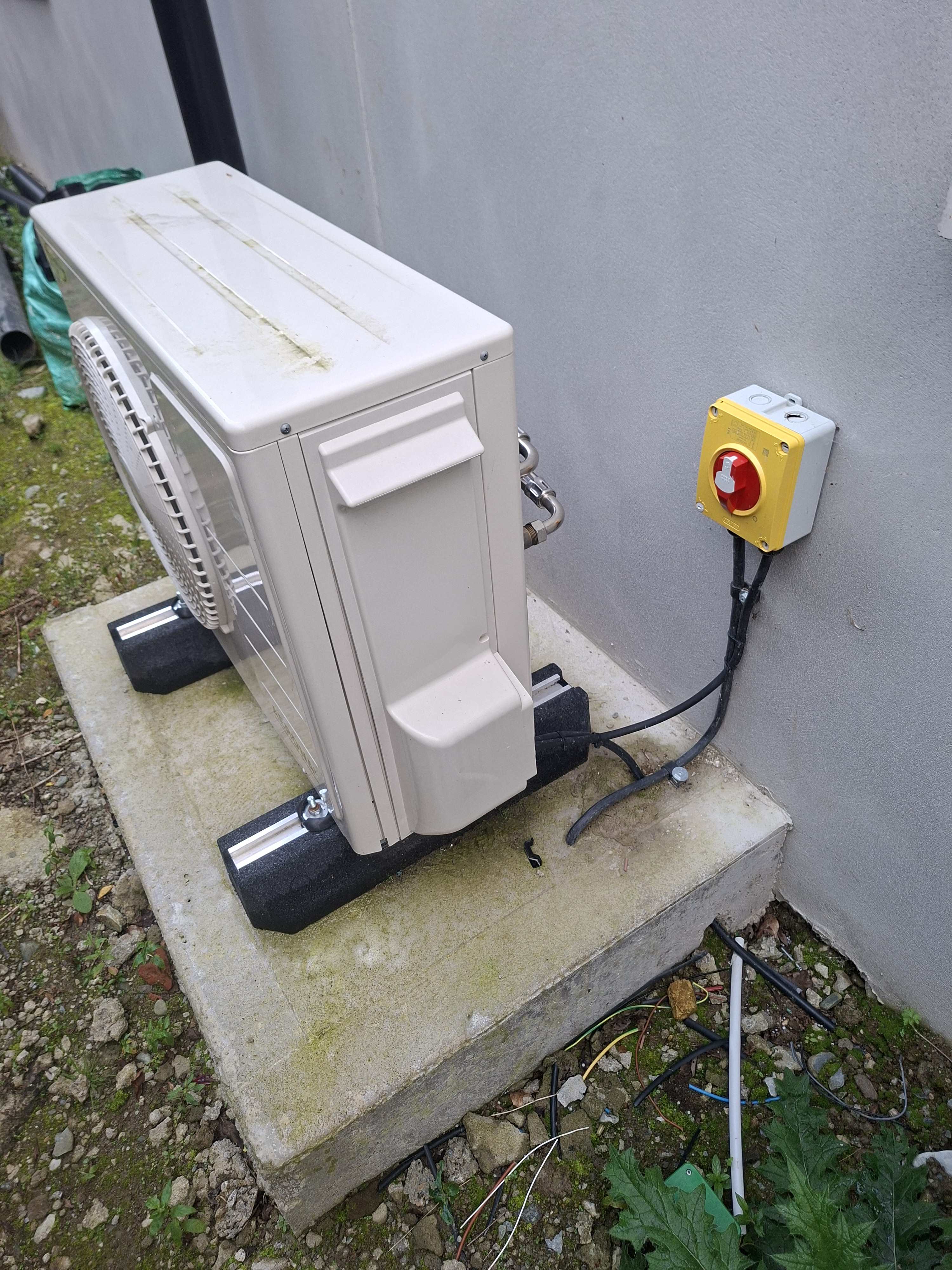

I thought the pipes going in and out of the ASHP should be insulated
I thought the pipes going in and out of the ASHP should be insulated and that a kit came with it but I was told not for this kind. Is this correct?

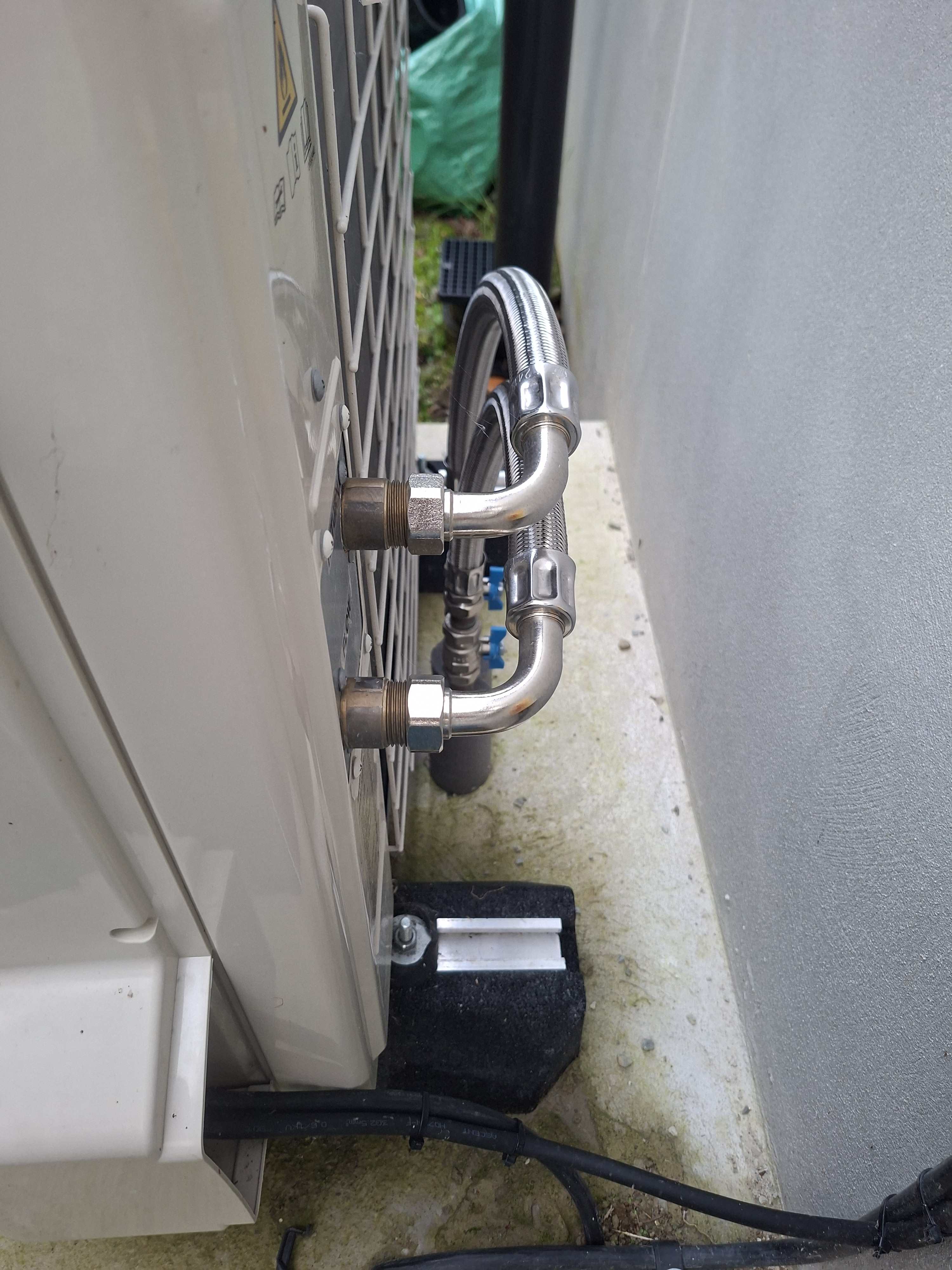

aren't they just flexible hoses? definitely don't look insulated already so i would suggest that insulation should be added to them.

All outside pipes need insulation. The insulation needs to be 19mm thick minimum, ideally 25mm and UV resistant.

for example ... those flexis look like 22mm connected to 28mm coming out of the heat pump.  This maybe OK but given the BS re insulation I wouldn't bet on it.
If its not too late Id give the system a good checking over and ask about anything faintly suspicious before paying.
and the two valves (wingnut style) may not be full bore and won't be easy to access once properly insulated either. That grey bit of insulation coming out of the ground also needs protecting from UV.

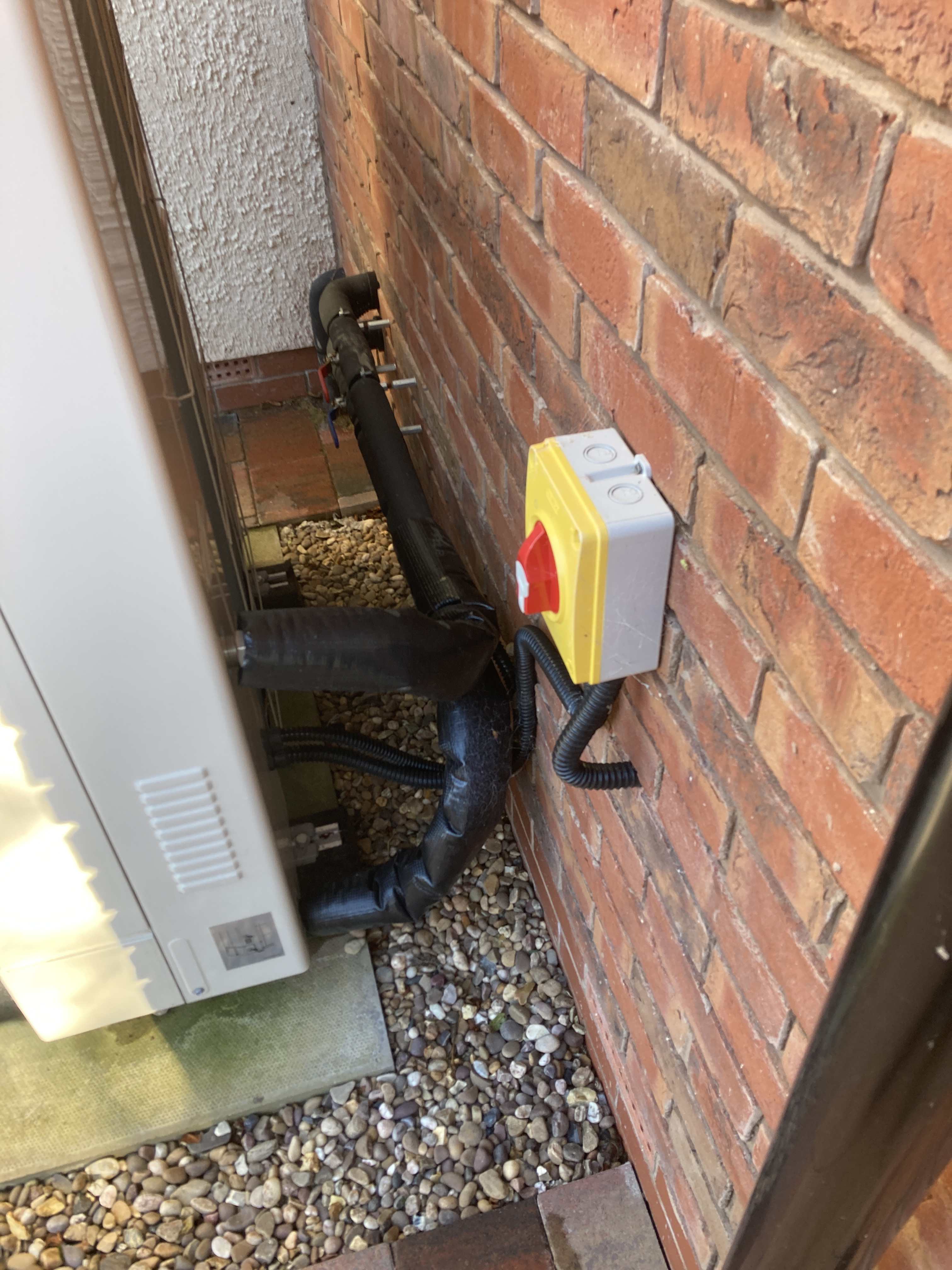

Yes 100% should be Insulated! I've got both air to air and air to water and everything is insulated in Armaflex type insulation.

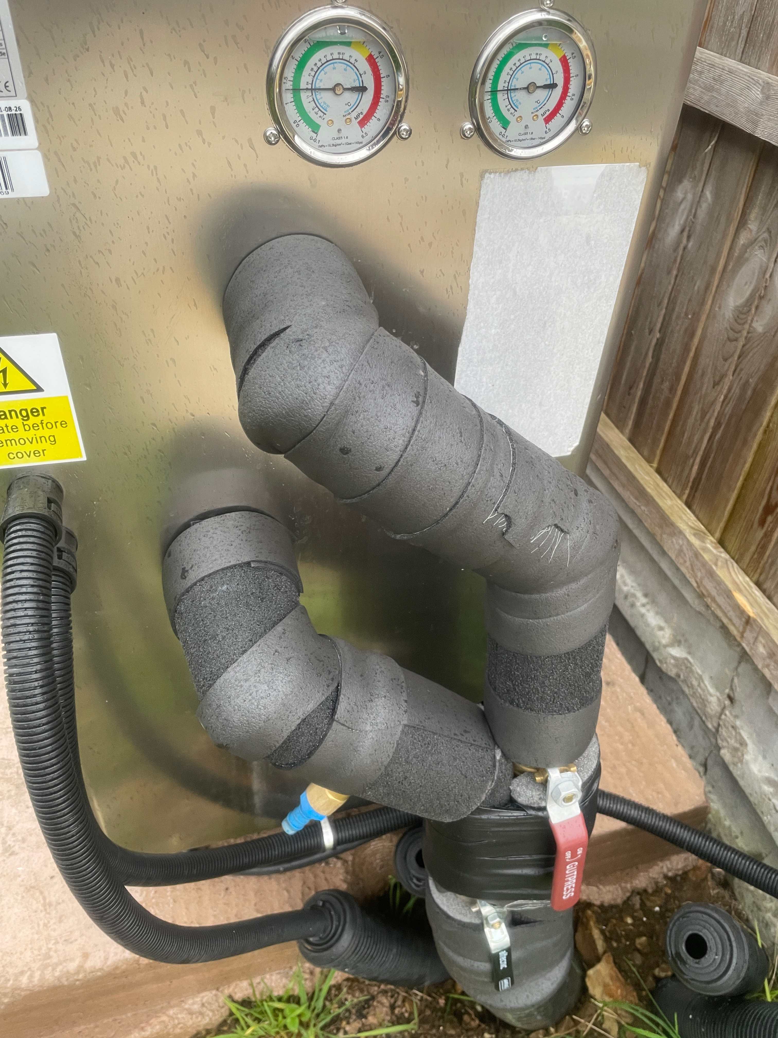

The dreaded SAP company asked me for geolocated photos for this as well. Of course I obliged. They need to be insulated as well as any primary pipework outside of the thermal envelope.

Looks like they’ve cheaped out on the smaller flexis, which will be a choke point when you’re looking to get the DHW cylinder heated up after use.
The butterfly valves are most likely 1/4 full bore, but the flexis are questionable.
If it all works, you may think “what’s the problem” but when you see the difference in heat up times for DHW when there’s a much higher flow rate, then you’ll see.

Yes they should be insulated… I hate flexis personally, don’t think they’re really needed if you’ve got properly bonded insulated twin…
This has since had a couple of coats of the condensate pro UV touch up paint.

Insulation is required by part L and by MCS MIS 3005, which I presume is why city plumbing think it's OK to charge over 200 notes for a pair of flexis
