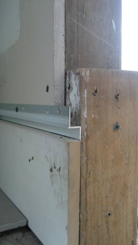

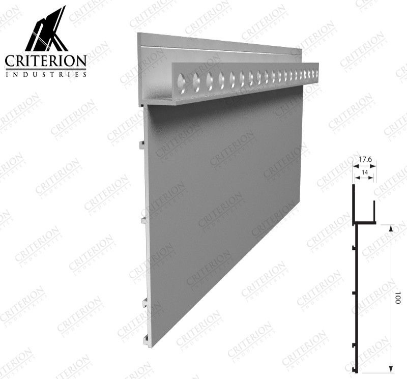

Nickfromwales Posted January 2, 2018 Posted January 2, 2018 Wouldn't some sort of Z bar plastic / alu profile be better fir this purpose? How big a shadow gap? Hey-up........
IanR Posted January 2, 2018 Posted January 2, 2018 (edited) We've put shadow gaps at all floor-to-wall joints and around all door linings in the living areas of the house where we have hard floors. We haven't used them in carpeted or tiled areas. We've used them for their aesthetic. We have minimal steps/rebates/shoulders etc. around any features and have tried to keep that theme running throughout the house. We have used a very simple skirting/architrave in carpeted areas. Our logic to this was that the more hoovering required in these areas would risk damage to the bottom edge of plastered walls if we used a shadow gap against carpet. We also wanted a slightly softer look in the bedroom areas. Some thought needs to go into how it is best to deliver shadow gaps around door linings. Two schools of thought: 1. temporary ply liners in to board and plaster to, then remove ply liners and fit final liners, or. 2. fit final liners and mask/protect then plaster up to them. We went with 1. and found we got some cracking around the liners as we fitted the final door liners. As the liners were screwed in they pushed against the edge of the shadow gap trim and the plaster cracked behind it. This happened on a couple of doors and required chipping out the cracked area and filling. If it was a painted or varnished finish to the door liner I'd try 2. next time, but natural, lacquered or oiled finish and I'd stick with 1. to avoid staining on the finished door liner. We used Qic Trims https://www.qic-trims.com/product/type-r/ After decoration you will need to mastic the gap from the edge of the shadow gap trim to the floor/door liner. There will always be gaps that need finishing. Shadow gaps do seem to mean different things to different people. To me they are a small rebate at wall-to-floor and wall-to-frame junctions that disguises the actual joint in a shadowed area. I know they are also used in conjunction with skirting to create a rebate above the skirting, but to me that's not a "shadow" gap. Our version of a shadow gap: Edited January 2, 2018 by IanR 4
ToughButterCup Posted January 2, 2018 Author Posted January 2, 2018 That, @IanR is impressive. Really elegant, elegant because of its simplicity. If you want to know why I keep coming back to BH, it's because of posts like yours. You can be sure I'll be re-reading it often. What do you call that stuff @Nickfromwales ? I mean generically, I'm not asking for a trade name. I know for sure that if I go to our BM and ask for Quick Trim like Ian's post I'll have another of these experiences
Nickfromwales Posted January 2, 2018 Posted January 2, 2018 17 minutes ago, recoveringacademic said: That, @IanR is impressive. Really elegant, elegant because of its simplicity. If you want to know why I keep coming back to BH, it's because of posts like yours. You can be sure I'll be re-reading it often. What do you call that stuff @Nickfromwales ? I mean generically, I'm not asking for a trade name. I know for sure that if I go to our BM and ask for Quick Trim like Ian's post I'll have another of these experiences No idea, just a random internet image grab. TBH, the supplier @IanR linked to is reasonabke and has the different sizes needed.
IanR Posted January 2, 2018 Posted January 2, 2018 (edited) 1 hour ago, recoveringacademic said: That, @IanR is impressive. Really elegant, elegant because of its simplicity. Thanks! 1 hour ago, recoveringacademic said: I know for sure that if I go to our BM and ask for Quick Trim like Ian's post I'll have another of these experiences My experience was that they're not available off-the-shelf in the normal BM's. I also found that tackers and plasters were not familiar with them so I had to set out how I wanted them to use them. When I searched for them I found only a couple of different manufacturers, but lots of re-sellers, some re-branding them to make them appear different. Qic Trims seemed to be the most prolific and often re-sold under different names. I went directly to Qic Trims. The pricing they show on their site is the RRP and is to not be seen to compete with the re-sellers. I found they offered a good discount, but you have to order in packs of 25 x 3m lengths and pay a delivery charge of £25. As I used 100's of meters of the stuff it worked out very economic. Edited January 2, 2018 by IanR

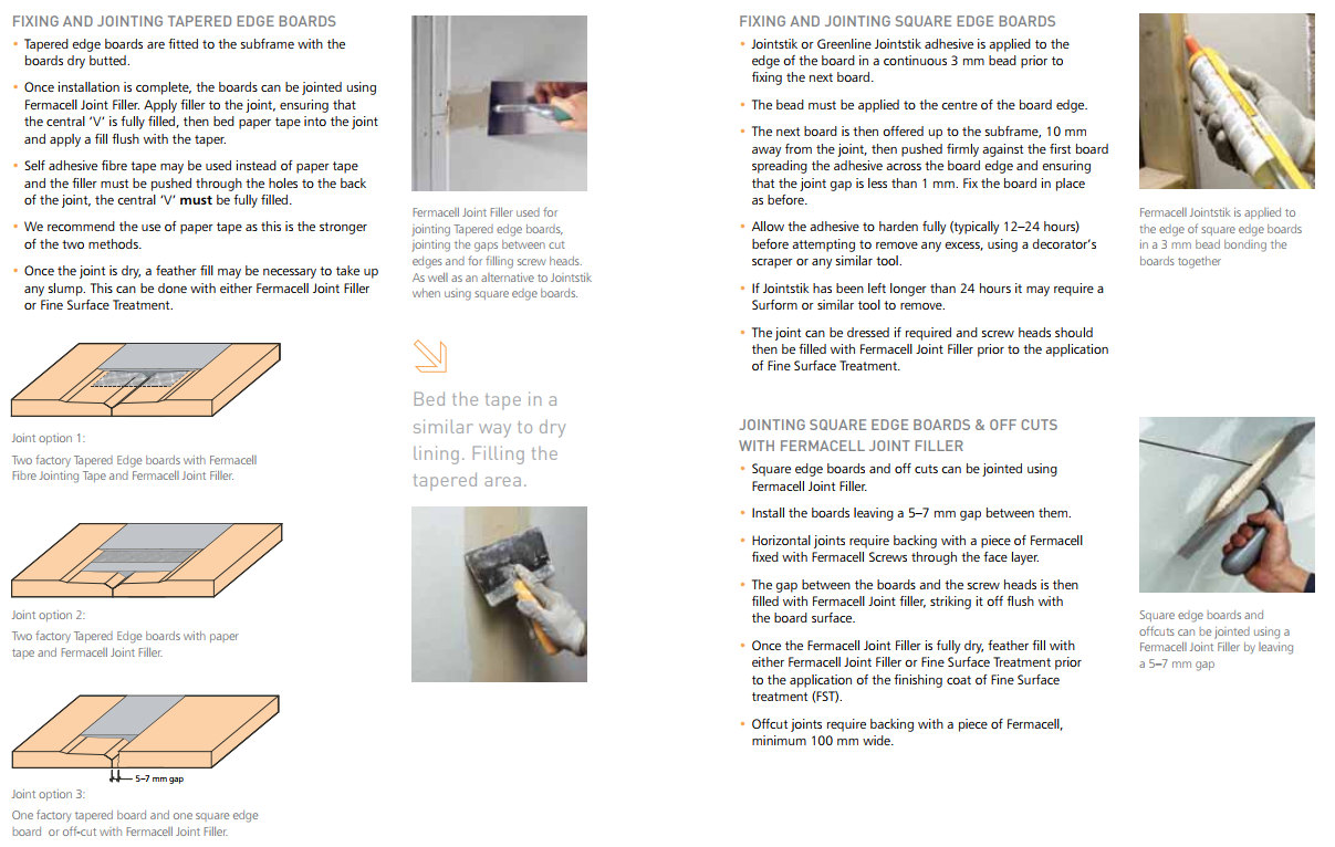

Visti Posted January 2, 2018 Posted January 2, 2018 Any idea if there's a similar solution that doesn't involve a skim finish to integrate these skims? We're heavily considering Fermacell and were hoping to do away with both skimming and skirting boards, but simply leaving a gap between the board and the floor wont cut it as @Stones has already pointed out. These appear to solve that problem but require skimming, which would negate one of our prime reasons for using fermacell in the first place.
Russell griffiths Posted January 2, 2018 Posted January 2, 2018 you Don’t have to skim them you treat it the same as if you had taped and jointed. You would be taping and jointing the fermacel wouldn’t you ? You treat it very much like the corner beads with a 3 coat finish and sand.
Visti Posted January 2, 2018 Posted January 2, 2018 35 minutes ago, Russell griffiths said: you Don’t have to skim them you treat it the same as if you had taped and jointed. You would be taping and jointing the fermacel wouldn’t you ? You treat it very much like the corner beads with a 3 coat finish and sand. There is with their tapered edge boards, though we were planning on using the square edge boards as it is more DIY friendly... we may however have to reevaluate that given the desire for shadowgaps!

Russell griffiths Posted January 2, 2018 Posted January 2, 2018 36 minutes ago, Visti said: There is with their tapered edge boards, though we were planning on using the square edge boards as it is more DIY friendly... we may however have to reevaluate that given the desire for shadowgaps! Has anybody here used the square edge board and had good results? I taped and jointed my last house and a BUTT joint where there is no taper were the work of the devil, they required lots of effort to get right and I think your battening will need to be cock on to not show any imperfections. Haven’t I read somebody here using it recently. ?

Trw144 Posted January 2, 2018 Posted January 2, 2018 One thing to consider with shadow gaps is the floor finishes - downstairs we had tiles which is fine and basically we had the house tiled and then boarded/skimmed afterwards. Upstairs we had to install the engineered oak flooring after the plastering due to the risks of damage to the floor (general mess plus high moisture content due to wet plaster damaging the floor) - this means they had to leave an exact gap to allow the floor to be laid, with the floor ending up touching the bottom of the shadow gap profile.
