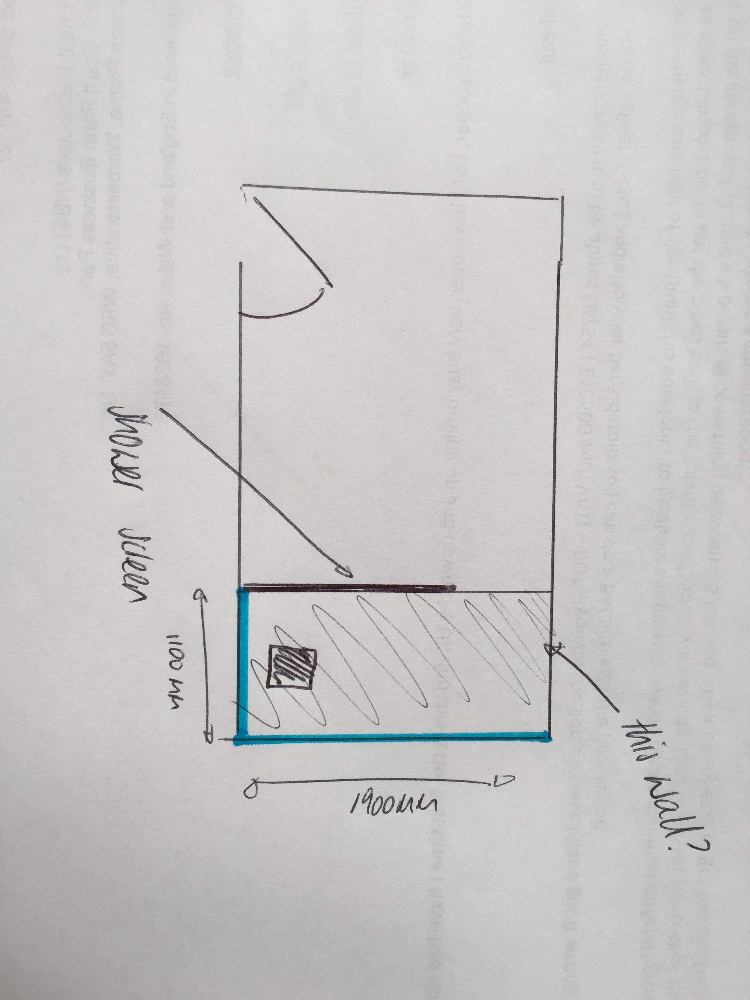

Trw144 Posted September 16, 2016 Posted September 16, 2016 Just want a bit of advice/input on plastering near a shower. I m having a 1100 x 2000m shower in our ensuite, using Fiora shower trays and wall panels (a type of composite material for those that don't know it... www.fiora.es) My plan was to use the waterproof Fiora panels on the 2m wall and 1.1m wall, but at the other end of the shower I did nt want to use the panels but instead have a plaster finish so it does nt feel so enclosed. The wall may get the odd splash but I don't think it should be too bad. My question is - what should I use of this wall - green moisture resistant plasterboard or something else? It will then be skimmed and then I planned on using one of the bathroom paints suitable for steamy/wetter environments? I ll do a quick sketch to help show the layout...
Trw144 Posted September 16, 2016 Author Posted September 16, 2016 The blue walls are where the fiora panels are going. I ve marked a smal square roughly where the shower head will be...
TerryE Posted September 16, 2016 Posted September 16, 2016 Green, without a doubt. It's just not worth the risk of using anything else. You also need to think of how you are going to do your skirting treatment. You mention "the odd splash", but this is all going to run down the wall and over your skirting
Trw144 Posted September 16, 2016 Author Posted September 16, 2016 (edited) I m using shadow gap everywhere else but I assume I wont use it here and will have a silicone bead or similar at the junction of the plaster onto the fiora shower tray? Edited September 16, 2016 by Trw144

Nickfromwales Posted September 17, 2016 Posted September 17, 2016 On 16/09/2016 at 14:45, Trw144 said: I m using shadow gap everywhere else but I assume I wont use it here and will have a silicone bead or similar at the junction of the plaster onto the fiora shower tray? Expand I'd buy 1100 or 1200mm wall panels for each end and make a splash proof area, in the interest of longevity. I don't like to see the cubicle finishing tight on the edge but that's just me.
Trw144 Posted September 17, 2016 Author Posted September 17, 2016 On 17/09/2016 at 09:01, Nickfromwales said: I'd buy 1100 or 1200mm wall panels for each end and make a splash proof area, in the interest of longevity. I don't like to see the cubicle finishing tight on the edge but that's just me. Expand Sorry nick, don't quite follow what your saying. Can I have it in laymans terms or a diagram !!?
Nickfromwales Posted September 17, 2016 Posted September 17, 2016 Panel all 3 vertical walls. If you have an 1100 tray then an 1100 wall panel will have very little meat left for screwing / fixing the chrome wall channel ( for the glass ) to. I don't like the idea of water ever getting to a painted plastered wall. At the very least I'd want an Upstand of similar material for the tray / wall junction. 1
