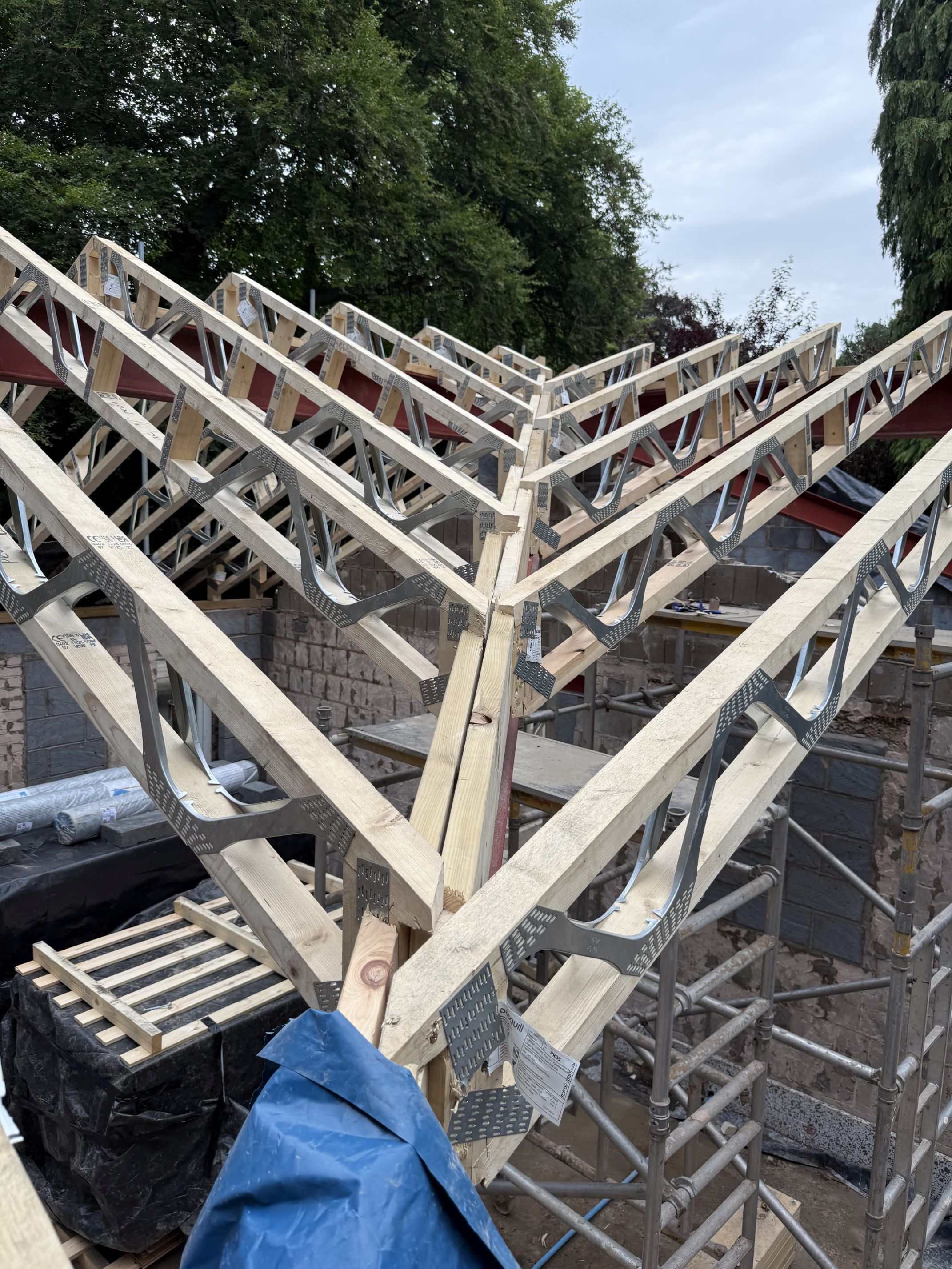

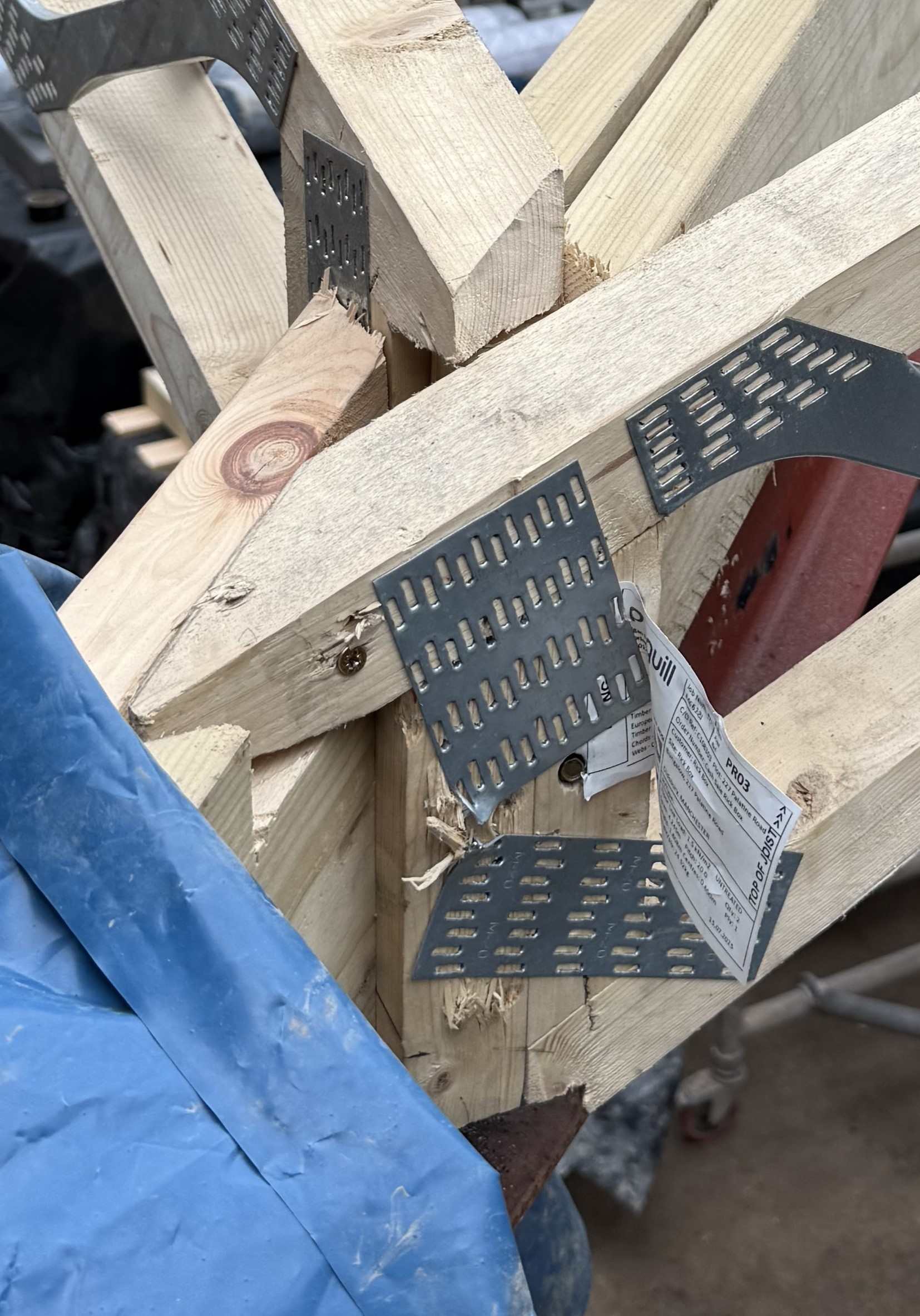

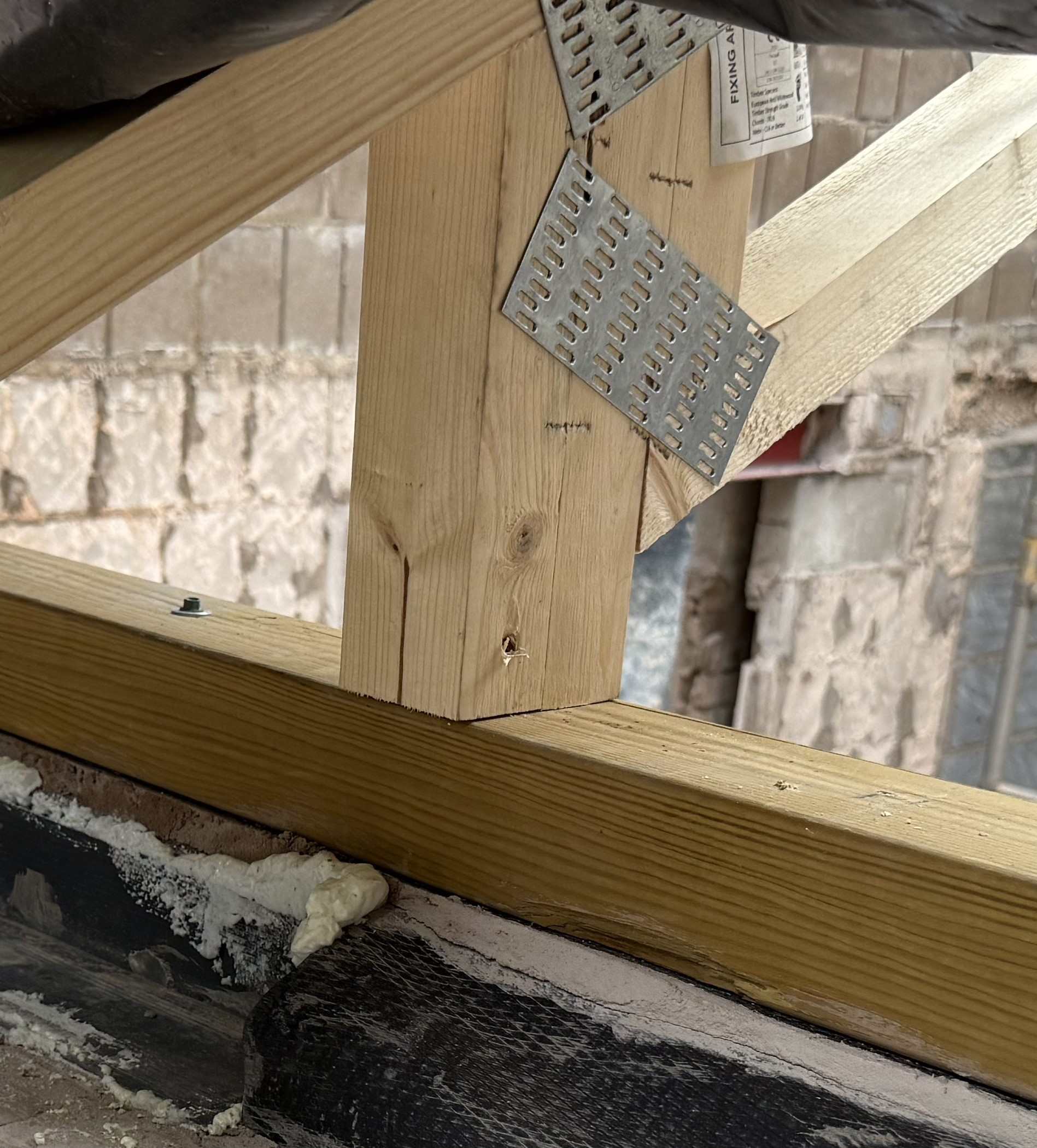

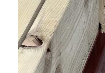

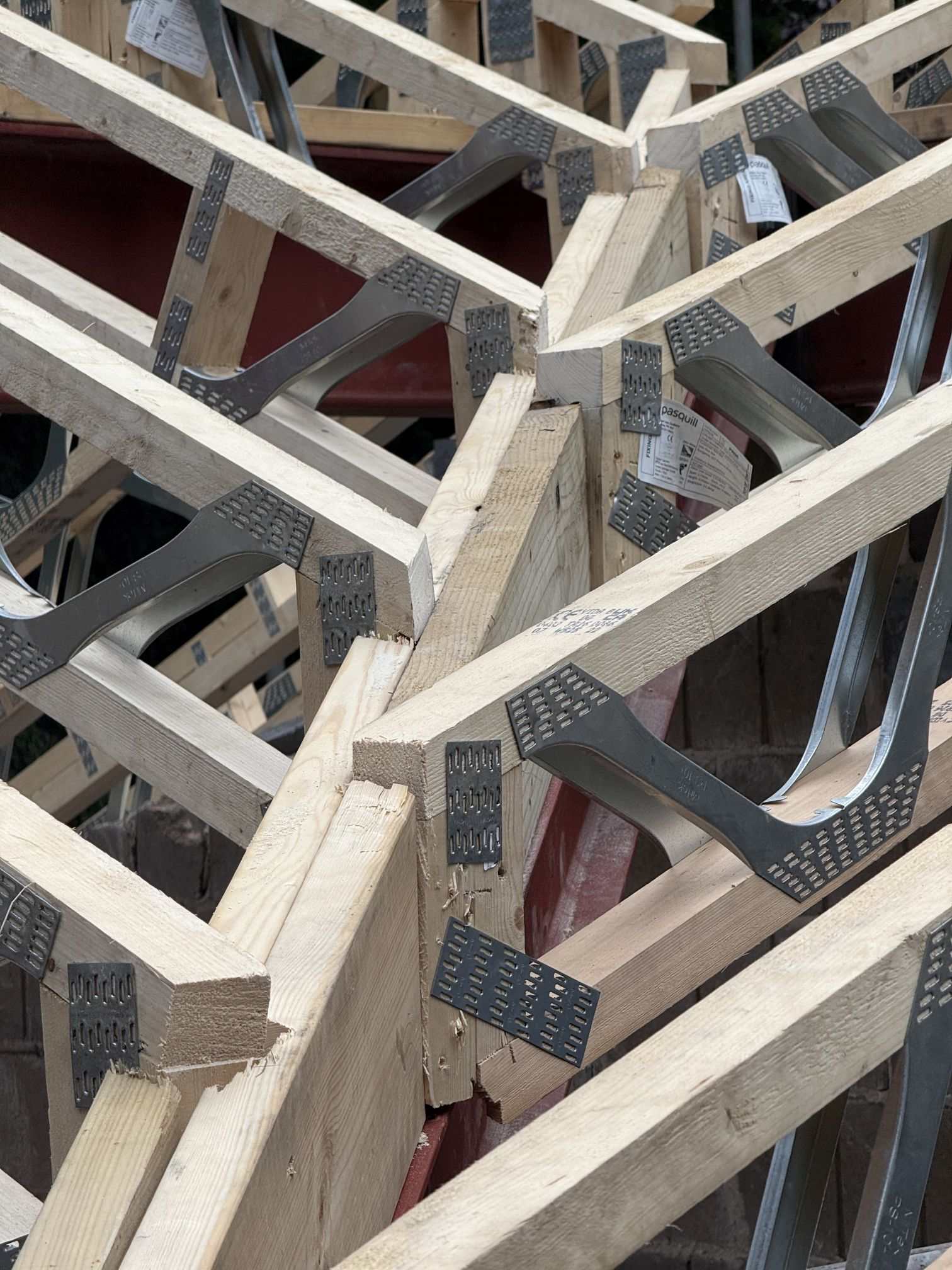

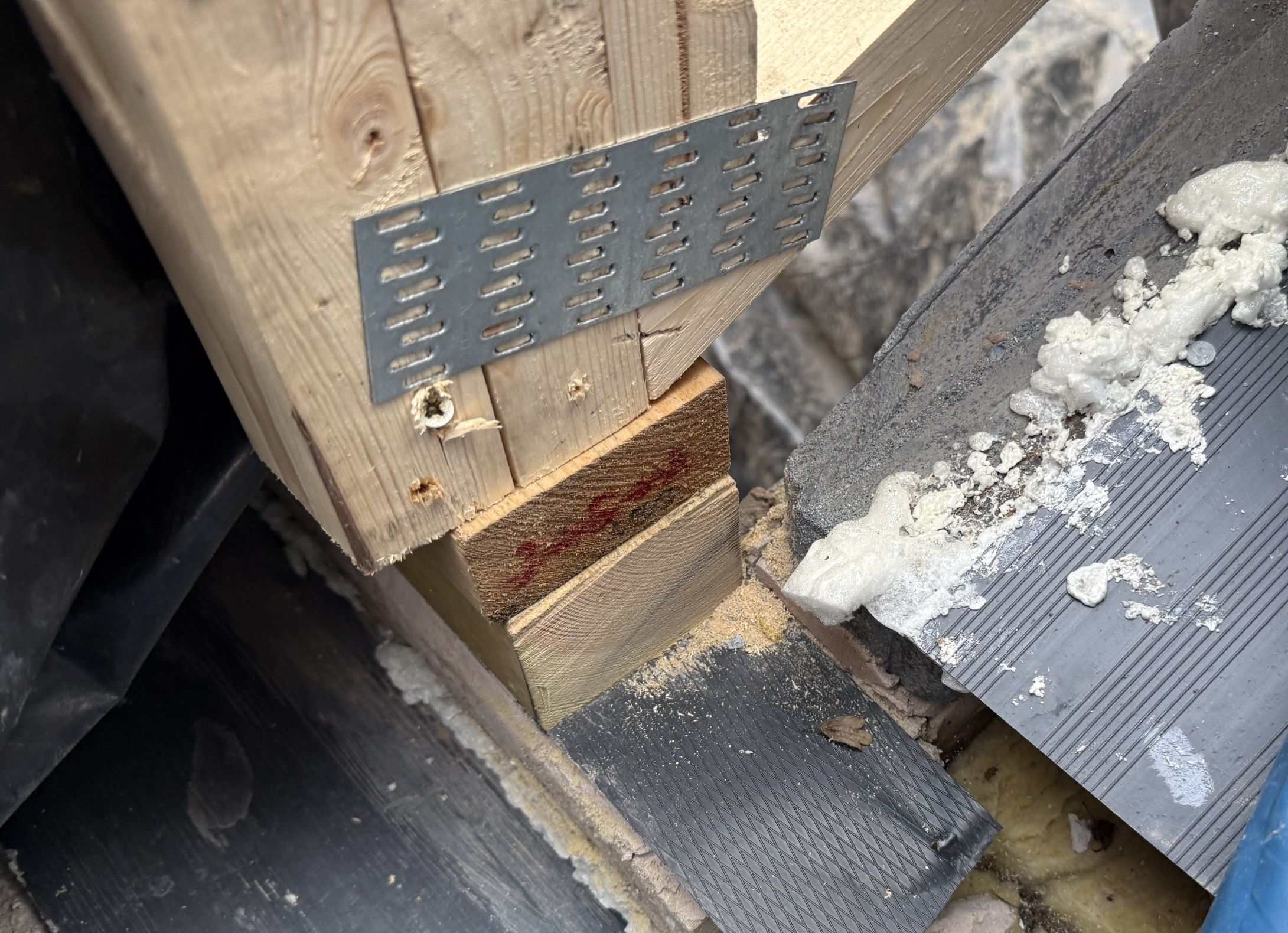

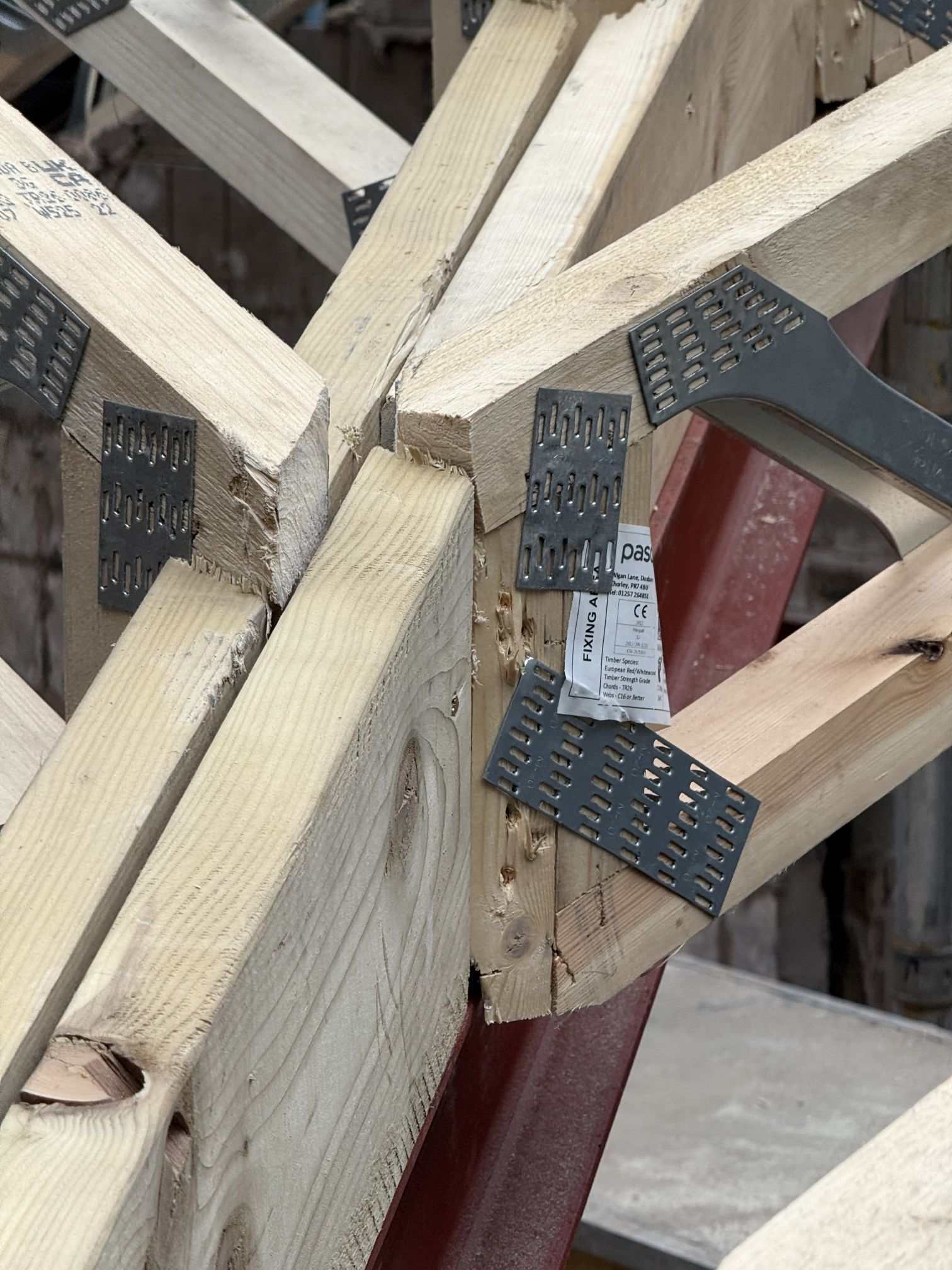

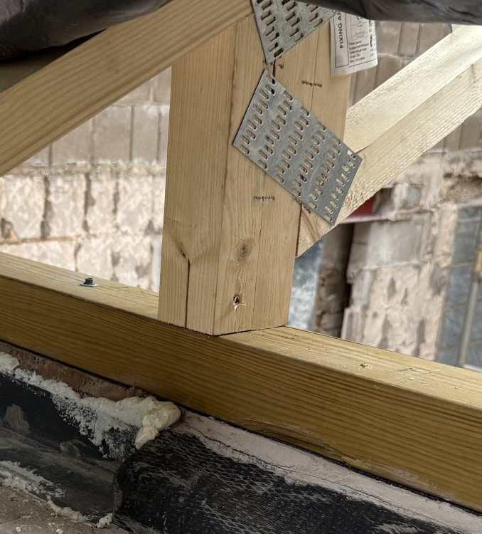

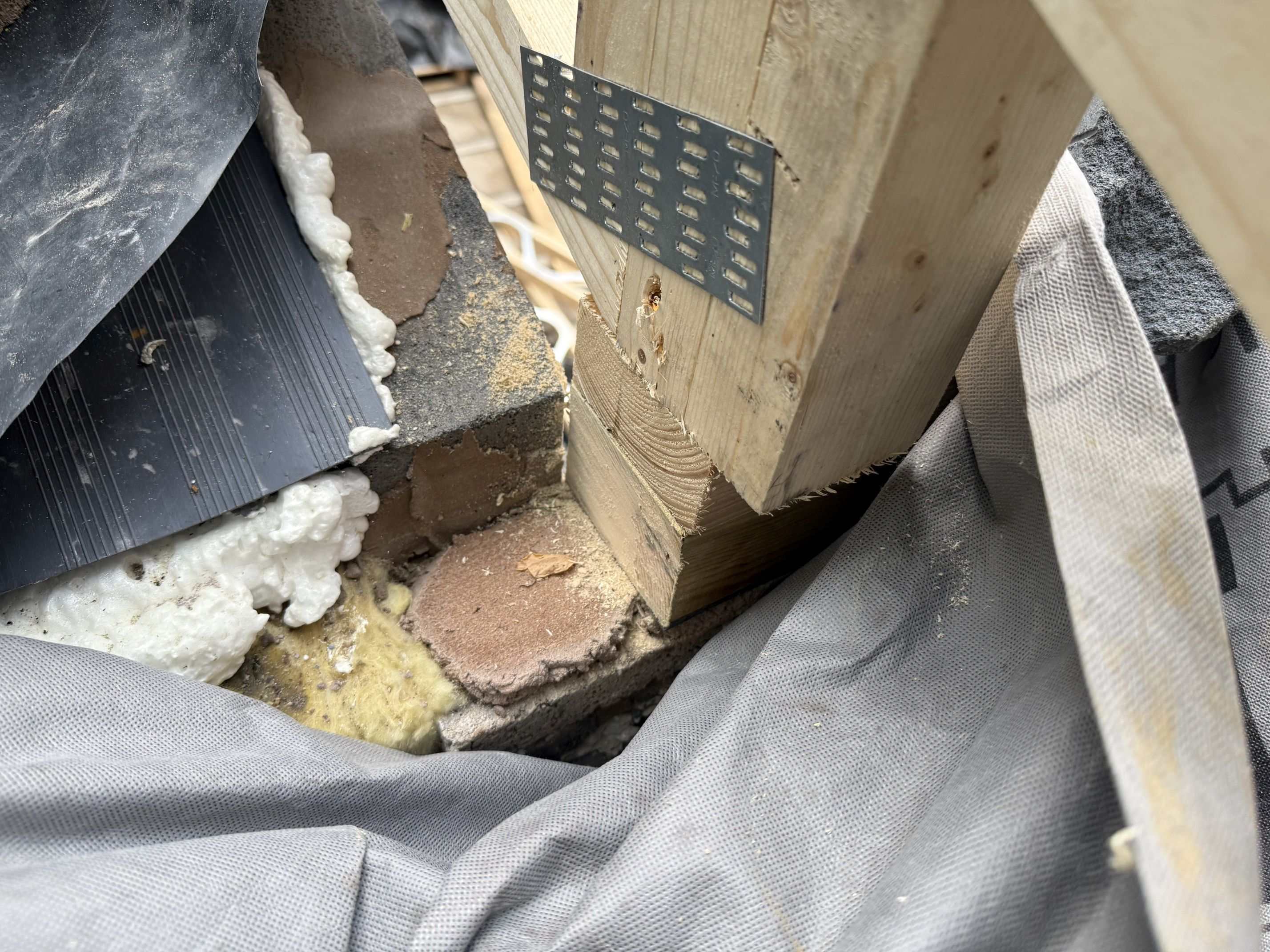

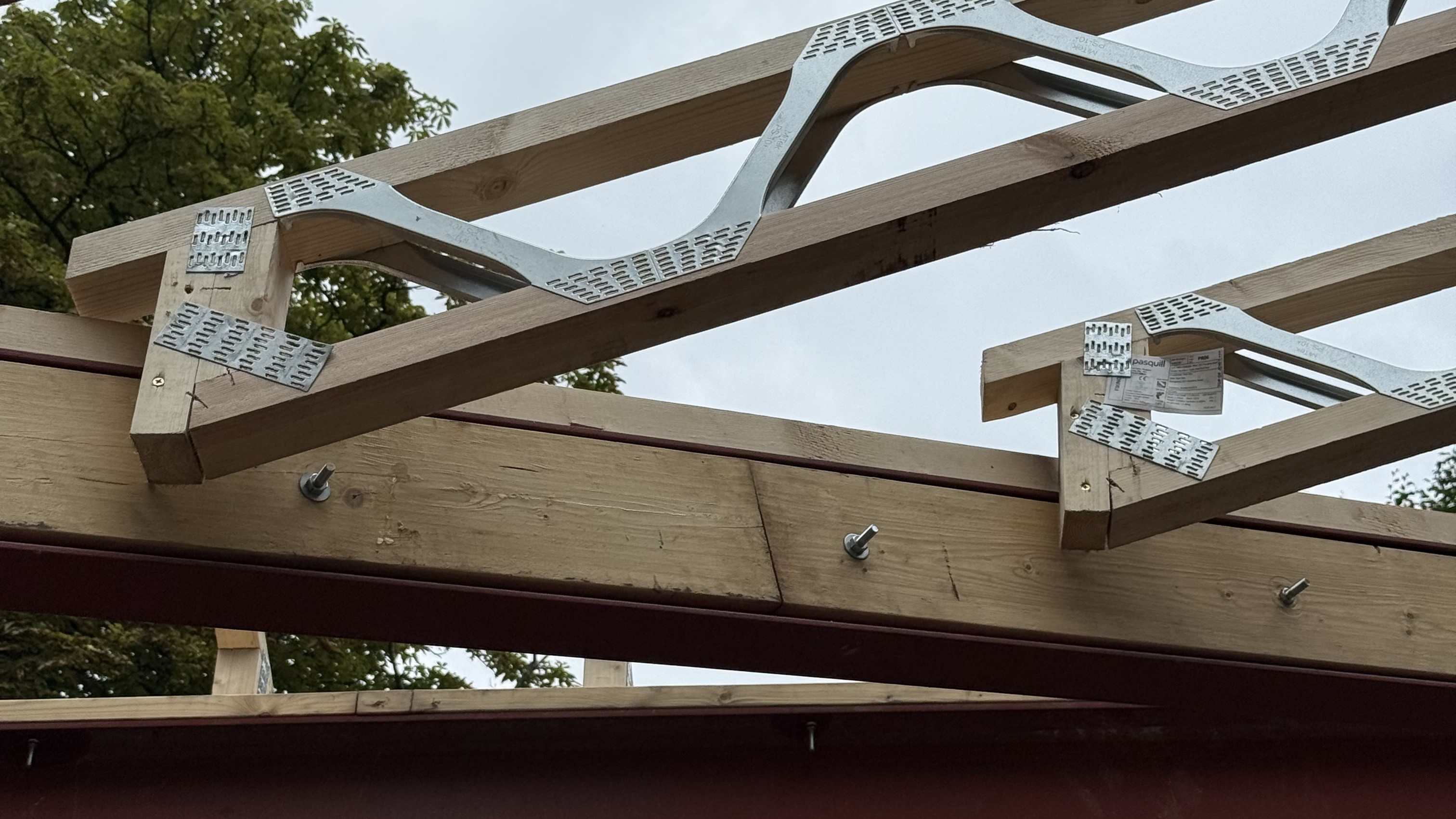

boxrick Posted July 26, 2025 Posted July 26, 2025 (edited) So... after much pain and agony my posi joists have arrived. I paid a lot of money for all my hangers and correct fittings, yet they seem to have been drilled into oblivion and the ends cut up. This document states that they shouldn't be drilled, notched etc. https://www.mitek.co.uk/wp-content/uploads/sites/23/2018/10/WoPT-Issue-7-2.pdf I'll get more pictures tomorrow, but I would like some immediate thoughts. I am a little bit upset with this right now... From the POV of a layman: You can see where they drilled them in just to get the positioning and they have drilled them in so hard the wood has split a chunk off the middle On this same positioning drilling the end piece has actually gone at an angle as its pulled each part away They have drilled so much on some pieces it looks like it has been mangled with a hacksaw Angles and big notches have been taken out, chunks out the top and bottom Random drilling constantly all over I'll contact the manufacturer on Monday, but from my POV this looks like absolute shit. Edited July 26, 2025 by Nickfromwales Duff pics deleted.

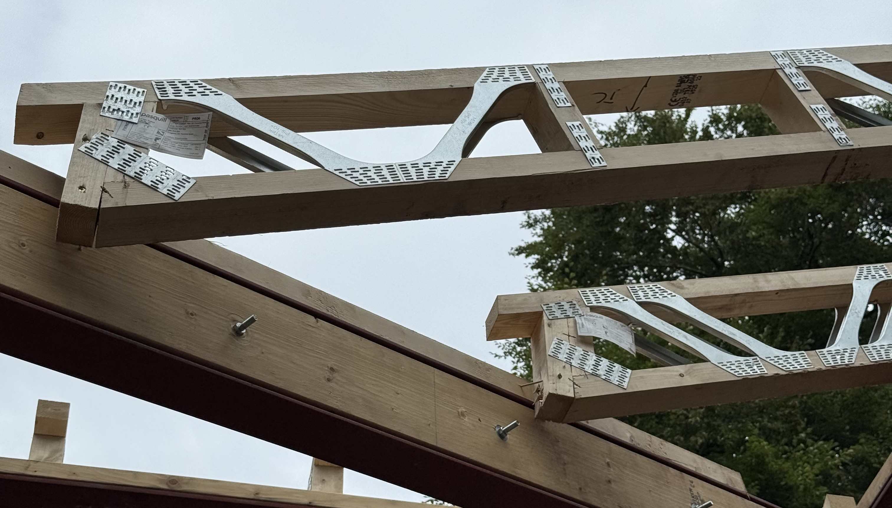

boxrick Posted July 26, 2025 Author Posted July 26, 2025 Honestly don't know whats going on with the brightness of these. Lets try again:

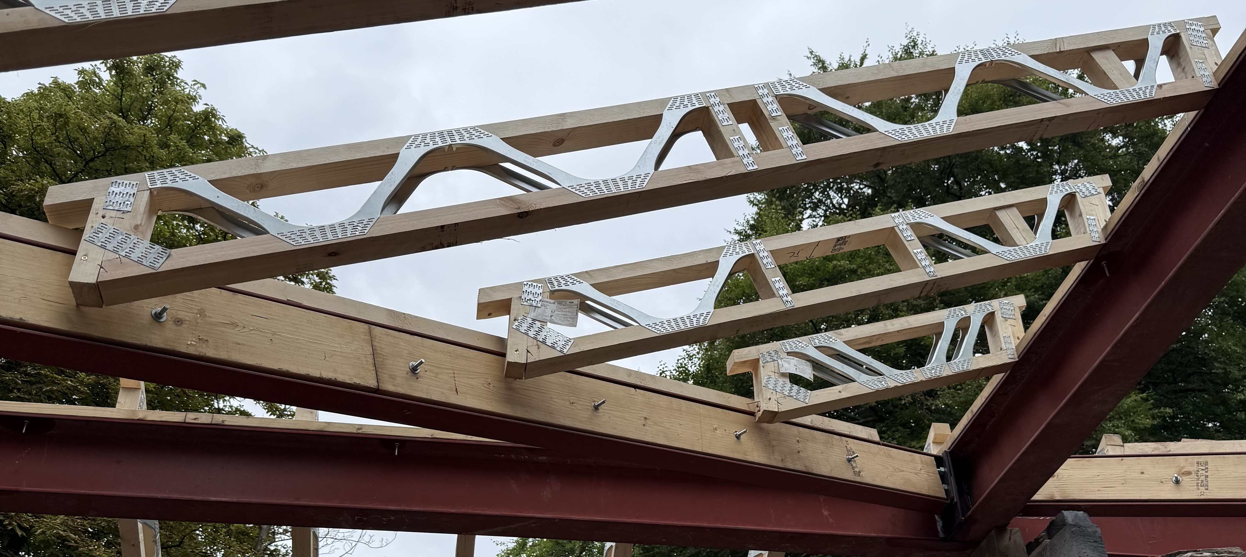

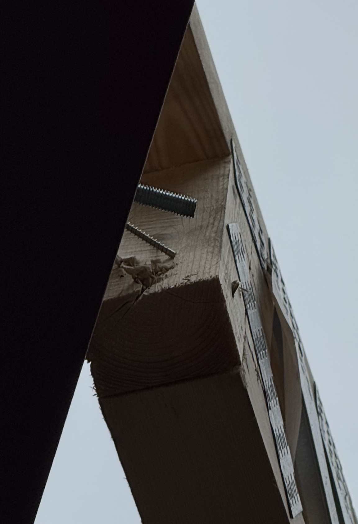

MikeSharp01 Posted July 26, 2025 Posted July 26, 2025 That does not look good - relying on a couple of screws and not the top string and / or a hanger feels very wrong, send these images to the joist manufacturers and see if they are cool with it - I doubt they will be although the runs are relatively short and the steel frame is doing the vast majority of the work assuming the roof load is appropriately transferred to it and I am not sure it is here. If things are as wrong as I suspect you will need to work up a strategy to tackle your contractors on Monday. Others with much more experience will be along to help with that I suspect.
ProDave Posted July 26, 2025 Posted July 26, 2025 Post whatever drawings of the roof that you have, that they should be working from. 1
Redbeard Posted July 26, 2025 Posted July 26, 2025 Last and last-but-one pics - what will happen next?! The phrase 'hanging in the air like bricks don't' - with a little modification - comes to mind.
torre Posted July 26, 2025 Posted July 26, 2025 Sorry but this looks very poor. You'll have been supplied with plans identifying each joist and which of the hangers you've paid for should be used at each connection. The design will rely on those hangers being used correctly. I guess the last pics may be just to place in rough positions prior to hanging as they're hopeless, but even with that benefit of the doubt some of the others where they've cut the ends and have minimal bearing are surely wrong. If your joist supplier is local maybe they'll visit the site to take a look, I think it's very likely some of this will need to be re-done and some joists may need replacing. Your building inspector will want to see these have been installed according to the design, it's hard to see this would pass. Are you staging payments? I'd want to keep something back if this is typical - I just looked at your profile, this is the same builder that installed the wrong insulation below damp?
boxrick Posted July 26, 2025 Author Posted July 26, 2025 (edited) 15 minutes ago, torre said: Sorry but this looks very poor. You'll have been supplied with plans identifying each joist and which of the hangers you've paid for should be used at each connection. The design will rely on those hangers being used correctly. I guess the last pics may be just to place in rough positions prior to hanging as they're hopeless, but even with that benefit of the doubt some of the others where they've cut the ends and have minimal bearing are surely wrong. If your joist supplier is local maybe they'll visit the site to take a look, I think it's very likely some of this will need to be re-done and some joists may need replacing. Your building inspector will want to see these have been installed according to the design, it's hard to see this would pass. Are you staging payments? I'd want to keep something back if this is typical - I just looked at your profile, this is the same builder that installed the wrong insulation below damp? Yea this is the same guy One picture I didn't share is they have also just cut this steel. It's one of the valley beams. It's not in any SE plans or similar. Edited July 26, 2025 by boxrick

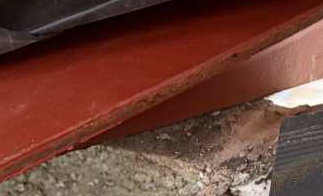

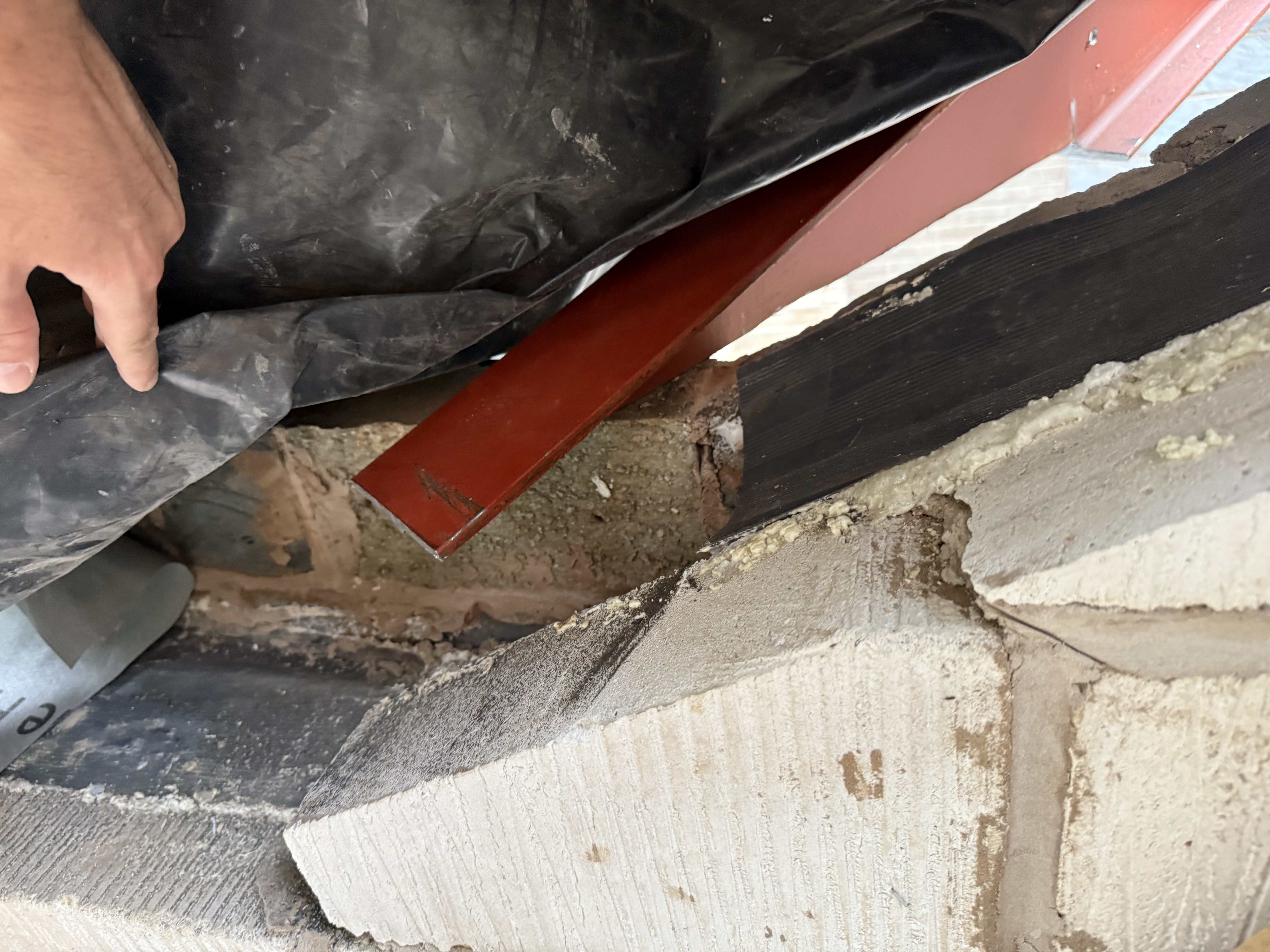

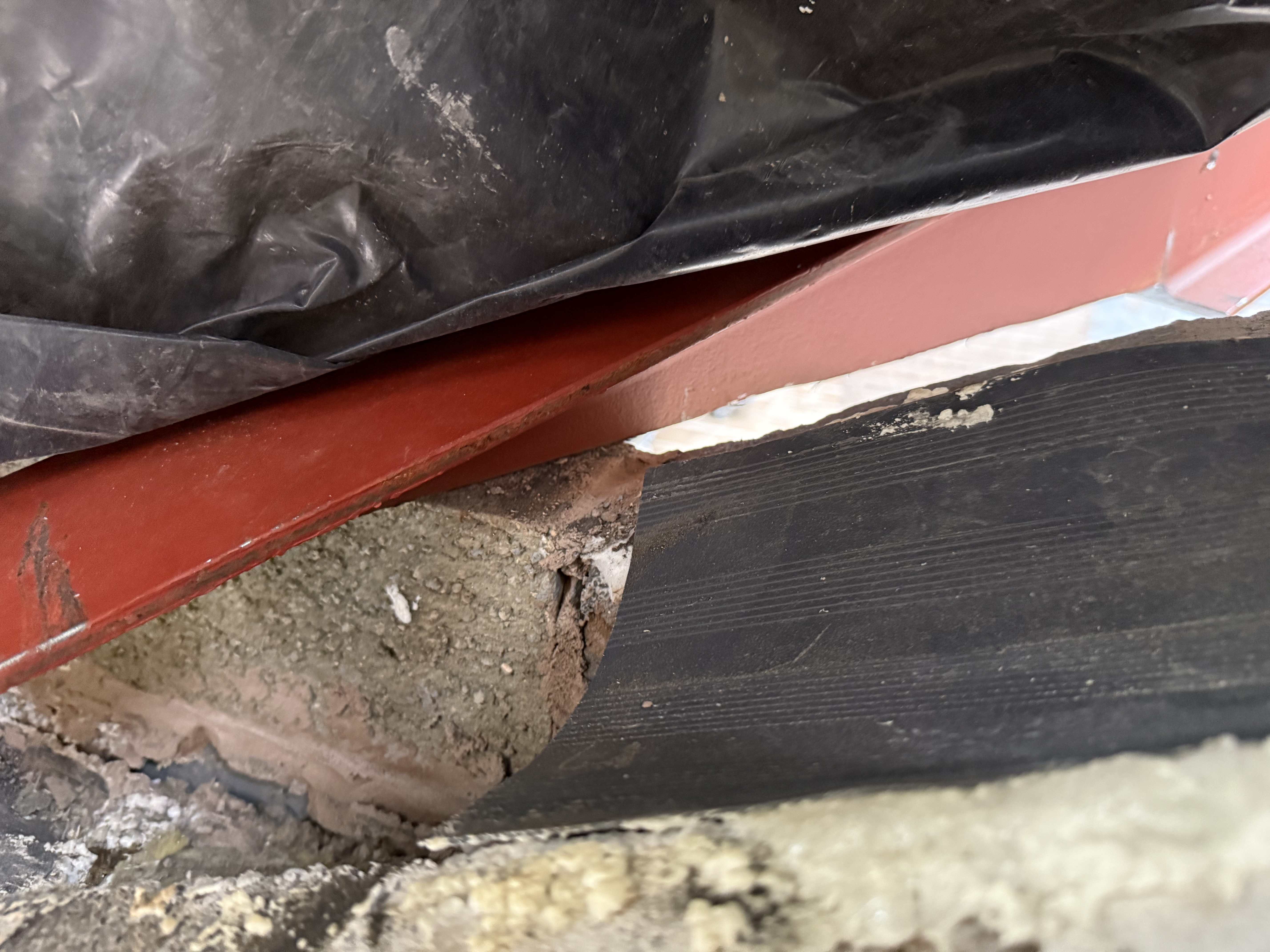

Nickfromwales Posted July 26, 2025 Posted July 26, 2025 1 hour ago, boxrick said: Yea this is the same guy One picture I didn't share is they have also just cut this steel. It's one of the valley beams. It's not in any SE plans or similar. @Gus Potter, has this steel just been destroyed by the undercut and diminished web?
saveasteading Posted July 26, 2025 Posted July 26, 2025 2 hours ago, Nickfromwales said: steel just been destroyed Its not completely clear on the photos. It looks as if the beam isn't a beam any more, reduced to a T, almost to a plate and all the load is sitting on the web. But perhaps back where the beam remains complete, that part is sitting on a wall or plate? In which case the remaining part has become an oversail and not structural. Even then, it should probably be on a pad or plate. Is there a side picture of that?
Nickfromwales Posted July 26, 2025 Posted July 26, 2025 7 minutes ago, saveasteading said: Its not completely clear on the photos. It looks as if the beam isn't a beam any more, reduced to a T, almost to a plate and all the load is sitting on the web. But perhaps back where the beam remains complete, that part is sitting on a wall or plate? In which case the remaining part has become an oversail and not structural. Even then, it should probably be on a pad or plate. Is there a side picture of that? The part where it’s complete is not sat on the padstone. The T that’s been left is the end load bearing bit. Quite hard to comprehend that someone would do this to a steel specified by an SE!
saveasteading Posted July 26, 2025 Posted July 26, 2025 19 minutes ago, Nickfromwales said: The T that’s been left is the end load bearing bit. In which case it is totally unacceptable. 1. The beam's web should not be load-bearing onto the support. 2..The beam is completely compromised and is now understrength. 3. It needs a padstone. @boxrick the works must stop immediately. Remedying this is likely to be complex and costly. Who is involved professionally other than the builder? do you have a contractual position with any of them? A formal complaint must be registered with your builder, in plain English with pictures attached, or with technicalities if you have an advisor. remember that the BCO is not a quality control manager, and will have constraints on what he can say. Who engaged the BCO anyway, You or the builder? If you, then I would still have a word with them. BTW That knot is massive and compromises this timber... I'm surprised this got sold. Web on block.

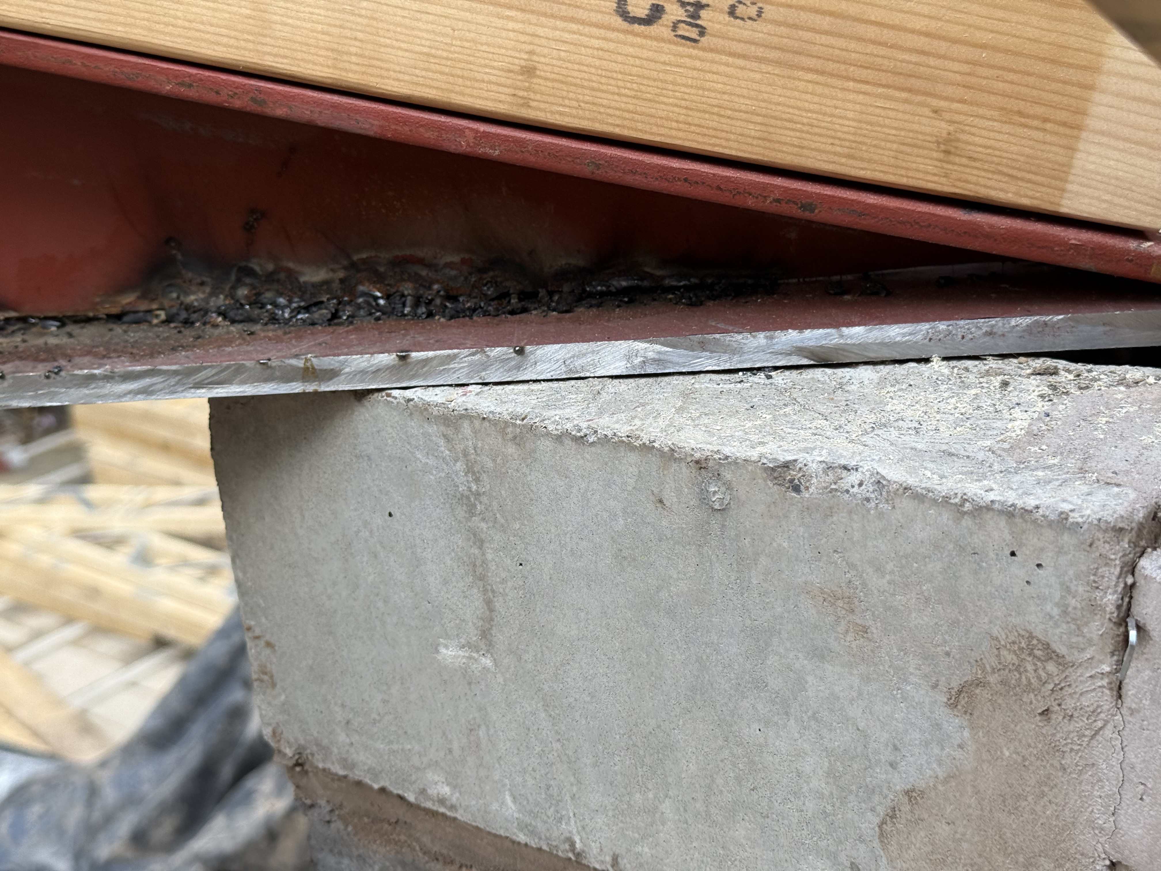

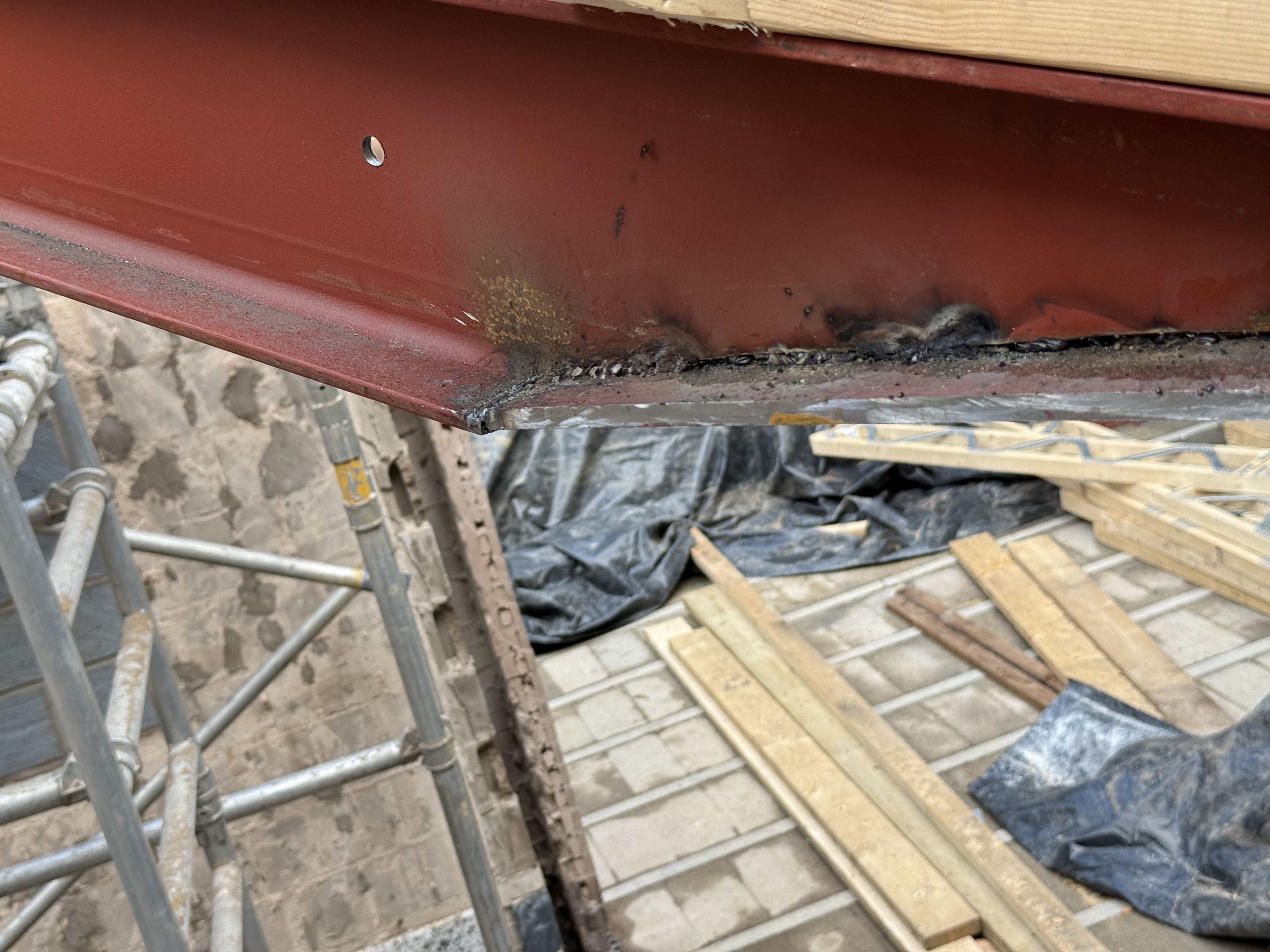

boxrick Posted July 26, 2025 Author Posted July 26, 2025 To add to this, the valley beam which has the posis rested on it, it's been welded at the bottom with this thing. So perhaps not as bad as it initially looked, but still far from ideal.
Kelvin Posted July 26, 2025 Posted July 26, 2025 That’s awful welding. You need to get an independent assessment of the whole build to this point while it’s still fixable. And I really doubt your builder is actually capable of fixing this without someone standing over him checking everything he does. 6
JohnMo Posted July 26, 2025 Posted July 26, 2025 7 minutes ago, Kelvin said: awful welding Yep. A hammer would knock that apart, technical term is pigeon sh!t. Deffo need your structural engineer to visit - be prepared to sack your current builder, I doubt they have the skills to put things right, even when pointed in the correct direction. 1

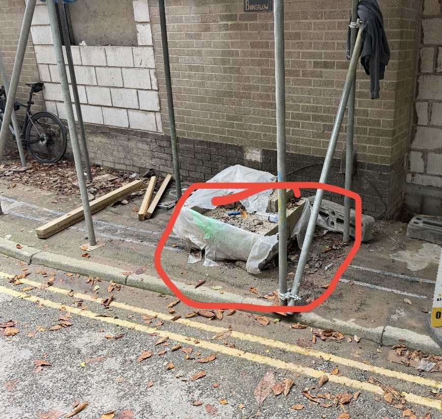

Conor Posted July 26, 2025 Posted July 26, 2025 Is that pic of the scaffold /mess on a public footpath road?! Unacceptable. When you say the steel valley was "not in any SE plans or similar", do you mean the beam or the modification? It does look like everything has been cobbled together with very little planning, care, skill or thought.
Iceverge Posted July 26, 2025 Posted July 26, 2025 The scaffold appears to have no cross bracing and the nearest leg is a stiff breeze from slipping off the footpath and see-sawing on 3 legs or falling over. It's a serious hazard to the public. I wouldn't them play with my Lego. There's a worrying lack of the fundamentals. It's really disappointing and I'm sorry it's happened. Can you tell us more about the contractor? Do any of the following apply? 1. Avail at quite short notice. 2. Cheaper than any other quotes. 3. References were in writing or over the phone, not in person on site of an existing project. 4. They dismissed the need for independence oversight from your Architect or Engineer as unnecessary. I fear they'll disappear into the ether when challenged. For now the utility connection is a very small priority and I would prepare mentally that this debacle may set you back the full cost of the roof and months of delay. Again, it's unfortunate to see such unscrupulous operators out there chancing this. 1

Mike Posted July 27, 2025 Posted July 27, 2025 20 hours ago, boxrick said: the valley beam which has the posis rested on it, it's been welded at the bottom with this thing. So perhaps not as bad as it initially looked, but still far from ideal. I wouldn't describe that as welding. It's also unacceptable.
