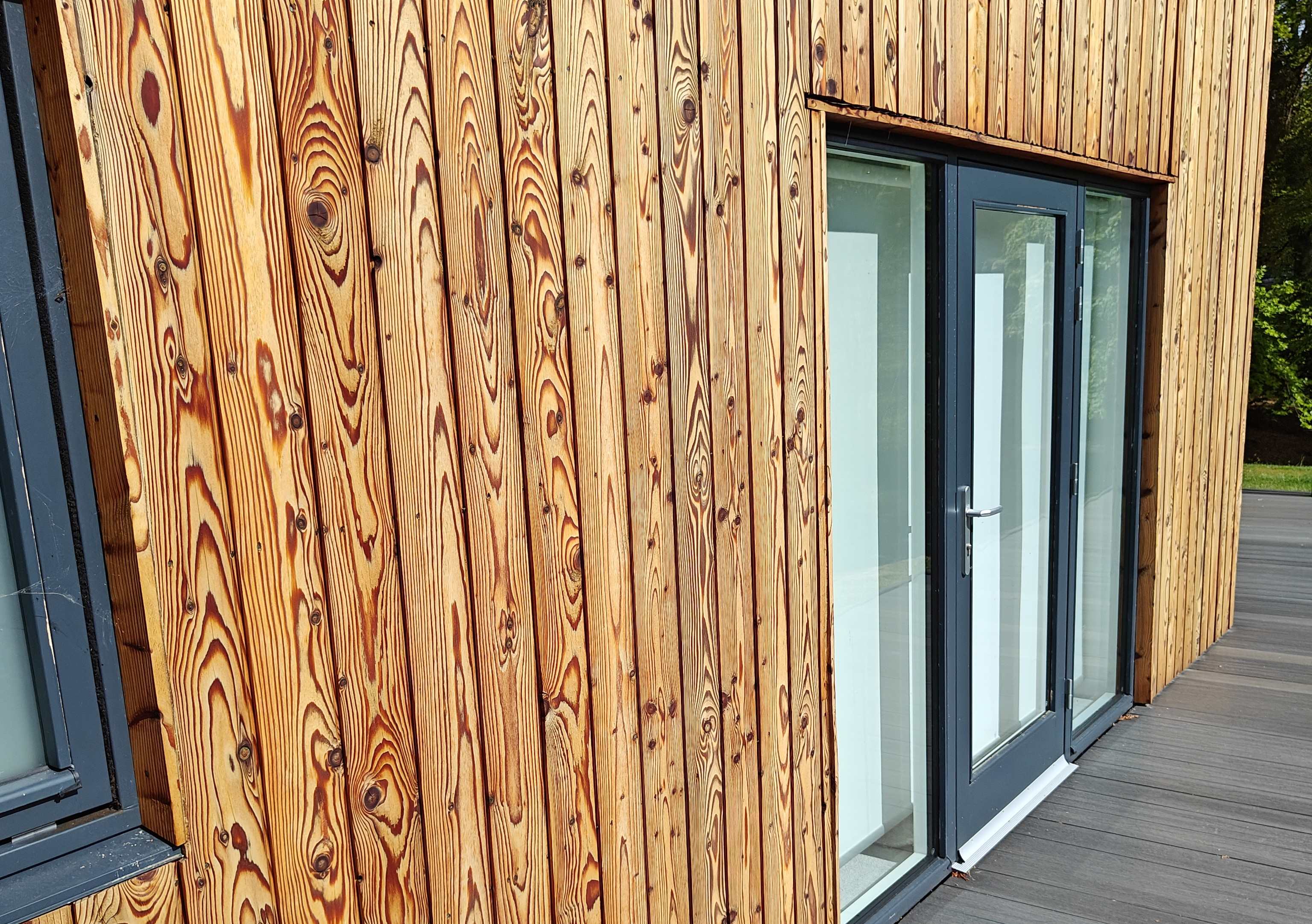

G and J Posted May 4, 2025 Posted May 4, 2025 1 hour ago, JohnMo said: there is enough upkeep with the larch cladding 😱 we're planning larch cladding to reduce the upkeep from our current cream rendered house........what do you have to do??
JohnMo Posted May 4, 2025 Posted May 4, 2025 (edited) 37 minutes ago, Nick Laslett said: Have you got aluminium fascia and soffits? Decent uPVC, not wood grain. Look identical to our spray paint wooden windows. Edited May 4, 2025 by JohnMo
JohnMo Posted May 4, 2025 Posted May 4, 2025 8 minutes ago, G and J said: 😱 we're planning larch cladding to reduce the upkeep from our current cream rendered house........what do you have to do?? We have larch, but don't want it grey. So coat with ceder oil.

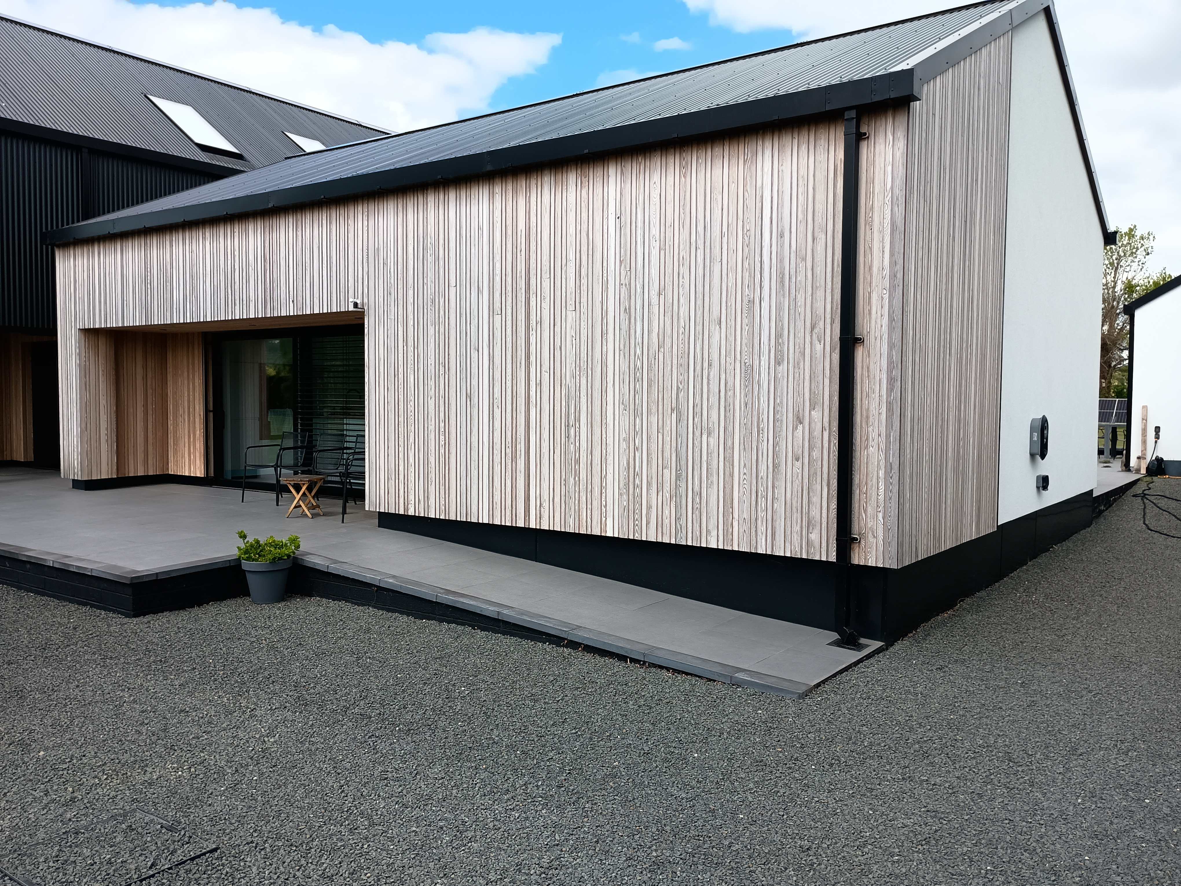

Bramco Posted May 4, 2025 Posted May 4, 2025 20 minutes ago, JohnMo said: We have larch, but don't want it grey. So coat with ceder oil. We have larch but didn't want it grey. So had it treated with Sioox by Russwood our supplier. 3 years in and it just looks bleached...

G and J Posted May 4, 2025 Posted May 4, 2025 1 hour ago, Bramco said: So had it treated with Sioox by Russwood our supplier. 3 years in and it just looks bleached... That's we're planning, which sioox did you use original or one of the greys.....cheeky but any chance of a piccy (sorry to divert thread)
JohnMo Posted May 4, 2025 Posted May 4, 2025 1 hour ago, Bramco said: We have larch but didn't want it grey. So had it treated with Sioox by Russwood our supplier. 3 years in and it just looks bleached... Our south facing wall, been there for 4 years, 2 coats of ceder oil only basically after a year then at 3 years. Single coat each time. Photo taken today 1
Bramco Posted May 5, 2025 Posted May 5, 2025 21 hours ago, G and J said: cheeky but any chance of a piccy (sorry to divert thread) You can see under the overhang that it is still in the process of greying out - it needs light for the sioox process to work. 1
G and J Posted May 5, 2025 Posted May 5, 2025 This is very much what we are hoping our end result will be...ta for pictures. Just shows what a great material wood is allowing us each to personalise to our own preferences. Thanks also to @JohnMo for the contrast image.
Roundtuit Posted May 5, 2025 Posted May 5, 2025 23 minutes ago, Bramco said: You can see under the overhang that it is still in the process of greying out - it needs light for the sioox process to work. It's atmospheric moisture rather than sunlight I believe. I misted under the eaves with a hosepipe occasionally to speed up the process.
