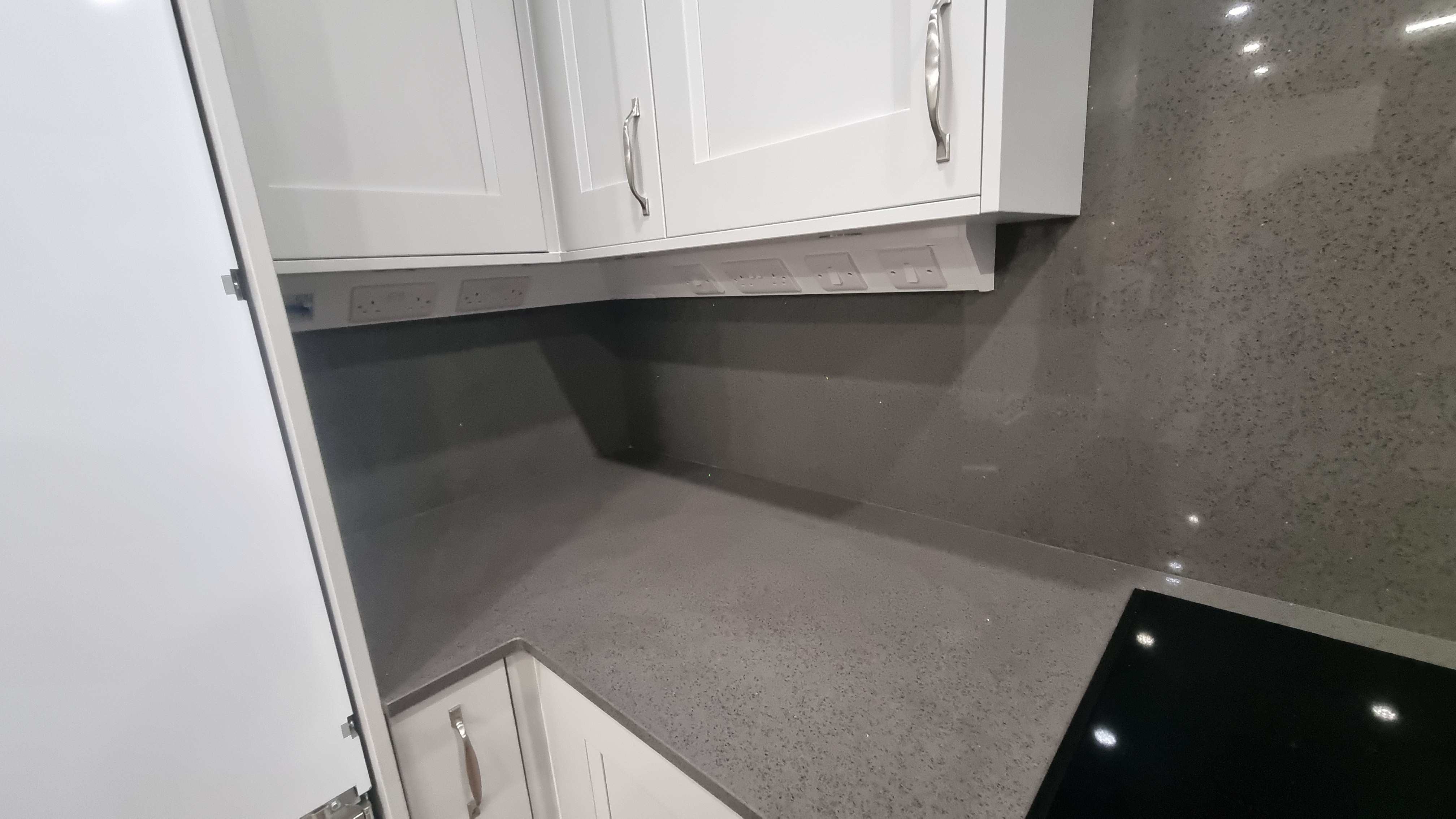

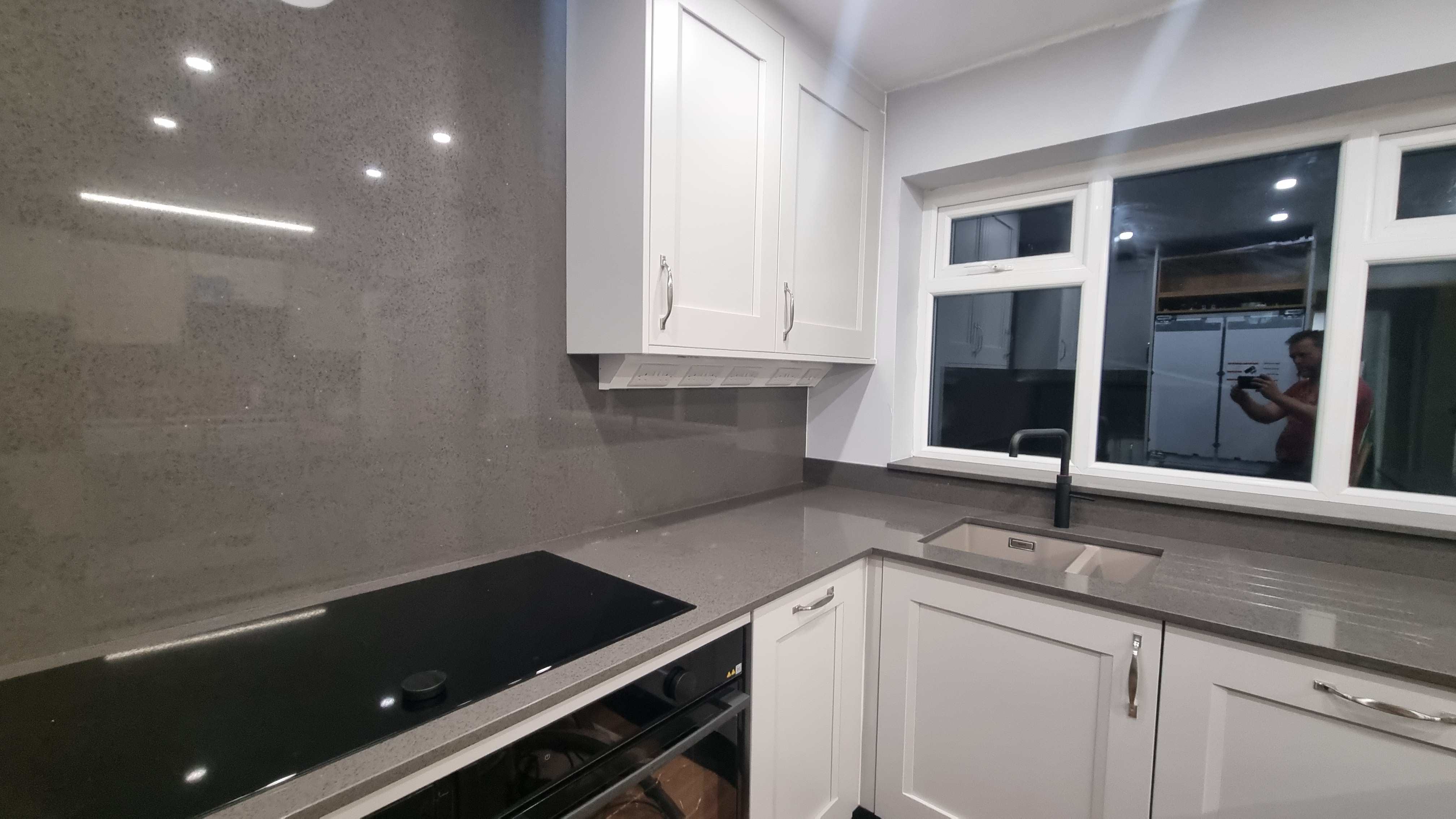

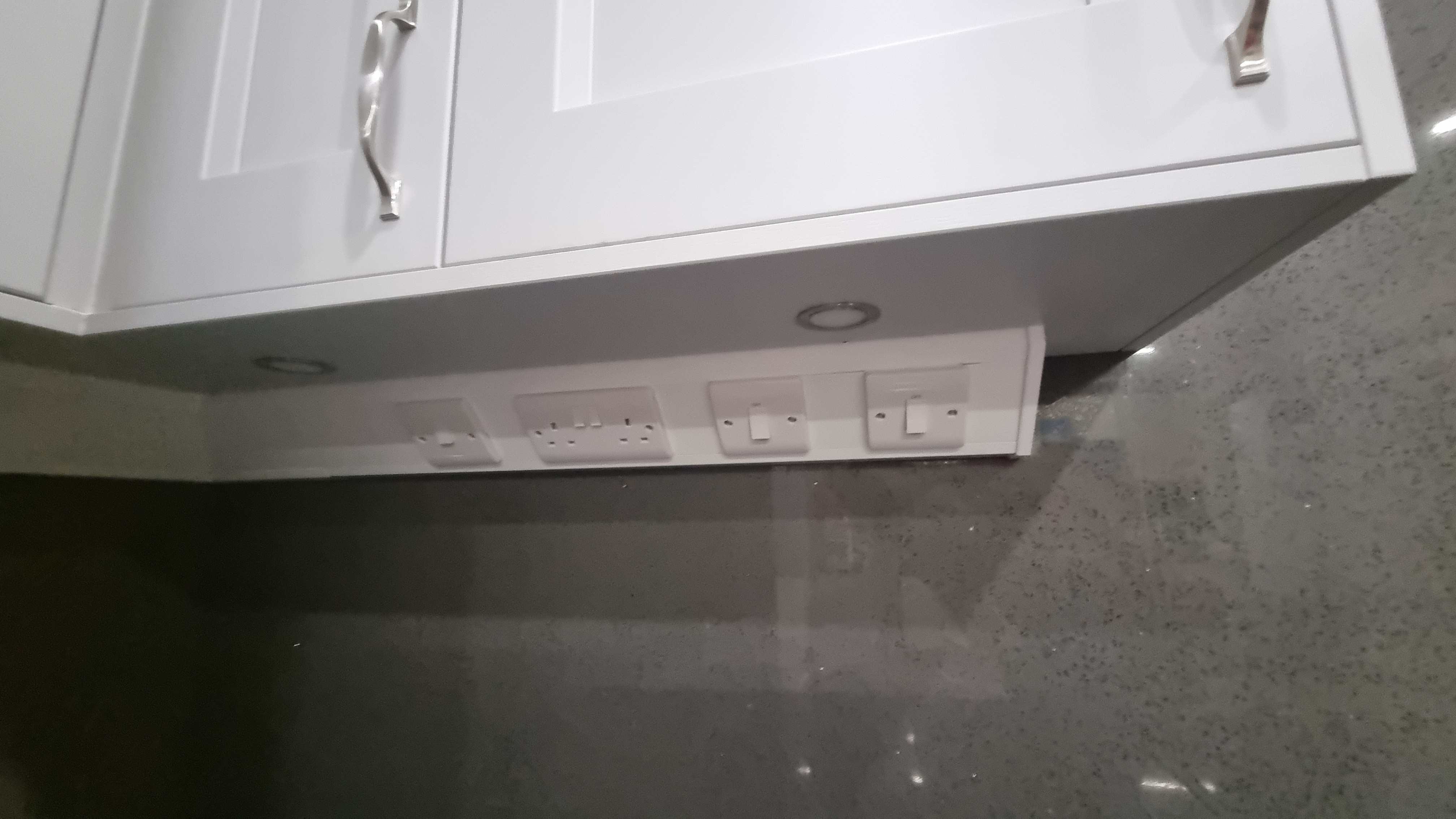

FuerteStu Posted March 4, 2025 Posted March 4, 2025 I've recently finished my kitchen and did something I've had lots of comments about.. I didn't have any sockets, spurs or Isolators in the splashback. Instead, they are all tucked away under the cabinets in bench trunking. It allows for future adaptations without redecorating (there are conduit drops from inside to below countertop) I was planning a trim along the bottom so it wasn't even in eyeline, but it barely notices as it is. Makes cleaning so much easier
BotusBuild Posted March 4, 2025 Posted March 4, 2025 I'd have to keep ducking down to use those, and I'm only 5'9"! Neat idea though
