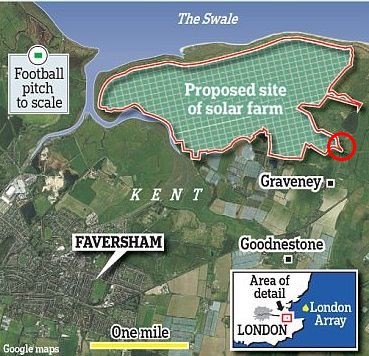

To approve or not approve that is this week's question.
Well next week I will pop along to the local consultation event for UK's largest solar farm which will be just down the road from Whitstable in Graveney. It will have 350MW, 4 x the current largest, at peak output and spread over 890 acres. I know what I think - what do you think?
Loads on the Web - neatly balanced description HERE from the Guardian.
