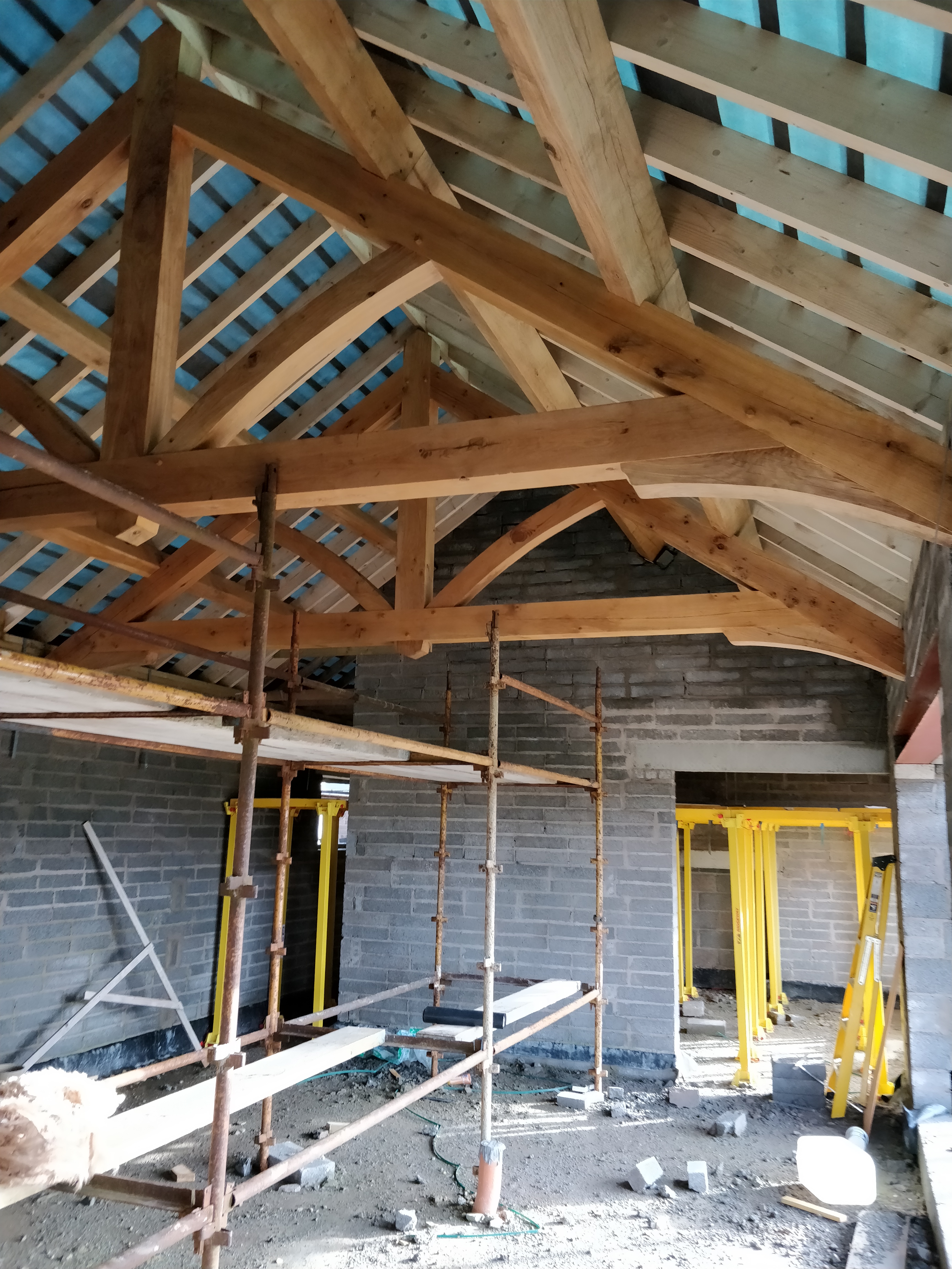

vfrdave Posted November 27, 2017 Posted November 27, 2017 My vaulted ceiling is approx 5m high on a space which is 8m x 5.5m. It's not finished yet as seen in the picture but doesn't seem too high.
