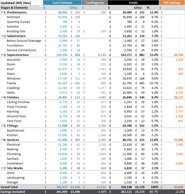

Visti Posted November 4, 2017 Author Share Posted November 4, 2017 So! Thanks to you all the cost estimates have been revisited following the suggestions here and we've managed to plug some line items with quotes. We're now in a position whereby we're confident we can continue with the self build without compromising the key elements of the house nor going bankrupt. It ought to allow us to potentially take some knocks on the way if (when!) they occur. It isn't perfect by a long shot, though it feels a lot more realistic than the Quantity Surveyor and will be a good baseline for moving forwards. It'll probably creep up by ~£100/m2 through discretionary spending, but at least that wont be hidden! If anyone wants access to the excel model they're welcome to a redacted copy placed on Google Drive here. It could use some additional functionality for identifying estimates vs quotes vs actual's which I'm sure will be built in in time. 1 Link to comment Share on other sites More sharing options...
oldkettle Posted November 4, 2017 Share Posted November 4, 2017 @Visti, one position I don't understand here is Walls - what does it cover? Link to comment Share on other sites More sharing options...
Ferdinand Posted November 4, 2017 Share Posted November 4, 2017 @Visti Could you give us a quick summary on the main savings you have kept. Some of those have gone back up again - eg you have got your posh kitchen back . F Link to comment Share on other sites More sharing options...
Jeremy Harris Posted November 4, 2017 Share Posted November 4, 2017 Also, you still have the foundations and frame separately costed. Bear in mind that, if going for an MBC frame it will include a passive slab foundation (and usually UFH pipes). Link to comment Share on other sites More sharing options...

dpmiller Posted November 4, 2017 Share Posted November 4, 2017 On my quote from MBC, frame and founds are two very separate prices. Link to comment Share on other sites More sharing options...

Mr Punter Posted November 5, 2017 Share Posted November 5, 2017 17 minutes ago, Visti said: That'd be the double layer of plasterboard (£5 - 6.5/m2) and the inner wall acoustics (£4/m2). We may halve this later, but given I'm of the large and accident prone persuasion I do like the idea of walls with a bit more of a sturdy feel to them. About 50%+ of this we plan to save via DIY We have used 15mm Knauf Soundshield Plus in a recent development. You will only need one layer. It is a lot tougher than normal plasterboard - a good compromise between p/board and Fermacell. Link to comment Share on other sites More sharing options...
oldkettle Posted November 5, 2017 Share Posted November 5, 2017 (edited) 35 minutes ago, Visti said: That'd be the double layer of plasterboard (£5 - 6.5/m2) and the inner wall acoustics (£4/m2). We may halve this later, but given I'm of the large and accident prone persuasion I do like the idea of walls with a bit more of a sturdy feel to them. About 50%+ of this we plan to save via DIY Thank you. As wall acoustics is included in "Walls" line why is there a separate "Acoustics" item worth quite a lot even including savings? You will need some between the floors of course, but I think the amount is going to be comparable with the 155m2 line you have for internal walls (smaller size but possibly double layer). Unless you are adding it in the first floor ceiling as well? Edited November 5, 2017 by oldkettle Link to comment Share on other sites More sharing options...
PeterW Posted November 5, 2017 Share Posted November 5, 2017 33 minutes ago, Visti said: -£9k Heating (simplified from ASHP to Gas Boiler) So I take it you went the MCS route ..?? Gas boilers don’t like underfloor heating unless you put a buffer tank in so factor that in ..! Given you’ve said you want to have a big family friendly house, unless you go very big on the boiler, a combi will not cut it for DHW so you are back to an unvented cylinder. A 400 litre UVC with a 9kw ASHP has change out of £3k if you buy right, and it’s much easier to link into UFH. If you have a cellulose filled frame, heating is the least of your concerns ! Link to comment Share on other sites More sharing options...
