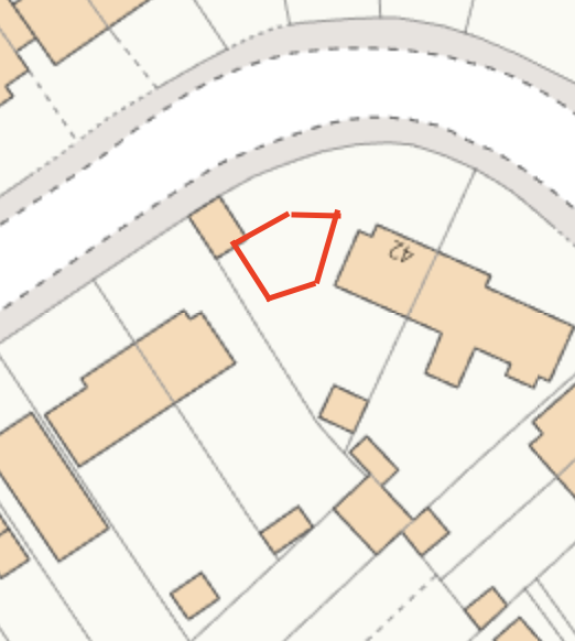

Rachieble Posted August 21, 2024 Share Posted August 21, 2024 I have the chance to buy this plot. Because of the way the road runs around a corner, any new build would be forward of the principle elevation of the house next door. I'm proposing a detached house of the orientation shown in red. It doesn't violate the 45 degree rule so no loss of light issues. Is there any way this might get planning? Link to comment Share on other sites More sharing options...
MikeGrahamT21 Posted August 21, 2024 Share Posted August 21, 2024 Ask the local planning department for pre-planning advice. I'd say if this is a residential area, and it matches in with the other properties on the street, i can't see why it wouldn't get passed, the plot looks big enough to take it Link to comment Share on other sites More sharing options...
torre Posted August 21, 2024 Share Posted August 21, 2024 Potential issues are likely to be around over-development, negative visual impact, highway safety, parking. I'd draw a line following the front line of properties left of pic and try and plan within that, which probably means building closer to your neighbour, planners would probably baulk at anything intruding closer to the corner than that. Is there any negative planning history for the site or nearby? Are you in a conservation area? There's inevitably a fair bit of risk (and cost). What are your plans and particularly what's your plan B if you can't get permission? If you're going to live in one or the other, would you be happy falling back to a large extension or terraced property that wraps around that corner? 1 Link to comment Share on other sites More sharing options...
Conor Posted August 21, 2024 Share Posted August 21, 2024 Does it have access? Id have thought you'd have no chance of meeting visibility splay requirements around the corner. Link to comment Share on other sites More sharing options...
Rachieble Posted August 21, 2024 Author Share Posted August 21, 2024 59 minutes ago, torre said: I'd draw a line following the front line of properties left of pic and try and plan within that, which probably means building closer to your neighbour, planners would probably baulk at anything intruding closer to the corner than that. Is there any negative planning history for the site or nearby? Are you in a conservation area? There's inevitably a fair bit of risk (and cost). What are your plans and particularly what's your plan B if you can't get permission? If you're going to live in one or the other, would you be happy falling back to a large extension or terraced property that wraps around that corner? That's not possible as the owner of the existing house wants to keep their house separate (so the new house has to be detached) and keep the garden behind their house. So the only place to build this house is where I've shown. I would be buying with a 'subject to planning' option agreement so there would be no plan B. Without planning I wouldn't buy the plot. I'd only be buying the plot, not the house as well. Link to comment Share on other sites More sharing options...

garrymartin Posted August 21, 2024 Share Posted August 21, 2024 4 minutes ago, Rachieble said: Yes, it has direct road frontage all the way along. Generally, any vehicular crossing point cannot be within 10m of the corner of a street, 15m of the corner of a more major road. Link to comment Share on other sites More sharing options...
Russell griffiths Posted August 21, 2024 Share Posted August 21, 2024 I would say there isn’t enough room to satisfy parking or amenity land needed for the dwelling. Link to comment Share on other sites More sharing options...
Rachieble Posted August 21, 2024 Author Share Posted August 21, 2024 12 minutes ago, garrymartin said: Generally, any vehicular crossing point cannot be within 10m of the corner of a street, 15m of the corner of a more major road. That's not an issues. We will take the existing house's drive and dropped curb which is currently to the side of their house. 1 Link to comment Share on other sites More sharing options...
Rachieble Posted August 21, 2024 Author Share Posted August 21, 2024 (edited) 14 minutes ago, Russell griffiths said: I would say there isn’t enough room to satisfy parking or amenity land needed for the dwelling. There's no issue with parking - there's loads of room to the front - 48m2, easily enough for 2 spaces (the local requirement) after building the house. The image is deceptive. The red outlined area is 50m2 so it's still a reasonable sized garden (about 26m2 to the rear plus another 5m2 to the side). Overall therefore the garden and amenity land/parking is nearly 80m2. Edited August 21, 2024 by Rachieble Link to comment Share on other sites More sharing options...
Mr Punter Posted August 21, 2024 Share Posted August 21, 2024 If the red outline is the the proposed new dwelling could you also show the proposed site? Link to comment Share on other sites More sharing options...
Conor Posted August 21, 2024 Share Posted August 21, 2024 40 minutes ago, Rachieble said: That's not an issues. We will take the existing house's drive and dropped curb which is currently to the side of their house. You can't do that, new dwelling needs it's own independent vehicular access which needs to meet current highway standards. Unless they are selling that as part of the site and they have an alternative access? Link to comment Share on other sites More sharing options...
ProDave Posted August 21, 2024 Share Posted August 21, 2024 There is a "building" shown in the corner of the existing plot. Is that a garage for the existing house built right up to the road? If so that will be in your favour as the building line and visibility is already breached. Where will the existing house park? I expect both would have to share the same entrance as I doubt a new one would be allowed closer to the corner. Make an offer "subject to planning" and submit a planning in principle application. If that is rejected you can walk away with little cost. A suitably anonymised streetview screen grab might help. 1 Link to comment Share on other sites More sharing options...
TommoUK Posted August 21, 2024 Share Posted August 21, 2024 The building line looks too close to the road and even as it stands the rear garden would be tight? Draw the plot boundary in between your plot and the sellers plot and see what your left with. Link to comment Share on other sites More sharing options...

Dave Jones Posted August 23, 2024 Share Posted August 23, 2024 2 issues jump out, highways and a new access on the bend. space for at least 1 car (if its a 1 bed) to turn around in. The rear will be overlooking neighbours amenity space. Link to comment Share on other sites More sharing options...
