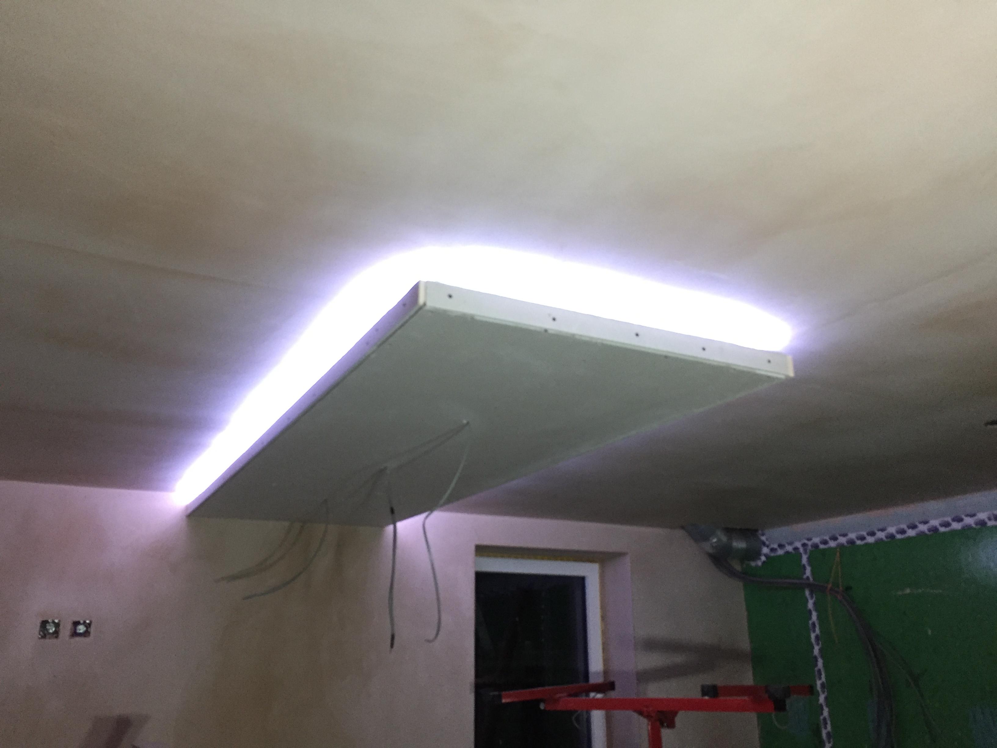

Barney12 Posted December 14, 2017 Author Posted December 14, 2017 Thought I'd update my thread. Stupidly forgot to take photo's of all the construction phase but its now in and ready to be skimmed tomorrow. The RGBW LED strip has been installed in advance as it was easier to fit that before screwing up to the frame and boarding. Another job where the plasterboard lifter was invaluable.

Barney12 Posted December 14, 2017 Author Posted December 14, 2017 On 14/12/2017 at 18:54, Luckylad said: Got to love a plasterboard lifter! These drop downs are always an interesting challenge for plasterers Expand LOL. Yes my plasterer was completely lost by what I wanted. Even my sketch on the back of an envelope left him scratching his head. I had the ceiling skimmed first, plus the drop down outer reveal. I then put the drop frame up and boarded it (as per above picture) He’s coming in the morning to skim that and a few last bits.

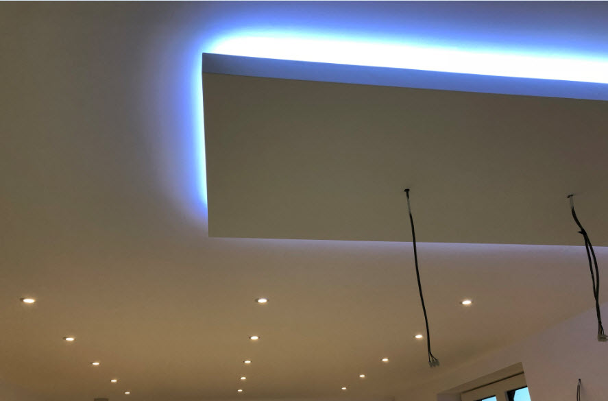

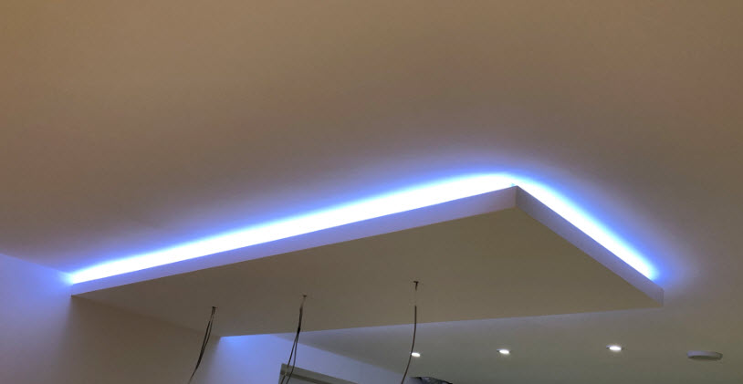

Barney12 Posted February 14, 2018 Author Posted February 14, 2018 (edited) Looking pretty now its plastered and painted. Edited February 14, 2018 by Barney12 5
