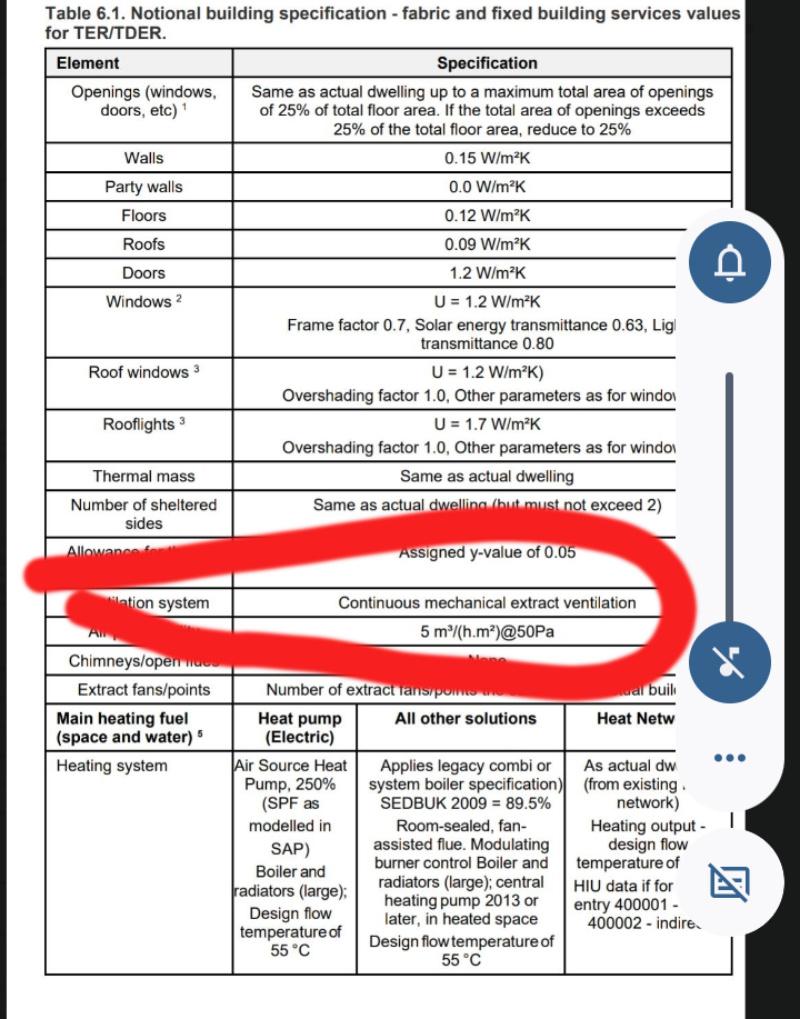

MikeSharp01 Posted April 12 Share Posted April 12 They actually mention "Thermal Mass" without stating any units. Also the 0.09 for roofs is going to be challenging as is the 0.0 for party walls I wonder what the assumption is there then? Link to comment Share on other sites More sharing options...
MikeSharp01 Posted April 12 Share Posted April 12 1 hour ago, Nick Thomas said: Excellent news. Now do England Great idea and the large housebuilders will need jump even further than they would if they had allowed the earlier attempt at it.. Link to comment Share on other sites More sharing options...
ADLIan Posted April 12 Share Posted April 12 Heat loss from (cavity) party walls has been in the Regs for many years - all linked to air movement within, into and out of the cavity. Fully filling with mineral wool and sealing the wall edges are deemed to give zero U-value. Description here Link to comment Share on other sites More sharing options...
ADLIan Posted April 12 Share Posted April 12 Thermal Mass is actually 'thermal mass parameter' used within SAP. Based on the heat capacity of internal linings (kJ/m2K), area of each element and total floor area. In older versions of SAP it was broadly classified as low, medium or high depending upon construction method but now has to be calculated more precisely. Link to comment Share on other sites More sharing options...

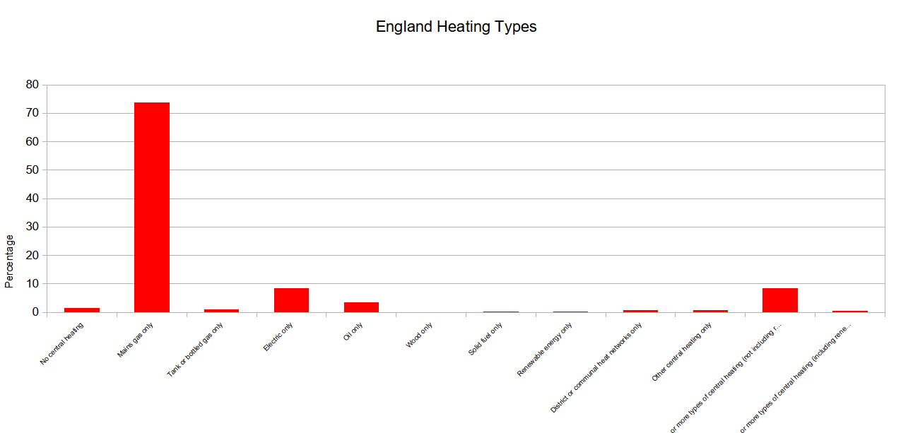

SteamyTea Posted April 12 Share Posted April 12 The ONS has some numbers on heating types. Here is a quick analysis for England. Type of central heating in household (13 categories) Number No central heating 367119 Mains gas only 18298730 Tank or bottled gas only 260108 Electric only 2113123 Oil only 865944 Wood only 35720 Solid fuel only 49469 Renewable energy only 98729 District or communal heat networks only 220893 Other central heating only 225399 Two or more types of central heating (not including renewable energy) 2113324 Two or more types of central heating (including renewable energy) 134659 1 Link to comment Share on other sites More sharing options...

Jenki Posted April 15 Share Posted April 15 On 12/04/2024 at 21:53, Iceverge said: Apart from this bit. Like @Kelvin says. Our PHPP predicts 2625kWh/m2/Annum at the moment. If I put the limiting values in for Air permeability and ditch the MVHR it goes to 7525kWh. It really is the lowest hanging fruit. Far more so than super insulation. @Kelvin and @Iceverge have, IMHO highlighted the glaring omission. Just using the heat loss calculation spreadsheet easily shows the importance of airtightness. Once you plug in the required U value, even slight improvements in airtightness have real positive impacts on heating requirements. Even to a point where lesser levels of insulation can still achieve lower running costs with better airtightness. I think the changes should have focused more on heat loss giving the designer more flexibility to balance u values and airtightness to achieve an efficient solution. The cynic in me would suggest a bit of lobbying from the expensive insulation manufacturers added more weight to the argument. For my build Airtightness was, in material costs, relatively inexpensive to achieve, but labour and attention to detail expensive. And "no body" would be lobbying for that. Link to comment Share on other sites More sharing options...
Kelvin Posted April 15 Share Posted April 15 My cynical view too. Plus better insulation is easier to understand for the average home buyer and easier to achieve for your average builder. I also think some of this is because they knew that setting a much better airtightness target wouldn’t be achievable by the building industry. Also when you get to three or below you increasingly need active ventilation which adds to the complication and cost. An opportunity missed imo. Link to comment Share on other sites More sharing options...
Jenki Posted April 15 Share Posted April 15 4 minutes ago, Kelvin said: Also when you get to three or below you increasingly need active ventilation which adds to the complication and cost. An opportunity missed imo. They have changed the ventilation as well. Link to comment Share on other sites More sharing options...
Kelvin Posted April 15 Share Posted April 15 I never spotted that on first reading. Makes even less sense then to go with such a poor airtightness target. Link to comment Share on other sites More sharing options...
ProDave Posted April 15 Share Posted April 15 Air change less than 3 in Scotland triggers the need for MVHR, so the mass builders will aim for just under 5 to pass without it. Link to comment Share on other sites More sharing options...
