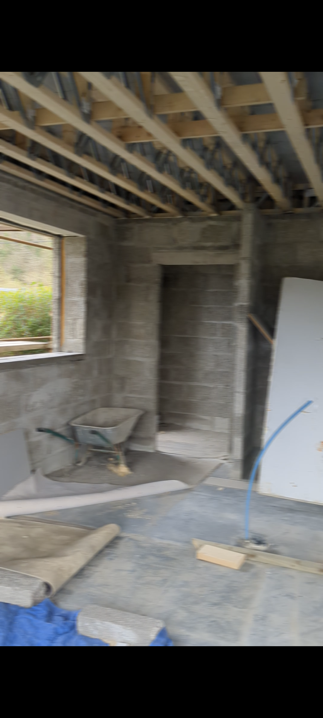

Originaltwist Posted April 22 Share Posted April 22 For me it's about the triangle thing in your workspace - fridge, cooker, sink. Heres one I did earlier, and it worked really well  Link to comment Share on other sites More sharing options...
