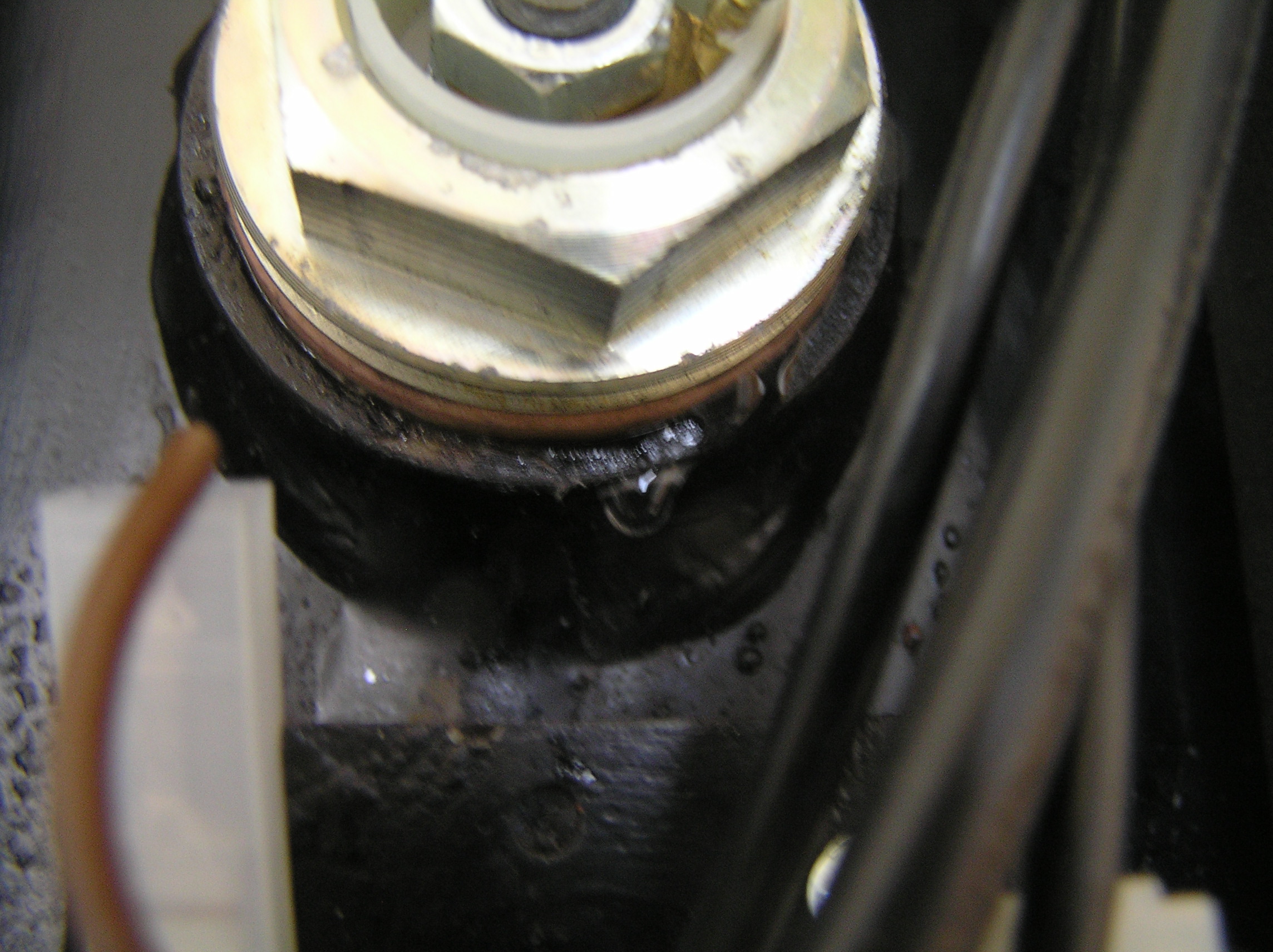

As an update to the purchase of the Genvex Combi from Denmark, we had a problem with the hot water tank leaking around the anode. I emailed the suppliers (Sundthus) who wanted evidence, so I uploaded a short video showing the leak. They helpfully told me the anode needed refitting. I asked them what they could do under the two year warranty and they told me I would have to send the unit back to their workshop in Denmark for repair. As it weighs 210kg and is bulky that's not realistically an option for a small leak. I then asked for more clarification and they haven't replied. I was hoping for a small refund but I guess the savings I made in buying it from Denmark is my guarantee. So if purchasing something large from Europe check on the warranty conditions in case something goes wrong. I was very surprised that a UVC made by Genvex leaked at two bar when it's rated at 12 bar.

@Moira Niedzwiecka and @Luckylad unfortunately the saga with Sundthus has meant I haven't been able to get it going yet so we're still waiting to see how effective it is. Maybe @Nickfromwales can help me with carrying out the repair. The UVC is enamelled steel with a welded boss for the anode. Is it okay to clean up the thread and wrap PTFE tape round the anode and reinstall it? I wasn't sure if that was okay because the tank is rated to 12 bar and I don't know how much I can tighten it into a steel tank.

@PeterStarck, it looks as if there may be a fibre washer under that anode, so it could be something as simple as just removing the anode, checking the fibre washer and refitting it after a bit of a clean.  It may even be that the anode just needs to be tightened slightly, say 1/4 of a turn, to seal on to the washer properly.
Failing that, removing it,  wrapping PTFE tape around it and refitting it would almost certainly fix it.
+1.
The reason it's a fibre washer is because the anode is sacrificial, so will need inspecting and replacing with some frequency. I'd try taking the anode out, filing the mating steel surface to get rid of any imperfections, dabbing a bit of hammerite on the then exposed metal and reinstall with a new fibre washer.
Do NOT use any lubricant or jointing compound as the fibre washer will displace outwards when you rotate it and it tightens. ;). It needs to be clean and as dry as possible to seal.
Peter, I've access to various large fibre washers if you need another. Just tell me the dia and I'll see what I can get.
