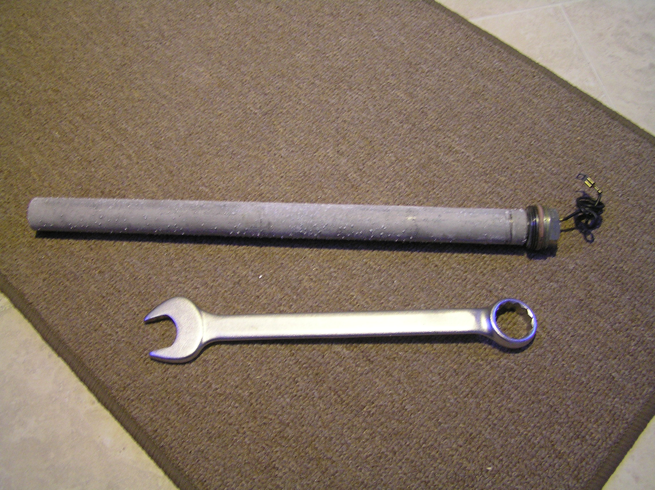

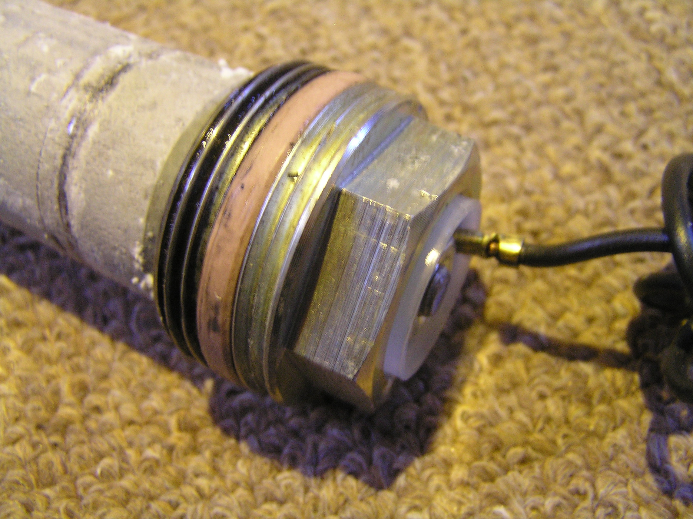

As a change from hanging the wet room door, oak doors are heavy! I took the anode out of the Genvex and the seal on the anode thread is a sort of hard rubber band. Maybe it just wasn't done up tight enough, although how it could have been pressure tested to 12 bar I don't know. I shone a torch inside the tank and another thing that surprised me was the immersion must be inside a tube so it's a dry immersion. Never seen that before.
As an update I have refitted the anode and I have tightened it significantly more than it was before. I have removed the 1kW 'immersion' and it is in fact a dry well or pipe heater so no need to drain the tank if replacing it. @Moira Niedzwiecka when I fill it and get it going, some time next week I expect, I will get back with how effective it is. As an aside Total Home Environment have an ex test Genvex Combi 185 S for sale at £5040.
