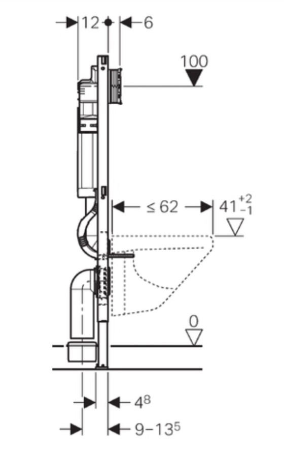

November 2, 20179 yr At a push the soil pipe will fit into about 150mm. The catalog shows the min/max of 90-135mm for the centreline of the soilpipe. If you add 55mm onto that then you’re at 145mm or about 25mm thicker than the cistern itself. https://catalog.geberit.com/public/product.aspx?cat=GB_GB-en_1&ch=CH3_100902&p=PRO_100833 If you are putting them back to back you may struggle with soil pipe separation to meet building regs.

November 2, 20179 yr Thanks @PeterW that drawing has made everything alot clearer. Are you referring to building regs for soil pipes joining the main stack? I can't see anything referring to two soil pipes running next to each other i.e. before they join the stack....but then I haven't read the whole lot just yet.....

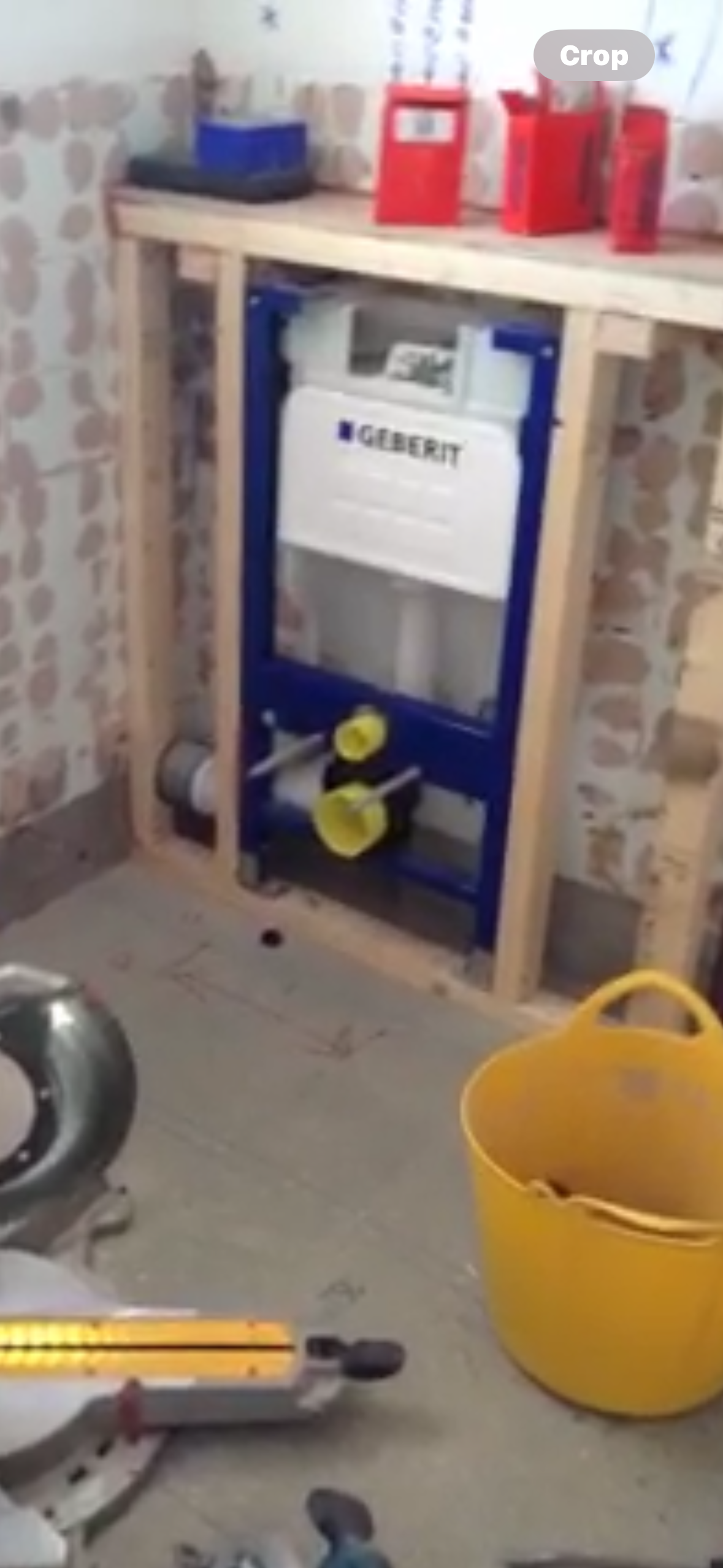

November 3, 20179 yr 46 minutes ago, Temp said: When you push the WC up against the wall it tends to push the flush pipe back into the wall. I'd recommend a brace behind the flush pipe to prevent this. Likewise the soil pipe. Negatory . The full frames have the cistern outlet moulded as a solid section of the cistern which faces forward. It's clipped to the metal frame and doesn't move a mm. The black soil bend is shown loose here, but gets locked into position by a horseshoe clip and doesn't budge. What you get left after boarding / tiling. The geberit supplied pan connector pushes into the larger hole, cut to length to suit, and likewise with the supplied flush pipe. Plenty of silicone grease on the ends and the pan slips onto them like a hand in a glove. Bingo.

March 15, 20251 yr On 03/11/2017 at 14:54, Nickfromwales said: The black soil bend is shown loose here, but gets locked into position by a horseshoe clip and doesn't budge. That looks like the soil pipe runs up hill in the white flexi section is that allowed, acceptable, inevitable, to be avoided or what?
March 15, 20251 yr 18 minutes ago, MikeSharp01 said: That looks like the soil pipe runs up hill in the white flexi section is that allowed, acceptable, inevitable, to be avoided or what? The pan connector was laying on the floor It was later lifted up and into the receiver, and clipped in, locking it into place with a fall. I put some membrane against the wall, and pumped a load of foam under and behind the flexi so it couldn't ever drop / droop with time and use etc. I only used a flexi there as 2x 45 or 30 or even 15 degree bends couldn't get me lined up right for a rigid installation.

March 15, 20251 yr @MikeSharp01 A shit pic, but shows the final fitment and a decent fall. Nothing went anywhere other than downhill I assure you 🤣
