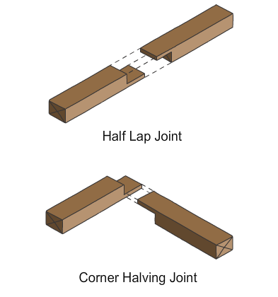

ToughButterCup Posted September 26, 2017 Posted September 26, 2017 Just a quick one: does a wall plate (rim joist) have to be a continuous piece of timber? I ask because a visiting rep asked me if I needed the wall plate to be one continuous piece of timber. Maximum uninterrupted run is just under ten meters. Nowhere in the architect's notes does he mention a continuous run of timber for the wall plate. Thanks. Ian
bassanclan Posted September 26, 2017 Posted September 26, 2017 No it doesnt have to be continous. If you try and get a 10m length it will unlikely be straight and probably expensive. You put a half lap joint in where the two timbers meet

bassanclan Posted September 26, 2017 Posted September 26, 2017 It's not a ddifficult joint, but there will be a few of them, you need them on the corners as well, so by the end of the job you'll be a 10/10
Onoff Posted September 26, 2017 Posted September 26, 2017 Here's one I made earlier: It's got galvanised expanded metal stapled to the underside to provide a key to the mortar.
