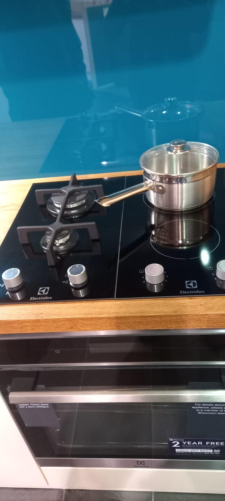

ProDave Posted January 24 Author Share Posted January 24 So in Wickes this afternoon (visiting for something else) we saw this I liked that, and (some will say strangely) the fact the induction unit was controlled by knobs not non tactile buttons. So went to enquire. "Oh that is obsolete can't get that any more" "In that case can I buy that as ex display" "No we would have to get permission from head office to do that" "Well could you phone head office and ask them please" "no" Even finding a second assistant who gave much the same answer did not help. SWMBO almost had to drag me away as I was starting to get angry....... Link to comment Share on other sites More sharing options...
SteamyTea Posted January 24 Share Posted January 24 (edited) 25 minutes ago, ProDave said: The fact it is not made any more says it all. It is hideous, and borderline dangerous. I suspect that the reason you cannot get it is because Electrolux took it of the market. Edited January 24 by SteamyTea Link to comment Share on other sites More sharing options...
ProDave Posted January 24 Author Share Posted January 24 In what way is it dangerous? Link to comment Share on other sites More sharing options...
SteamyTea Posted January 24 Share Posted January 24 4 minutes ago, ProDave said: In what way is it dangerous? Smaller pans can topple of the gas. Look about as good as a camping stove. Link to comment Share on other sites More sharing options...
AliG Posted January 24 Share Posted January 24 The AEG looks like your best bet and can be had here for £671. It is very well reviewed on the AEG site. If it was me I would not be having gas. Just back from two weeks at the in laws. So much less safe than induction with handles getting hot. Way too easy to hit the big sticky up knobs by mistake also and hard to tell what it is set at and if rings are even on under pans. https://www.applianceworldonline.com/aeg-hdb95623nb-black-300084404?/?utm_source=google&utm_medium=cpc&gad_source=1&gclid=Cj0KCQiAh8OtBhCQARIsAIkWb6_n1O10ex3OlP65laYWjQ0JEwl_1b29NPmWV3siHl7vXsGCmlRRyDwaAhcCEALw_wcB If you need 600mm wide then there is the Electrolux hob that was found on eBay and an identical AEG hob, but it seems to be a European import which may affect the warranty. It should come with a 24 month EU warranty here - https://www.vieffetrade.eu/sale/cooker-hobs/electrolux/mixed-hob-cm.-60-_-black-glass-ceramic/kdi641723k/562046 Link to comment Share on other sites More sharing options...
