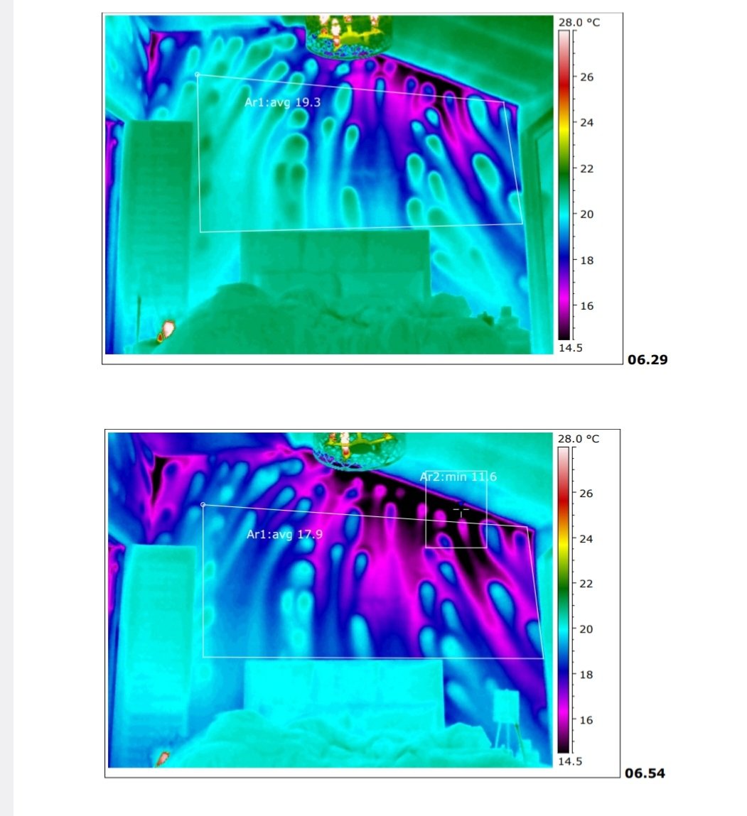

Sparrowhawk Posted December 10, 2023 Share Posted December 10, 2023 Unsurprisingly the promise and the build quality don't match up. Thermal bridging, plasterboard tent. If you can't view/access X (formerly Twitter) here's a readable link to the thread: https://nitter.net/jimmybb/status/1733051913027949027 The image below is from a neighbour's survey. I have never seen dot and dab (with blower door running) highlighted so well. Source: https://twitter.com/sav_ann/status/1733118128199020803 / https://nitter.net/sav_ann/status/1733118128199020803 The thermal imagery is excellent and I am coveting these £18k/£30k thermal cameras. 1 Link to comment Share on other sites More sharing options...

Mr Punter Posted December 10, 2023 Share Posted December 10, 2023 1 hour ago, joth said: Do they mention what the airtightness test result was? Yes it was 3.5 m3/h.m2. These are often extrapolated from a couple of tests. The door threshold looks really poor and was possibly never detailed correctly. Velfac windows have the glass on the very outside of the system so the glass cannot be placed in the insulation zone on a cavity wall. They require very careful and sometime awkward detailing to work well. Plasterboard on dabs is nice and easy to do but useless unless the surface you are fixing to has no outside air. So not blockwork or any holes through to the outside that are not 100% sealed (which they won't be). The "We will put a continuous ribbon of plasterboard adhesive around the perimeter of the boards" never ever happens. Link to comment Share on other sites More sharing options...
nod Posted December 10, 2023 Share Posted December 10, 2023 1 hour ago, Mr Punter said: Yes it was 3.5 m3/h.m2. These are often extrapolated from a couple of tests. The door threshold looks really poor and was possibly never detailed correctly. Velfac windows have the glass on the very outside of the system so the glass cannot be placed in the insulation zone on a cavity wall. They require very careful and sometime awkward detailing to work well. Plasterboard on dabs is nice and easy to do but useless unless the surface you are fixing to has no outside air. So not blockwork or any holes through to the outside that are not 100% sealed (which they won't be). The "We will put a continuous ribbon of plasterboard adhesive around the perimeter of the boards" never ever happens. On all my jobs a continuous line of adhesive does happen I can’t believe we are the only ones doing it right It’s poor management when it doesn’t and really easy to check at any stage afterwards A gentle tap around the perimeter Velfac arnt the best quality windows They are a contract window that most of the big players use and cheap Ive said before on I visit different sites each week and haven’t seen an air test being carried out in the last five years It’s supposed to be 1-7 which is a joke in itself The major house builders get away with it Because the can Most of the new builds that I work on achieve a 2 on the air test Which must be done via a desktop 4 Link to comment Share on other sites More sharing options...

joth Posted December 10, 2023 Share Posted December 10, 2023 6 hours ago, Mr Punter said: Yes it was 3.5 m3/h.m2. These are often extrapolated from a couple of tests. Yeah I get a lot of developer builds aren't tested, I was asking specifically on the second set of thermal camera images which were done during an air test being conducted by the independent consultant. Did they actually measure 3.5 in that post-completion test? Link to comment Share on other sites More sharing options...
saveasteading Posted December 10, 2023 Share Posted December 10, 2023 A proportion of units is air tested. Most likely selected to represent the varying models of house. They are pre-advised so they are ready for testing, and the builder can do these ones reasonably well, for a good figure. These results are then applied to all of the same (untested) houses. (Some people say) the developers have influence related to political donations, hence the rules are not tightened. I'm pretty sure one air tester was suggesting to me that he could arrange ( write down) a better result if persuaded. I can't of course say that happens. 1 Link to comment Share on other sites More sharing options...

Kelvin Posted December 11, 2023 Share Posted December 11, 2023 Having borne witness to a supposed quality team this isn’t in the least surprising. They genuinely think that because there’s a lot of insulation in the building then it must be good by default. When I explained that leaving gaps or even small bits unfilled significantly reduces the U value of the wall/ceiling it just went over their heads. Air tightness was like the dark arts. They are building houses with very little appreciation of building physics. Until the regulations tighten up and every house is properly tested then this isn’t going to improve. 1 Link to comment Share on other sites More sharing options...
