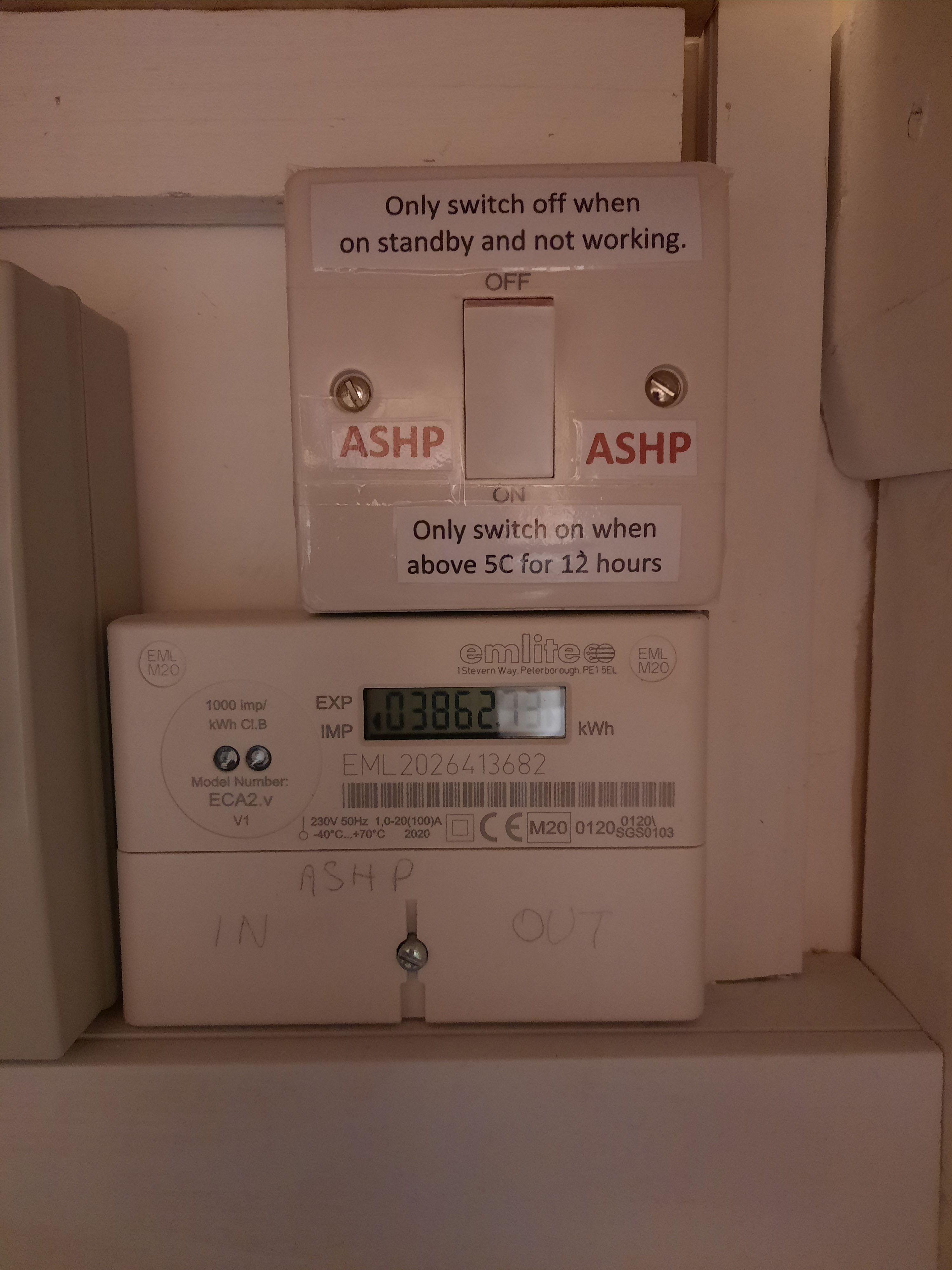

And what does your ASHP installation instructions say about turning on after leaving it off for hours when below 5 degrees Centigrade.....  Mine says don't do it!
Yes if you want to "turn the heating off" for a period, don't flick the big red switch, turn it "off" via some control input while leaving it still powered.  In my case I use the "room thermostat" input to tell it that it is satisfied when I want the heating "off" but the ASHP is still powered and indeed overnight on a cold night it will still periodically start the water circulating pump to prevent a slug of cold / freezing water being left in the outside unit.
Some makes of ASHP use a crankcase heater to warm the compressor before first start up, there was a long thread about this a year or so back as some users were noticing a big unexplained usage even when the ASHP was "off"  but you can't just turn those off at the mains switch without allowing them proper time to warm up before starting.
Mine has a sump heater, and antifreeze, plus below 5 degs it circulates on and off anyway so no mention anything special.
