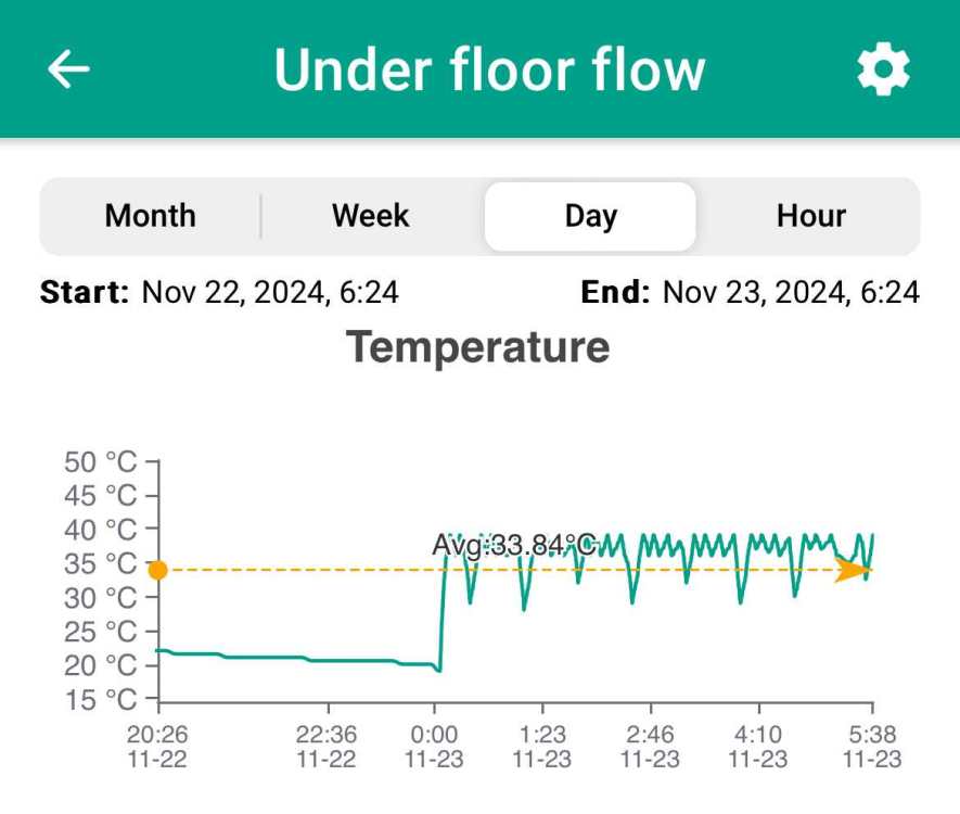

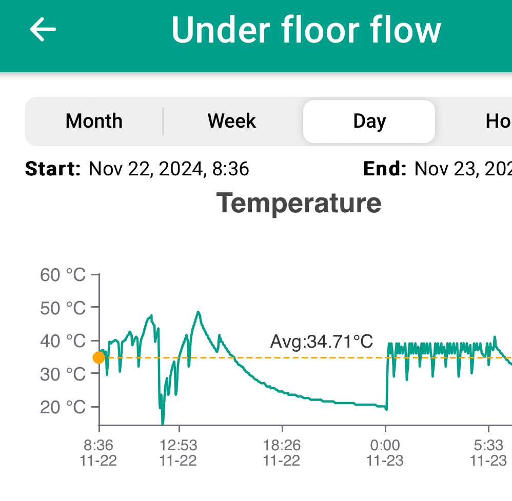

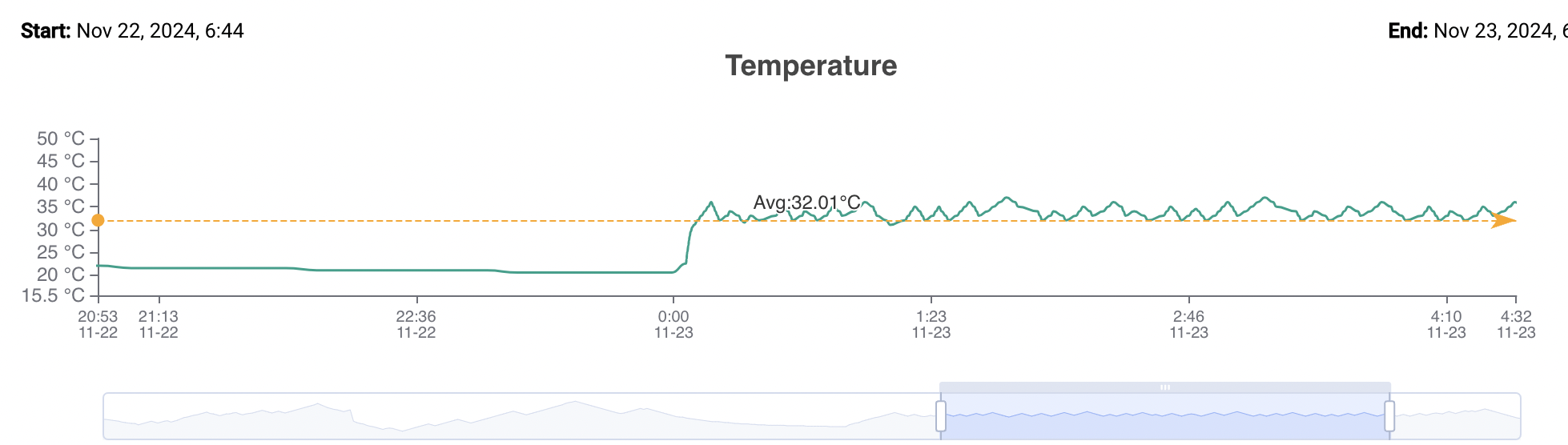

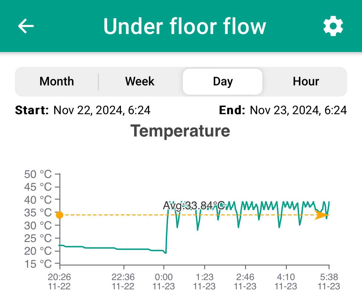

  6. sorry my bad not enough coffee,, yes thats correct at about 0-3 degress and intake is about 14kwh over that period the 10kw pump maxes out full chat and rquires 3 kw -3.2kw for the 5hour stint.
  7. get on an overnight cheap EV =charge rate and run that ASHP full chat charging up your floors during that time .. then step it back during the day.. this could save you some ££ , you have to look at the whole year costs .. ASHP are way more £ to run during cold spells to get temoerature up (hence teh overnight chep tariff) compared to oil or gas IMO , but soon pull that back in late autumn and erly spring so that over the year you should be more economical and cost effect ..
  8. i run my grant arona 10kw heat pump, flat out , between 12.am and 5am using cheap over night electric.. during that periord at about 0-3 degrees it uses 10-14 kw of power.. my thermo stats are all calling for heat higher than it will ever reach .. its just pumping heat into the floors .. i have the weather comp set at 50 degress at -3 external .. this is into my buffer tank , but i have recordeded retirn tems of 40 degrees from teh underfllor loops.. i designed my house to run at Under floor flow temps at 35d at external 3, but this would be leaving it running all the time .. and it works perfectly, , but its way more cheaper for me to utilse the overnight cheap rate and charge up the floors as much as i can for teh 5 hour period then turn it off (cost to last year are about a 1/3 ) I have a large 4000 sqft house. all with under floor heating .. during this perior we heat bathrooms, kitchen , family room , living area .. ( bedrooms dont require heat..they stay warm) the charge into the floor make the whole house snug and warm .. we may light log burner in the evening but this is more creature comfort rather than nessesity.. at the same time over night we charge our 10kw batteries ,, this mostly enough to run our house , do our hot water via teh heap pump and electric cook.. if we get a bit of sun its enough to boost the battery by 30% (7.2kw 5 degree facing west rray) to last out till the 12am charge time.. if not and we do a big electric cook we may need couple of imported kw.. House is new, i(designed by myself )contemporay design, open plan iving areas with solar gain in winter if its sunny .. floors are covererd in either amtico , tiles with carpets in bedroom.. (wood floors what ever they are are just terrible for low grade under floor heat efficiency we learned that mistake the hard way in our last house ) we basically pay about £2-2.30 - britisg gas 0.09p kwh (standing charge aside) deending on temp say 5 degree or under to heat and run our 4000 sq ft house per day .. keeping it super comfy toastie thsi way.. we only really need to heat november / december /jan feb march.. if you woudl like any more details or soe energy graphs ask away, but using over night to pre wrm your house works brilliant, teh more isnulation and draft proofing you do to retain that heat then it has every chance of being your only heat time required.. kind regards Andy
