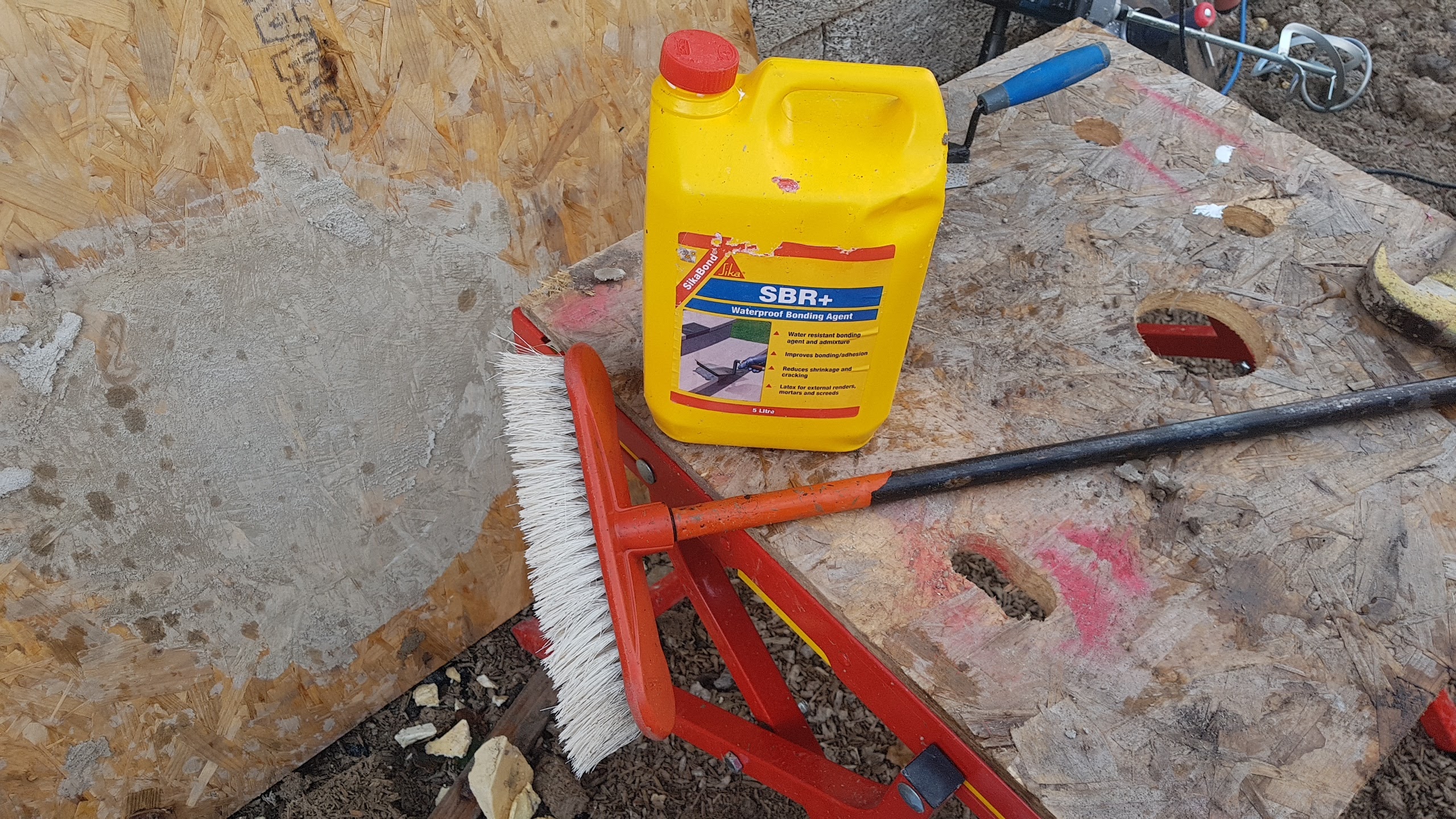

ToughButterCup Posted October 5, 2017 Author Share Posted October 5, 2017 Well, here's the first go at rendering Durisol for airtightness. I used a 4 :1: 1 (or more) mix and applied it with the only brush that was lying around on the site stillage - an old house broom; There's a degree of sloppiness in the mix that's just right It's a very therapeutic process. Until I noticed I was rendering our car at the same time as the wall. She's going to kill me. (If you are reading this Deb, sorry love. I've got some flowers from the petrol station for ya!) 1 Link to comment Share on other sites More sharing options...
Declan52 Posted October 5, 2017 Share Posted October 5, 2017 Always used a masonary roller for that job. Link to comment Share on other sites More sharing options...
ToughButterCup Posted October 5, 2017 Author Share Posted October 5, 2017 Trip to B+Q or Screwfix coming up then: 240 square meters to do on the main house. Thanks for the nudge @Declan52. Link to comment Share on other sites More sharing options...

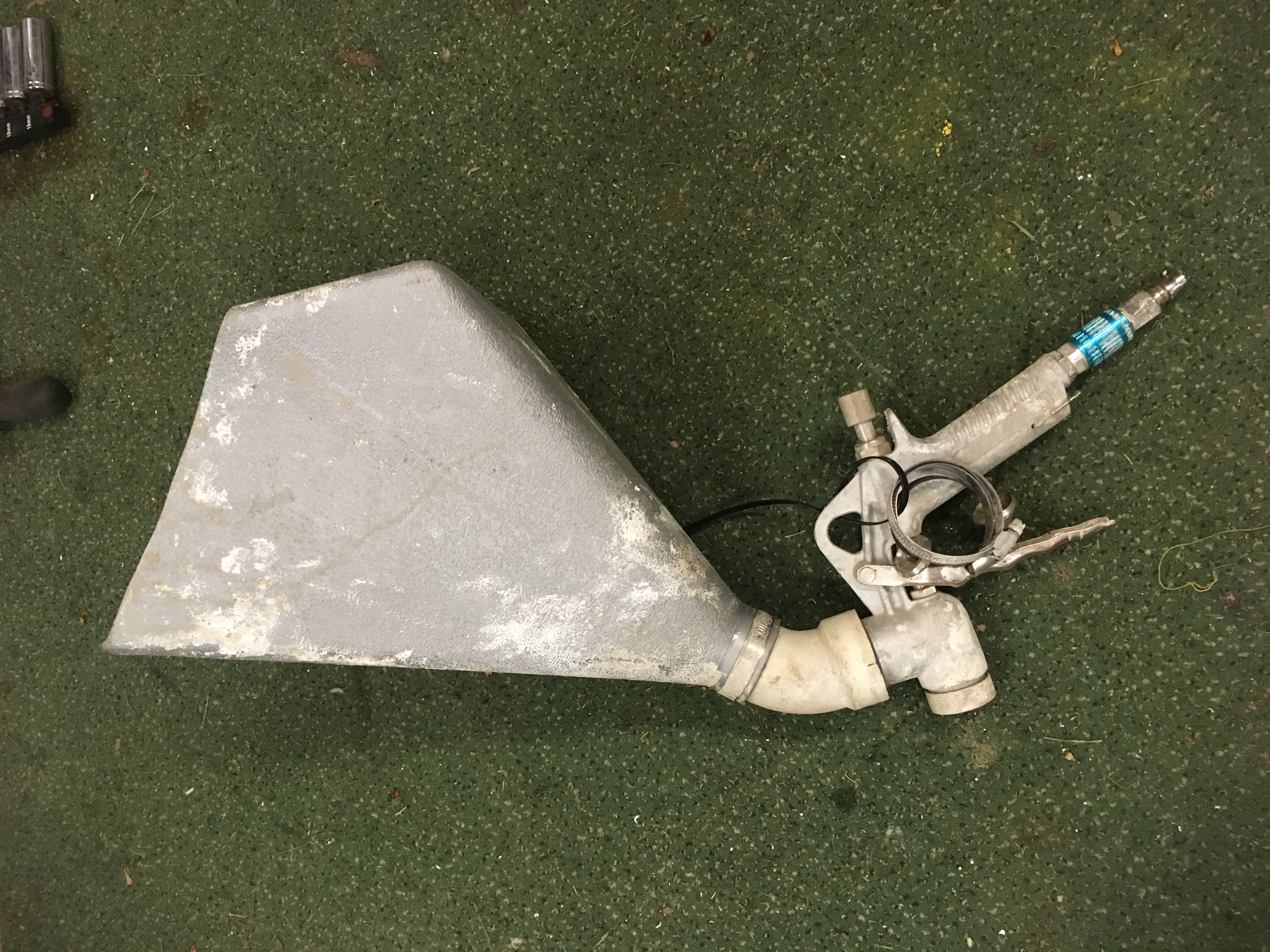

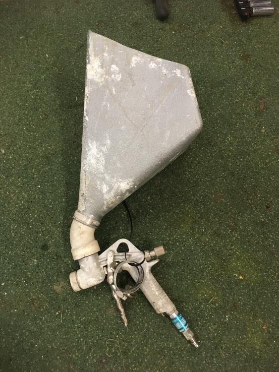

Russell griffiths Posted October 5, 2017 Share Posted October 5, 2017 Link to comment Share on other sites More sharing options...
Russell griffiths Posted October 5, 2017 Share Posted October 5, 2017 The one above is mine, cost about £65 you need the little blue thing on the air connection it is a second regulator and makes adjusting the pressure at the gun so much easier. Will run off a standard diy compressor. Watch the grit size in your sand I would use a very fine sharp sand or as some would call it plastering sand or Leighton buzzard. Plenty of cement as it will make it a bit slicker i use a figure of eight pattern. Dont scoop the muck muck out of the barrow like the Neanderthals in the vids, make a scoop or you will end up in the biggest mess ever i would lend you it but it needs a new set of seals in it. Plenty on e bay, but I would avoid the smaller round hopper as you can't get a lot in it. Link to comment Share on other sites More sharing options...
Declan52 Posted October 5, 2017 Share Posted October 5, 2017 It's it really much quicker than troweling it on. Didn't look it on the video but most of the plasterers I know are animals who don't hang about getting it on the wall. Link to comment Share on other sites More sharing options...
Russell griffiths Posted October 5, 2017 Share Posted October 5, 2017 I use mine for acrylic texture coating. If I was doing a rough parge coat just for sealing purposes I would slap it all on with a broom head. Keep it simple. Link to comment Share on other sites More sharing options...
Onoff Posted October 5, 2017 Share Posted October 5, 2017 https://www.johnkingsley.ca/strawbale/sprayer/v2/ & http://cottagedreamers.blogspot.co.uk/2014/05/diy-stucco-sprayer.html And there are LOADS of diy ones on Pinterest. Link to comment Share on other sites More sharing options...
