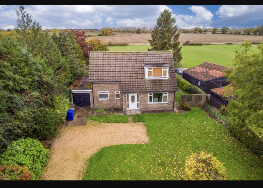

Fallowfields Posted September 8, 2023 Share Posted September 8, 2023 All new to this, and already frustrated. Got our dream plot with the ugliest broken down house on it and i have submitted a design which is different to the 1970s house here. The Hamlet is not particularly thought out planning wise and as the village dates back to domesday I thought it would be nice to insert an appropriately proportioned 17century farmhouse design. Well, they want a dormer and I dont want one as its not in keeping with the farmhouse of 17 century, apart from losing floor space and the blooming maintenance, that together with there is not one dormer in the road. What on earth?? Architect says we will have to give them one. Well thats like hanging a chandelier in a toilet cubicle, it just isnt right. Can they insist, it seems mean given this house is falling down and trust me its ugly and 70s and yet they seem to want another eyes sore to replace the already hated house in the hamlet by the natives. Any tips how I can stop this silliness? TIA FF Link to comment Share on other sites More sharing options...

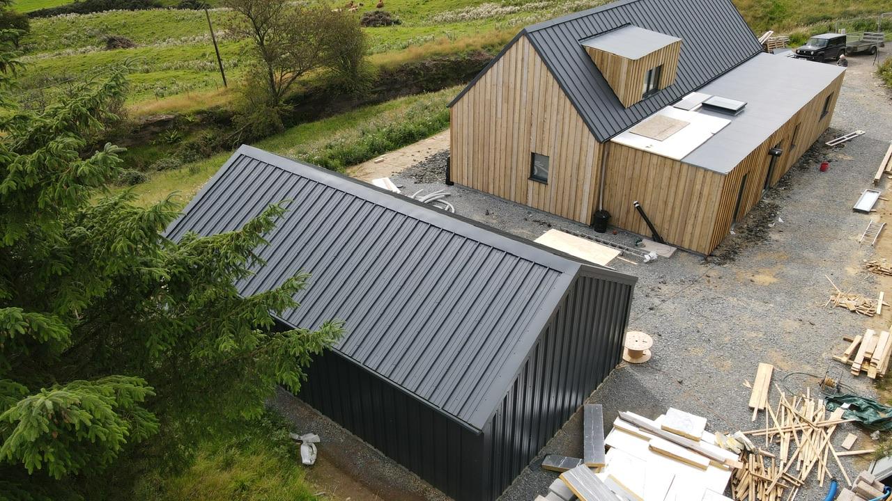

ProDave Posted September 8, 2023 Share Posted September 8, 2023 How do they define a "dormer"? I hate the things, difficult to detail correctly, and you lose headroom. So this was my solution instead, "gable ends" One at the front ant 2 at the back. Full unrestricted headroom. much easier to detail in all respects compared to a traditional dormer. See if your planners would accept something like that? 3 Link to comment Share on other sites More sharing options...
Blooda Posted September 8, 2023 Share Posted September 8, 2023 Have you seen the actual correspondence from the planning stating this and in what context ? How does the ridge height compare with the existing building? 2 hours ago, Fallowfields said: ign. Well, they want a dormer and I dont want one as its not in keeping with the farmhouse of 17 century, apart from losing floor space and the blooming maintenance, that together with there is not one dormer in the road. What on earth?? Architect says we will have to give them one. Well thats like hanging a chandelier in a toilet cubicle, it just isnt right. Can they insist, it seems mean given this house is falling down and trust me its ugly and 70s and yet they seem to want another eyes 1 Link to comment Share on other sites More sharing options...

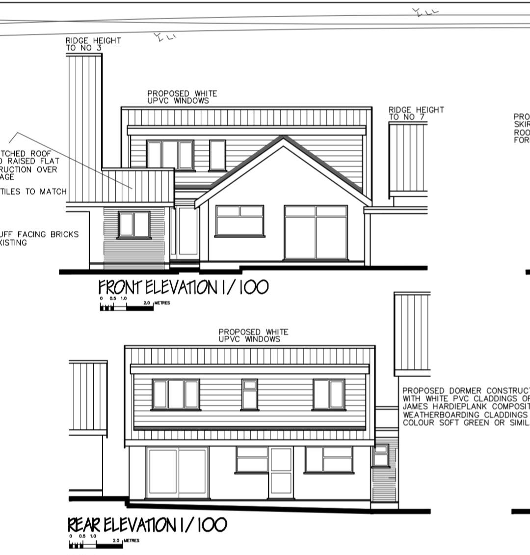

FuerteStu Posted September 8, 2023 Share Posted September 8, 2023 Planning specified a traditional looking dormer only on my loft conversion.. After a few back and forths, they accepted a full width Dormer on my bungalow, front and back. In reality, it's entirely new warm deck box on top on my bungalow with a artificial (non structural) ridge and a row of tiles down the sides. I had to adjust the pitch of the gables to accommodate the raised ceiling height, but planning went with it, because it 'looks'. Like a traditional dormer loft. 1 Link to comment Share on other sites More sharing options...
FuerteStu Posted September 8, 2023 Share Posted September 8, 2023 Mine, for reference.. 2 Link to comment Share on other sites More sharing options...
