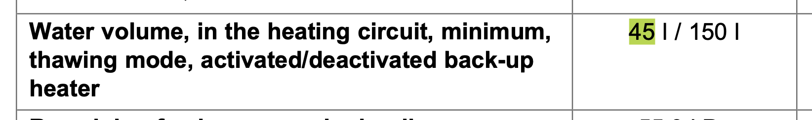

On 28/08/2023 at 13:37, S2D2 said:
Assuming they are replacing with an Arotherm Plus, they have a rather odd step in the minimum system volume dependent on size.
10/12kW models: 150l
7kW: 55l
3.5/5kW: 40l
I've only just started looking at this but I doubt anyone is fitting a big enough buffer to hit 150l, so I would query this with them as it seems a massive jump from 55l to 150l. Getting down to a 7kW model might solve the headache if you can make up the system volume in the radiators/pipework.
You can also drastically reduce the required volume with the 6kW backup heater which is relatively small but will cost more to run, I have no idea how much it would come on for normal usage, I've only just seen that it exists. Including this changes the minimum volumes to:
10/12kW models: 45l
7kW: 20l
3.5/5kW: 15l
Which you should be able to hit with radiators alone. Information for the larger units here in appendix E: https://www.vaillant.co.uk/downloads/product-brochures/arotherm-plus-230v-double-2626669.pdf

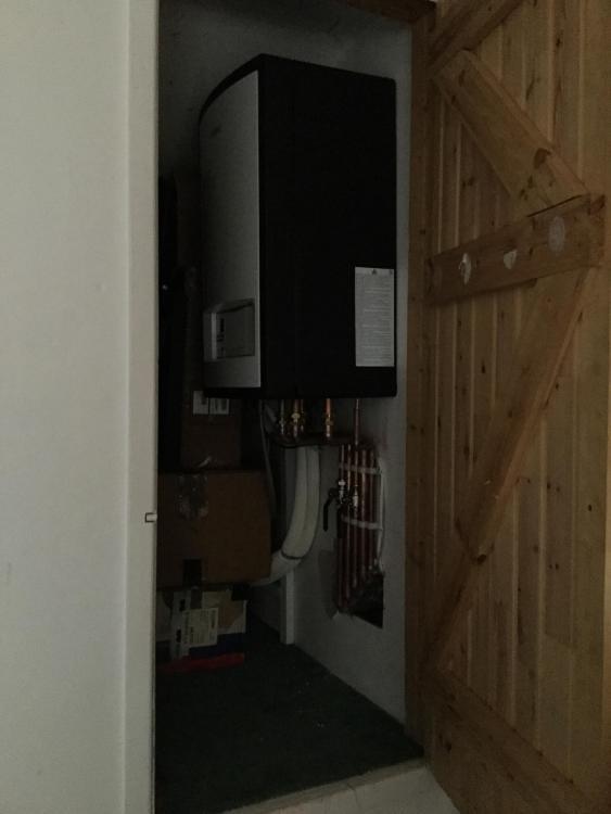

@zoothorn I answered this back on page 2, and again on page 3 when you typed it out in all caps. Maybe I should have typed the response in all caps?
With the above picture it is clear. The hydraulic module contains the backup heater, so your current system requires a smaller system volume. Ask them why they aren't fitting the backup heater with the new system. It will cost more to run than a buffer, which may be the reason.
If they are, ask to see their system volume calculations and post them here.
If you repeat again that nobody has answered this question I highly doubt you'll get any more replies.
You beat me to it @S2D2 I was just checking the installation manual.
9 hours ago, zoothorn said:
A question: why with my 10kw Arotherm split in the property now, os there no such buffer tank, whstsoever?
The water volume requirements are exactly the same for the split unit and mono block unit. If the split unit has the backup heater why wouldn't the monoblock. Clearly a question for the installer.
With this the whole issue goes away.
If the buffer absolutely is needed, you previously posted this picture of the hydraulic unit. It looks to me as if the buffer can fit in there, has the installer looked at this?
