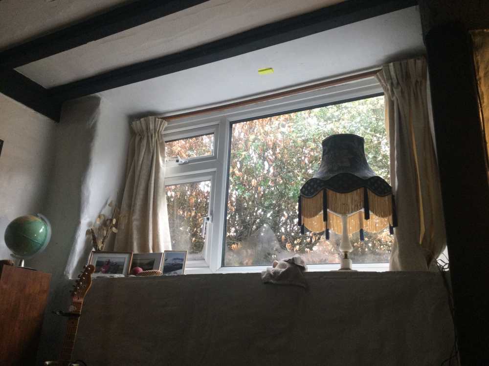

Honestly, it's simply not a game I can possibly win here. Bar one room that is (actually two: I have a workshop room under my bedroom, 2021 extension, which CAN get warm even with 1 of the 4 walls an original stone.. but neither do I need, nor want heat in there: it dries my timber work out, so prefer this 1 rad out of the 12 in the house, off: just a fan heater to inject a bit of heat in, when I work, otherwise rad is off).
If you came you'd understand. It's just one of those houses, like that freezing room you recall as a child for eg, always deathly cold.. my main 3 rooms, sit'room/ kitchen/ bathroom unfortunately all have this trait. 2 beds directly above, I don't use, much the same.
It's simply lack of insulation. In my 3 main rooms: nothing under the floor, & nothing in the stone walls (bar a token gesture 1" rigid insulation in kitchen/ bathroom walls: ie next to nil). Sit'room has nothing in very low 6'3" ceiling too, just the two cold bedrooms above it. Basically, I have none at all. And whole cottage is just whacked down on -cold- clay too. I also have some damp upwards in the stone walls (not enough to mean odour- just black mould on lowest 1', a bugger to scrub off.. so I now just don't/ let that win too). Plus a stream -very- close & lower than cottage, likely aiding the cold ingress to the floor too. So it's no wonder I sit with the 2 sitroom huge rads on, now quite hot, but can still see my breath & cold feet, face, hands. It's like David & Goliath: I don't expect a small ammount of heat, to win over a massive ammount of cold. It's not physically possible.

I've had the HP (heatpump) set to 17*C & on continuously, all winter. Until I got the new one fitted, which outputs higher temp in the rads (for whatever reason) but only goes on evenings & mornings, since the installer set it to. And which I was sure I set it to, beforehand. Tbh It's so complicated that Ive no idea why it was on continuously beforehand, & not now.
Still the mainroom is -just- see your breath cold, most of the time. Uncomfortable. When I used to put the stove on, I was sitting on a cold sofa still, at 10:45pm. Still with hat & scarf on. Sometimes even then still see8n* my breath. Infuriatingly the sofa is only 1m from the damn thing. I had to load so much wood in, so often, that I got through two big baskets of logs each mere 4-1/2 hour stint (for eg 6pm- 10:30pm).. plus.. had to run it so high/ flat out continuously, in order to get room up to say 12*C from 2*C.. that I warped the internal metal removeble bits within the stove. Bought new ones at great cost, warped those too. A french top brand stove too. So I refuse to waste so much effort & money, when the sofa's still cold at 10:45pm. No point whatsoever, to putting on the stove.
If a 9kW stove can't heat the room, there's no way on god's earth, two rads will. And it's proven, they don't. They just can't be expected to.. in this house. In your house, yes. In other often cold houses, yes to a degree/ likely in time. With mine.. not a hope, in hell.
There are no draughts. I stuffed those up within 6 months of being here. I have excluders + a huge thick curtain across the front door.. which leads to a porch (not directly outside). And across other door to kitchen. Thick curtain too. No draught is ever evident. The cold 'pouring down from loft onto perimeter of sittingroom ceiling' is approx 2" wide. It isn't direct cold air, because there's a ceiling stopping it. But it's coldness nevertheless. It is a gap between the rooms' outer walls above (the walls corresponding to the outer 'shell' of the main room below them) & the poor studwork & plasterboard outer layer. Above these awful walls, is cold loft air. So cold loft air sits in a  2" wide ring, going around 6x5m of the rectanglular shape of the main shell of the cottage, on the edges of the ceiling. But no direct draught, just cold ingress.
To remedy this, I'd have to rip out all the plasterboard walls from the 2 bedrooms. Put insulation in this gap. Redo. In other words, a full renovation of 2 rooms. Which I'd already patched up & renovated aesthetically anyway.
Alot of work, to fix just 2" of a perimeter cold ingress, which may only make a tiny bit of difference. That is, considering jus5 how much MORE cold, is coming UP from the floor, & IN from the walls, & also in from the whole 6x5m floor area sitting onto0 o& the sitt8ngroom. This floor, is about 2" thick itself. The bedrooms.. freezing cold, due to their walls having a 2x4m layer of loft air behind each one.
So the only sensible way forward, if there's any at all, is addressing the floor. Now, I know what a -proper- floor can be, sat upon the 'bedrock' of clay I have here. Because my workshop, is a newbuild room, in fact 3 ft lower than the sittingroom. I put the insulation in, with caberfloor ontop. Although I can't compare directly to the adjacent sittingroom, they do share 1 stone wall between. I can tell how much this floor retains the heat, I can just sense it. But it has 3x newbuild walls + a rockwool insulated ceiling. So 8 cannot tell how much the warmth that I sense is due to the floor. It may be hugely significantly affecting/ retaining the heat mor3 than the walls. But it may be the walls doing the heat retaining job, & the floor far less.
So I can only make a --gamble-- as to whether excavating my sittingroom floor/ doing it properly/ with UFHeating too (doing away with the 2 big rads: these I could sell to help pay for the job, which I'd have to do myself).
With my skills & knowledge, making such a huge gamble (really it's the logistics: of removal of item/ storage/ the massive dust of excavation/ skipping: rather than the cost) is kinda a step too far, for me to judge whether it's worth trying it. My "waters" say it might -just- be beneficial though, with the UFH idea addition. My friend over the hill, didn't lay UFH, he just excavated/ added celotex/ floorboards ontop. Little gained there as I said.
