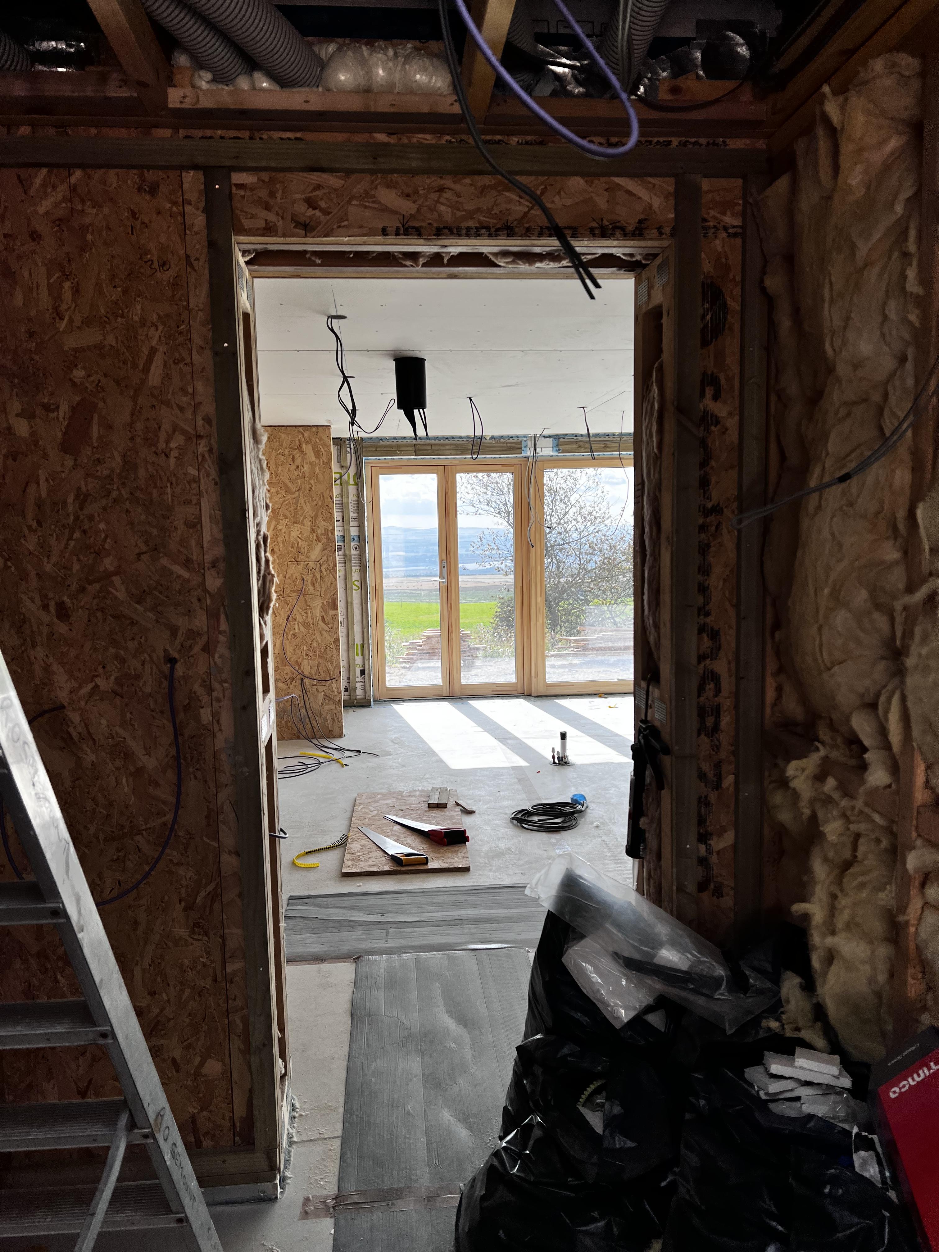

Kelvin Posted August 14, 2023 Share Posted August 14, 2023 The wow of our house is the view across the valley to the hills beyond. What we did is widen the hallway as you walk in the front door, the inner hallway door is glazed into the kitchen which has a glazed door to the garden. Therefore when you walk in the first thing you see is an uninterrupted view straight through the full width of the house to the hills beyond. The other thing we’ve done is open up what would have the second bedroom upstairs. We’ve turned it into a sitting room. You come up the stairs and it’s open plan with a vaulted ceiling exposing the glulam ridge beam as a feature. Neither of these two things have cost us any money to do. Where we are spending a little bit of money, but not a huge amount is in some of the lighting for the open plan living area. We found a great lighting place called glow lighting in Ripon. https://www.glowlighting.co.uk Hand made blown lights and spun metal lights. They are really beautifully made. We visited them last month and were completely sold on the look. 1 Link to comment Share on other sites More sharing options...

Kelvin Posted September 9, 2023 Share Posted September 9, 2023 18 hours ago, Fallowfields said: Would love to see some pics, Weve got some lovely views and looking for ideas to enjoy them We’re still building. I’ll take a picture from the doorway to give you an idea but it doesn’t give the view justice. I also rendered our house in 3D to give us a rough idea of how it might look internally. 1 Link to comment Share on other sites More sharing options...

Kelvin Posted September 9, 2023 Share Posted September 9, 2023 Doesn’t give the view justice. But when finished you’ll be able to see straight through from the hallway to the hills in the distance 3 1 Link to comment Share on other sites More sharing options...

Fallowfields Posted September 20, 2023 Share Posted September 20, 2023 On 09/09/2023 at 15:31, Kelvin said: Doesn’t give the view justice. But when finished you’ll be able to see straight through from the hallway to the hills in the distance I like this, I can imagine it with walls finished. The unfinished doorway is already making me want to walk through and look at the view, so def a winner when all done. Link to comment Share on other sites More sharing options...
