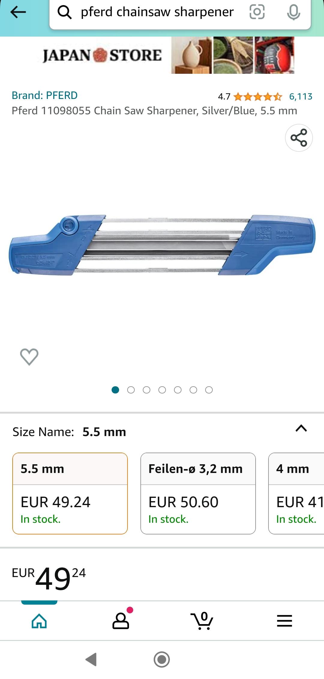

Iceverge Posted July 18, 2023 Share Posted July 18, 2023 Guage Pitch Length Alternatively (and I'd recommend this) sharpen the chain. The chainsawing experience is night and day with a sharp chain. I couldn't make any fair attempt of it until I bought one of these. Also sold as Stihl. I have a knock off and it works well too. 1 Link to comment Share on other sites More sharing options...
