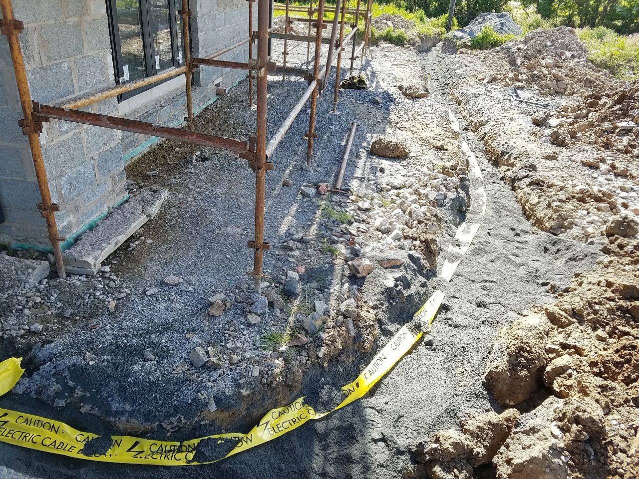

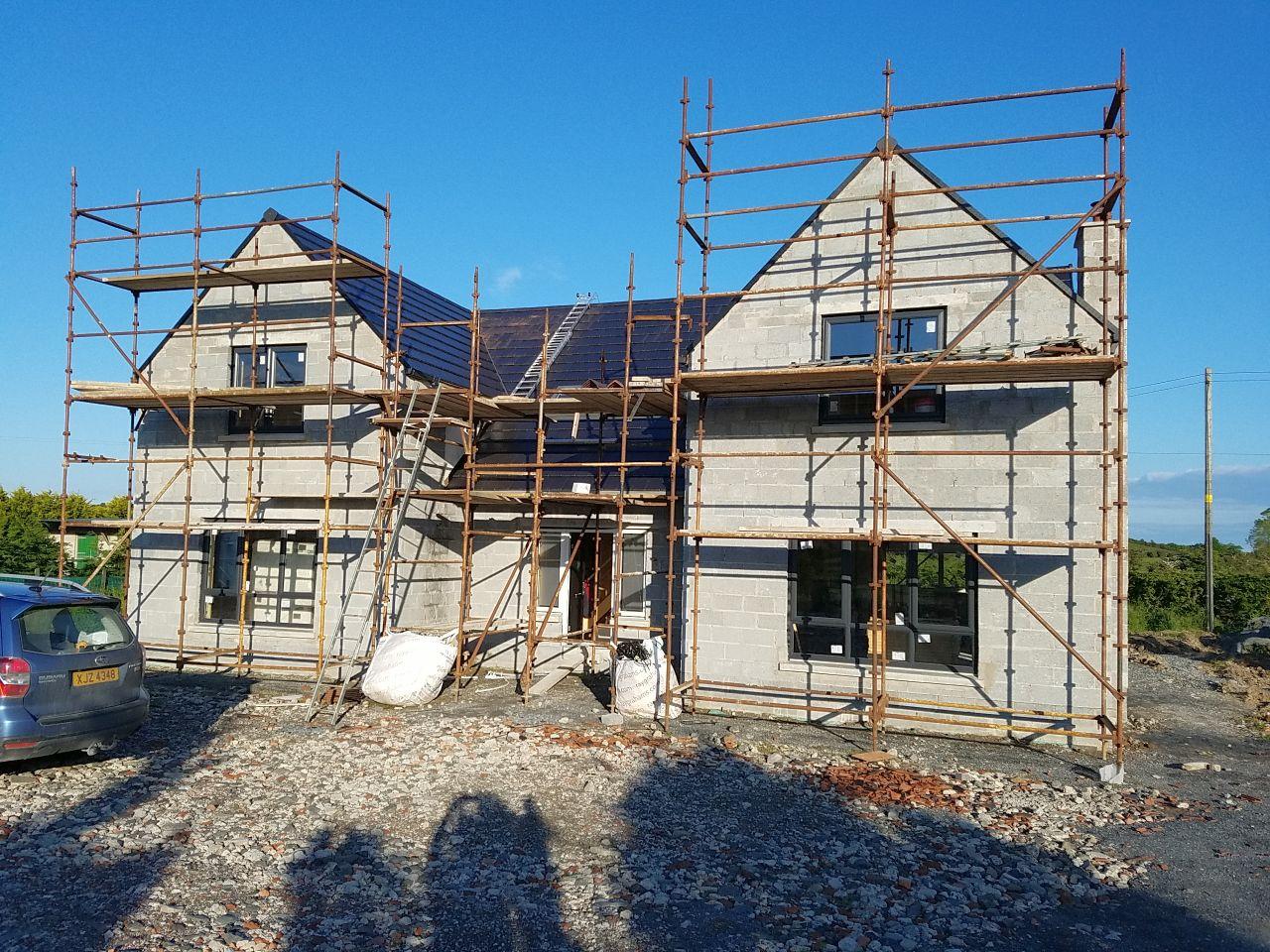

dpmiller Posted May 22, 2019 Author Posted May 22, 2019 NIE arrived today to connect the official crocodile clips. Only slight issue was the lads had been supplied a cut length of concentric and it was a touch tight for our trench route. We considered playing tug-o-war with the cable but instead chose to fire up the digger and cut a corner off the trench. With both ends terminated off it was a case of "plenty o'blinding and don't forget the tape"; they offered to stay and help but I could tell manual labour wasn't high on their list of priorities on a sunny day... Swapped buckets to backfill, to find the quality inspector hitching a ride. So that's that for now. Meter should be installed in the next couple of days now, we're awaiting some of the scaffold being removed, and the roof is so close to finished I can smell it (but maybe that was just the slurry off the next field...).

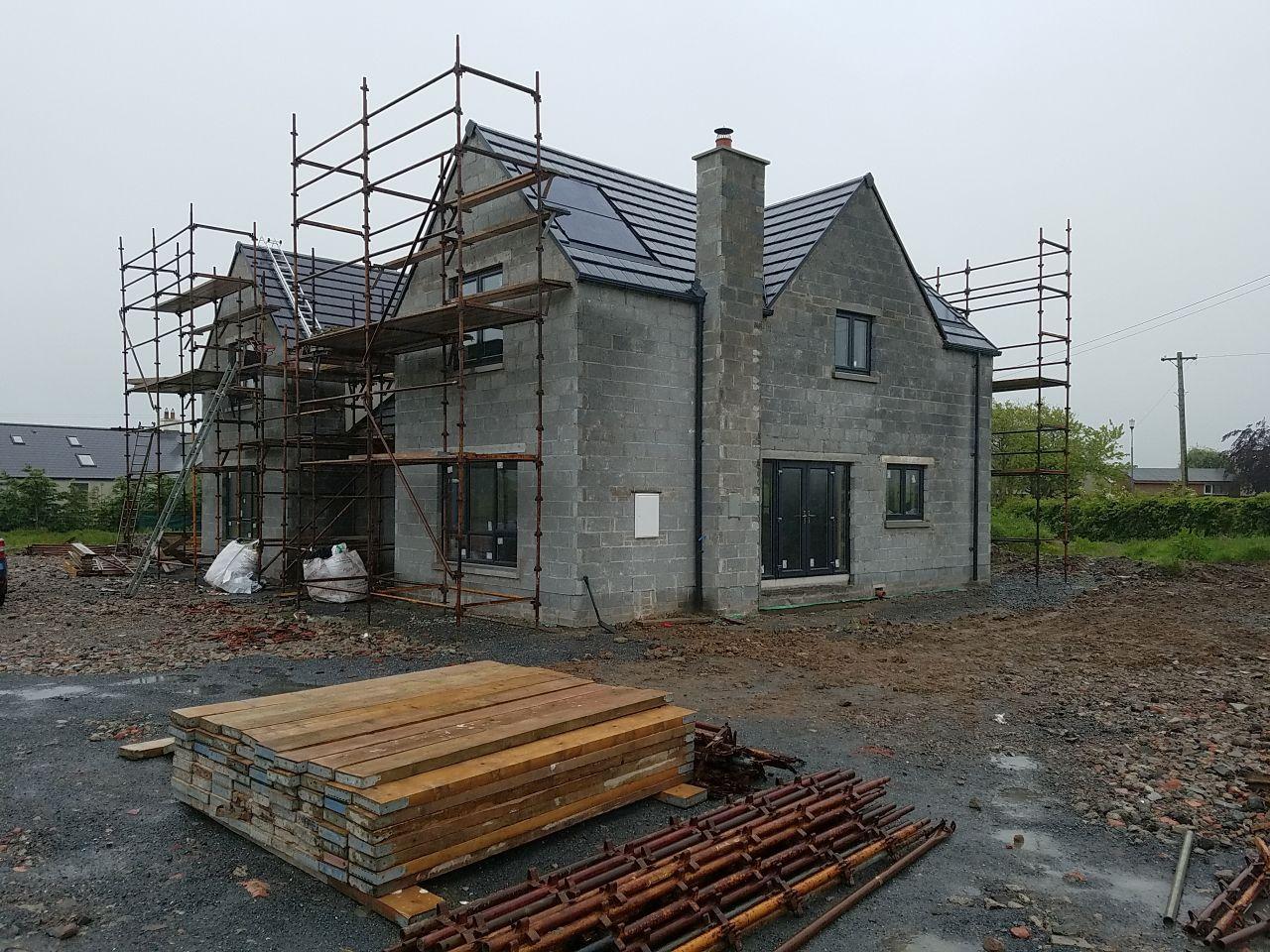

dpmiller Posted May 29, 2019 Author Posted May 29, 2019 Slowly being revealed and no, the electric isn't on. Blokey arrived to fit meter and made reference to a new edict from management that permanent supply is only allowable after second fix is complete for the whole house, and can I fit a commando socket in the meter box instead? Grr. And the reason? Apparently it's to negate the possibility of someone working inside a live CU. Not much of a spark then, I said... 1
ProDave Posted May 29, 2019 Posted May 29, 2019 43 minutes ago, dpmiller said: and no, the electric isn't on. Blokey arrived to fit meter and made reference to a new edict from management that permanent supply is only allowable after second fix is complete for the whole house, and can I fit a commando socket in the meter box instead? Grr. And the reason? Apparently it's to negate the possibility of someone working inside a live CU. Not much of a spark then, I said... That is totally bonkers. I could not work like that. I would be fitting the commando just to get past the stupid system and then connecting the CU once he had gone.

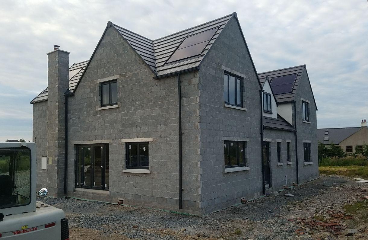

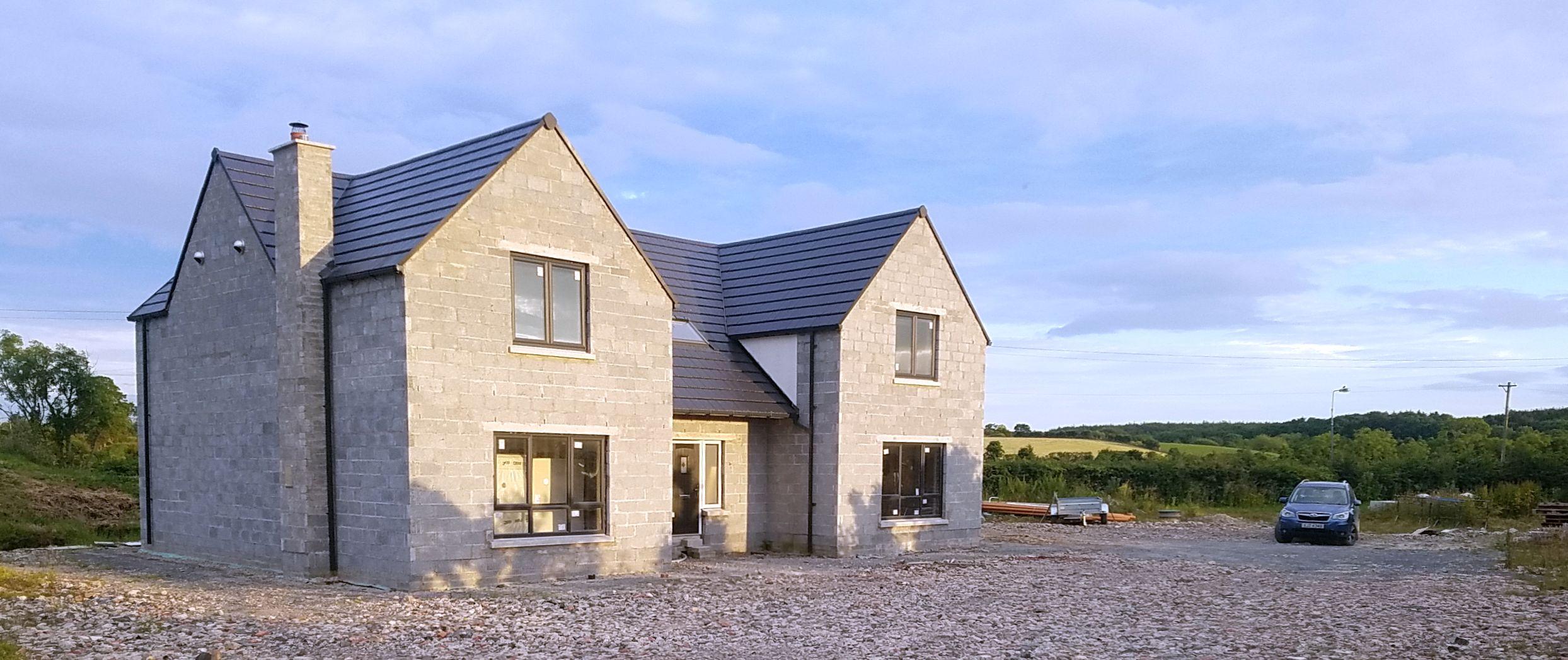

dpmiller Posted July 4, 2019 Author Posted July 4, 2019 Guttering complete, scaffolding away, MVHR complete. photos! 8
