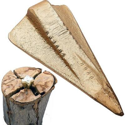

Adsibob Posted June 18, 2023 Author Posted June 18, 2023 3 minutes ago, saveasteading said: One of these and a 7 lb hammer Screwfix to the rescue: https://www.screwfix.com/p/magnusson-carbon-steel-sledgehammer-7lb-3-2kg-/1424V?tc=IB2&ds_rl=1244066&gclid=Cj0KCQjw1rqkBhCTARIsAAHz7K3ROUm53HdOrl63qBnjMvhsdXw86WRHMnnQKJxeAjOaOX0ZF6hLbtUaAk06EALw_wcB&gclsrc=aw.ds AND https://www.screwfix.com/p/roughneck-wood-grenade-4-way-log-splitter-1-6kg/51334
