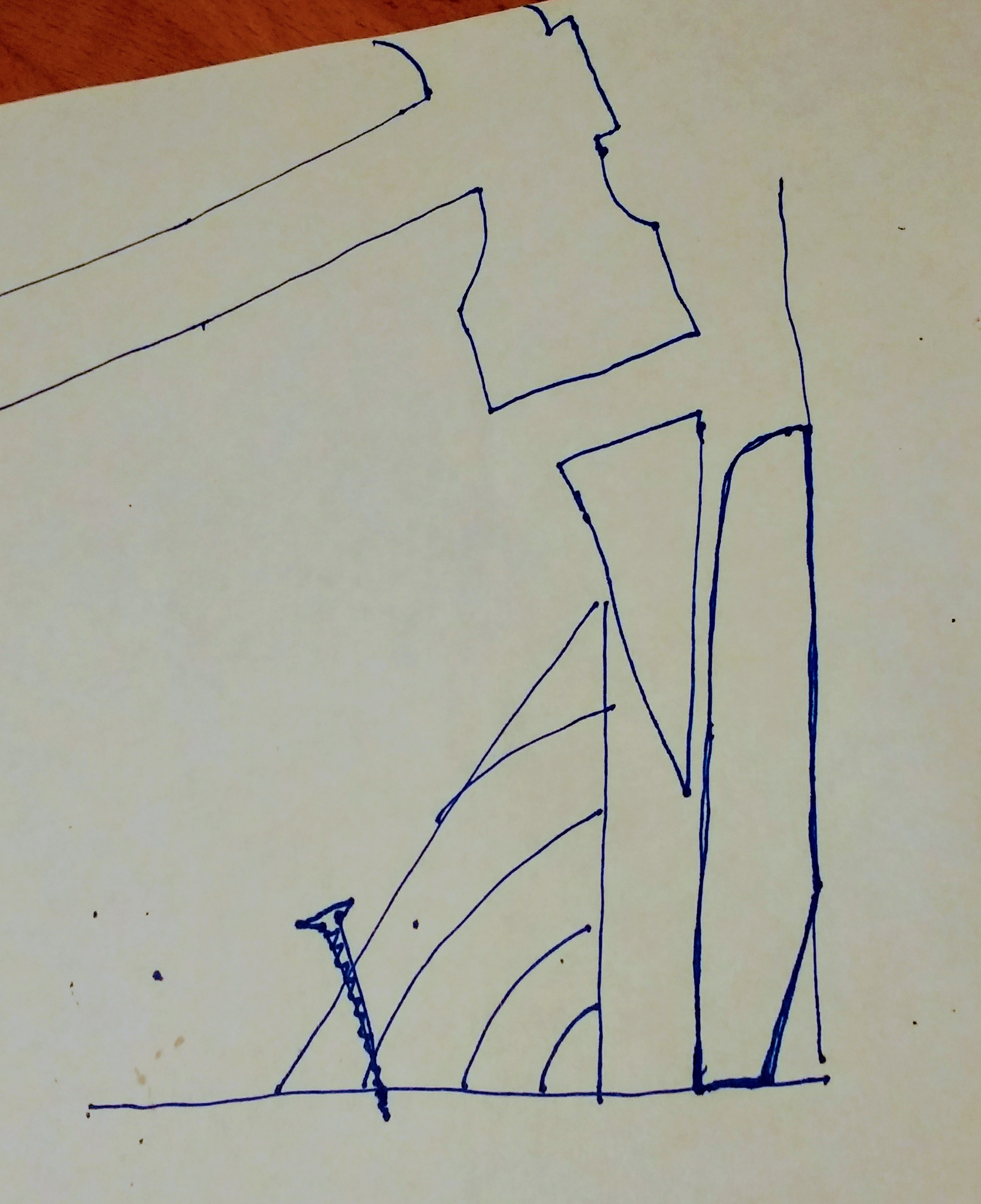

41 minutes ago, TheMitchells said:
Can you provide a photograph please as I am struggling to work out what you mean - apologies.:$

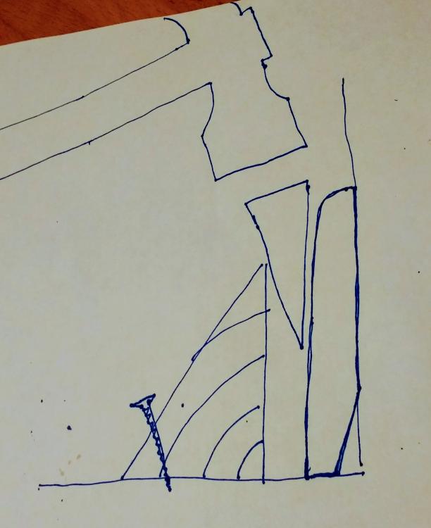

Pre insert a screw as shown with the point just hidden  Sit the wedge against the floor, push it against the skirting until your snug, then send the screw home. Don't let it go right through the floor in case of pipes or cables.
I used vertical screws and square wedges ... wedging the piece against the screw, or holding it against the skirting to keep it in place, and placing the screw to keep it tight.
That also worked for me.

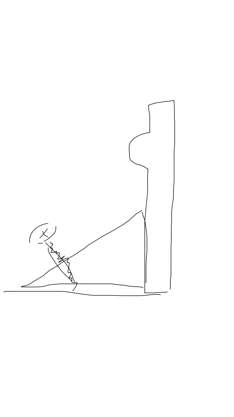

Naughty step @Nickfromwales I think @TerryE meant this for an uneven or wavy wall ???IMG_20180101_172113843.thumb.jpg.e25d86810cb79ad4ee22fd4919efd15b.jpg

24 minutes ago, Tennentslager said:
Naughty step @Nickfromwales I think @TerryE meant this for an uneven or wavy wall ??? by
Not quite.. two thinner wedges banged in. One on each side!

i'm fairly sure this is what he means viewed from above as this is pertty much the definition of "folding" wedges.
I would add this will only work if you are working on an unfinished floor e.g will be carpeted.
if you are painting the skirting personally I would just screw it to the wall wherever you have got a big gap
 TBH Nick's way would work fine as long as you put your foot against it while you put the screw in ;)

26 minutes ago, Nickfromwales said:
People......if you have to do more than my suggestion, sack the chuffing plasterer. ??

It's not so funny, I've used extending plasterboard props to hold the skirting in place while the glue dried.
I've cut tile batten down to prop from the opposite wall.
Nick's got a point -- pushing the wedge up and screwing it might work, but we found the wedge method had (as shown by Ed) had two advantages (i) we pre-painted our skirting before fitting and the planed surface of the wedge against the skirting was a lot gentler on the skirting painted surface; (ii) by adjusting the hight of the wedges you can trim the lean of the skirting.
For some room like the bathroom where we had a floating floor, we used Pete's prop method just using lengths of scrap battening but also used wedges here for the same reason: to protect the skiriting paintwork.
