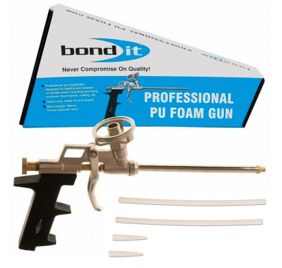

MortarThePoint Posted May 7, 2023 Posted May 7, 2023 Some of the guns seem more susceptible than others, although that may just be a coincidence. Has anyone tried this gun as its cheap: https://www.sealantsandtoolsdirect.co.uk/bond-it-professional-ag1-pu-expanding-foam-applicator-gun-bdag1?language=en-gb¤cy=GBP
jayc89 Posted May 7, 2023 Author Posted May 7, 2023 41 minutes ago, MortarThePoint said: Some of the guns seem more susceptible than others, although that may just be a coincidence. Has anyone tried this gun as its cheap: https://www.sealantsandtoolsdirect.co.uk/bond-it-professional-ag1-pu-expanding-foam-applicator-gun-bdag1?language=en-gb¤cy=GBP I've used Bond It guns before. They did the trick. The ones I have now have larger nozzles so those attachments don't fit on it, which is a pain. 1
Gone West Posted May 7, 2023 Posted May 7, 2023 7 hours ago, MortarThePoint said: Has anyone tried this gun as its cheap: I've had one of those, seemed much the same as others I've had.
