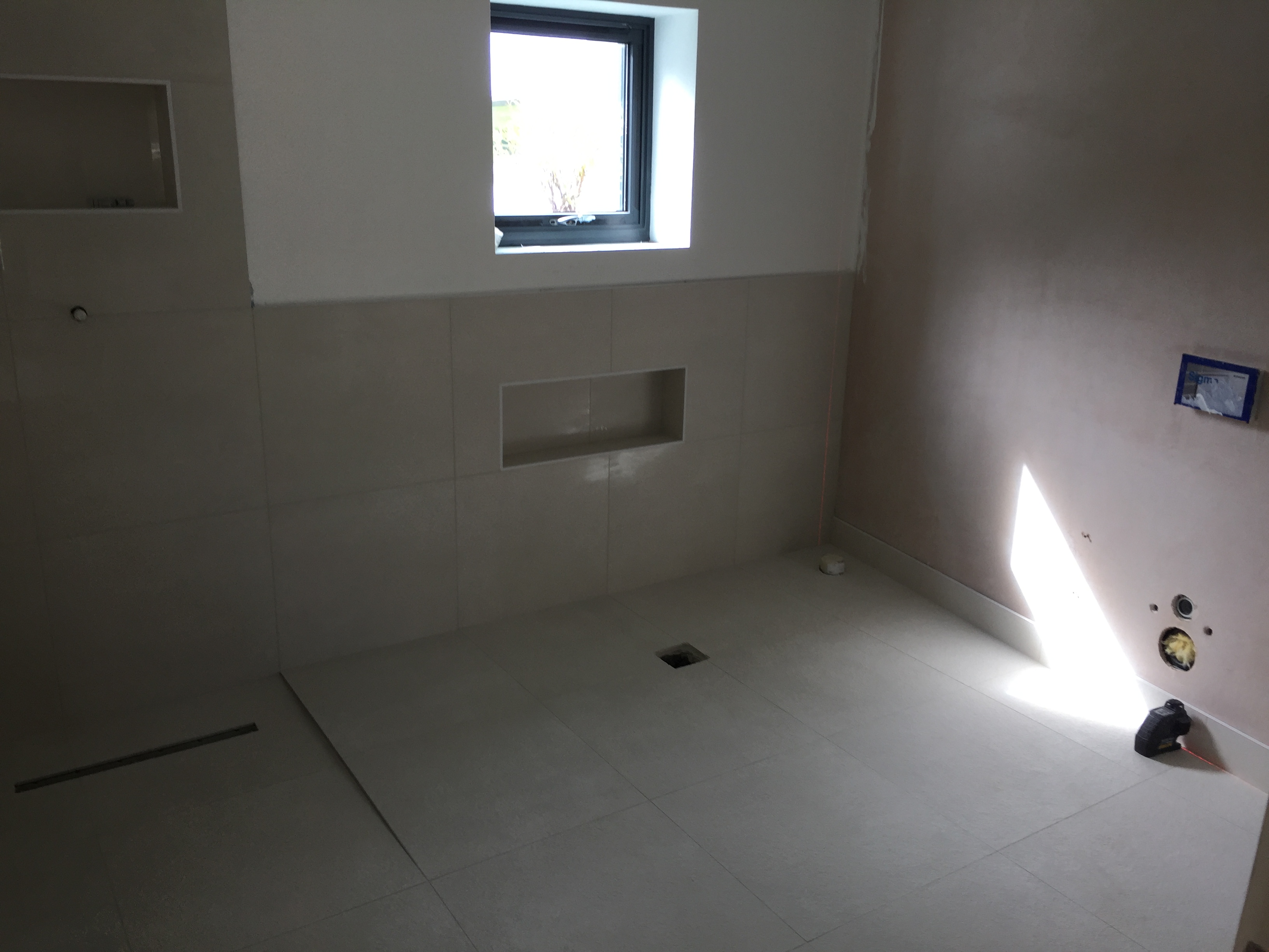

Nickfromwales Posted August 2, 2017 Posted August 2, 2017 That is an Impey linear 2 wetroom former built into the left hand corner. Where the step is in the floor will go a glass screen ( 2040 high x 1180 wide ) to capture the splashing water. Shower 'area' ( sloped bit ) is 1200x900mm. Yes they'll have to dry the floor a little beyond the 1200mm but if you like cool then that's the way forward. @joe90, try before you buy .

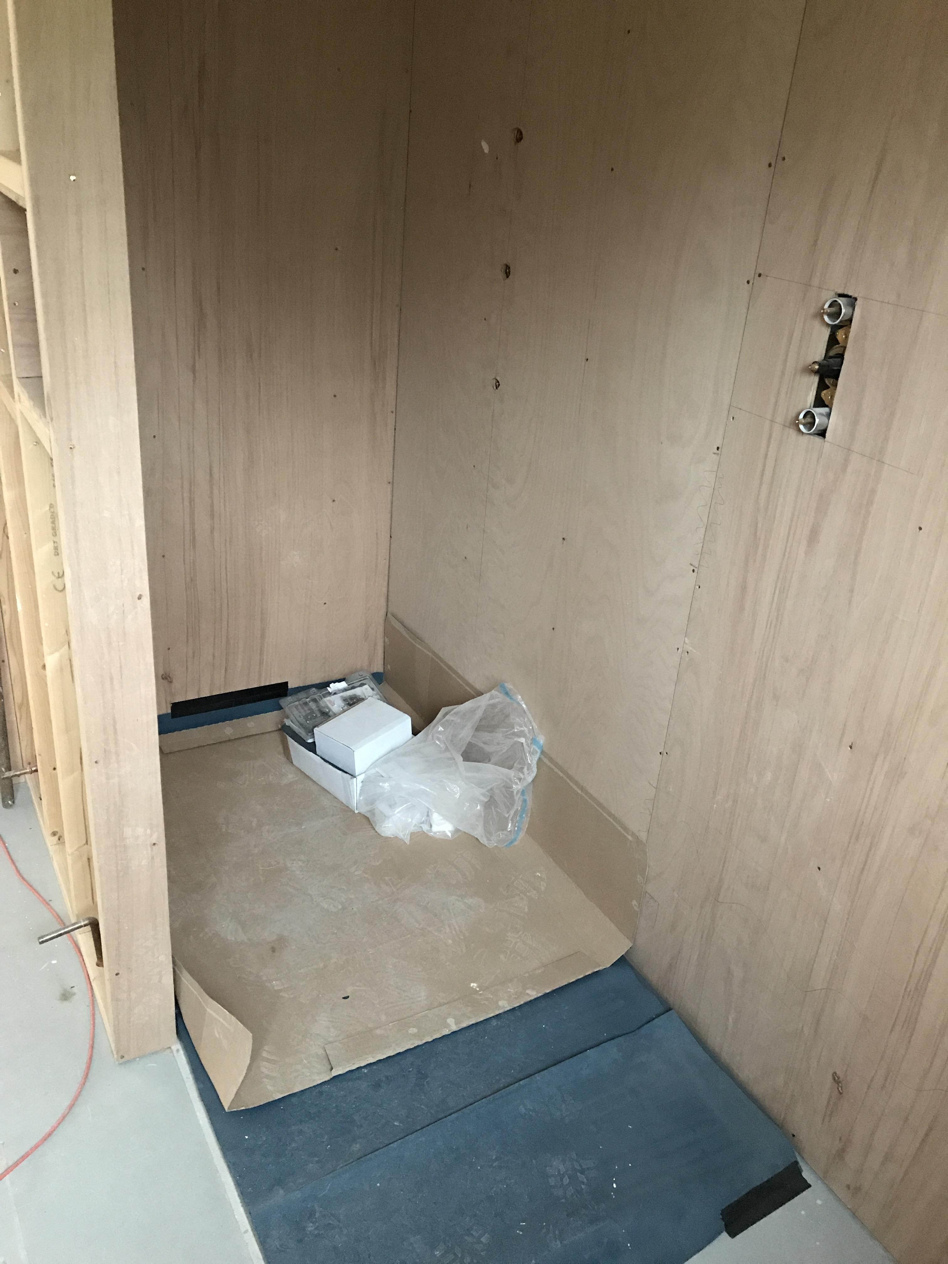

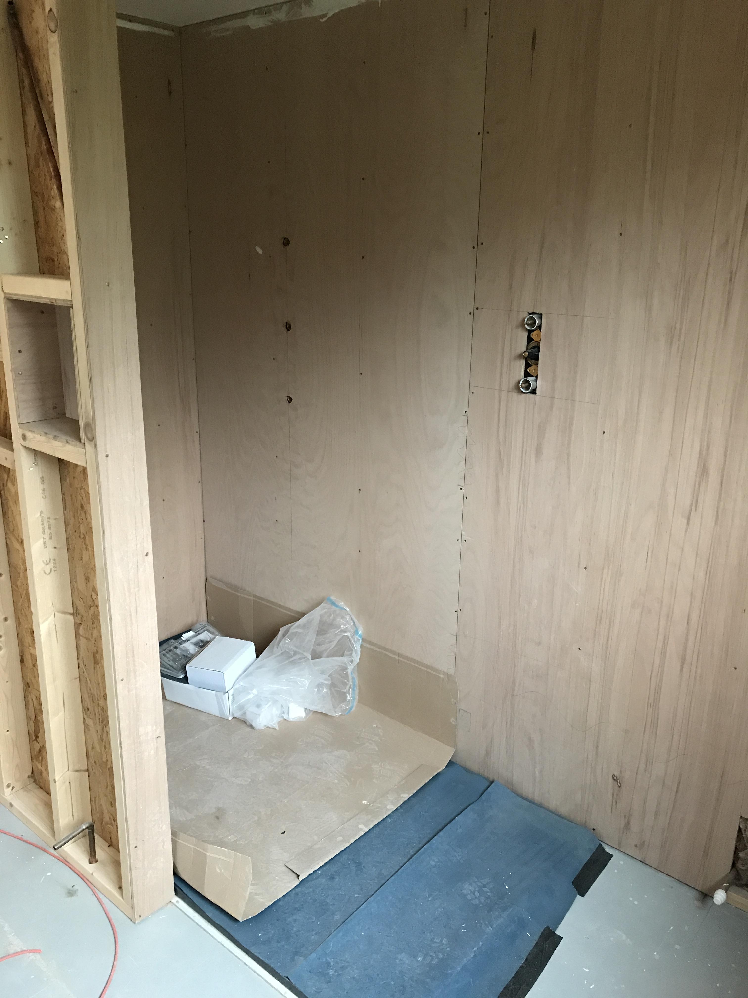

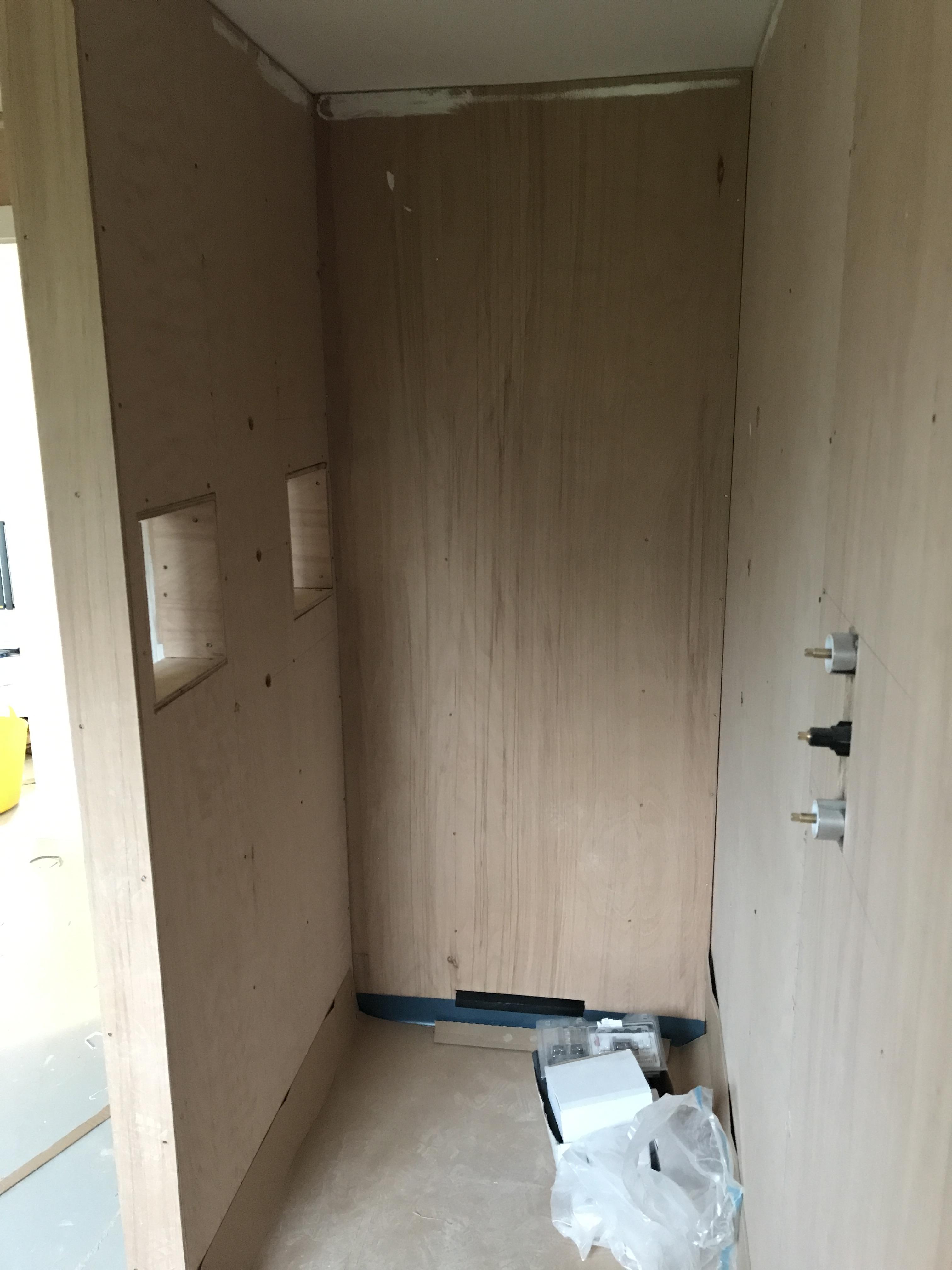

Grosey Posted August 2, 2017 Posted August 2, 2017 (edited) I have built this enclosure around a 900 x 1500 tray. This came about as we wanted body jets and a walk in shower but couldn't figure out a way to not have 1 set of jets firing across the room! So the enclosed section is 1000 x 900 created by the little stud partition. Rainfall shower head coming from the ceiling. No idea how much it'll splash especially when using body jets and moving about, but there's noggins in the wall to install some glass if required, although I'm not sure how it'll work if it proves to splash so much it'll need fully enclosing.... probably a curtain with rubber ducks on it and hang my head in shame! Edited August 2, 2017 by Grosey

Nickfromwales Posted August 2, 2017 Posted August 2, 2017 Thanks ? The original window was about 400mm x 400mm, so only about 300mm of glazing, so I chopped the TF out and fitted that bigger 800mm one. Much more light into the room now, but a right pita to peel back the load bearing layers of the head above ? When i get 5 mins I'll start a thread on the bath waste that I 'pioneered', the square you can see in the floor in front of the window. The circle in the corner is the Hans Grohe freestanding bath tap 'receptacle' which is basically a very posh bayonet type fitting which the tap stand gets fitted into after tanking and tiling is complete. I'll post some pics on the aforementioned thread after I second fix it next week.
