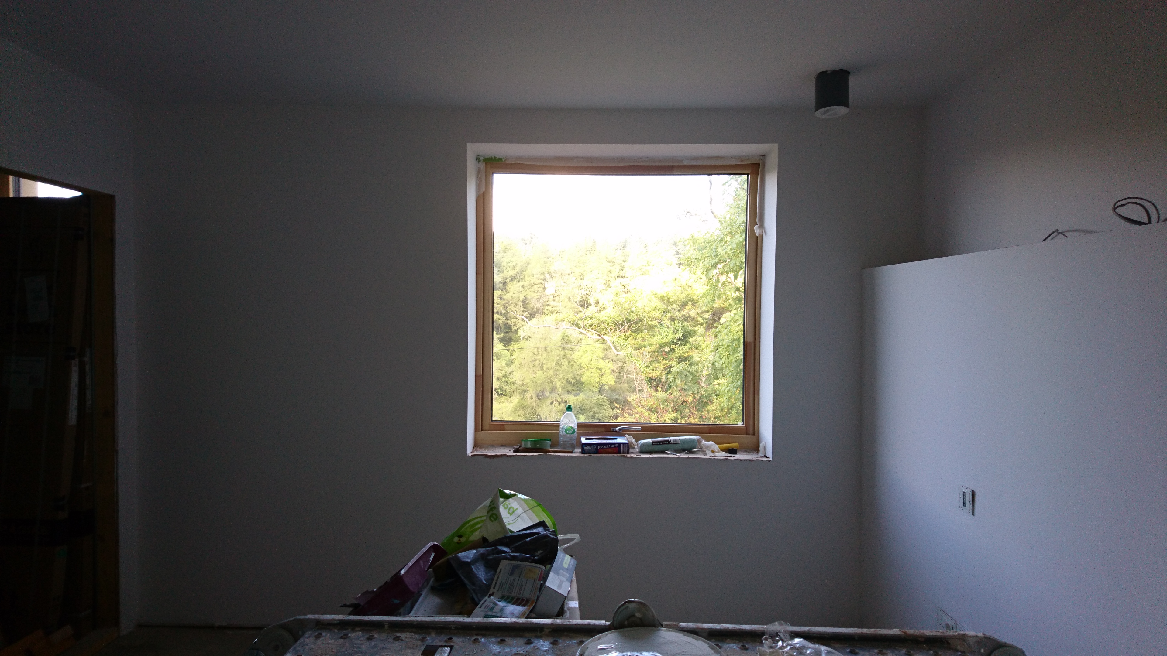

jamiehamy Posted September 10, 2017 Posted September 10, 2017 All suppliers recommended us against TnT for the two 1550s we have, so they are fully reversible. Work fine but a bit heavy. We considered splitting but was not the look we wanted.
JamesP Posted September 10, 2017 Posted September 10, 2017 27 minutes ago, craig said: 1500? It's a big single pane window, that's about 1300mm opening into the room when you deduct the sides. Have you considered splitting it into two openers? One master tilt/turn one slave turn? All our windows are single pane except 4m sliding and 2m kitchen window. Internorm have quoted us for the 1500x1500, Rationel have a max width of 1300mm. 3 minutes ago, jamiehamy said: All suppliers recommended us against TnT for the two 1550s we have, so they are fully reversible. Work fine but a bit heavy. We considered splitting but was not the look we wanted. So are all your windows tilt and turn except the one above, if so is the external profile different to the others? Which company did you use, so many horror stories about delivery and fitting. I did help fit my brothers Nordica windows last year, not easy due to size and weight but doable.
craig Posted September 10, 2017 Posted September 10, 2017 (edited) European suppliers such as Internorm who have quoted you and other Austrian / German and amongst others, can and will manage 1500mm - the concealed hinges can handle a fair bit of weight. It's not that it's a size which is to big or to heavy, it's just a large single pane opening into the room. Most suppliers recommend against it for a couple of reason, mainly weight related. Edited September 10, 2017 by craig
jamiehamy Posted September 10, 2017 Posted September 10, 2017 38 minutes ago, JamesP said: All our windows are single pane except 4m sliding and 2m kitchen window. Internorm have quoted us for the 1500x1500, Rationel have a max width of 1300mm. So are all your windows tilt and turn except the one above, if so is the external profile different to the others? Which company did you use, so many horror stories about delivery and fitting. I did help fit my brothers Nordica windows last year, not easy due to size and weight but doable. We have 4 fully reversible - two as shown because of weight, two upstairs are because we wouldn't be able to use the turn function - it would block a passageway. Profile wise that's a good question. Various is the answer! Not that many people would ever know but they are all different. Some out of necessity because of the different styles, but we have two different profiles on what are effectively the same TnT windows. Our French doors downstairs are entirely different profile to the inwards opening doors upstairs - I. E a completely different design. We went with Janex and had a lengthy catalogue of issues many of which never got resolved (we gave up and settled after 9 months). I wouldn't recommend them. The windows individually are lovely and high quality but as a package, they couldn't deliver the goods. Literally and metaphorically.
