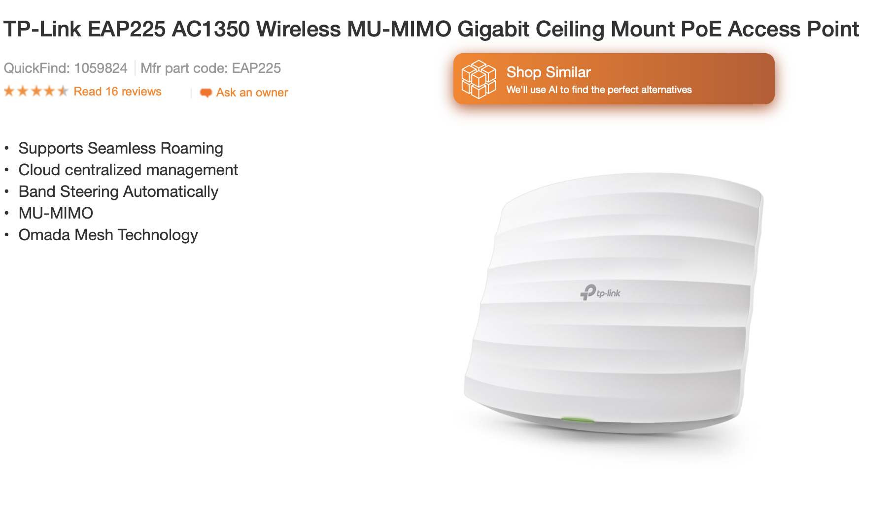

Nestor Posted February 24, 2023 Posted February 24, 2023 We have used the TP Link below. Simple and effective.
