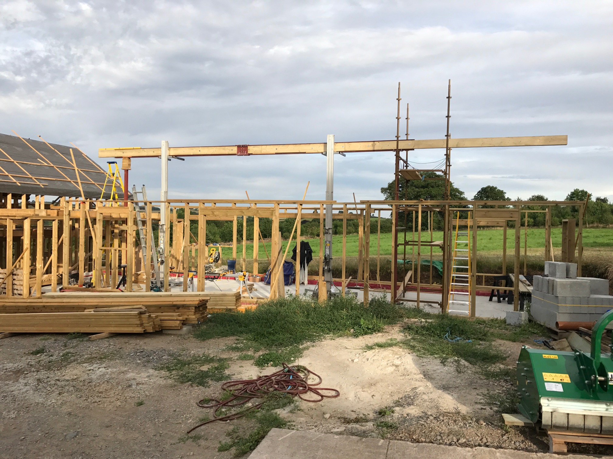

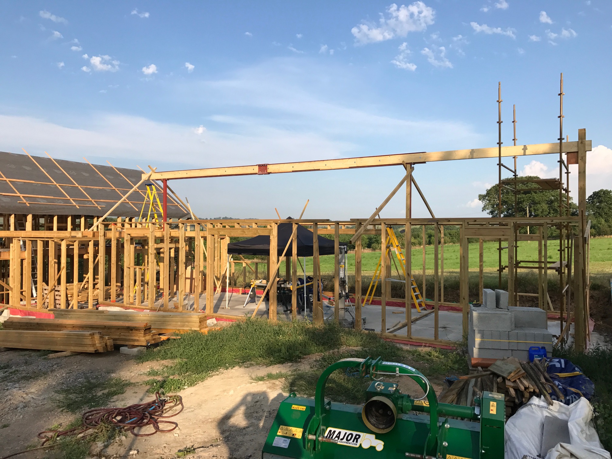

JamesP Posted July 19, 2017 Share Posted July 19, 2017 (edited) Hi Ian Sorry to hear the news. You have great advice here. It will be rectified and you will move forward once again with the build. In situations like this I think it could have been worse, no one injured. Monday, my Dad and I put up a 400kg steel, 10.5m in length, 5m up on a couple of Genies. Felt a bit sick the whole day seeing it sway in the wind and one of the posts was 40cm to short!!! It was replaced yesterday. Drama....Blocks underneath left hand post. Kind regards James. Edited July 19, 2017 by JamesP Link to comment Share on other sites More sharing options...

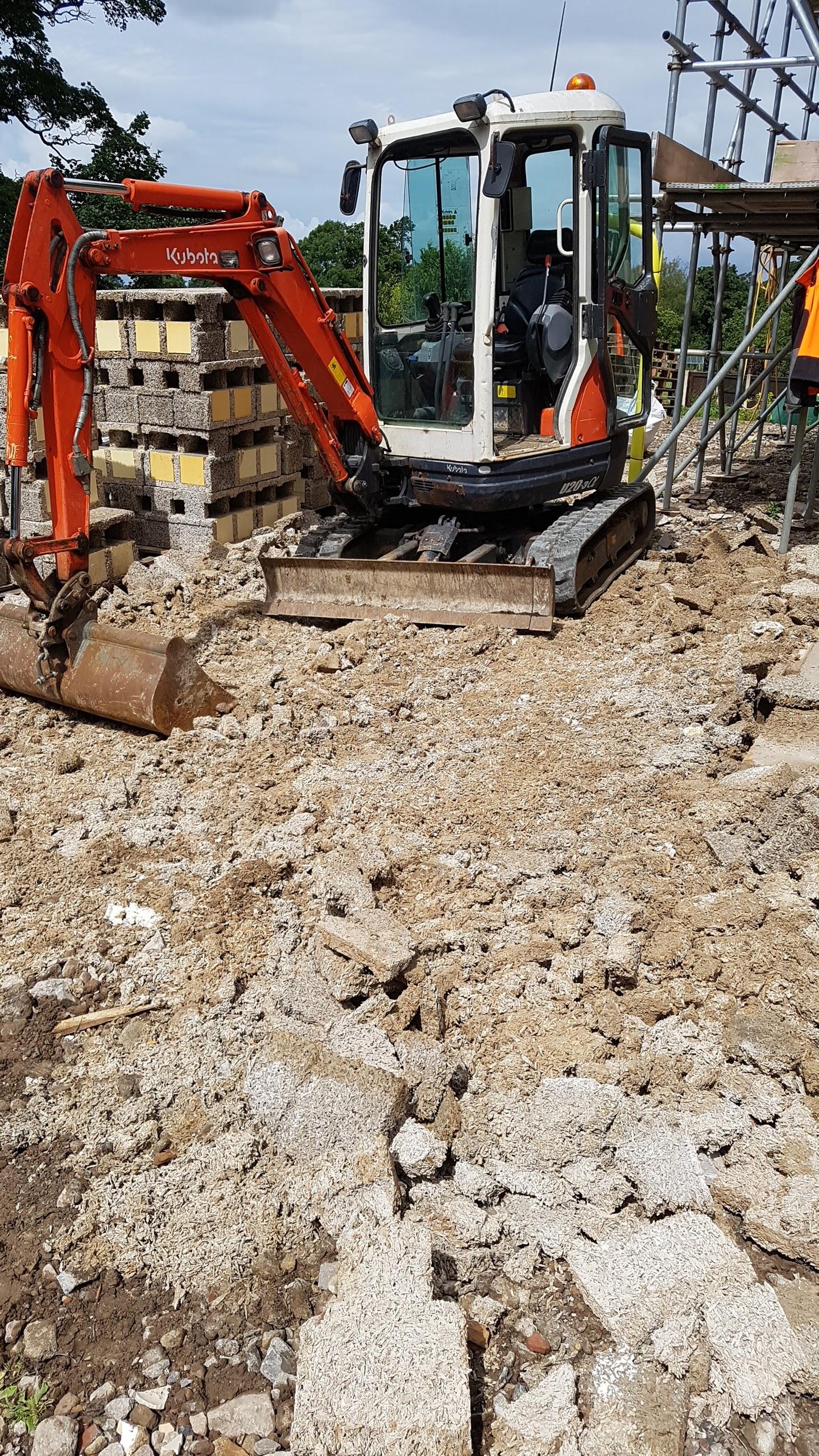

ToughButterCup Posted July 21, 2017 Author Share Posted July 21, 2017 From that to this and after separating the foam blocks from their wooden 'jackets' then kissing them with the digger, this.... a really nice, soft, bouncy, free draining top cover for the MOT1. It'll break down even more over time. And come into its own over the winter - maybe not so many muddy boots. Better and much cheaper than skipping it. Meeting the Durisol MD and rep on Tuesday of next week. Contractor tomorrow. With luck and a good deal of energy, we might just get back on schedule with the least damage possible. Now all I have to do is make it happen. 1 Link to comment Share on other sites More sharing options...
