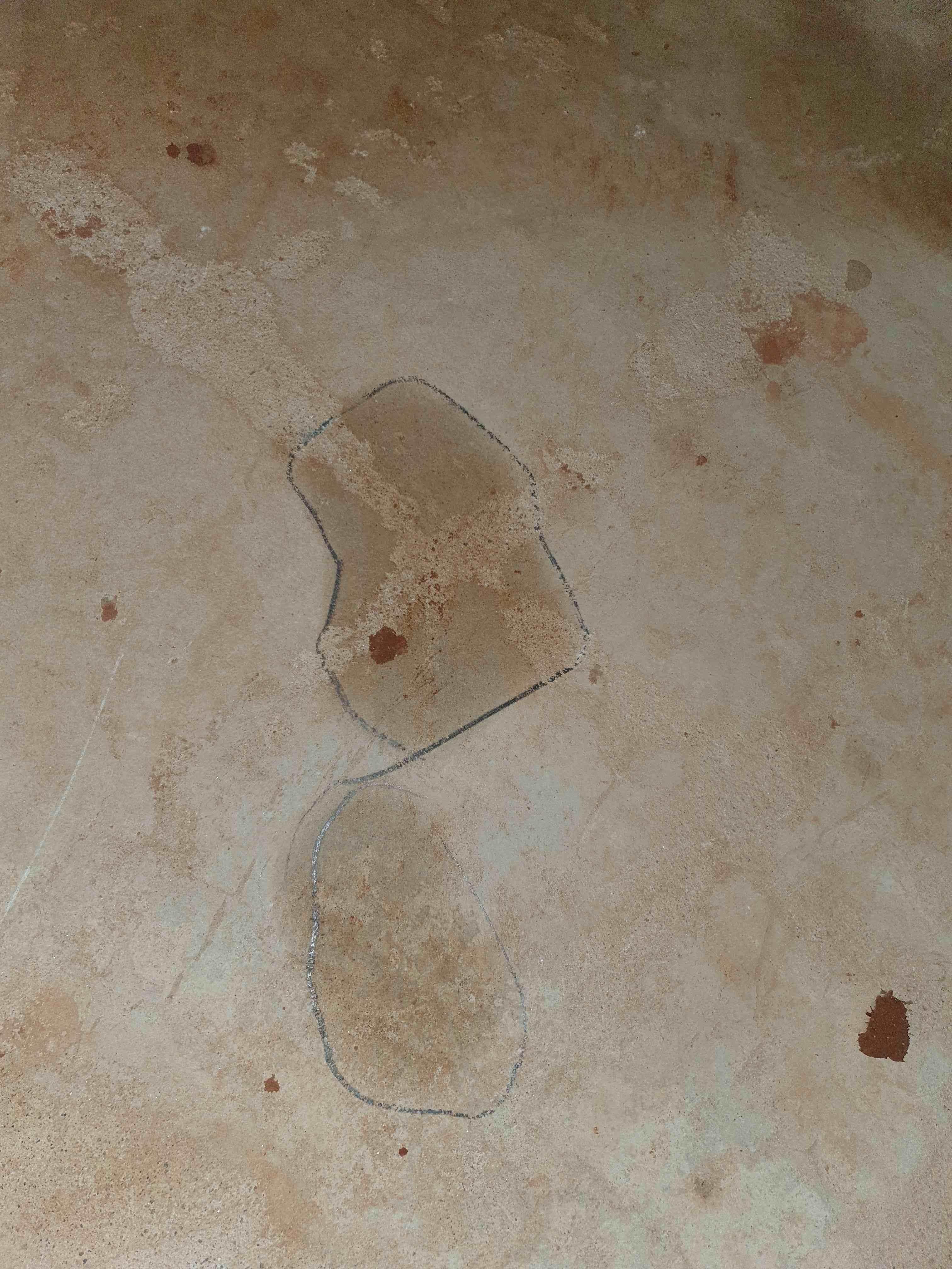

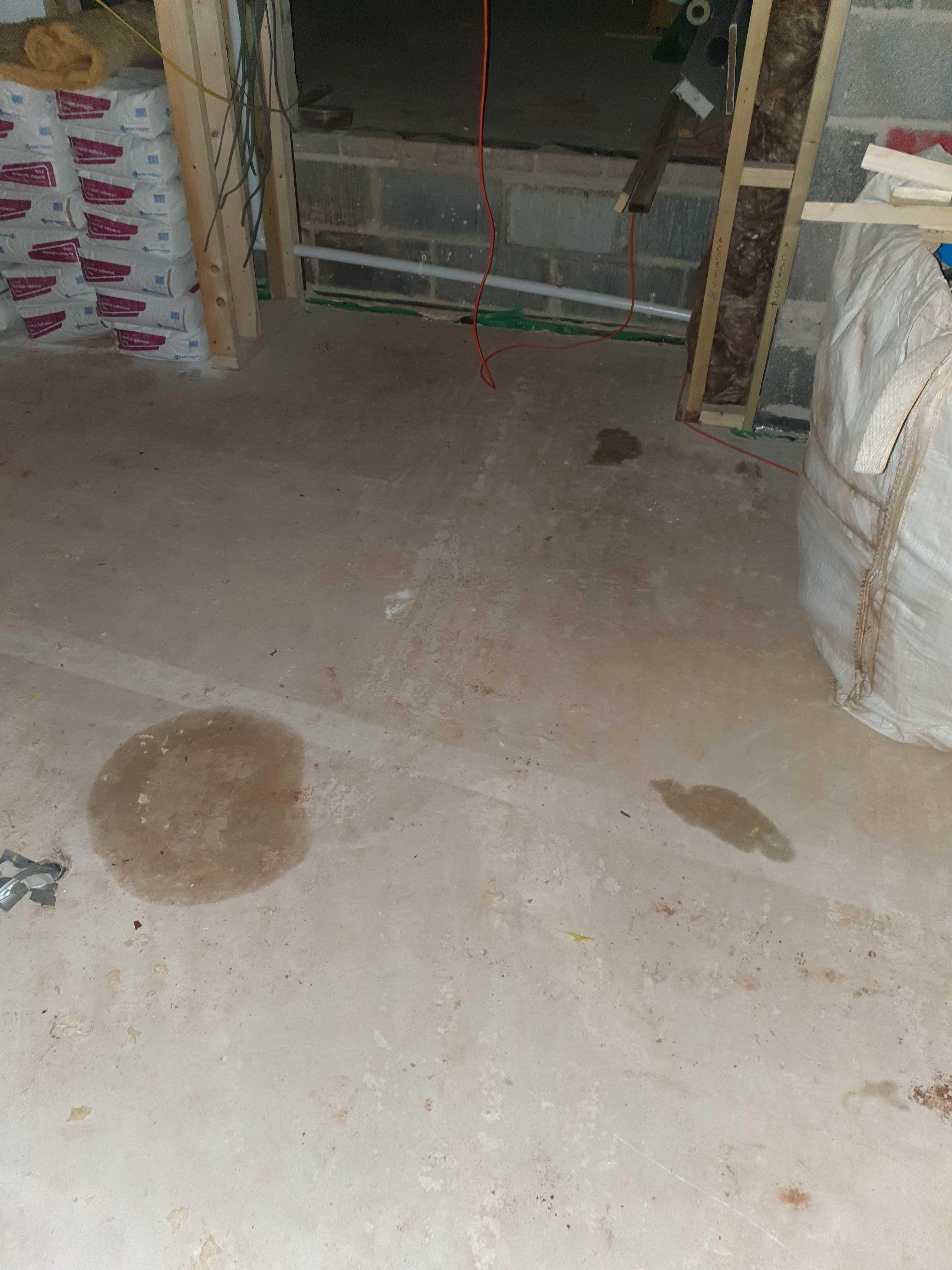

Moonshine Posted December 12, 2022 Posted December 12, 2022 My build is getting cold at night and ufh pipes are in, water is in them up to a pressure of one bar. Water in hose pipes are frozen and just checked in my build. I am seeing wet spots on the screed, unless it's my trades spilling thier teas it really looks like the ufh is leaking, feck.
Mr Punter Posted December 12, 2022 Posted December 12, 2022 (edited) The pipes are really strong. Unless the temperature indoors got really low I don't think it could be leaking pipework. Can you see if they are frozen at the manifold? Edited December 12, 2022 by Mr Punter

Moonshine Posted December 12, 2022 Author Posted December 12, 2022 (edited) 13 minutes ago, Mr Punter said: The pipes are really strong. Unless the temperature indoors got really low I don't think it could be leaking pipework. Can you see if they are frozen at the manifold? The indoors is cold, as it hasn't got a couple of external doors fitted. I will try the drain valve and see if anything comes out, though that doesn't mean to say its not frozen elsewhere Edit: released the drain values on the inlet and out let of the manifold quite a lot, only a low flow came out of each. Gut says it's all pretty much frozen. Edited December 12, 2022 by Moonshine
Mr Punter Posted December 12, 2022 Posted December 12, 2022 Could just be some soggy materials left in a dumpy bag?
Radian Posted December 12, 2022 Posted December 12, 2022 Blow some heat on it to dry it out - then wait and see.

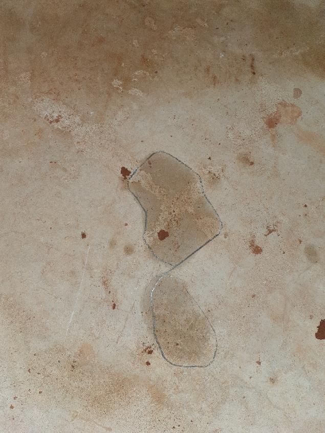

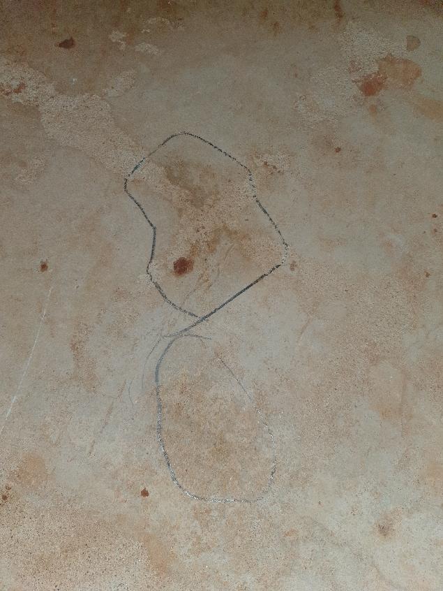

Moonshine Posted December 12, 2022 Author Posted December 12, 2022 21 minutes ago, Radian said: Blow some heat on it to dry it out - then wait and see. Used the hairdryer on a damp spot. After a few minutes the surface seems dry, now we wait.
Radian Posted December 12, 2022 Posted December 12, 2022 Good thinking to mark out the outline of the corpse wet patch on the floor. Are the drain valves still open?
Moonshine Posted December 12, 2022 Author Posted December 12, 2022 9 minutes ago, Radian said: Good thinking to mark out the outline of the corpse wet patch on the floor. Are the drain valves still open? Just gone back in, wet patches have returned (there are about 4 locations), f$%k. I just opened them so a short while and closed them back up. 1
PeterW Posted December 12, 2022 Posted December 12, 2022 Put plastic over them - if there is a drip from above the plastic will catch it 2
Moonshine Posted December 12, 2022 Author Posted December 12, 2022 1 minute ago, PeterW said: Put plastic over them - if there is a drip from above the plastic will catch it Absolutely bone dry above them, I am watertight other than two external doors
