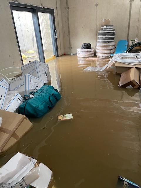

Thorfun Posted November 17, 2022 Share Posted November 17, 2022 hi all. woke up to a nightmare today as the single pump in our sump failed last night and with all the rain and underground water our sump filled, overflowed and found it's way (I believe it was under the sliding door) in to our basement. we were using the basement as a storage area for our household belongings that are waiting for the house to be finished. stuff has been ruined and we can't do much about that now but it has really pushed my need for quality pumps that have a reduced risk of failure that I can use for the sump. I have temporarily replaced the failed pump with a Titan pump from SF just to get back to a normal state but I want to get the proper ones in as soon as I possibly can. Can anyone please recommend a good pump make/model for a sump? I want to create a dual pump system for redundancy. Also, I need to create a high water alarm. eventually that should feed in to our proposed Loxone system but, for now, I want to run something that sits in the sump and runs up a long (4m) cable to the top of some heras fencing we have around the basement courtyard with a light on the end so that as we look out if we see a light on we know that something is up! I'm happy to build my own if someone can give assistance on components to use and wiring diagrams. I know it's all a bit like closing the stable door after the horse has bolted but I really don't want to go through another day like we have done today. it's definitely not been a good day. 😭 10 Link to comment Share on other sites More sharing options...

Pocster Posted November 17, 2022 Share Posted November 17, 2022 Right ! This was always my fear ! I have 2 sumps with high water alarm for grey / sewage water . Hi water alarm is audible but also linked to my HA . I also have 2 on Zoellar pumps for rainwater . I tested lots of pumps ! They all failed for various reasons . Zoellar are easily the best . Not cheap . Flooding is the thing that cannot happen. . I bought from https://www.sumpsandpumpsdirect.co.uk Don’t cut corners on this - bolts ‘n’ braces and then some . My configuration would require 4 pumps to fail before any flooding would occur . 2 Link to comment Share on other sites More sharing options...

Pocster Posted November 17, 2022 Share Posted November 17, 2022 To add My rainwater Zoellar pumps are at 2 different heights in a pit I.e lower than my basement floor . I have a HA sensor on the higher one - that informs me if it comes on . As it’s higher it should *never* come on as the lower one should trigger first . So if it gets activated I know the primary pump has an issue . You need a proper approach to this - with multiple fail safes . 1 Link to comment Share on other sites More sharing options...

ProDave Posted November 17, 2022 Share Posted November 17, 2022 Serious question for basement dwellers. I assume you DO have a generator on site always in the event of a power cut? and what if you are away during a prolonged power cut? In the case of our septic tank pump, if the pump failed or a prolonged power cut, your lawn just got some fertiliser. Link to comment Share on other sites More sharing options...
Pocster Posted November 17, 2022 Share Posted November 17, 2022 4 minutes ago, ProDave said: Serious question for basement dwellers. I assume you DO have a generator on site always in the event of a power cut? and what if you are away during a prolonged power cut? In the case of our septic tank pump, if the pump failed or a prolonged power cut, your lawn just got some fertiliser. I have batteries . But if I didn’t would have ups Link to comment Share on other sites More sharing options...

Thorfun Posted November 17, 2022 Author Share Posted November 17, 2022 9 minutes ago, ProDave said: Serious question for basement dwellers. I assume you DO have a generator on site always in the event of a power cut? and what if you are away during a prolonged power cut? In the case of our septic tank pump, if the pump failed or a prolonged power cut, your lawn just got some fertiliser. I have battery backup for the whole house. Am also now thinking of a dedicated UPS just for the sump pumps! for prolonged power cut I would have to look at hiring a generator I guess. or just stand next to the sump with a bucket and start bailing. Link to comment Share on other sites More sharing options...

Nickfromwales Posted November 18, 2022 Share Posted November 18, 2022 10 hours ago, Thorfun said: I have battery backup for the whole house. Am also now thinking of a dedicated UPS just for the sump pumps! for prolonged power cut I would have to look at hiring a generator I guess. or just stand next to the sump with a bucket and start bailing. The problem will be the significant start-up current required for a pump of this type. That’s why 230v breakers got pumps have to be C rated, so they don’t trip out on start-up. An UPS will need to be specified for the load, so beware of that when considering / ordering. It may be a good idea to have a much smaller auxiliary pump set aside for this, which can just run constantly for any such “doomsday” events. 2 Link to comment Share on other sites More sharing options...

saveasteading Posted November 18, 2022 Share Posted November 18, 2022 (edited) Normal practice in commercial projrcts is to have a pair of identical pumps at the same level. Each is sized to cope with predicted quantities alone, and due to some clever control box they operate time about. This also provides for a backup. To prolong their lives the sump should be substantial and is allowed to fill a bit before one kicks in. A secondary float is higher and turns on the second pump if the first is not coping. There are also warning lights for operation and showing a fault. This kit is not cheap, so it depends on your perception of risk and value. I would contact a local pump specialist. It is surprising that this is a sustainable business. They tend to be small businesses with multiple suppliers, and lots of advice. A phone call first. Edited November 18, 2022 by saveasteading 1 Link to comment Share on other sites More sharing options...
