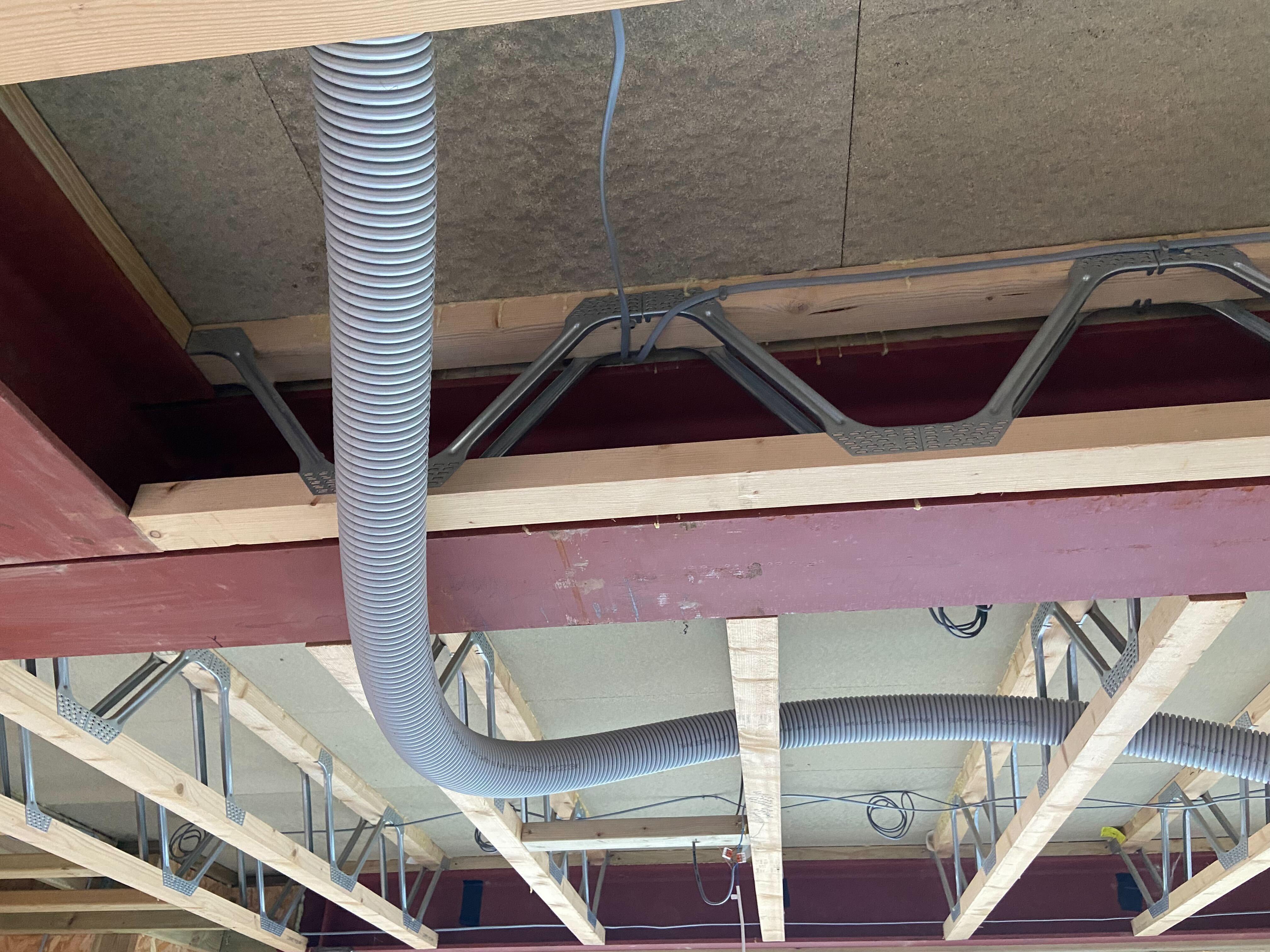

DeanAlan Posted November 7, 2022 Posted November 7, 2022 So, my mistake. When working with the SE, SIPs designer and steel worker, and MVHR designer it was just looking too complicated to core the holes in the steel during fabrication to line them up with posi joists so, when I asked could that be cut on site to "yes", I deferred to gut those cores down in place. Here I am and people sucking air between their teeth all over the place. Any thoughts on how these can be cut? We don't have the height to run the ducts under the beams and there are 3 places where there are no stud walls to hide them in. Some folks have said torch cutting would be possible but dangerous. Some have said a mag drill might fit. Really appreciate some help here on suggestions. Thanks
markc Posted November 7, 2022 Posted November 7, 2022 (edited) Hole saw, starrett ideally as a lot of the others just can’t hack it. Slow drill speed, plenty of water to keep teeth cool and well braced for when it snags, or use a drill stand held in place by a bolt. we have done hundreds of service holes through webs like this Edited November 7, 2022 by markc

DeanAlan Posted November 7, 2022 Author Posted November 7, 2022 @markcthanks - been looking at hole saw or annular cutter as a step up. Not sure there is enough space to get a mag drill so would need some other bracing. Doubt I could apply enough pressure. You are based in west yorkshire 🙂 fancy a trip down to Cambridge. The SE designed the beams for max of 3 90mm holes in centre of beam and we are less than than and off to the edge which is better. Challenge is just making the cuts. @Moonshinerectangular cuts would be bad for the steel at the corners so I'll steer away from that but keep um coming. I was wondering about drilling needle holes and then hacksaw them connections. Labour intensive. 1

markc Posted November 7, 2022 Posted November 7, 2022 @DeanAlan no need for a mag drill, just an ordinary (decent size) rotary pistol type dril. You don’t put any weight on it, let the cutter do the work. Think the most awkward one I’ve done was on a ladder, 150mm diameter hole into a 300mm diameter steel tube with 20mm wall thickness. Took about 30 mins.

Miek Posted November 8, 2022 Posted November 8, 2022 Your steel has a Web thickness of 8.9mm and at 90mm a HSS hole saw will do this easily. As @markc said, get a Starret one and use at low speed. Do not push too hard or you risk damaging the teeth and keep it straight. Get a can of aerosol cutting oil to make life easy. I reckon 5 mins per hole max. 2
DeanAlan Posted November 8, 2022 Author Posted November 8, 2022 Thanks all. My steel fabricator came around today to take a look. He also says a hole saw will do it, it will take time, access might be awkward and I have 11 of them to do. I told him to do the first one and I'll do the rest with his kit! I'll let you know. cheers, - Dean
George Posted November 9, 2022 Posted November 9, 2022 Just to check... The structural engineer has given the OK to cut a hole in the steel beam? 90mm is over a third of the depth which is the point I'd get a bit wary. Plus needs to be away from point loads/supports
markc Posted November 9, 2022 Posted November 9, 2022 At 1/3 of web depth a circular hole is nothing. The web is only there to keep the flanges apart. But as above, they should not be a point loading locations

saveasteading Posted November 9, 2022 Posted November 9, 2022 3 hours ago, markc said: At 1/3 of web depth a circular hole is nothing. The web is only there to keep the flanges apart. But as above, they should not be a point loading locations Good info, although a third is more a maximum than 'nothing' if the beam is economically designed. To which I add that multiple holes are an issue too. Big holes need to be a long way apart, small ones not so much. Say 1m. As with all holes in beams and joists..keep them at mid height, and towards the ends rather than central. Otherwise the web may fail.
DeanAlan Posted November 9, 2022 Author Posted November 9, 2022 The SE designed the steels to accommodate up to 3 of these holes in the centre of the beams (worst location). In 2 of the beams I do need need to put 3 of these holes but they will be far apart from each other and not need and connection points. As to economical designed - I think the general consensus is that SE don't do that. Tendency is to go to other way! I'll let you know how things shape up (round and full of holes hopefully)
