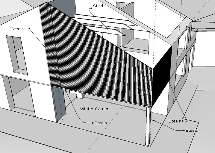

ToughButterCup Posted June 25, 2017 Posted June 25, 2017 Our Winter Garden - outside the heated envelope of the house - is a steel-framed construction. It will be open to the elements, and intended as a filter for the light from the south: all the rooms open into it or have a window onto it (except two). Debbie's keen on gardening. Me? Hmmm. Lots of people have been round to poke and stare at the build, among them a couple of local builders..... Talking about the Winter Garden, I mention we have been told that the steel frame for the garden needs to be built by a CE marked and Certified company. Cue snorts of derision, sucking of teeth and pithy Lancastrian. Who's correct? The builders or the ones with PII (Professional Indemnity) cover? WinterGardenIllustration.pdf
Jeremy Harris Posted June 25, 2017 Posted June 25, 2017 AFAIK, it just needs to comply with Part A, in terms of the structure, same as the house. CE marking applies to materials and products, not companies, so as long as the steel is supplied to the spec the SE has provided any competent steel erector can put it up.
MikeSharp01 Posted June 25, 2017 Posted June 25, 2017 1 minute ago, JSHarris said: AFAIK, it just needs to comply with Part A, in terms of the structure, same as the house. CE marking applies to materials and products, not companies, so as long as the steel is supplied to the spec the SE has provided any competent steel erector can put it up. Yep, +1 to that. You will be able to get the CE paperwork for all the bits, steel, bolts, welding rods etc but you won't need one for a one off winter garden, or at least I can see no reasonable path through the CE process that would be usable unless the whole winter garden was a product in its own right. If you think about it the CE process was designed to ensure that products arriving and circulating around the EU met the various standards. Your product is being built to a local standard (building standards) and is not destined for resale as a retail product so I cannot see how it might apply although the last time I had to take a product through CE marking was 2003 I think.
dpmiller Posted June 25, 2017 Posted June 25, 2017 http://www.steelconstruction.info/CE_marking "fabricated and delivered to site"
Declan52 Posted June 25, 2017 Posted June 25, 2017 I put the steels in for my wrap around window. Only had to show the spec sheet for the L shape steel catnic to BC. He just looked at the support post and seen it was heavy wall box section and went on his way.

Construction Channel Posted June 25, 2017 Posted June 25, 2017 without belittling the project i am struggling to see the complication, you have 2 steels sitting on top of a column with another column sitting on top of that??? I can't see where any structural welds would be. only to hold the plates in the right place. how well do you get on with your LBCO? I asked similar questions (about certified welds, not so much being CE marked) when i was looking into my steelwork, turns out not many people cared, as long as the steels being used had been specced by a SE, the actual fabrication and purchasing of the steel never got questioned, as I'm sure you know in the end i welded and cut all my steel myself and i have still not been asked where i purchased it from, 2
jamiehamy Posted June 25, 2017 Posted June 25, 2017 55 minutes ago, Construction Channel said: without belittling the project i am struggling to see the complication, you have 2 steels sitting on top of a column with another column sitting on top of that??? I can't see where any structural welds would be. only to hold the plates in the right place. how well do you get on with your LBCO? I asked similar questions (about certified welds, not so much being CE marked) when i was looking into my steelwork, turns out not many people cared, as long as the steels being used had been specced by a SE, the actual fabrication and purchasing of the steel never got questioned, as I'm sure you know in the end i welded and cut all my steel myself and i have still not been asked where i purchased it from, Wot he says- don't create a rod for your own back! Unless you think Jean Claude Juncker is going to visit...
dpmiller Posted June 25, 2017 Posted June 25, 2017 yup. Get it fab'd on site by yourself or others and you're good.
ToughButterCup Posted June 26, 2017 Author Posted June 26, 2017 8 hours ago, Construction Channel said: Without belittling the project i am struggling to see the complication, you have 2 steels sitting on top of a column with another column sitting on top of that??? [...] I was also struggling to see what was complicated about it. But then, I'm only a Domestic Client ....
