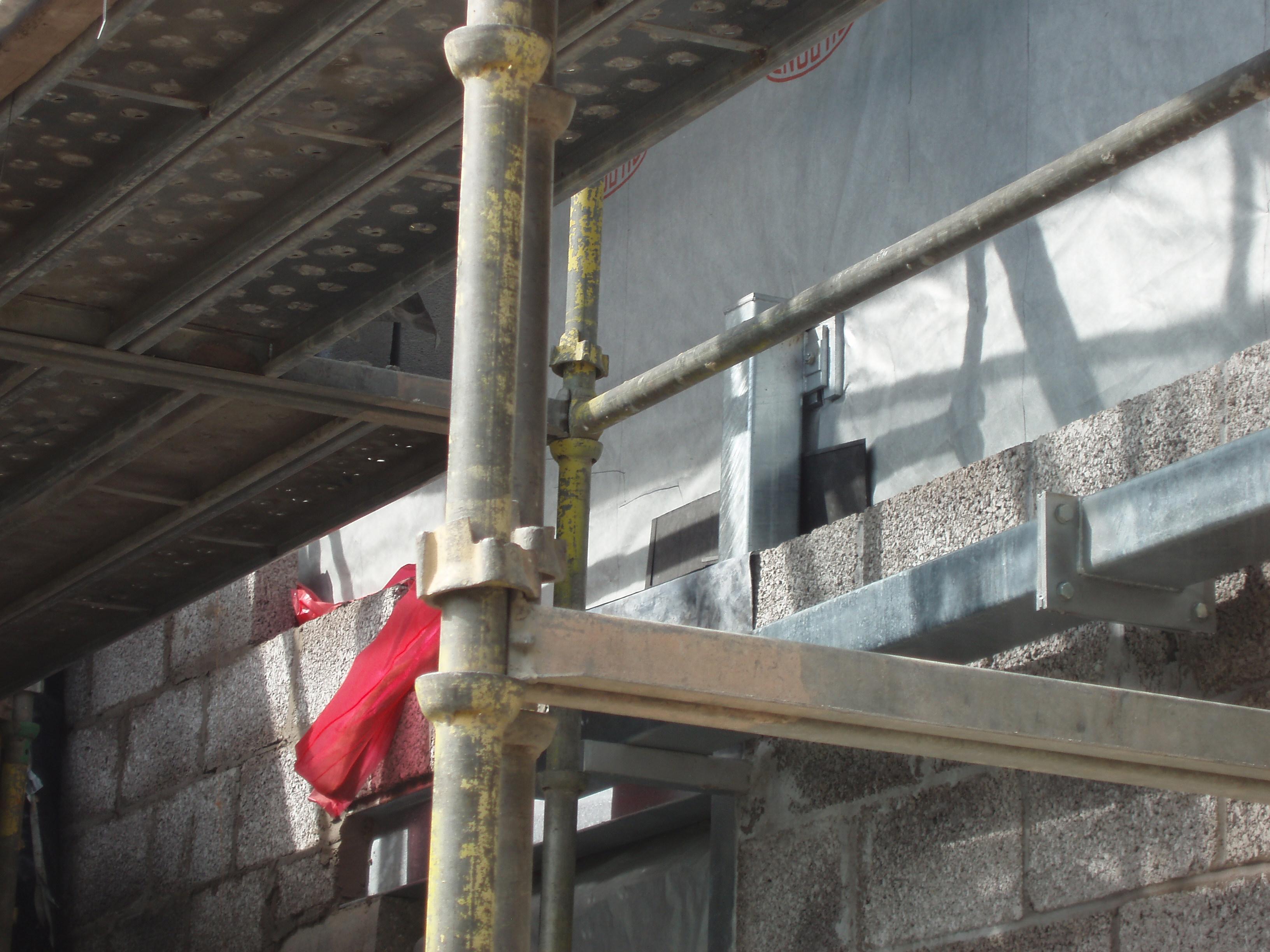

The photographs I posted form part of a remedial works scheme. It’s a very long story but the builder went bust, the structure was found to be defective and off the back of that the warranty provider instructed and employed a contractor to carry out remedial work.
There can be no doubt that they (warranty provider) are now responsible for the welding you see in the photos as it was they that instructed the contractor who carried out the welding.
It is fair and reasonable in my view to expect that the warranty provider will remediate the works to a level that reflects the original “value” and quality of the build that they have underwritten. To achieve this, the remedial works should be capable of resisting the loads etc that were used in the initial design. In some cases there may be an allowance for fair wear and tear but this is in my view not applicable to structural safety as it compromises on what we call the “robustness”.

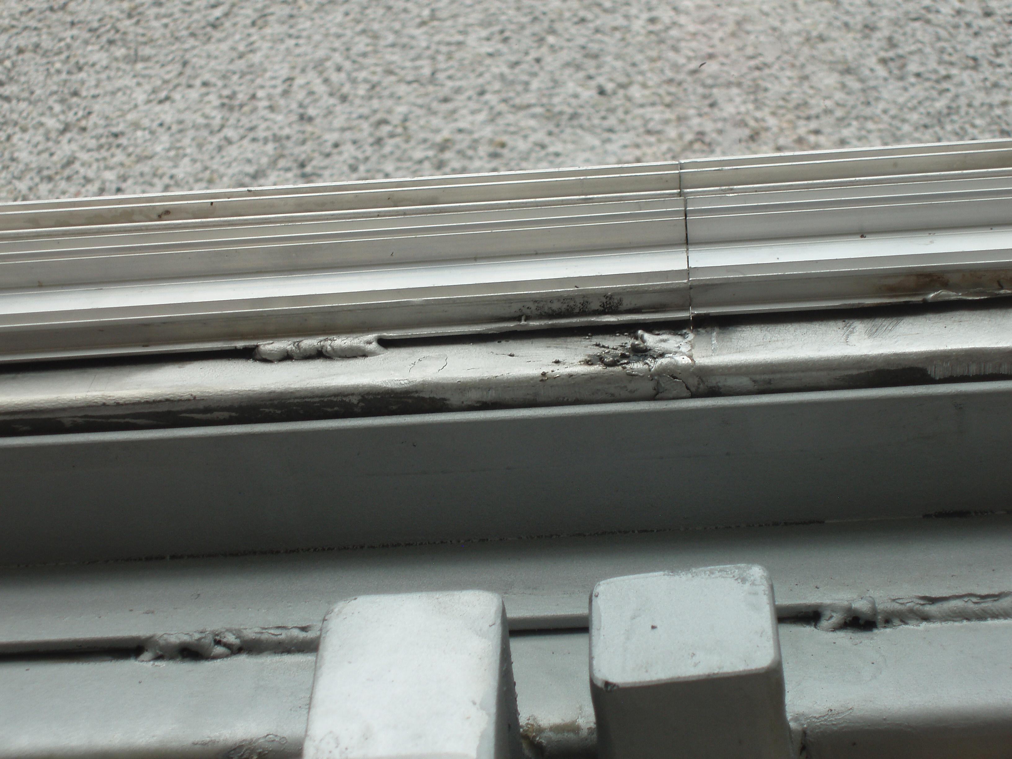

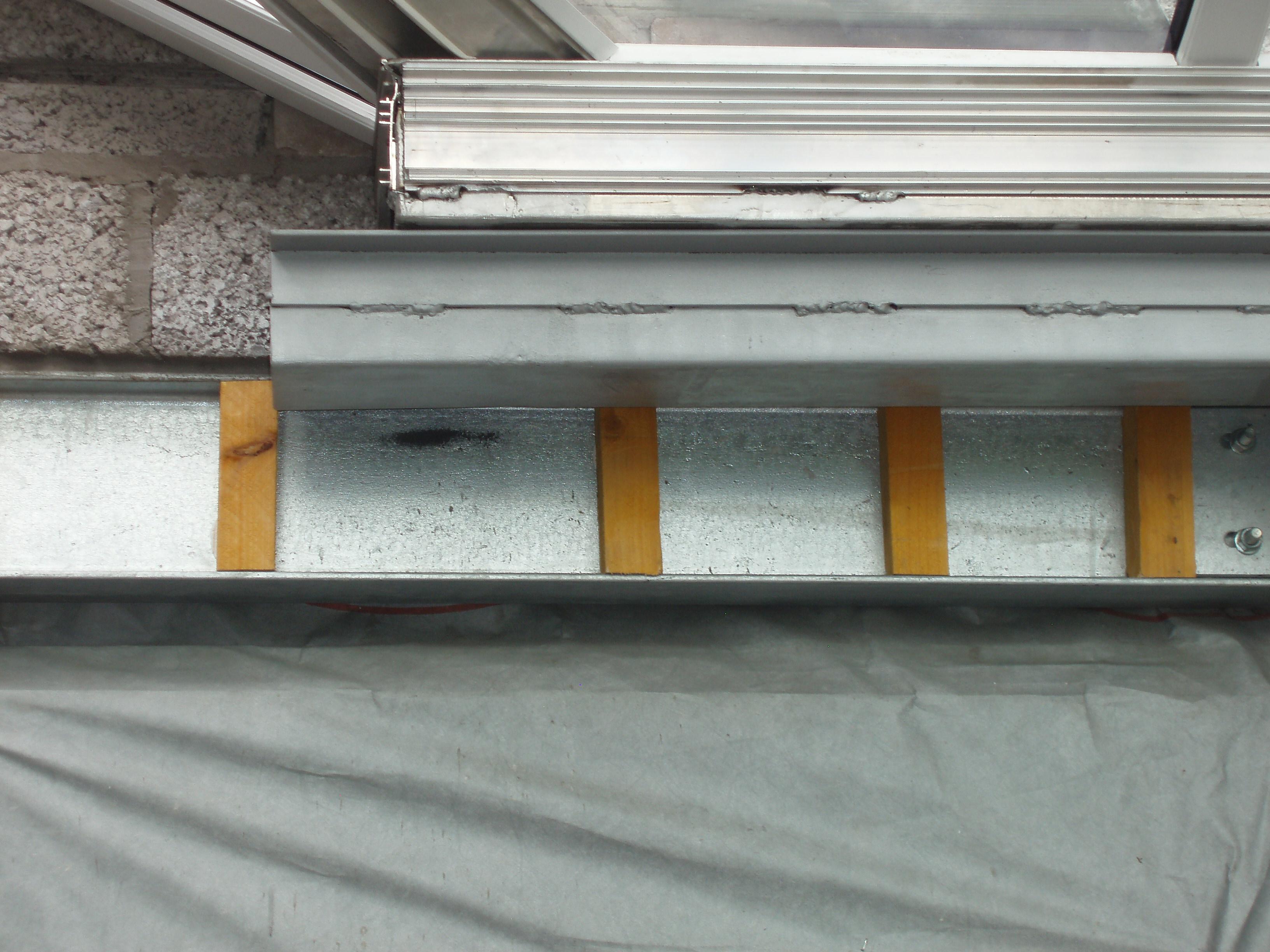

Here are some photos from a project that is covered by one of the major home warranty providers.. who have been arguing for some time that there is nothing wrong with the welding. The steels and aluminium sections you see are holding up a substantial glazed structure subject to snow drift loading in addition to the run of the mill design loads.

Anyway, some key points are: try and avoid site welding unless you have access to a real pro who can over head weld etc. Believe it or not the “goodish” and the “ugly” work was carried out by the same firm.. I cannot explain..

The "goodish" Not a bad end plate weld on the box section, it is covered with a galv finish though.. seen worse.
Oh dear going downhill!
And now we are somewhere else.. how do you classify the quality of the weld when it is kind of not there?
Surely the welding in the first photo was done in the factory with the steel then shipped off to the galvanisers? Looks reasonable...
The shit welding on that extrusion at the top of the second and third photo is aluminium isn't it? That can be a mission on site, especially if windy.
Then the angle to the box all steel? Looks like they used the same broken silicone gun for both! ?
