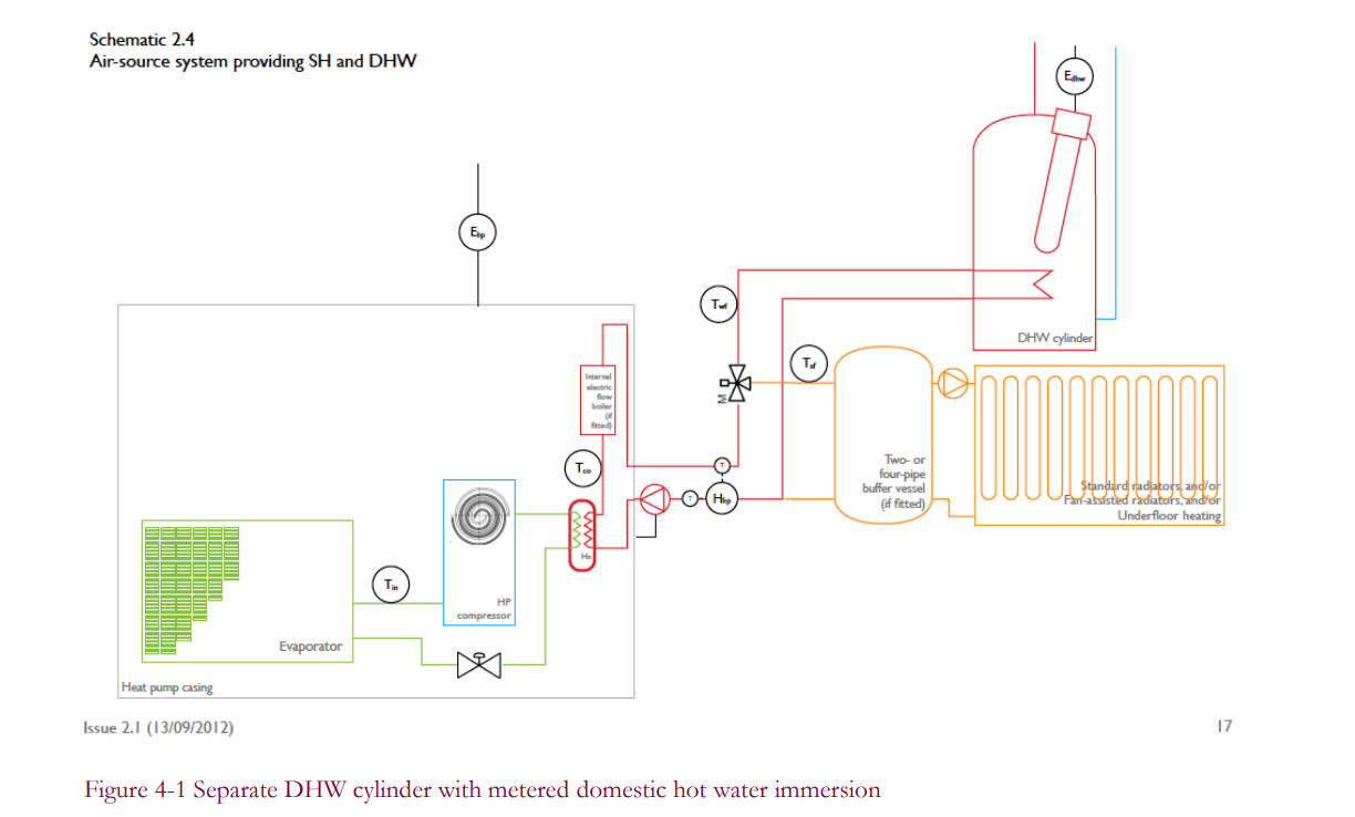

Radian Posted April 26, 2023 Posted April 26, 2023 From the report on MCS compliance page 51, my emphasis in bold: "Sterilisation or pasteurisation is achieved by raising the cylinder water to over 60°C. HSG274 (which refers to commercial installations) states that: “Arrangements should therefore be made to heat the whole water content of the calorifier, including that at the base, to a temperature of 60°C for one hour each day.” However, a review of heat pump manufacturers’ literature identifies varying guidance on the sterilisation process with temperatures ranging from 65°C to 73°C for between 30 and 90 minutes either weekly or fortnightly." It refers to HSG274 which is directed towards commercial installations and seems to be the only in-depth HSE guidance available. Then its goes on to show a diagram with a fairly typical looking immersion mounted in the top of a cylinder: Even if scheduled to heat at 60oC for one hour each day, this will fail to heat the water below the immersion without additional destratification measures. I appreciate that most new DHW cylinders installed alongside ASHP's will be unventilated types probably with bottom mounted immersions but with the widespread installation of top mounted units, it's clear that in many households it's been common practice to only partially heat the water when relying solely on the immersion to achieve the temperatures required for sterilisation. The lack of clarity in all this continues to bug me. I'm trying to emulate switching to an ASHP by modulating down my gas boiler but don't want to do something stupidly dangerous in the process. The plan was to use my solar PV diverter to heat the DHW via an immersion - hopefully exclusively so during the summer. I had already successfully reduced the flow temperature from the boiler to 55oC for radiators but all but given up on heating the HW cylinder with anything less than 70oC. I was hoping to eliminate this with the immersion but now I'm unsure. Obviously I can play it safe and run the boiler like this once a day but it's tempting not to. Hence wanting to get a thorough understanding of the issues.
markocosic Posted April 26, 2023 Posted April 26, 2023 The shower valve and pipe are purged at relatively high velocities and scoured of boifilms. Cylinders are not. 60C heating (at the 1/3rd mark) is for quickly pasteurising the gunky water at the bottom of the cylinder. It's never 60C at the base of old cylinders. Guidance that refers to this is bunk. Impossible in practice for most designs. It's more like setpoint 60C using a reheat stat 1/3rd of the way up. New unvented cylinder with a big coil that runs to the base is fine at 50C. Old junk ought to get junked along with the boiler and replaced with something clean with an appropriate coil in it and low standing losses etc IMO. Cylinder replacement ahead of boiler replacement is not problematic.
